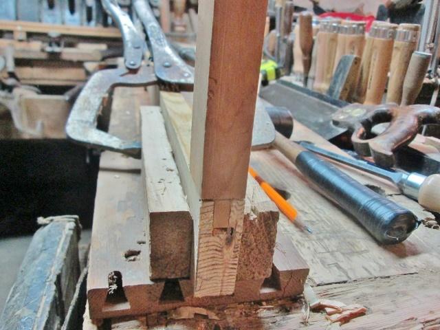

Rawhide mallet, Lew's Mallet is still on Vacation...I  mark out the location for the morise, using the tenon, a combo square, and one of them "hard to find when you need it" pencils....Clamp to hold things still for a bit...Backsaw?
To make a cut like this, then the chisel and mallet..
To dig a hole.   Mainly where the saw can't reach.    Chisel to "pop" the waste out..
Until it is cleaned out, then the test fit...
Repeat this three more times..
Then glue and clamps, checking for square...checked the dryer.....after the glue had set up enough, remove most of the clamps...pin the joints..

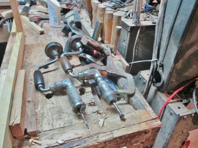

Which involved drilling a few holes, and counter sink them...have the drill handy..
Where these frames attach to the sides of the case..needed two more such holes..

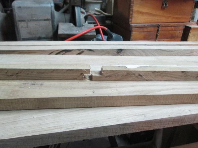

All the parts for the face frame.   Joints are to be 1/2 Lap, so, I had to set the height of the saw blade....
About the same thickness....we'll go with that..
Width is set to match those two stiles behind them..Need to clean these up a bit...and cut a detail...

had issues with one of the lap cuts..
Saw was kicking back little chunks at me...almost shredded the waste area....Rest of the laps cleaned up nicely..

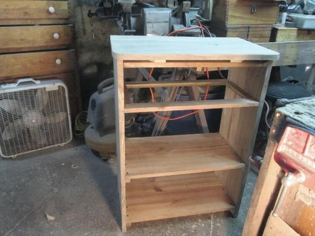

Really starting to take shape now.

Ok..most of the glue has cured...clamps came off the case....beltsander , router.  palm sander...scraper....time for a few PIPS?
Front corners have been rounded over,  same with all the other hard corners.   Plugs have disappeared..
There is 3 plugs in this view.....I think.  Side view?
A look at the feet?
White things are plastic, nail-on pads.   feet and the cut-outs are all rounded over...top?
Not too hateful?   Scraper?.....After the sanders got done, and the router before that...final smoothing was with a scraper..

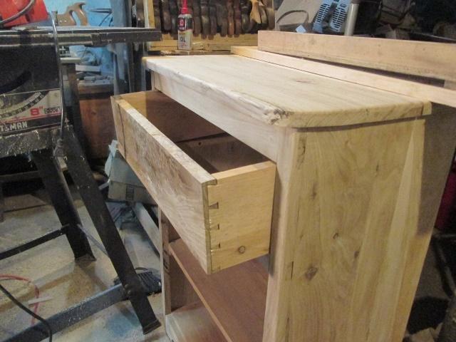

Still one shelf to go.....Got the drawer front out of the clamps...
Wanted one straight edge...then rip the other edge for width....leaving enough extra to plane smooth..
Then square the ends.   Then finally work on the face..
Planes did not like this grain...scraper did.   test fit?
I tweak this for a better fit..once the rest of the drawer is built....Ripped the 1 x 12 down to match the height of the drawer front....then cut for length..

you, on the other hand, had a pretty productive afternoon I see. Gonna' be one snazzy drawer front!
