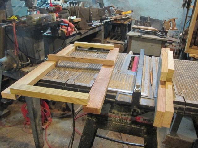

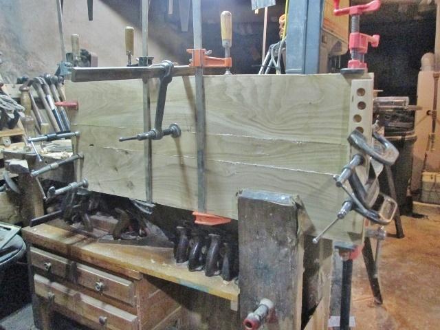

have this laying on the tablesaw....also good for doing glue-ups...
I fired the splitter/guard today.....all it did was bind things up...
About an hours worth...takes a while, went they look like this..
Had four edges to joint, used a few planes...some more than others..
In order to get them ready for a bead of glue, and a few clamps..
Tablesaw to crosscut and rip a few parts for side #2..
Might be a bit rough to blend this grain together....cut off pile is growing..
Will see what I can do with them.....door frames?  tops?   Face frames?   we'll see
Stay tuned...will let this sit overnight....

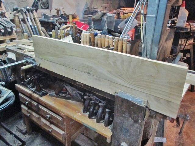

Ok..Panel #1 had it's clamps removed..
Handsome..ain't it, set this aside, out of the way..
And this is the "inside"  of the cabinet...

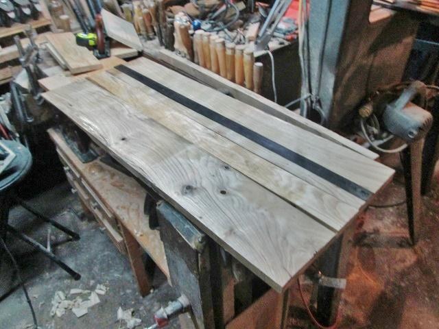

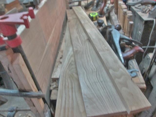

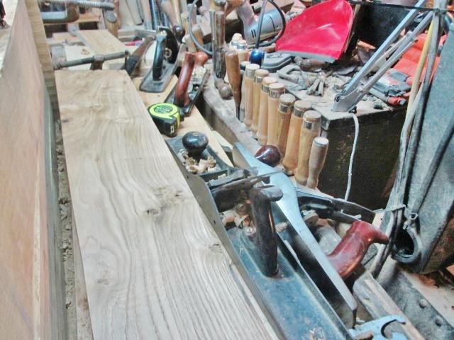

Had three more boards to work on..

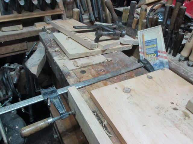

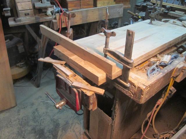

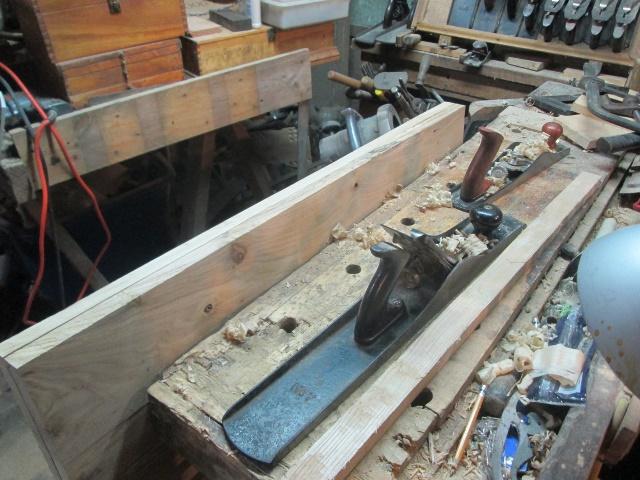

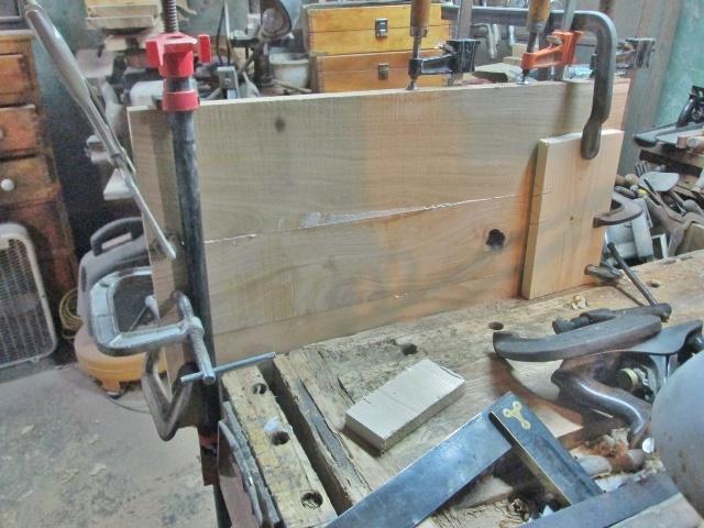

Kind of gappy?   We have ways....Clamped one of the wider ones to the bench's side..
I had a straight line to try to joint for....will worry about the non-glued edge later...

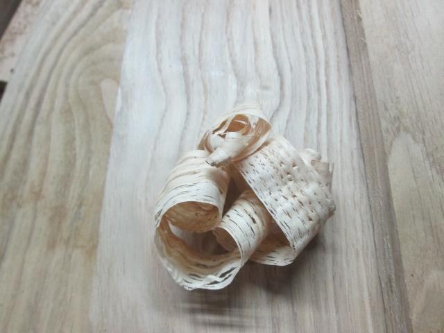

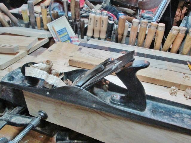

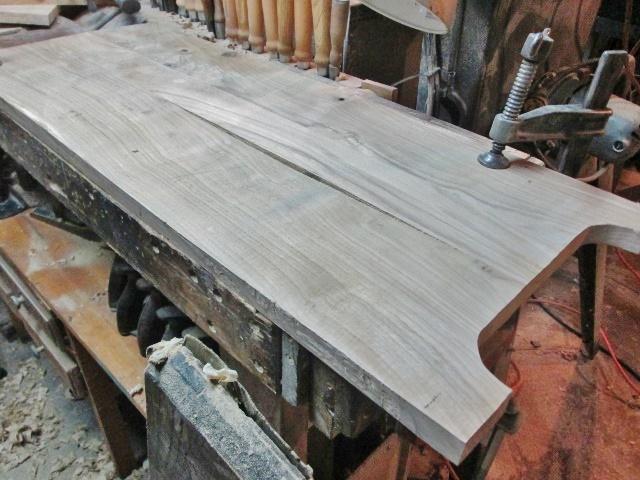

Used a No. 5 jack to get close to the line, then the No. 7c to get a full length shaving...then on to the skinny board..
Except this needed jointed on both edges...ever wonder about a use for the tool well?

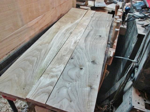

Then check for gaps...

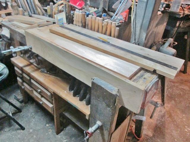

Meh...then joint the other wide board....then set things up for glue, clamps and cauls..
This time around, I needed a caul in the middle...
Skinny board had a curve to it...

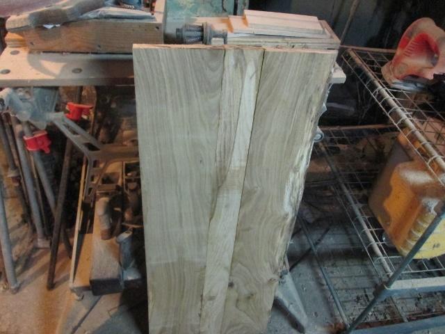

Cut three blanks, to make a 16" wide, by 26" long top for the case...
These are the "good" sides, too.....there was two leftovers..
Fancy?   Wait until I turn it over...

As to the difference between a #5 jack plane, and a #7c Jointer plane?
The Stanley #5 has a cambered edge..the jointer does not....
Side by side...like Mutt & Jeff?  Millers Falls No. 14 ( 14" long) also has no camber to the iron.   I use it first, to get close to a line, then the 22" long #7c finishes things up...

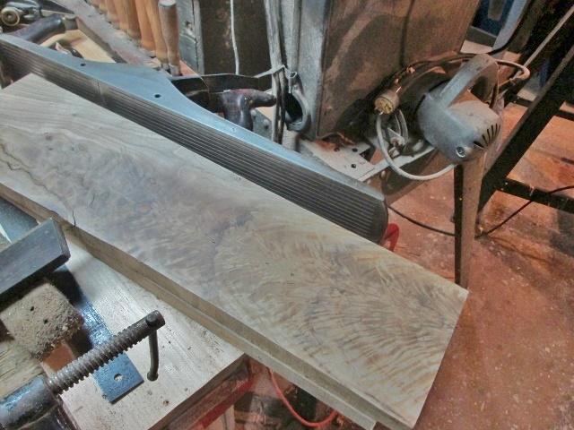

Late last night, I went back to the shop, removed the clamps from panel #2.   Placed it onto panel #1,  and c clamped them together.   Both had a slight cup to them...clamped the cup flat.   letting them sit like that for a while.
