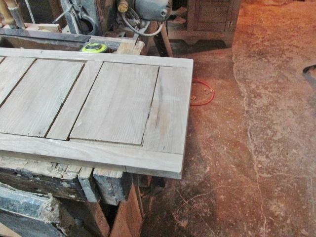

Ugly day outside...made a trip to the shop....Door was taken out of the clamps....nothing creaked, nor cracked..:ph34r:
One edge had a slight curve to it..making the door a tad too wide...we have ways..
Steel ruler to check for straightness....jack to get the high spots, jointer to clean up...
test fits showed one end was out of square....marked it, ran a saw along the line...beltsander to finish up..
Sanded and planed away other high spots...
Located and installed the hinges, to match the other door.   Took a couple tries, to get the knob in the correct spot..had to add a shim under the door, and then install it..
Had also gone around with a hammer and chisel...and cut the plugs flush, after the door was done.   Had some 1 x 12s to cut..
