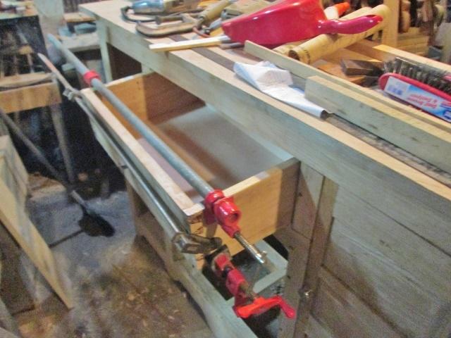

Thanks to the kicker in the top frame, the drawer does not tip down, I can pull the drawer out even further, and no tip.  Them clamps ain't light.

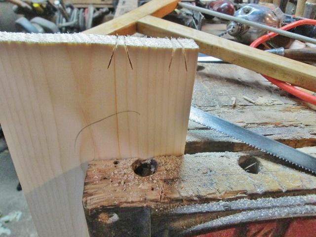

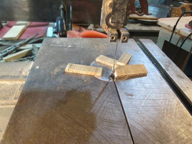

This is after the bandsaw squealed it's way through....planes were just as noisey....it wouldn't fit on the mitre box.
Removed the tongue, and tried to plane it smooth.....planes are not supposed to squeak, are they?

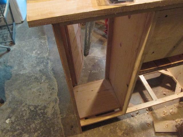

Fixed shelf is installed...front was narrowed down quite a bit...shelf boards are just sitting loose.   Clamps on the drawer  are for a little block of Ash, that is being glued in place, to repair the piece that broke off...:rolleyes:
Back of the shelf sits on a Ash rail...I used a "L" bracket on each end to attach the rail.    Gap is for any cables to pass through, or power cords.  I'll close off the door compartments AFTER this thing is hauled upstairs....gives the "movers" something to grab onto...;)
A bottom shelf..well, most of it...will add the filler later, as I make the rest of the shelves, I should have just the piece for there...
