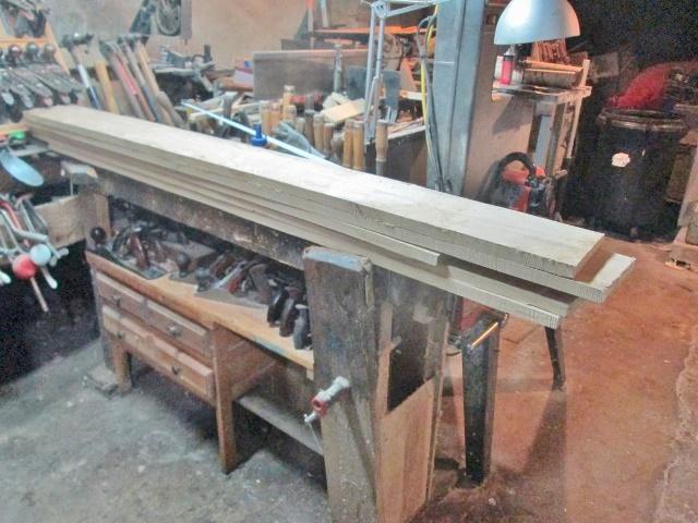

Nice hat, just doesn't protect the ears, much.   These boards are from the Wapak Shindig...finally got them in the house...the Ash?
having issues with the right hand shaking....boards were 1 x 6 x 11'6"...cut in half to fit IN the van...
Clamped together, and let it sit a few days....couple boards were bowed a bit ( will get a couple better views, when I get the tripod back upstairs)

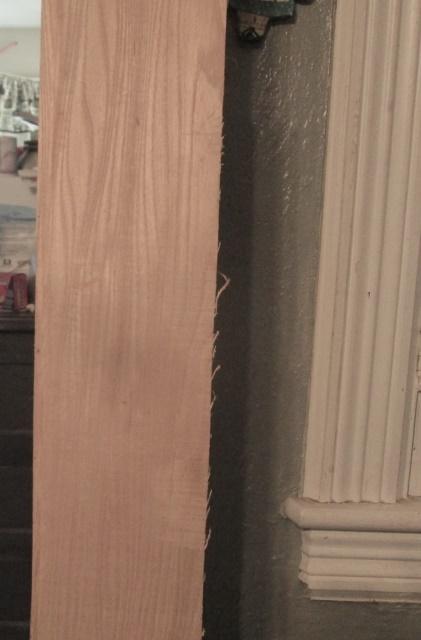

Grain isn't too bad...there are a couple knots in some of the planks.   Some will need a straight edge sawn on them.

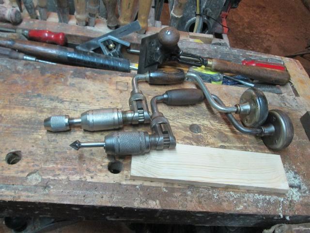

The Add-a-chuck has a home.

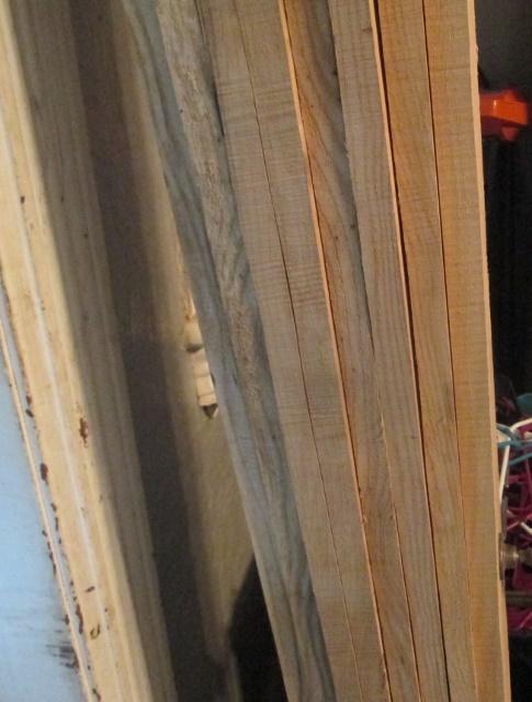

Now, about the Ash...
Clamped up, so the bows are flattened out..8 slabs...average about 5'6" long.
Not quite straight grained...will see how they mill up..
Kind of a mixed bag.   May mill some of these..
Plane the grooves on the faces, and the finish off...may keep the T&G stuff....panels for the doors?

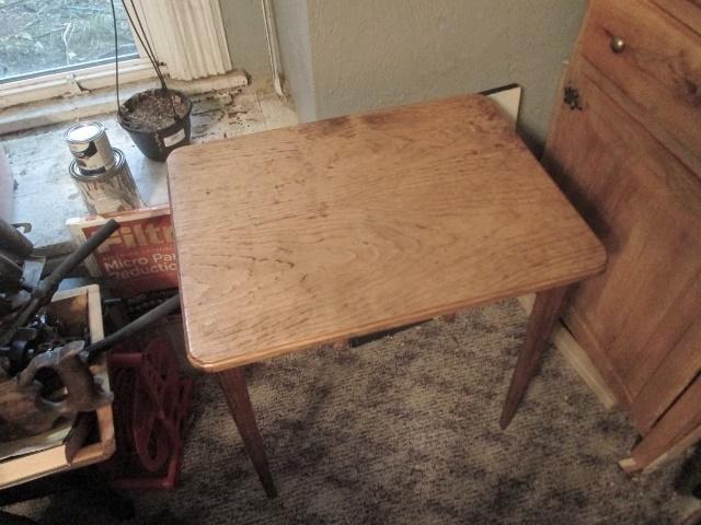

As for that table back there...
Shaker Bedside Table....was supposed to go on my side of the bed?   Wasn't enough room..in the room.   There IS another table sitting in the way, that I seem to trip over....legs are splayed out, and catch anything going by....it will be heading to the recycle pile in the shop...legs and the top.   This simple table is narrower, and won't be a tripping hazard.   The Boss keeps all the jigsaw puzzles on the other table....should be enough room on this one..?
At least these don't splay out.
B)...and a fine one at that where it will get the right kind of exercise.^_^

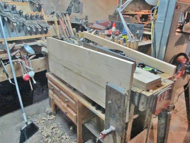

And went to work on the filler strips..

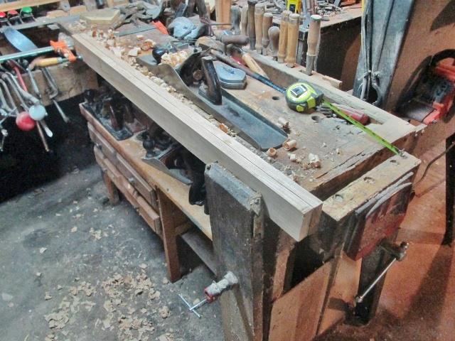

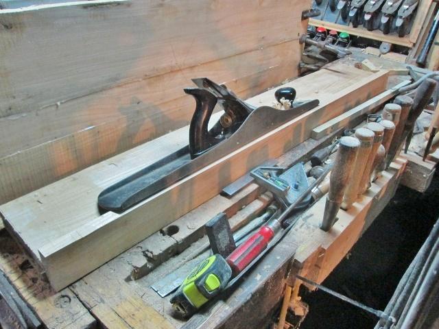

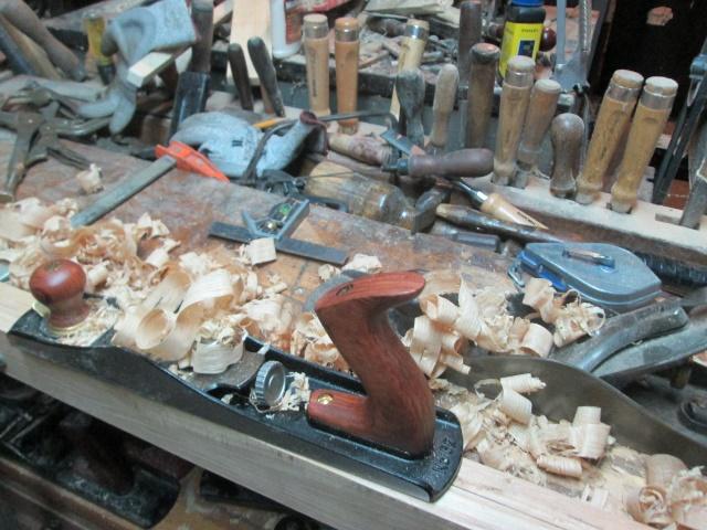

Used this little jointer, among other planes....some areas were really bad..couple of jack planes were also used..
Hey, it IS a Jack plane, after all.   Got both edges close to straight...laid one down on each of the wider planks, and marked a straight(er) edge line...then stacked each up, as i went, whew..
Then laid out three parts, to give an idea of what the sides will be like..
Something like this?   need to joint the edges of the two wider boards, to get rid of the gaposis....some other day...back is about as stiff as these boards are..besides, I was dripping on the lumber.   That will be about it, for today...

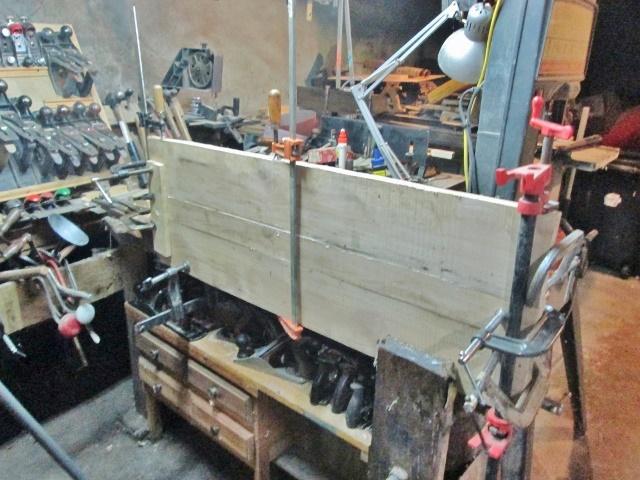

Just can't quit, I guess :rolleyes:....decided a change in planes was in order.   Instead of the 10 pounder..down sized a bit...to an 8 pounder plane.

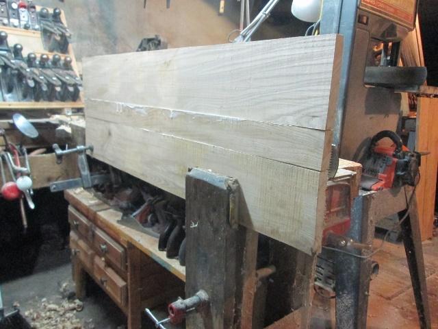

Got both planks to sit without gaps on a middle strip....Decided to try a few clamps and some glue...
I did use the #62 to get things close, then the #7c to flatten the entire length.

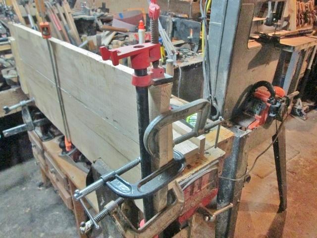

Spread a bead, moosh the next part around til it "sticks in place", spread a bead, and do it again.   Clamp in the middle first, then the ends
I wanted this end to be as straight and flat as I could,  used  a caul and a few clamps to pull things into line.
other end had a caul, just to keep things in line...as i'll be cutting a foot profile at that end.

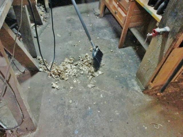

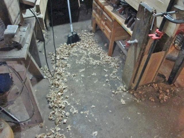

Did make a mess, but not too much..

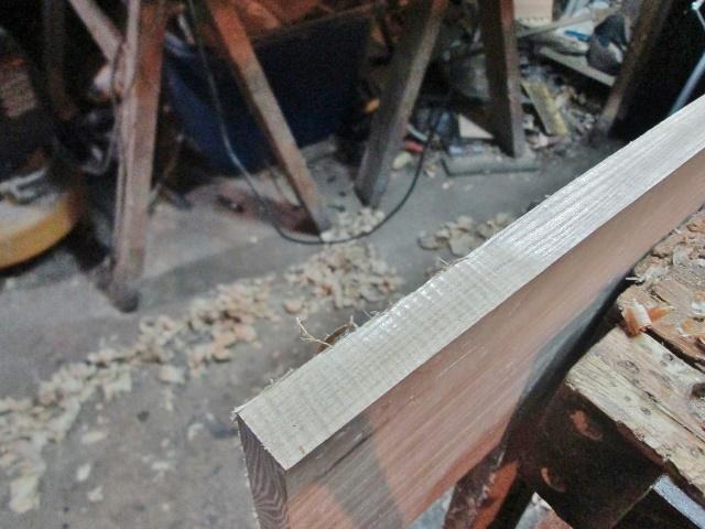

Unclamped side #1...went ahead and jointed the outside edges..
used these two.   Set aside the panel, and went to work on #2..
Goal was to get rid of the high spots, until these low ones shine up...checking for gaps
And making sure the filler strip doesn't rock.   Got both of the 1 x 6s with a jointed edge....spread some glue..
gaps at this end will go away, when the foot profile is cut out...Three planks, just sitting there, held by the glue alone...
Like before, center clamp went on first..then the end clamps, then a caul on each end.
