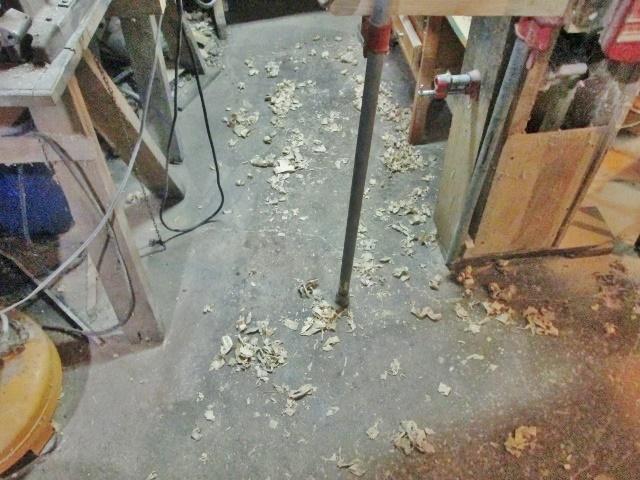

    Just can't quit, I guess ....decided a change in planes was in order.   Instead of the 10 pounder..down sized a bit...to an 8 pounder plane.  Got both planks to sit without gaps on a middle strip
4 hours in the shop today...Not counting a Gatorade Break 1/2 way through...Made a mess on the floor, right off the bat..

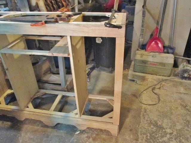

Took a lot of cussing, flipping these around in the shop...sides are now attached to the frames..the parts?

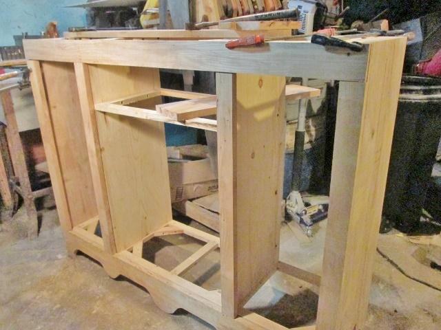

All the parts for two webframes, to house a drawer....got one assembled..
And stuck it here, out of the way..then decided it was BREAKTIME!
After the break, I finished up the other webframe.   Had to clamp a rail in place..
So I could locate where this frame will sit.   It also has the kicker, to keep the drawer from tipping down, when you open it..
Have a blank for the drawer front....and clamped it in place..
To locate where the drawer guides will go....
Still had to drill and counter bore it, first.....then used the big square to draw a few layout lines to show where this will go...and install it...hammer to nudge things into place...
And this is what the drawer will ride on.  3 jobs done, was about Suppertime...cleaned the shop and went upstairs... I did stash things where they should go..

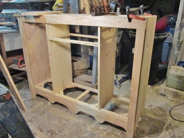

Rebate done, sides attached, drawer frames  made and attached....in 4 hours?   Getting slow in me dottage...

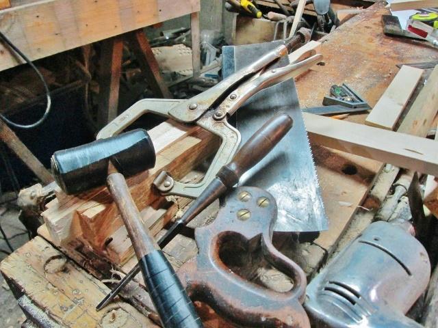

Today?  Tried a nap..didn't work out....went to the shop to "putter around"  Remember back in the Industrial Arts Classes in high school, where you had to make a series of joints with hand tools?  Talking mid to late 60s......

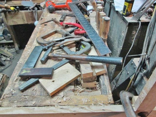

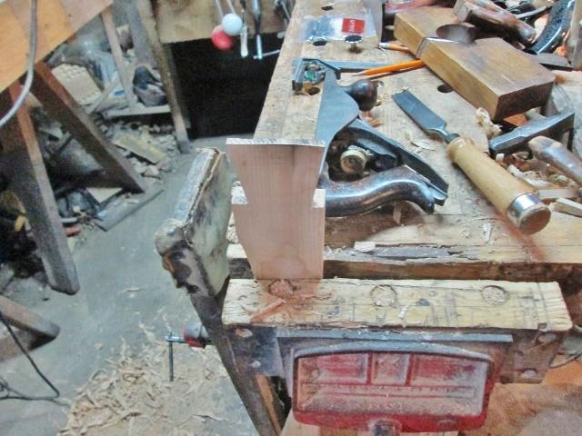

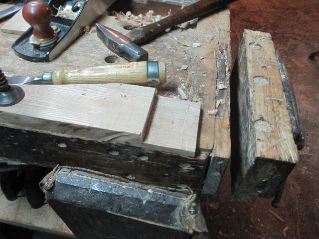

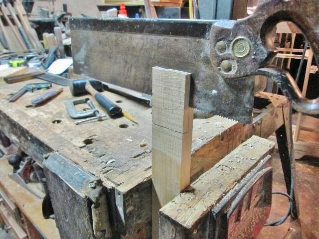

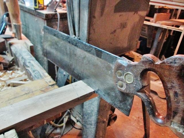

A Half lap Joint was as "easy" as 1, 2 , 3?
One...( after you mark the layout lines)
two..
Three..
Use this to layout the matching part...sometimes, you had to cut things at an angle..

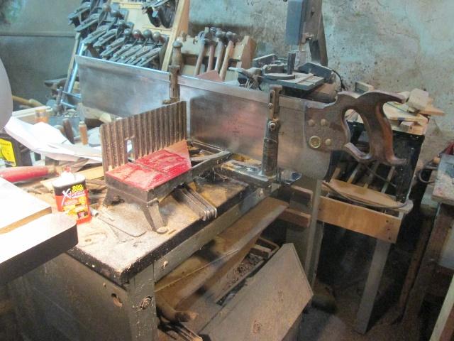

Thought about using the bandsaw,,,,couldn't do a straight cut, like the Disston No. 4.

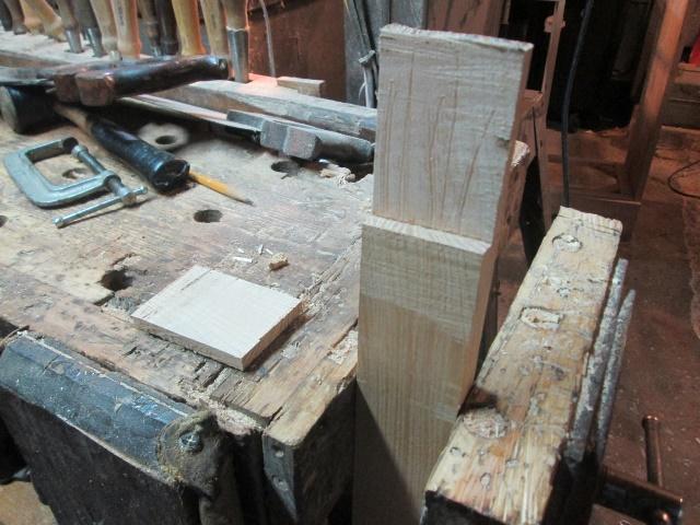

Got the four corners milled, and ready to be fine tuned...

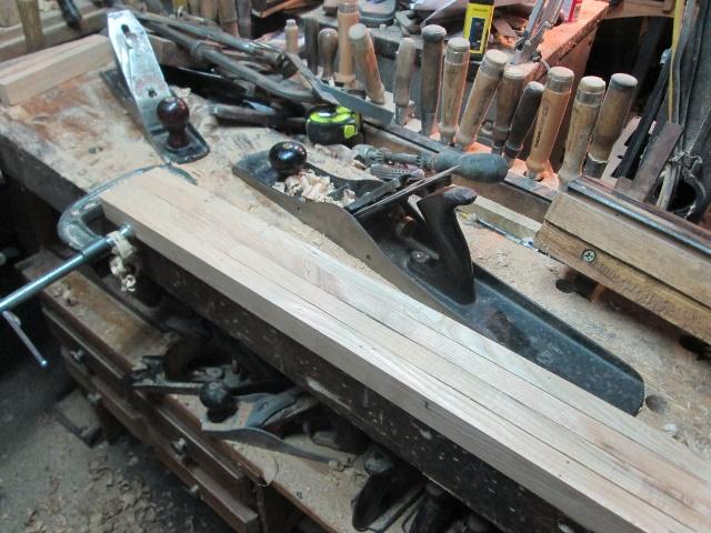

Had hauled the 80" long 1 x 6 to the shop...needed two pieces...3/4" x 2" x 39" long...rough cut for the 39...looked the board over...I could saw the two 2" parts out, and leave the strip with all the knots.    Even drilled two holes, through the knots..and fixed the board to the bench top with a couple screws...Rip one part, shift things over, rip the other part..toss the bad part..usual wavy cuts...clamped both into the leg vise..

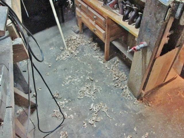

Yes, there IS indeed a use for a tool well....used a few planes, to level the edges straight..
The two smaller planes knocked down the high spots...the No.7c worked the entire length.

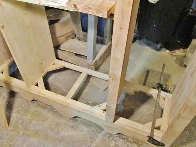

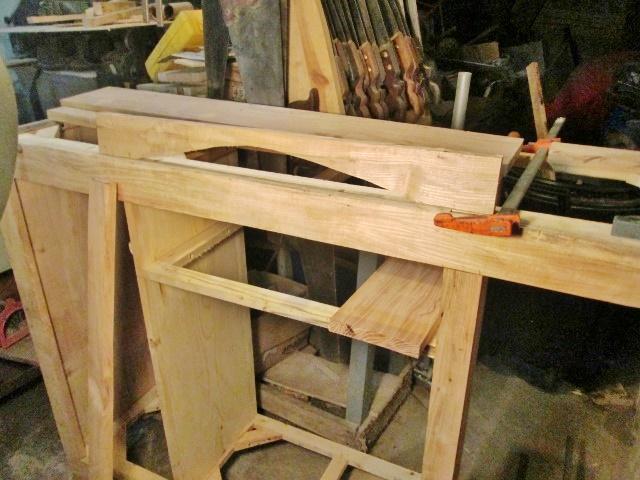

The two middle rails..go ahead and install them....with just the rail under the drawer opening.    One for the fixed shelf will get installed once the insert is installed..
Will build the drawer.   Need the two rails beside it installed, with the cross rail below the drawer.  Then I can start on the two doors....may go ahead and glue up the top of the case...what ever kills 10 days of waiting.    Boss needed to go shopping, I needed a new glue bottle, old one is about empty.

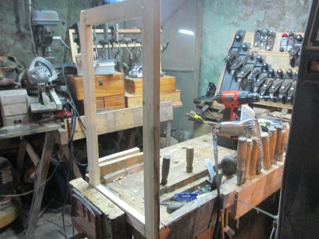

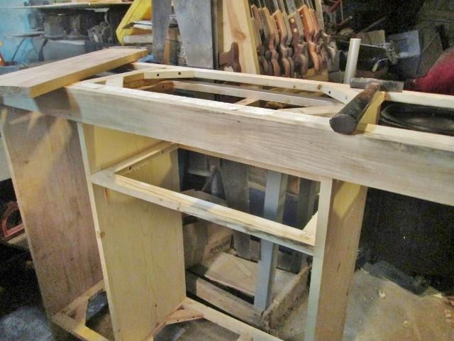

Right side, corners tuned up, and that rail added...had to cut the bottom of the rail/stile to match that curved area.  Left side?
Got the outside corners tuned up...still have to work on the vertical  one...board with that curve sawn in it?
Will go along the bottom edge of the drawer opening...made a mess tonight..
Long handle is a coarse rasp, used to flatten the joints.   Fancy plane is NOT sitting on metal ring...iron is sitting on the wood part of the handle. Floor was a mess, too.
These open areas will get a thin plywood "skin" to close them up...glued in place.   I'm going to need a LOT of clamps, before too much longer...

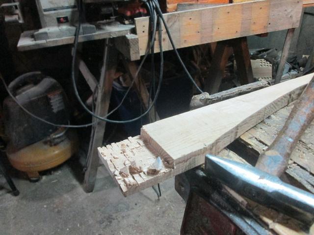

Remembered that the more cuts I make..the easier it is to remove the waste..cuts were with another "vintage saw"
Depth of cut was set as needed.  All those cuts, made a hammer's job easier..
Smack them until they crack.  Then those items got put to work..

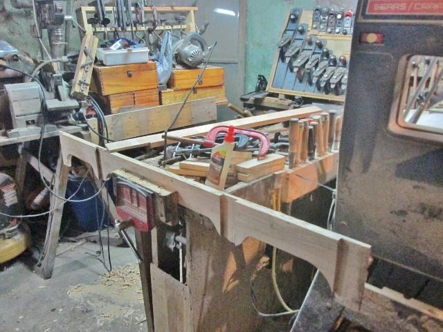

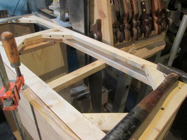

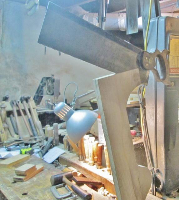

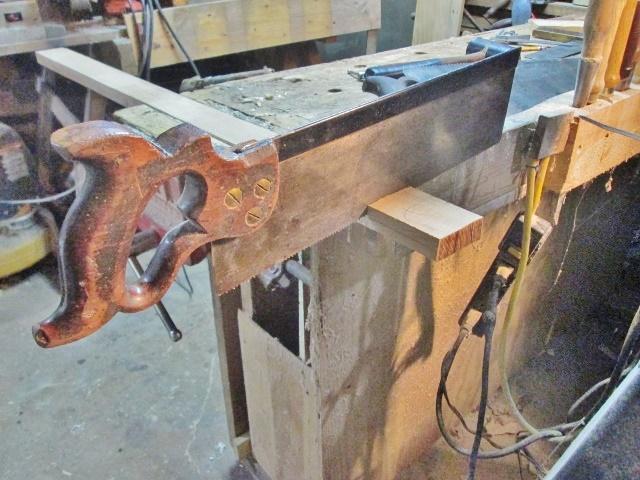

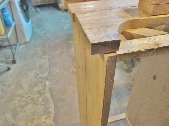

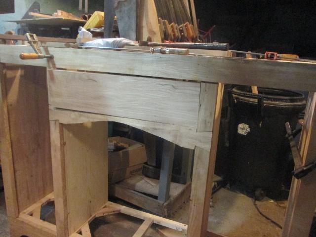

Well, before a walk-about today....decided I would use a dovetail joint, instead of the lap joint...so..
Simple matter to mark the angle, and cut the waste off...do this for both ends.   Take this part to the frame, clamp it in place long enough to make a few marks..
Hmm, can't use the Skil saw..so..
Back to Olde School.   Lots of cuts, wax on the saw teeth...then remove the waste as before..
Test fit a few times, until the fit was flush.   repeat for the other end....then test fit the whole mess, again..
Hope I have enough clamps....will glue and clamp the face frame as a unit...later will use counterbored screws and a dab of glue, to attach the frame in place.   need to get a drawer started, too...

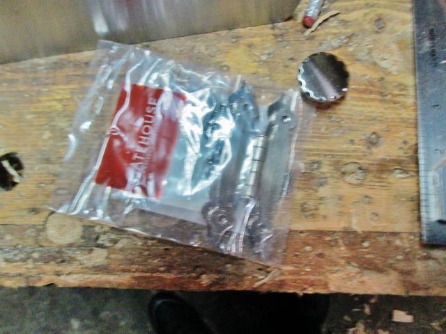

Since the Boss picked out the Knobs (3) and the hinges (6)...
One for each door and drawer...three surface mount hinges per door.
Should be a high level of cussing, tomorrow.....will try the glue up.   Stay tuned...
Really like the dovetail feature on the drawer opening apron. Great touch.

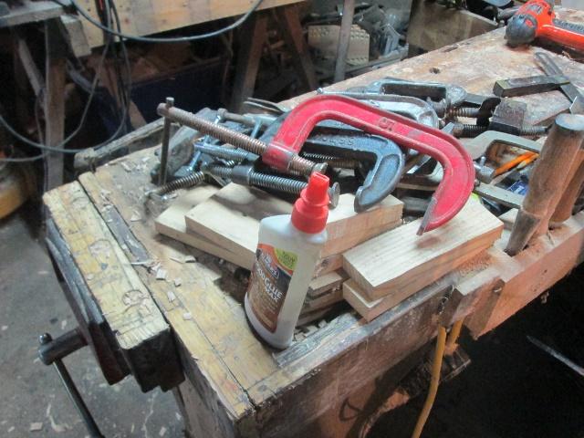

Cussing level in the shop, and at this computer are about at the same level...about the same as Gene heard on the first day of Basic....:o

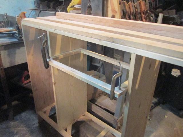

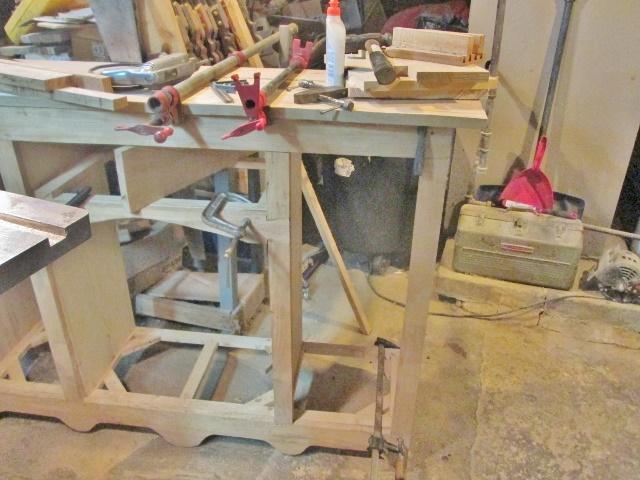

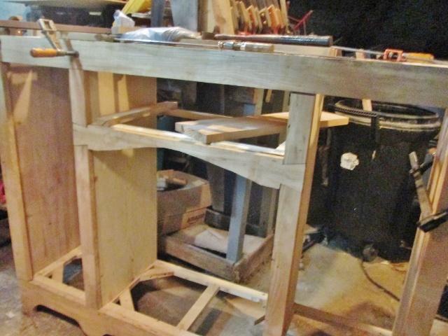

Clamps were piled up..
Cauls were made..

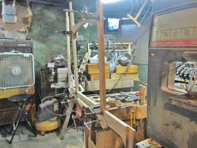

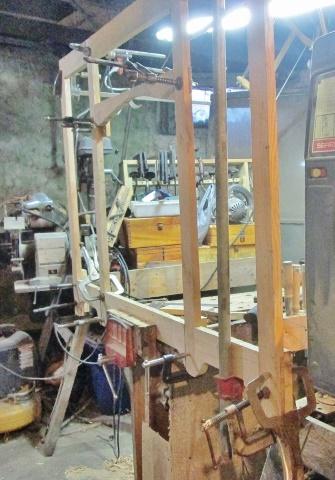

First item...had to remember that I am working from the inside...
Had to turn this one around.  Wanted to see what I was doing...got a few parts installed..
Getting low on clamps, already
Squares and a hammer were needed....Had a bit of trouble fitting the top rail...extra clamps to pull things to where they needed to go..
Pipe clamp, and about half of my "F" style clamps, because..

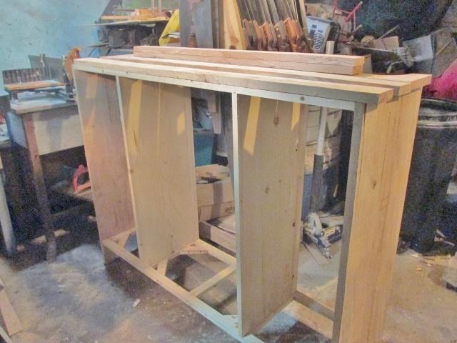

All of these are gone.  Cleared a spot on top of the case, and hauled the planks for the top, and plunked them there..
A bit too long?  Both had issues with knots..
Hmm, yeah...You can see the other one from here....I do have a third plank..it has other issues..
Besides being too long..
On the "good" end..there was a knot...Another plank had a bit of snipe...both will be heading to the burn pile..

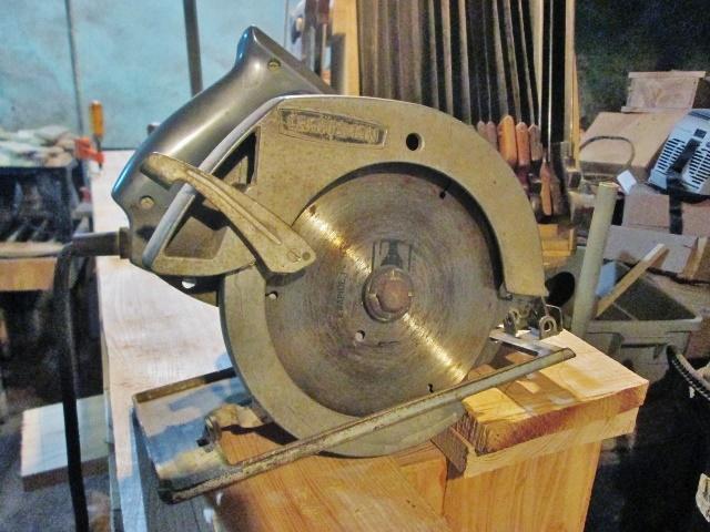

Need to haul an e-cord to the shop,and run the circular saw around.   NO, I am NOT going to hand rip 5' of Ash! may not even do the crosscuts.

Can't get to the SKIL 6" saw..
Frame kind of cuts off access to that area..for now.   ( all this work today was done on just 3 hours of sleep)
Well, this Vintage saw was upstairs,,,and has a 10' cord!   Craftsman 7-1/4", with a Irwin  rip blade...might come in handy?
Set up a "saw bench affair", even did one rip cut, just had to move the clamps a bit.   Crosscuts were also done..
And the scraps.   Which will be heading for that big black tub thing back there..even clamped the blank for the drawer front, and crosscut it..

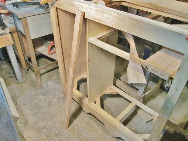

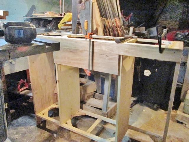

Has 6 hours of sleep last night...still wasn't enough...waiting on the heart monitor batteries to charge up....
has two work sessions today, with the Boss's errands inbetween ...got the frame out of the clamps...and set in place..
At this end, anyway, I clamped it into place...Found the 3/8" forstner bit  I bought a while back..
Then come back with a pilot hole bit, and add a bunch of screws.   Had one board I could rip a few stiles from, along with one I already had....just under 1-1/2" wide.
Stacked all four stiles together,,and trimmed to rough length...
Length was a hair long, can fine tune that later.    Problem here?   was these were tapered...one end was wider than the other....and the edges were wavy...
wavy we can work on..

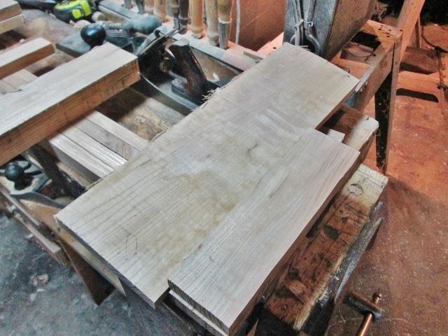

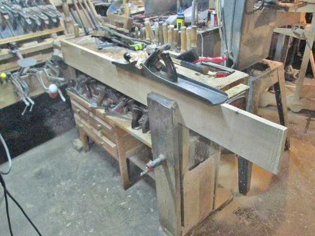

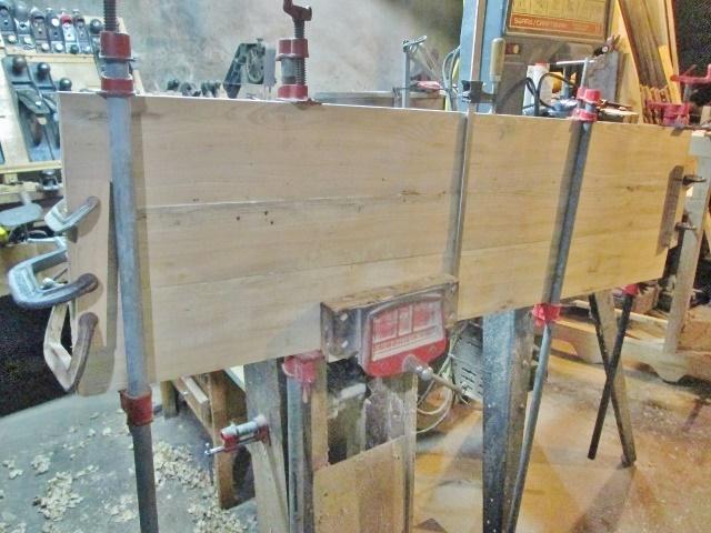

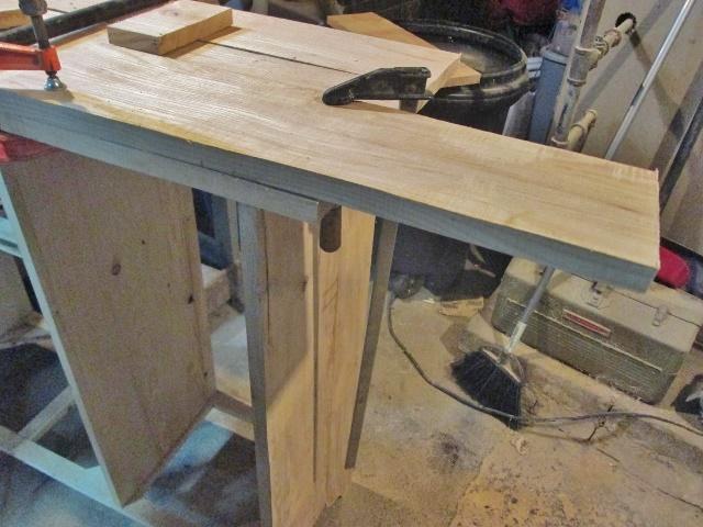

That be the Stanley No. 8..taking on 5' of Ash.  Trying to joint enough edges  for a glue up..
2 down..1 to go...had a few spots where a slightly smaller plane was used..
Like where the ends curved up...or down.   Finally got all three boards into the clamps..
Glue and cauls, too.  Doubled up the cauls on the other end..
Always have a use for scraps....right now, I can't even sweep the floor..
This top is HUGE...compared to my shop..
