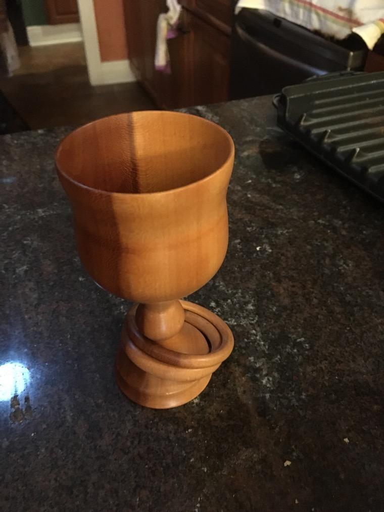

Gerald also showed us a captive ring goblet he just completed. Captive rings are are fun to make but a pain to sand!
3D0A7F3D-66F8-4DFC-9F36-6E893A4A8158.jpeg.bafb3398289b6b80bbcb8ff8bbcc3e8c.jpeg.f244afdd6a6d8604faf278d5134f9241.jpeg
Gerald describes his turning-

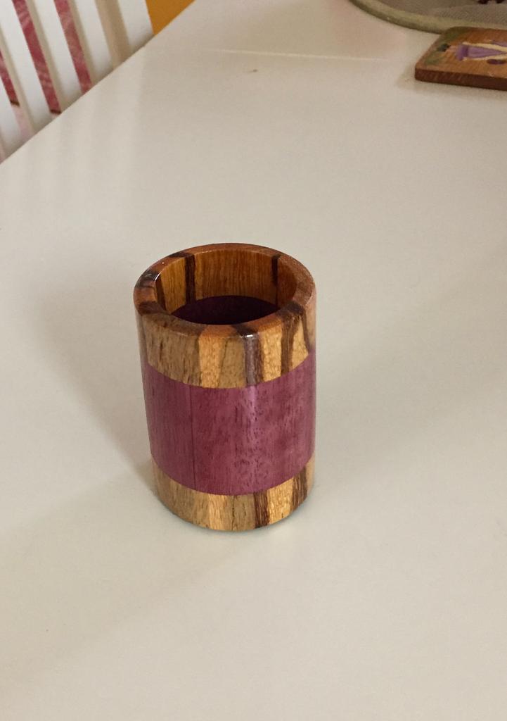

@Ron Altier turned a small vase/box to hold his wife's knitting needles. Ron really makes use of exotic wood when he creates a project.
fullsizeoutput_8e7.jpeg.73318e54dc60cbdfb52a8d7911ff9c5a.jpeg.a3a625fb38d86fdbbfb1a05aa65a7e08.jpeg
Check out Ron's post-

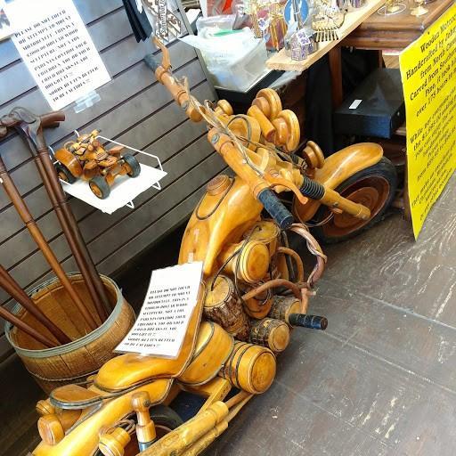

@DuckSoup was on a road trip and saw this in a shop-
804807333_hardtail.jpg.58c6ade6f17252a302cbfc575ac75800(1).jpg.da46fa17e3e2ea66e672d0b9b0e3eb5b.jpg
Now that's a lathe project!!

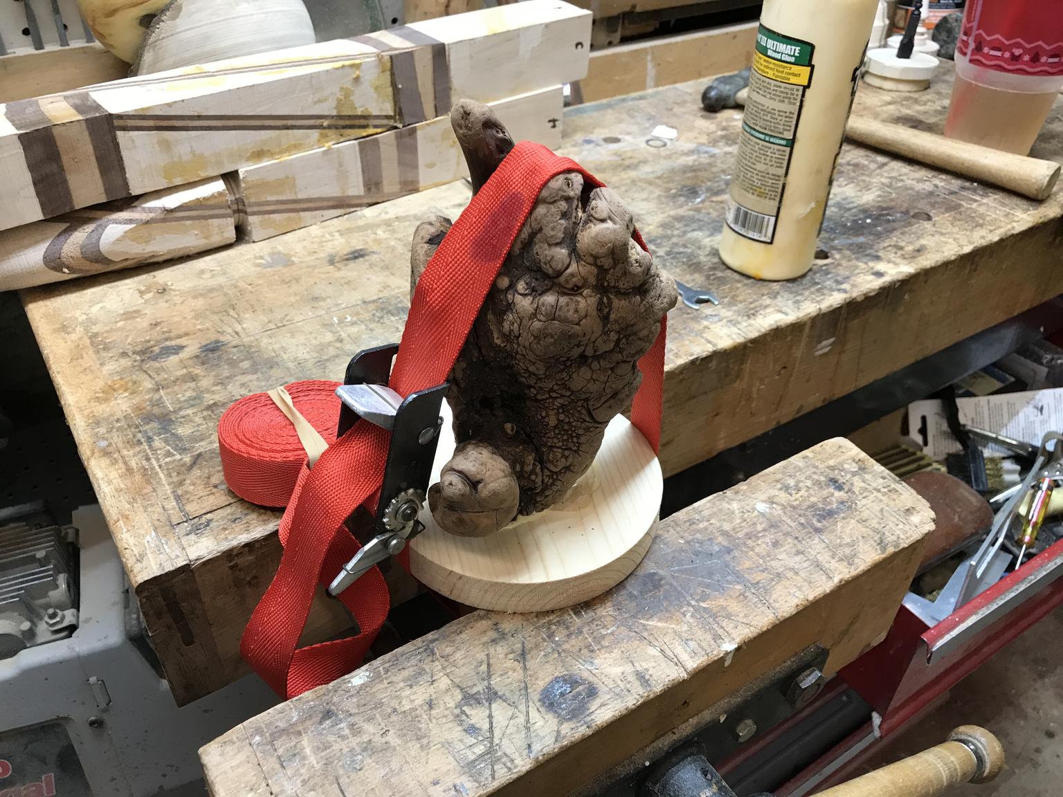

I've had this idea for making a turning using casting resin and manzanita. It started out OK but I think it may be a colossal failure.
The root mounted on a sacrificial block-

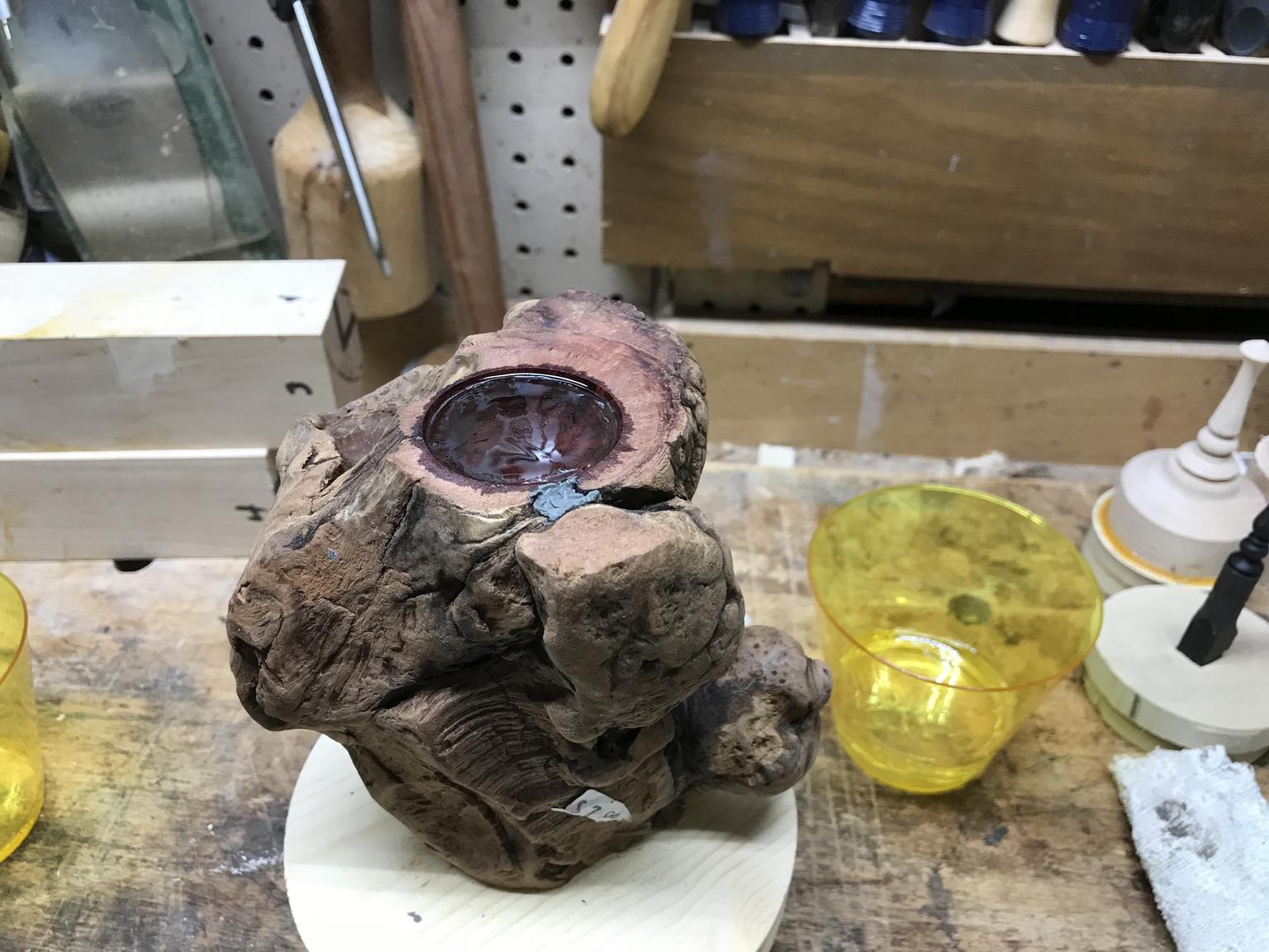

The end flattened and hollowed about an inch and filled with Alumilite-

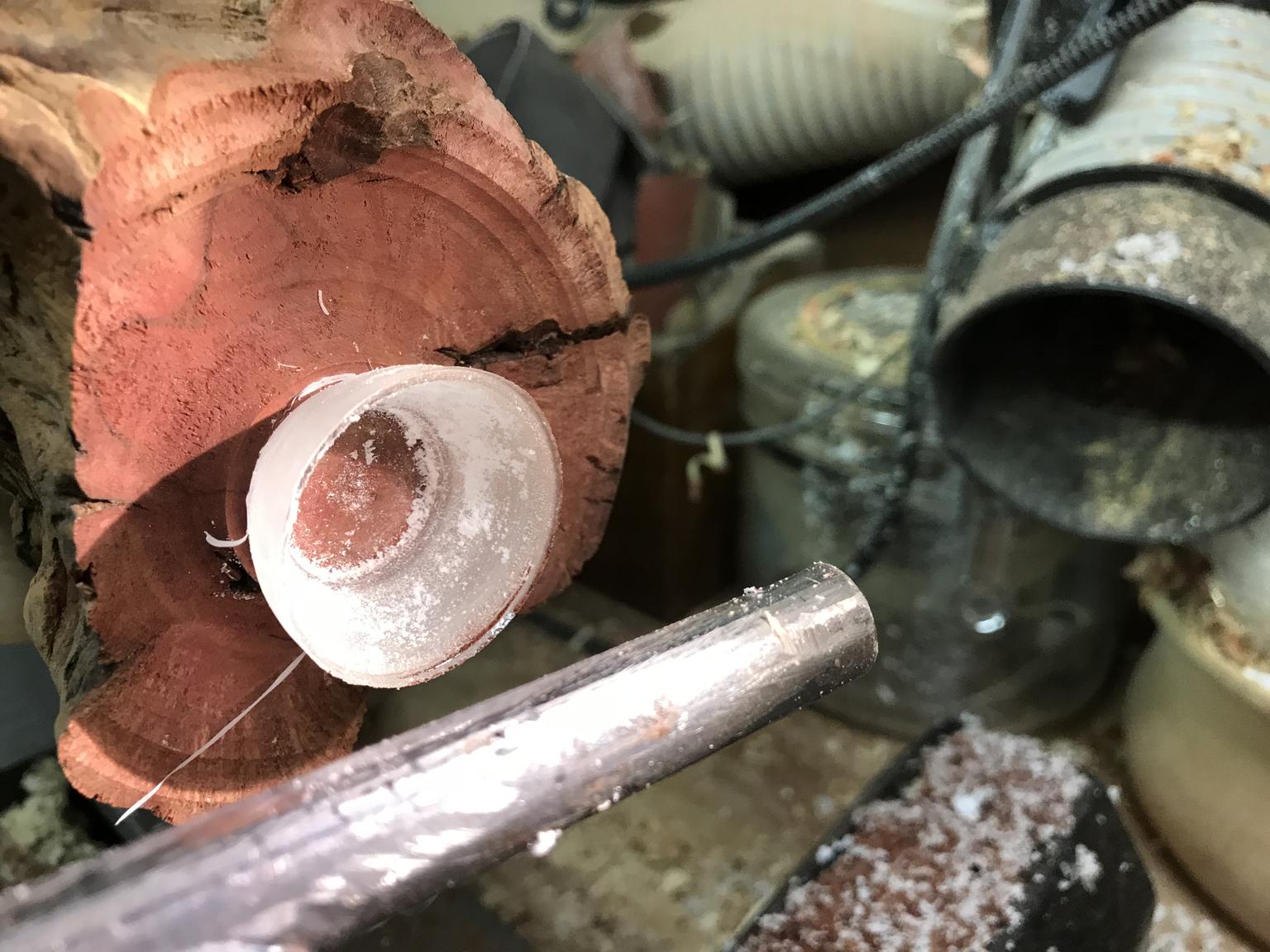

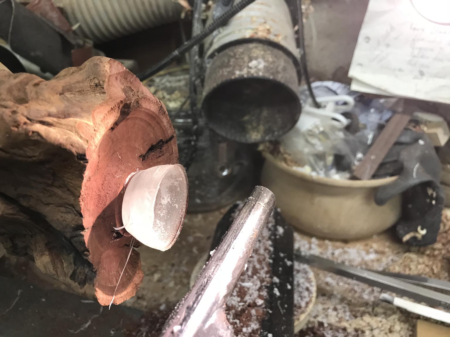

The root turned away to expose the resin and the resin hollowed to form what I envisioned to be the top of a wine glass. Unfortunately the shape isn't very pleasing.
When I began sanding the resin, which is a little over 1/16" thick, the heat from the friction is softening the casting. I can only sand for a few seconds at a time and then wait for it to cool. I have tried using a canned air duster, held upside down, to cool the resin. That works but I really don't think I'm going to be able to get the resin "glass clear". Maybe this will end up being a lidded box. Oh, Well.

That could be a frosted glass.

Re: the resin project.  I have used Meguiars to good effect on both clear and colored inlays, in flat work, after final sanding. As it is liquid, it might serve to reduce the friction induced heat.
