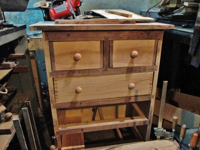

Drawer #4 has it's dovetail "covers" on....and then knobs.    Errands to run.....came back and worked on cleaning up Drawer#2
Which left Drawer #3 to do,,,
Used this to saw out the waste...came from both directions.....chisels to clean up.  And a rasp.  and a slick...Got the walnut covers glued on...tacked them in place with a few brads...and stash the drawer of of the way...

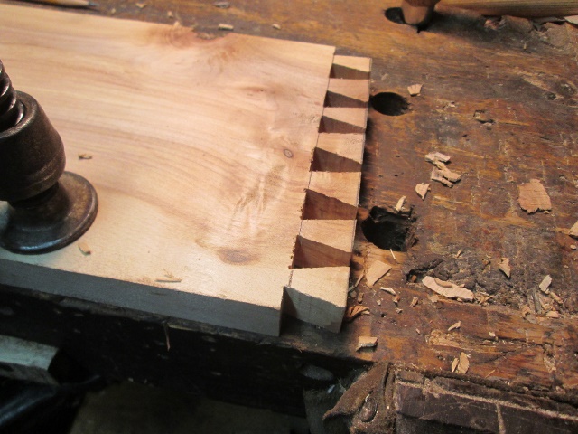

yeah, welcome to my world.   Drawer front is in the vise.  laid out the pins, and did a bit of saw work..
Helps when I rub a candle on the saw's plate...  once this end was cut ( but not chopped, yet) I laid out the pins to match at the other end..
I'd set that square from the edge to the first saw kerf, and then make a mark down on this end.   Kept going until I had them all marked out.  Make a knife-wall, using a bigger square ( that didn't move)
Then got out the Usual Suspects..
See anything you know?  I chop down half way, then flip the board over, and finish the chops..then turn the board end for end, and repeat..
Next, I stood this up on a drawer side, making sure I had things aligned the correct way..top-top, in-in, so forth....A SHARP pencil to mark out the pin's locations, then that square and knife thing.   Then, over to the bandsaw, again
I try to cut on the waste sides of the lines...and a little extra cut or two...the less I have to chop in there, the better....

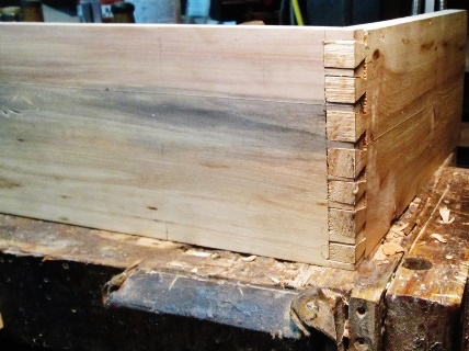

Just like the pins, I chop 1/2 way in from each face.   Don't need any blowouts.   Dry fit, first corner?
Needs a bit of tuning.....I didn't drive it all the way in, either.   Dry fitted the second corner..
Dry fit 1 on top, dry fit 2 holding things up.   Nothing else is holding this up there, but how tight the dovetails fit.

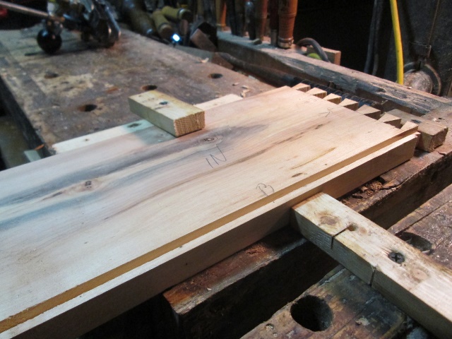

Rigged up a jig to hold the front and the sides...
Grooved the front..
Time to get out The Box...
All kinds of goodies in there....Needed that wide #18-1/2 cutter.   Traded out the #12 for it.....
Screwdriver points  to a spur I had to rotate down ( PITA)  had to do both sides' spurs.
This is now a dado plane, instead of a plough plane...Moved to jig around, need to hold the sides still long enough to cut a dado..
Added a screw down at the tails.   I can tighten the vise as needed.
Now, to get this far, a couple things need to happen.    I drag the 45 backwards a few times, to let the spurs work....meh...follow that up with the backsaw to cut the exit a bit deeper, to prevent blowouts.   had the cutter a hair deep reset nd finish the cuts..
