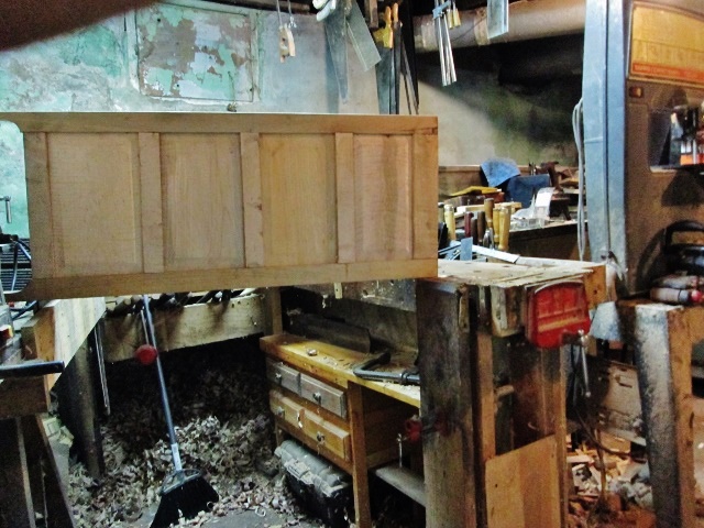

The other 4 panels have been "raised"
basically the same as the others were done.   Bench is now cleaned up..

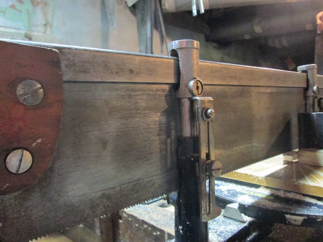

My "spare" MitreBox...Needed a few 8' pine 1 x 2s cut down....not much room to the left of the saw...first cuts were @ 24"
Set these aside for a while( got yelled at, because I set them on the washing machine:o !) Long parts needed a helping hand
Made a LOT of saw dust, today:rolleyes:  Set up the saw stop....and cut the 11-1/4" long parts..

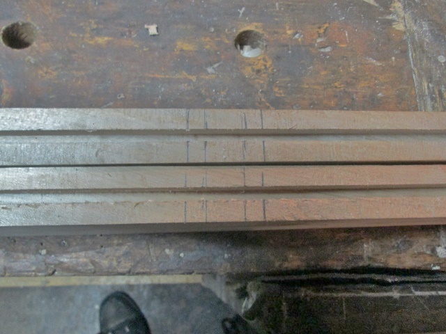

Reset and cut the kickers, as well.    Set up the re-saw jig on the bandsaw, and reset the mitre box...
The metal one that came with the mitre box was about an inch too short.  This sets the 1/2" length of the tenons..
That bracket adjusts to set the depth of the cut...a bit fussy..but works.    I even used this set up for the wider board..

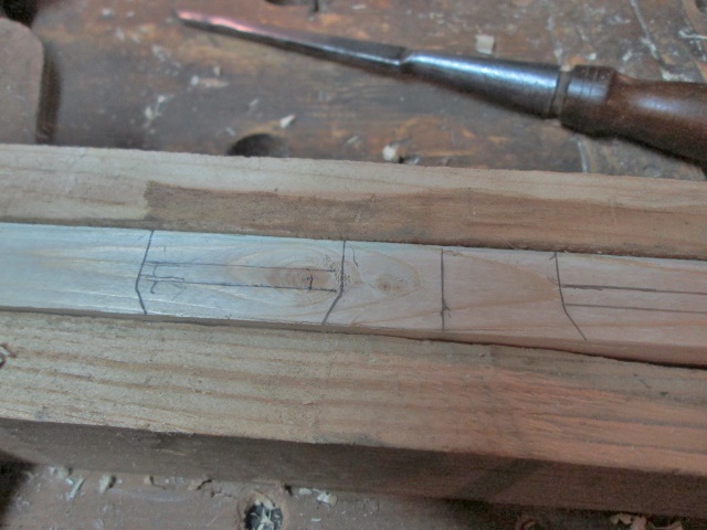

It has a double tenon...and we have a knot..figures.   well, we have ways..
Hmm, what knot?   I chopped my way back to the knot, then it popped out better.   Dry fit?

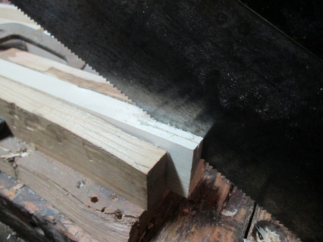

Saw  work...
This is the angle used, to make the cut..
To cut the sides of the mortise.  Then a bit of work with the chisel..

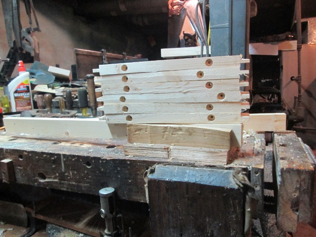

Counter-bores, then a drill bit to make the pilot holes.  Rather do these now, than try it went things are all glued up.   All I needed was two holes per rails.   Allowed a space for the drill to get in and drive some screws...
I have had to trim just under an 1/8" off the ends of these kickers....must have cut on the wrong side of the lines...Oh well.:rolleyes:

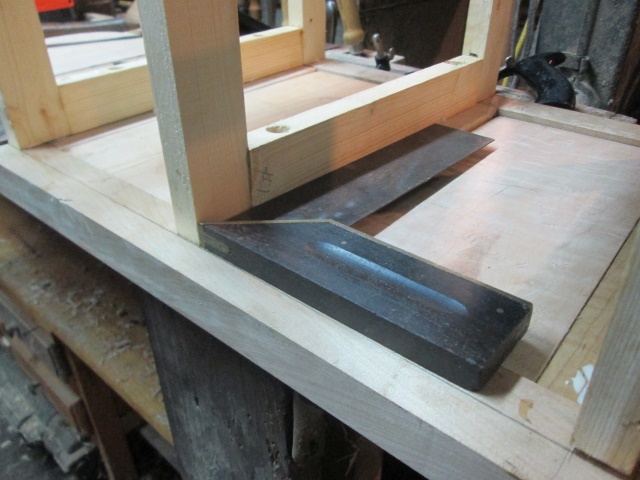

Squares to make sure things go in square to the sides..
When I flipped this over onto the other side...not everything lined up.....clamps to pull tings back, cussing, a shim for the top frame..cussing....squares everywhere...cussing...finally got all the frames to where they needed to be....and then set this mess down on it's own four feet..
Had to glue and screw a shim at one end of the top frame ( compost happens:rolleyes:)
