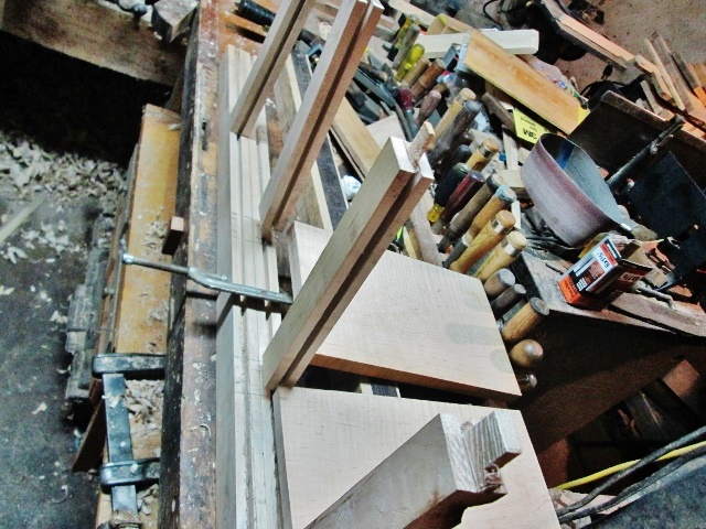

Test fit a couple of them...as I had two mortises done....the rest will just have to wait awhile..
Yep, there are five rails....kept sweeping the floor..

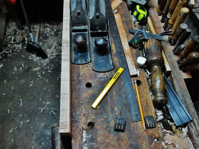

Just a tad wavy....( called a Tinner's Rule..) Marked a line along the straight edge..
This might take awhile....wonder which plane to use....
One on the left is an 0-7....the other?  Stanley No. 8......I think I may use the smaller one..
And save that 10 pounder for another time....like when my thumb is healed up...

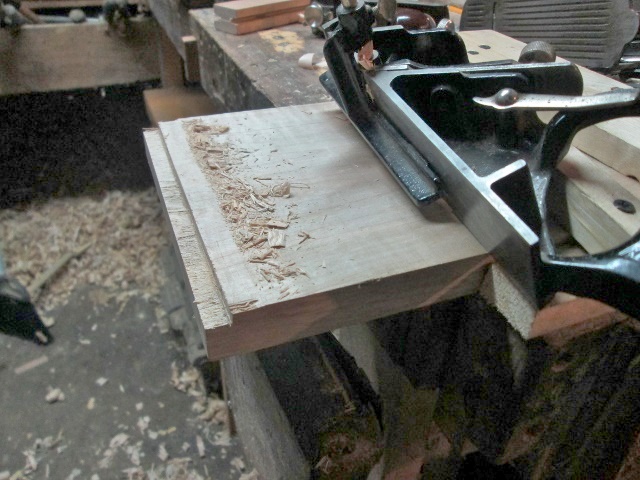

Gaining on it.   Then came the Stanley 45..

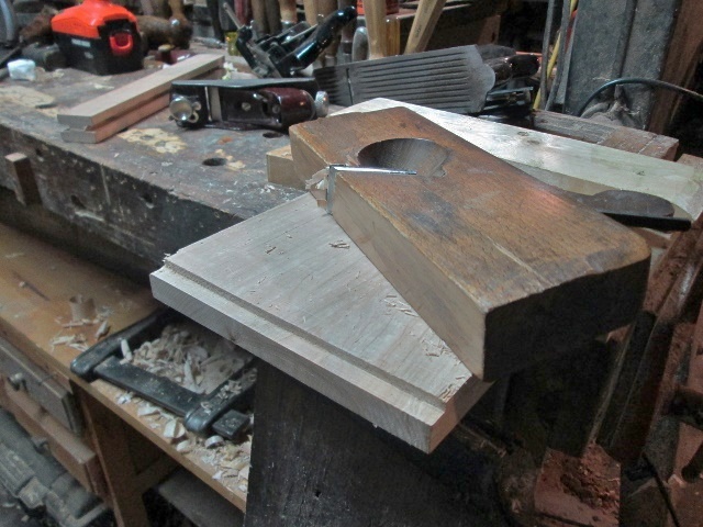

The "bad edge" of the groove?   Had this pointing the other way, going against the grain ( Dummy..) and a chip got between the part and the fence...turned it around, kept an eye out for wayward chips...

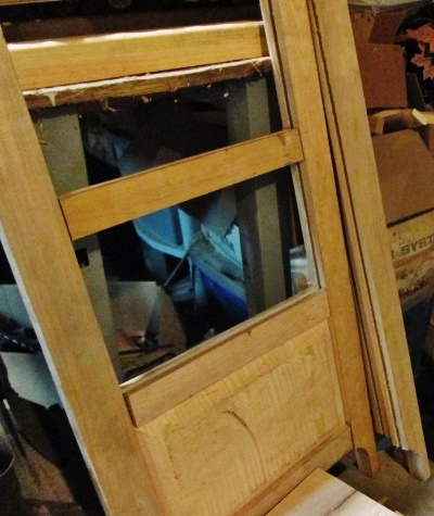

Here is where things got...complicated.  Remember that part called "Spare"?    It no longer is a spare part.   One of the "good" parts came out too short.  Ran the Stanley 45 a bit...made a few tenons..rails have all been S4S to match the stiles.   Decided to stop with these, and set up for the stiles..
Need to joint the edges to a line..
Or two.  Get this done, I can mill the grooves, shape the feet.   then set up for mortises.   Maybe after Lunch?

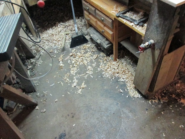

Had to sweep the floor,
This was before I raised the fan up to where it would do some good...
Wound up using that broom about 5 times....got tired of shavings crunching underfoot.
