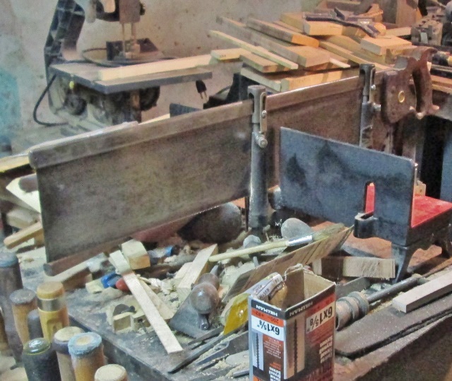

Well, I did get bored...nothing else to do but try a few things....as noted above, I gave this old saw a workout..saw.jpg.915a2c54693b31987b1491fc02595727.jpg
Made a few parts as well..between the bandsaw and circular saw...
Rather a rough looking bunch?   Was just going to let these set......and yet...
IF I keep the planes on the small side, and do a lot of the leveling work with the beltsander...59769af78db8c_visework.jpg.a622859df5be1b1f98cb9b7e8686e439.jpg
And clamp the parts in the vise like this....I could even plane Left-handed.

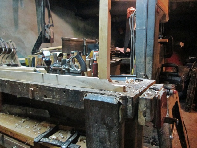

Set up to joint the corner posts...at least one, anyway.  Pound the part into that hook thingy, called a crochet, and lock into the leg vise..
Afraid my Jointer is a "cordless" model....No. 0-7....made decent enough shavings, though..
Again, thumb sticking straight out to the side, keeping it out of the way.   Got both edges jointed...thought I'd try this out..
Had to adjust the fence a hair...to get it more in the center.   There was a problem or two, though...597783a50c5d6_crochetbump.jpg.a88a18976d4a854bcf3f605f35d1b112.jpg
At the far end, I hit the crochet....at the other end..
I hit the jaw of the leg vise.....may have to make this groove in stages....

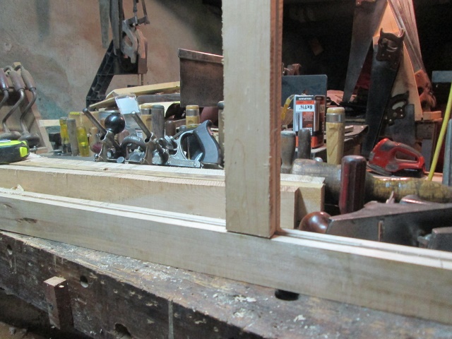

Kept going on a few parts....got the groove in the corner post finished.
And laid out where the 5 rails will go.   Top rail is an inch wide than the other four.....Laid out according to the widths of the two planks I will be using for panels.  And marked a 3/8"  deep groove..
Once they were all laid out, I could add a "foot" detail..
Bandsawn, and beltsanded to shape.  Decided to do a little digging....
To see how a mortise will go...
1" deep, so...I cut a tenon on the spare rail..
And a trial fit..
Could be better...will serve as a pattern for the rest...
