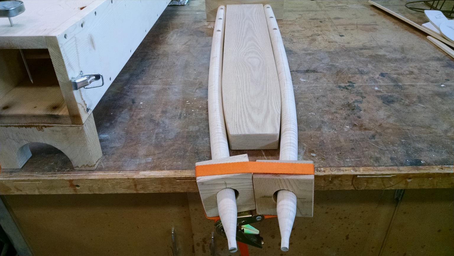

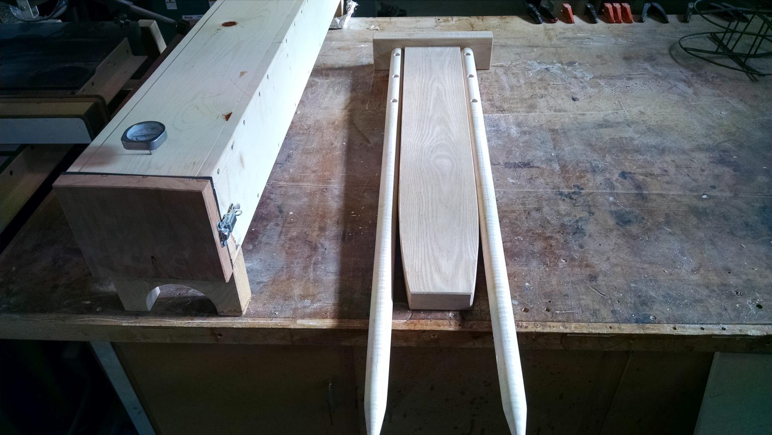

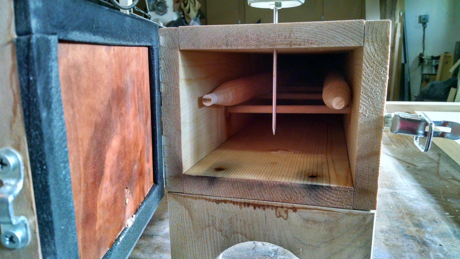

Today I have two back legs heading to the steamer. In just a few minutes they'll be ready to set inside.
Dry fit the legs into the forms, just for a good visual before it's committed.
In they go, for about an hour and a half.
I'll take it! A successful bend.
That's just pretty darned clever. Do you expect any spring back?
We'll see Gene, the Cherry rocker I did have a little bit on one post only, the other post held it's form pretty good. It's going to happen, from what I am learning through doing, studying and reading, it's not a science, every one will be different. But just because one part that is supposed to be the same as the next, isn't, does not mean it's trashed. It's very usable.
I love making these chairs, my experience up until a few years ago consisted of precise machined projects, cabinetry, router shaping, if I couldn't turn a switch on to make it happen, I did not touch it. The chairs have taught me that it's ok to be imperfect, I am finding a ton of beauty in a non-perfect project. And a slightly out of shape post in a chair, makes it all that much more wonderful.
When I pop the maple posts from this form, I'll report back with a more accurate summary of how much they sprang back if any. I'll remove them next Friday.

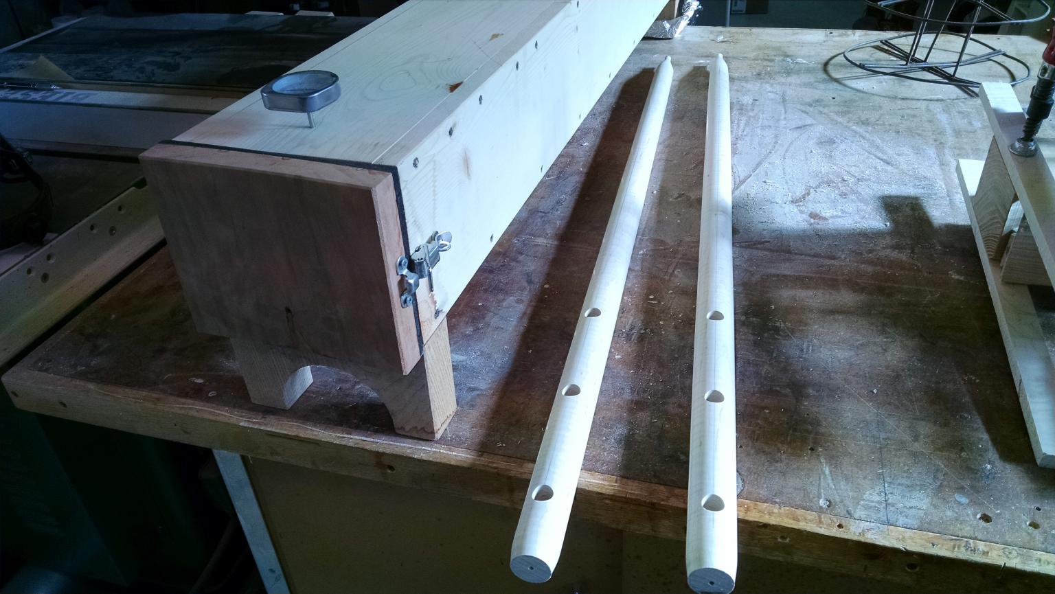

John, did I notice one of the legs already has a wedge slot at the bottom/top?
Couldn't agree more about small imperfections. Adds charm to be celebrated. At least, that's my story and, I'm sticking to it.
No wedges or slots yet Gene. It maybe blade burn that your seeing from when I cut the end off from the lathe.

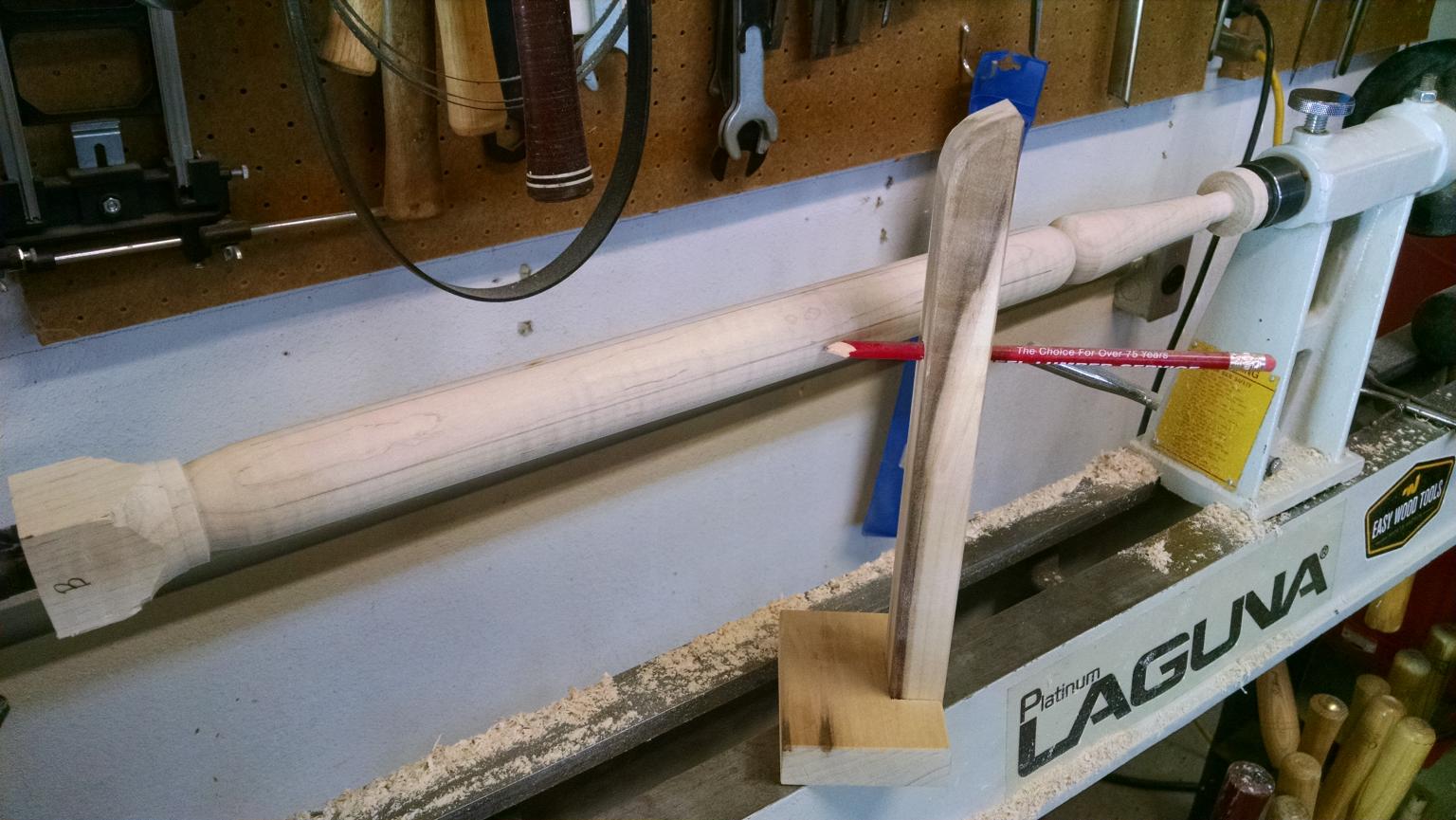

Front spindle/leg  is turned and I am laying out mortise lines for the rungs. I use a handy pencil holder that is set at the the same height as the lathe center. I can mark parallel lines on a spindle.
