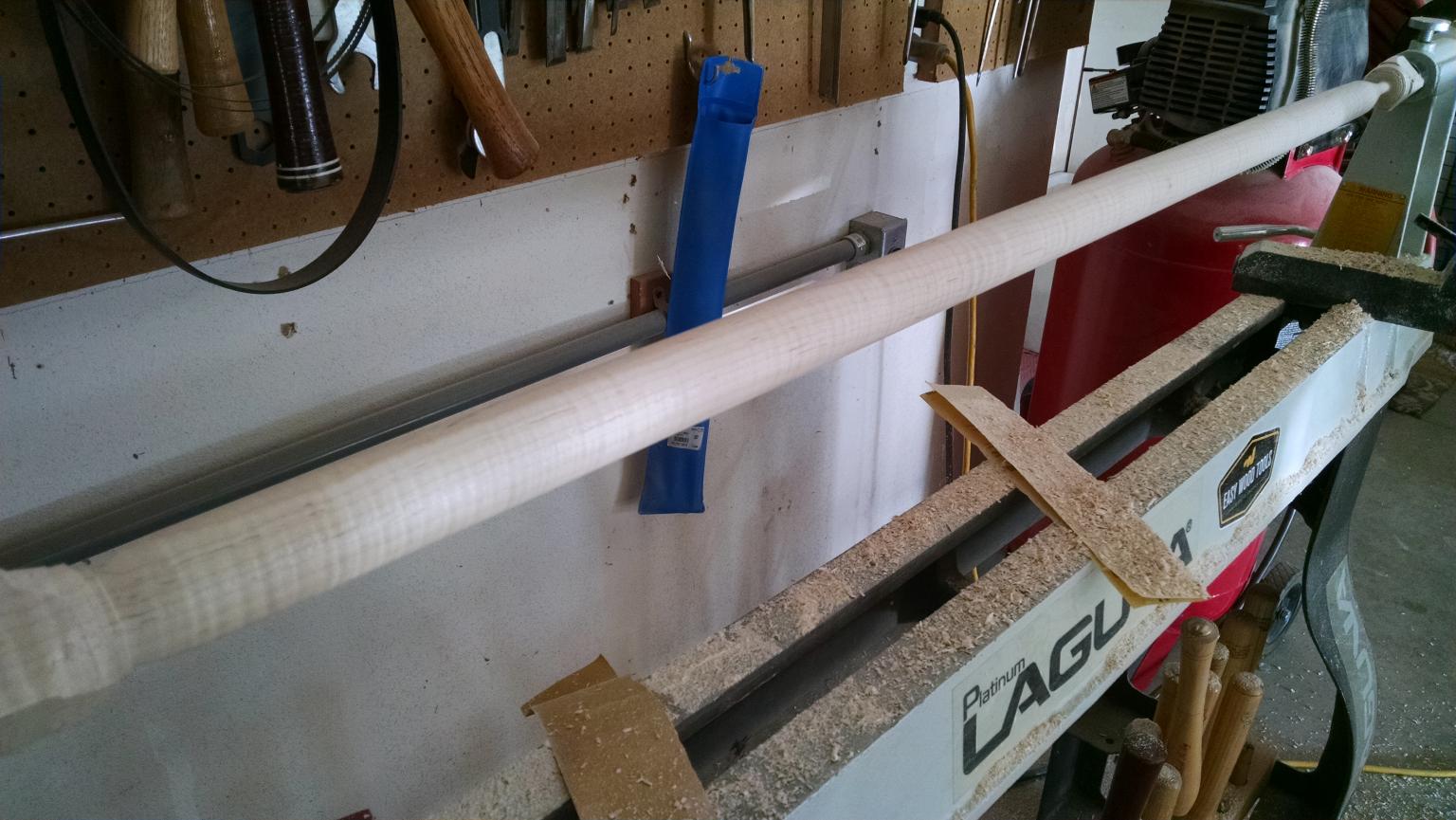

Legs are cut and squared.

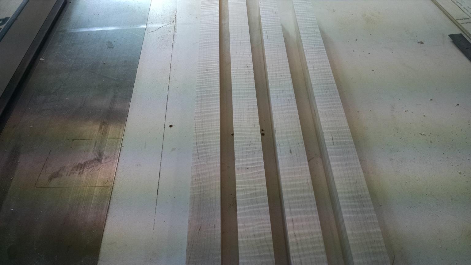

    Thanks for the kudos gents! This morning I have parts roughed out, and ready for planing and smoothing and turning. I book matched the rockers, arms and back slats. The chair rungs are

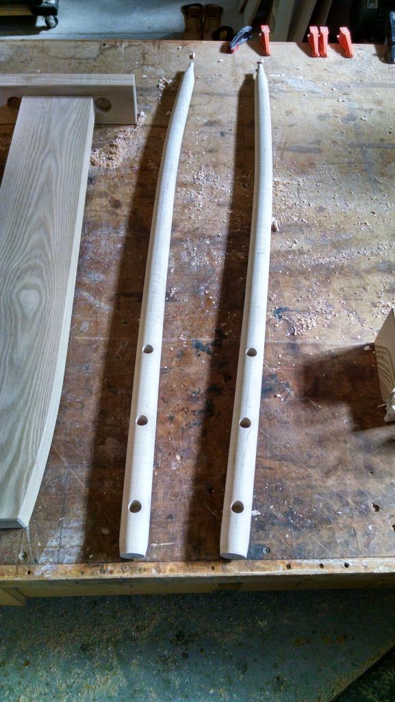

    Just got the back slats out of the steam box and into their forms. Here they'll set for a week or more.

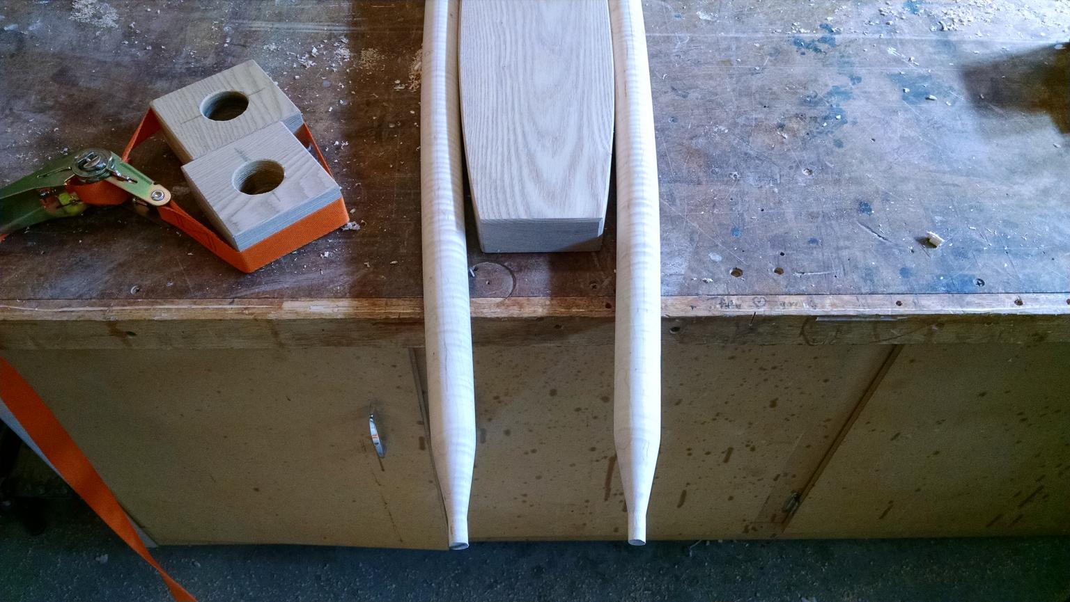

    Today I have two back legs heading to the steamer. In just a few minutes they'll be ready to set inside. Dry fit the legs into the forms, just for a good visual before it's committed.

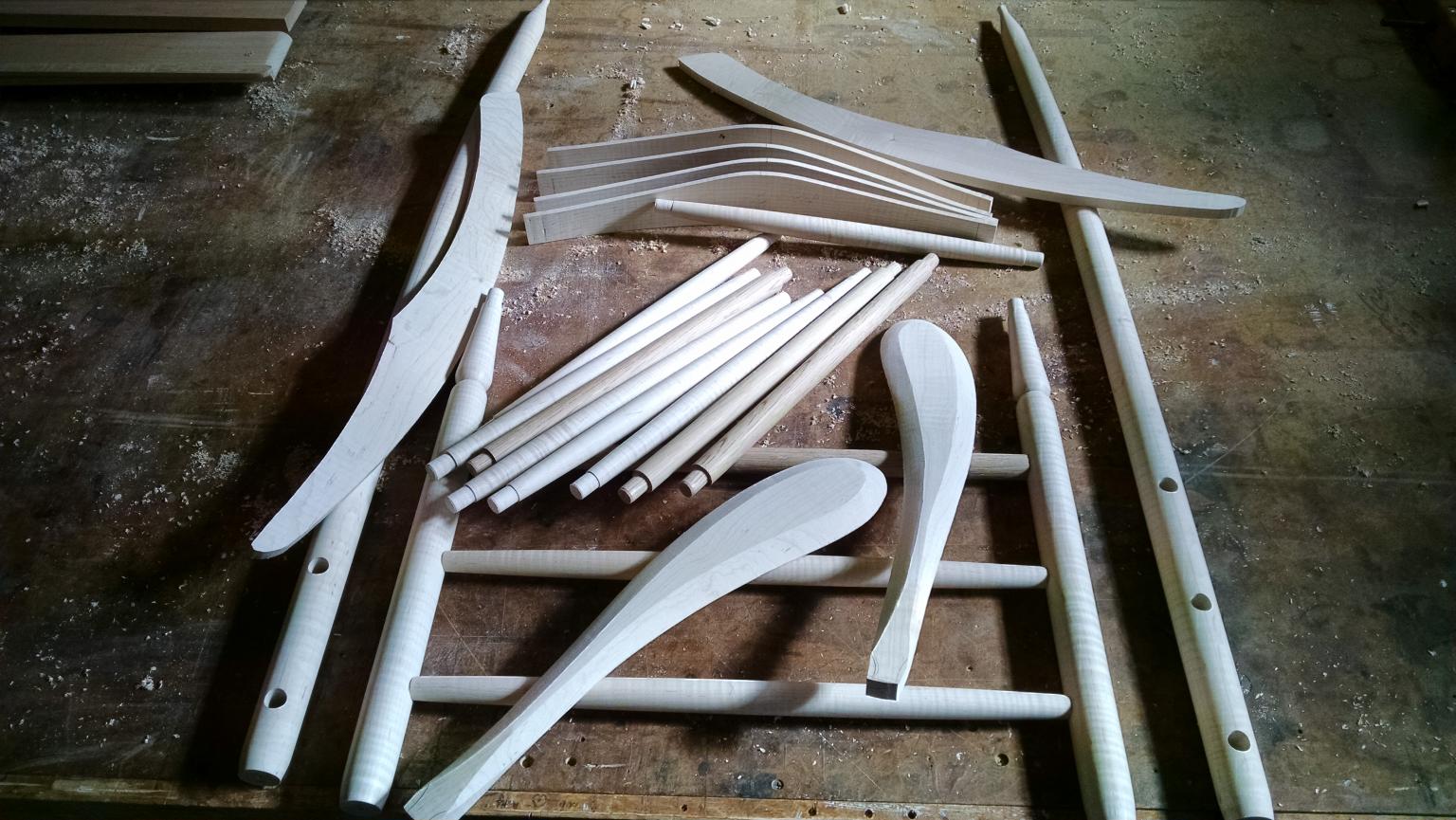

The chair rungs are in the middle below the back slats, the legs are laying on the sides.

Herb, I started with a 8/4 x 96" by 9.5" board, and I cut all the parts from it. I have a length about 2 feet left. I am going to try to get a matching foot stool from that section.
The seat is weaved fabric tape, no wood is used in the seat.

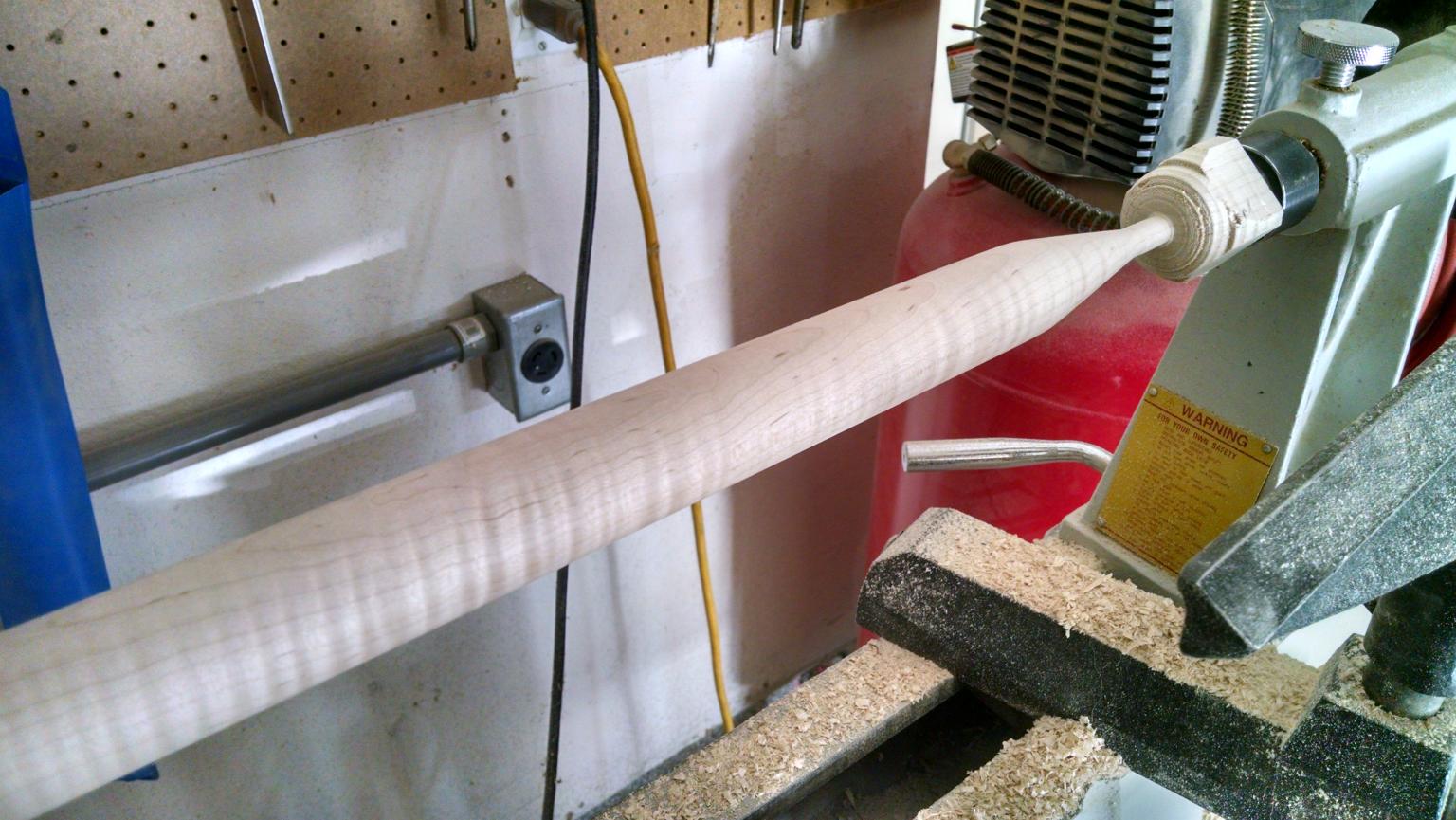

One rear leg has been turned. A slight taper overall with a 3/8" tenon for the cushion rail at the top. I sanded to 320 and a shaving burnish.
Thanks for following!

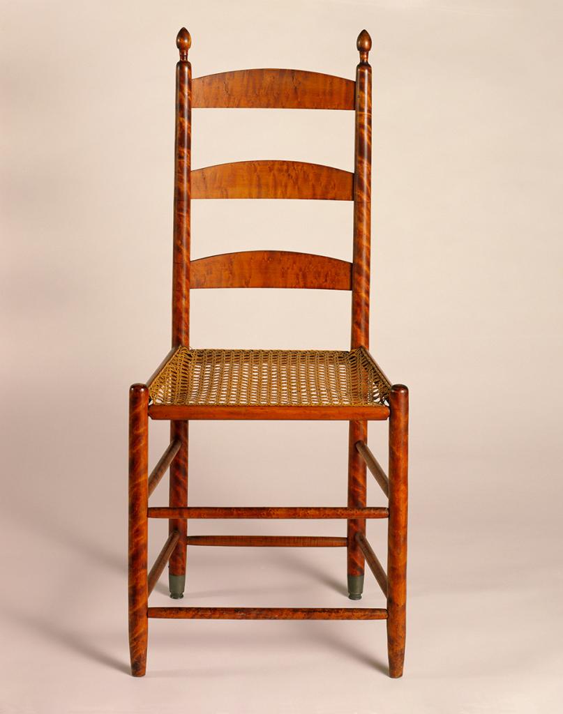

You know, they did have access to some beautiful figured maple Dave, actually more so than we do today, I have seen original chairs with gorgeous figure, here is a chair at the New Lebanon Museum in New York. This chair was built in the 1850's.
Here is the link to the furniture gallery for the New Lebanon Museum: https://shakerml.org/blogs/furniture
