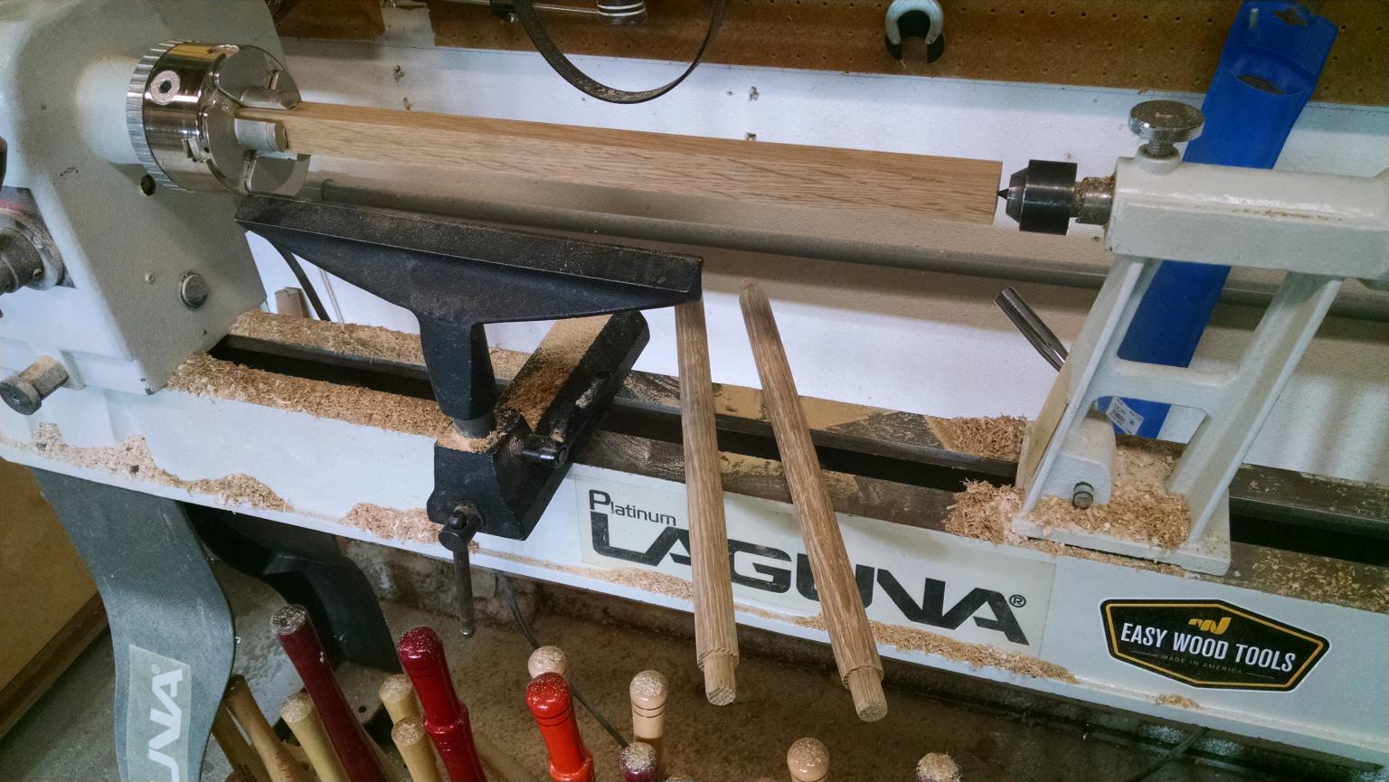

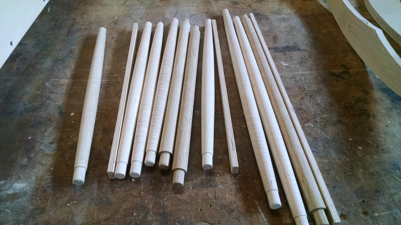

Turning Ash seat rungs for this rocker. I read more on the fabrication of the Shaker chairs, they would often mix species for both aesthetic and structural reasons. Ash was a secondary species used for its strength, so trying to stay true to the Shaker, I'm making the seat rungs from Ash.
I also have all my Maple rungs turned.
I should have a fully assembled rocker frame by week end. Thanks for following!
Those are some nice looking spindles

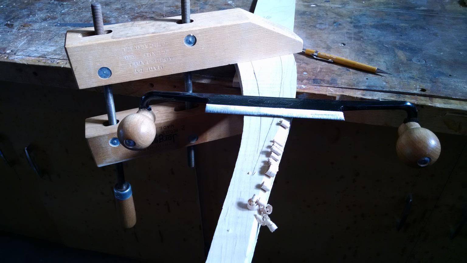

While waiting for glue to dry on the front legs rack, I'll shape arms. I purchased this wonderful French Arno draw knife a while back, finally I get to use it, so far I love it!
You would make the Shakers proud John. Looking great!
Thanks man!

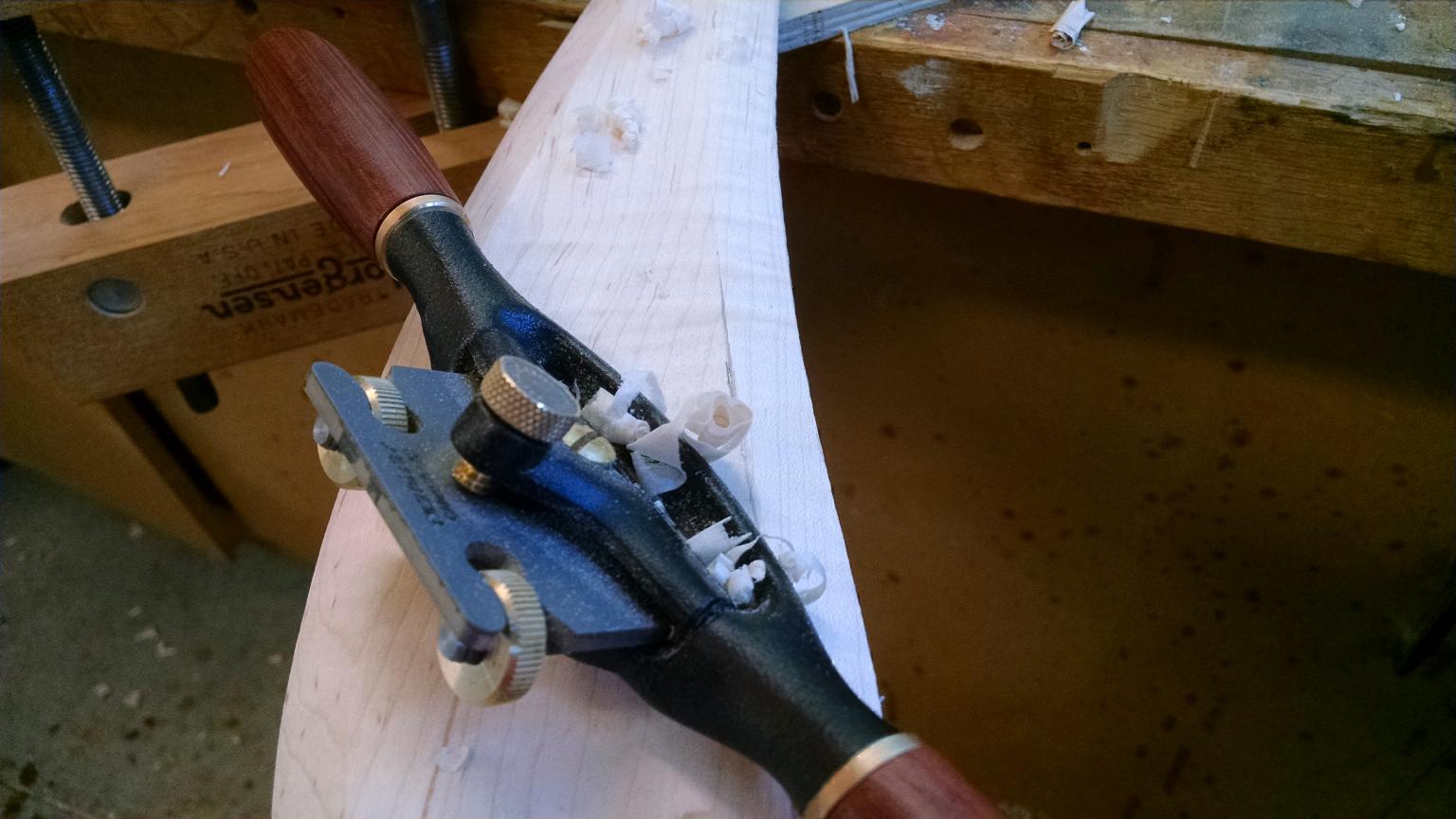

Working the fine lines in with my lovely Veritas shave.
It's just as easy to push this shave when the grain reverses on me, than to rotate the arm. Image above is the arm bottom.
Image below I'm getting the top cleaned up.

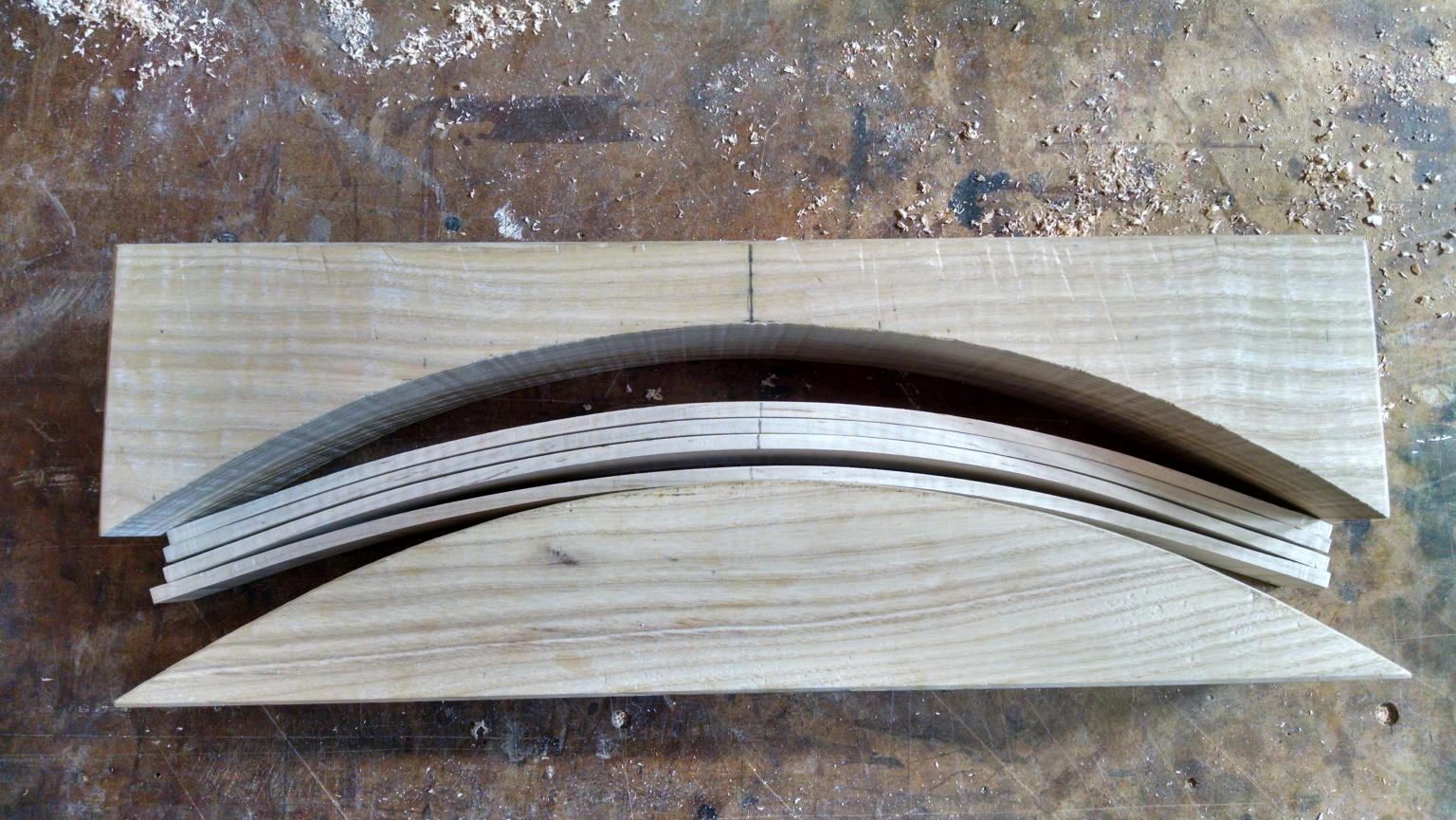

@Gene Howe, you were inquiring earlier about spring back when released from the forms.
As you can see the back slats had a good (normal) amount after breaking the forms loose.
I guess you built the forms to accommodate, right?

Ya, when I was building the sculpted rockers with glue lam backs and rockers, zero spring back. Thanks to the layers of strips and glue.
Steaming is a different animal I'm finding out.
The forms are direct takeoffs from Shaker forms, I did not design or come up with a workable radius. I could have with trial and error, but why? The Shakes did all the designing for us! So I'm sure they had the movement built into their bending routines.
