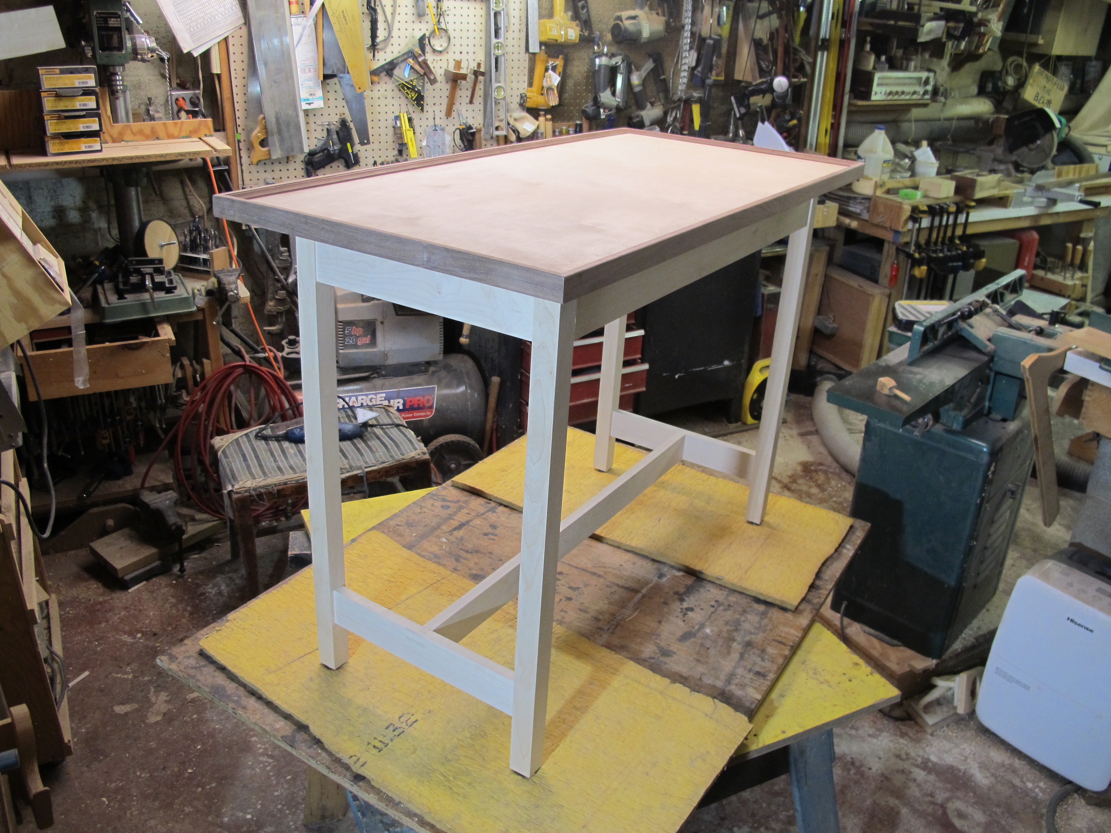

  6. Finished up the "Communion Table" for my sister's minister. He picked the design/size/materials. The church members will apply the finish when it is delivered. Made of maple, birch ply and walnut. Mortise and tenon joinery all around except for the long lower stretcher which is connected using a sliding dovetail joint. 30" H x 20" w x 40" L.
