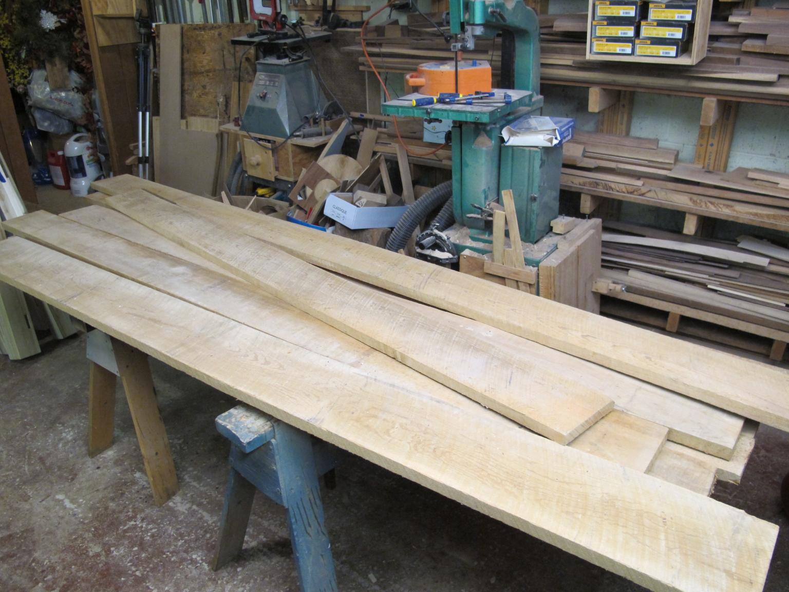

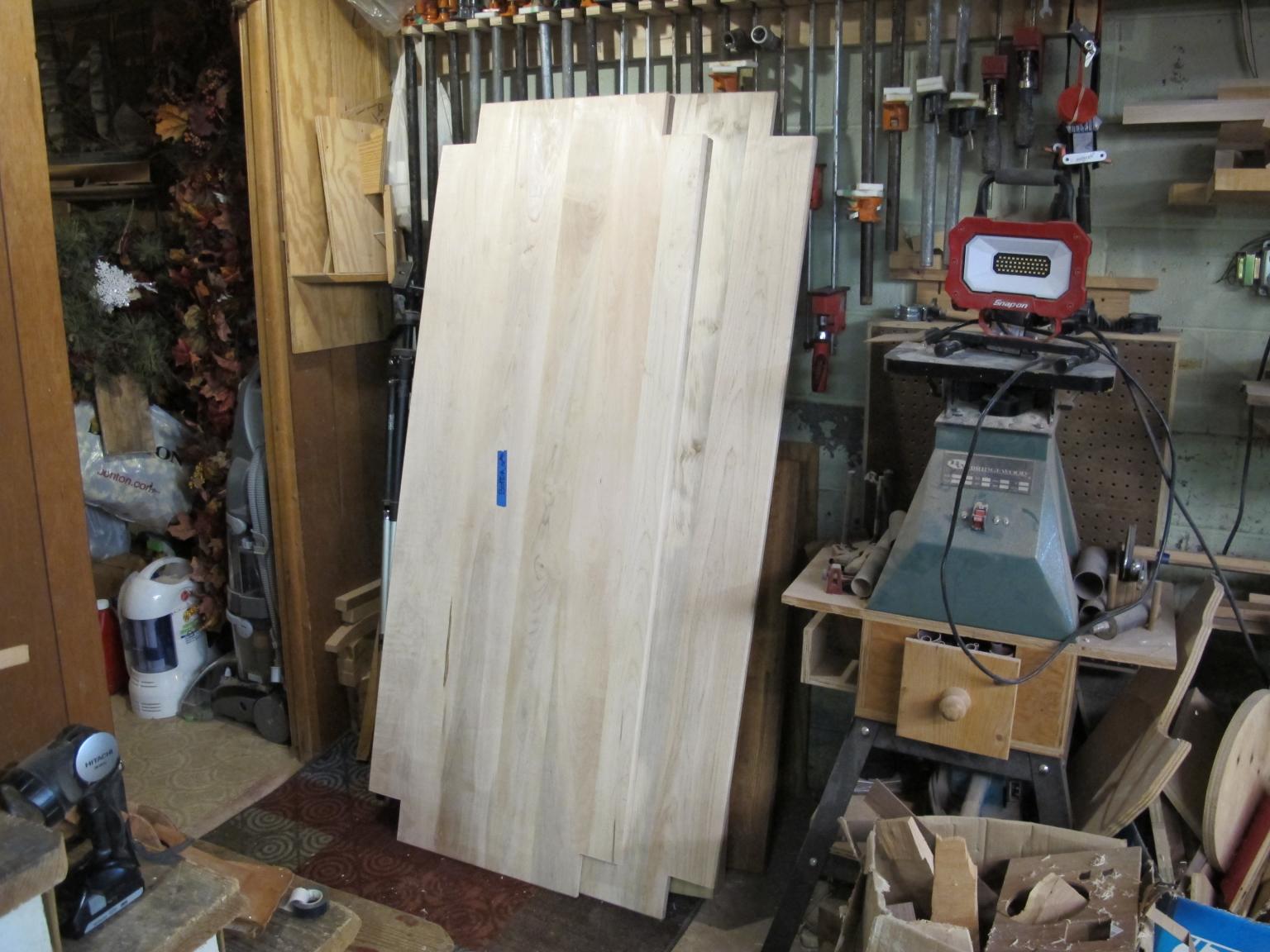

The last bit of machining was to create the two lower shelves. The minister wanted to keep the “maple” look for the shelves but hard maple is a little expensive so we went with soft maple.

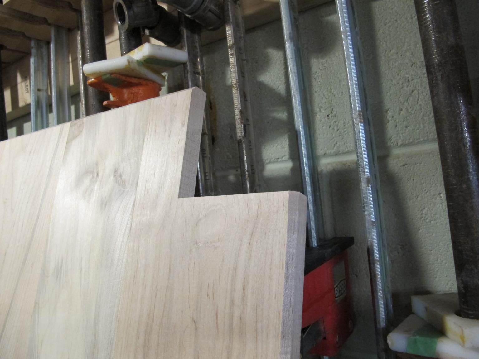

Planed everything to ¾” and used biscuits to help with alignment during glue up. I made these shelves full width during the glue-ups

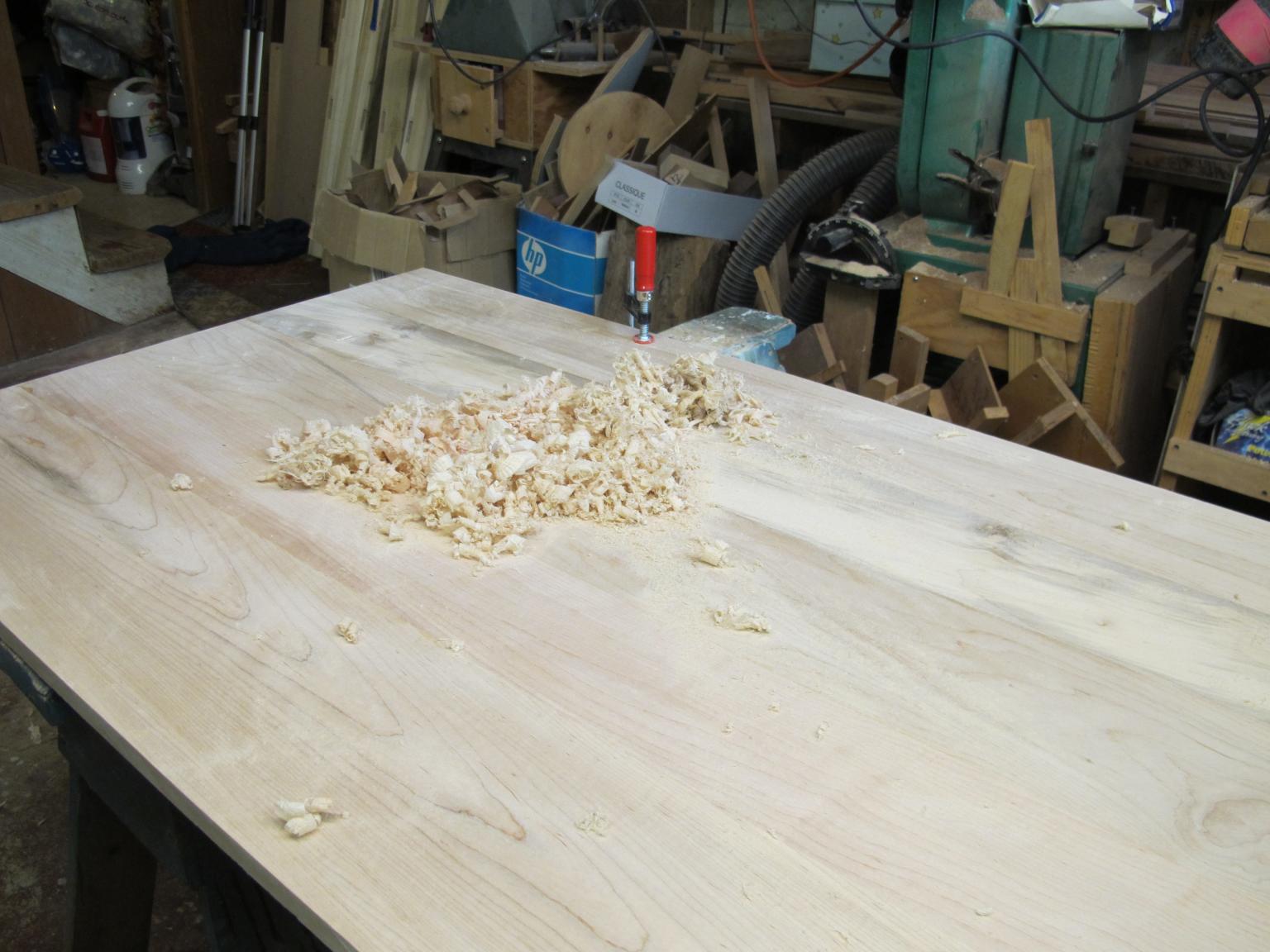

A card scraper brought everything smooth.

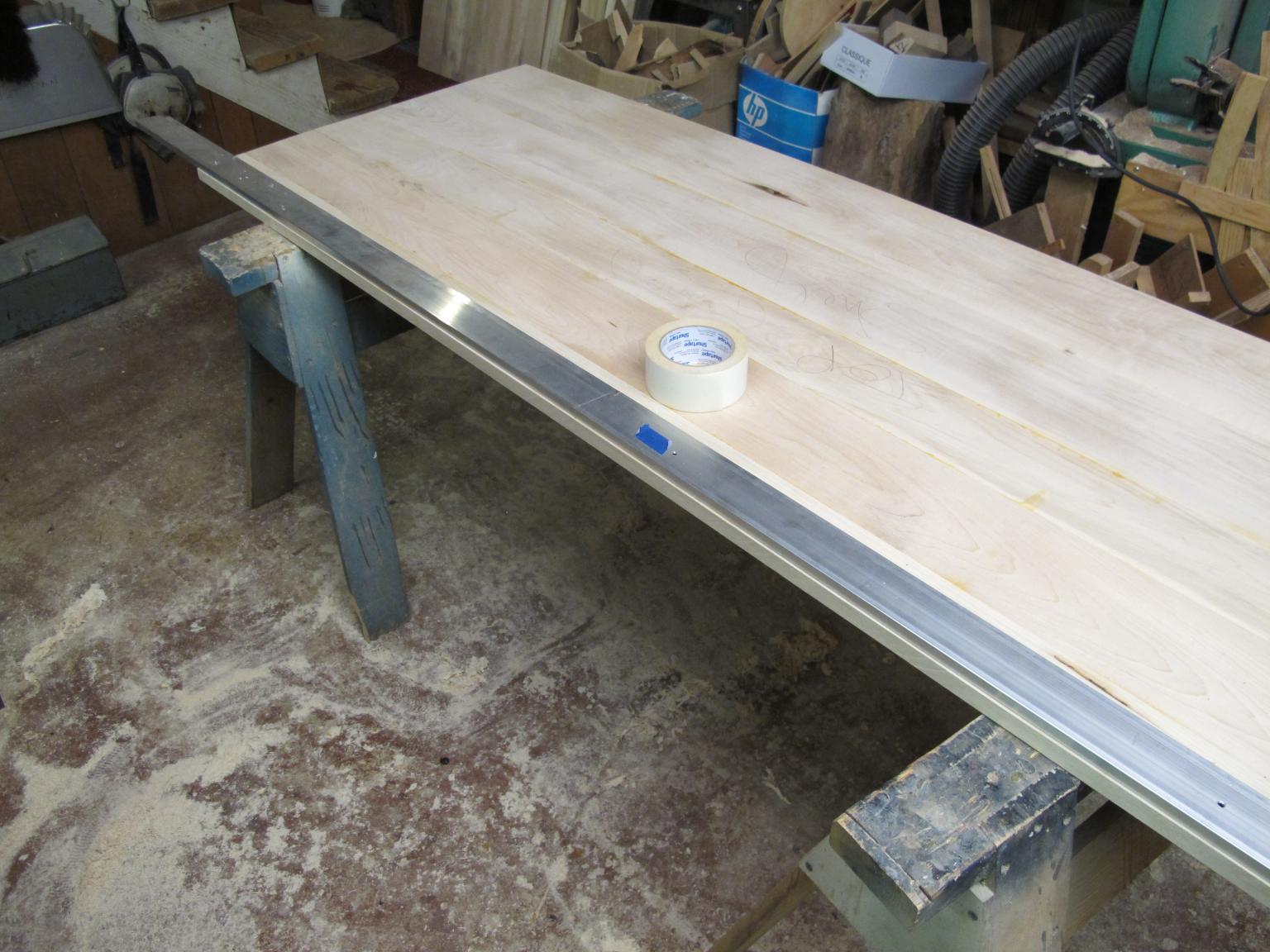

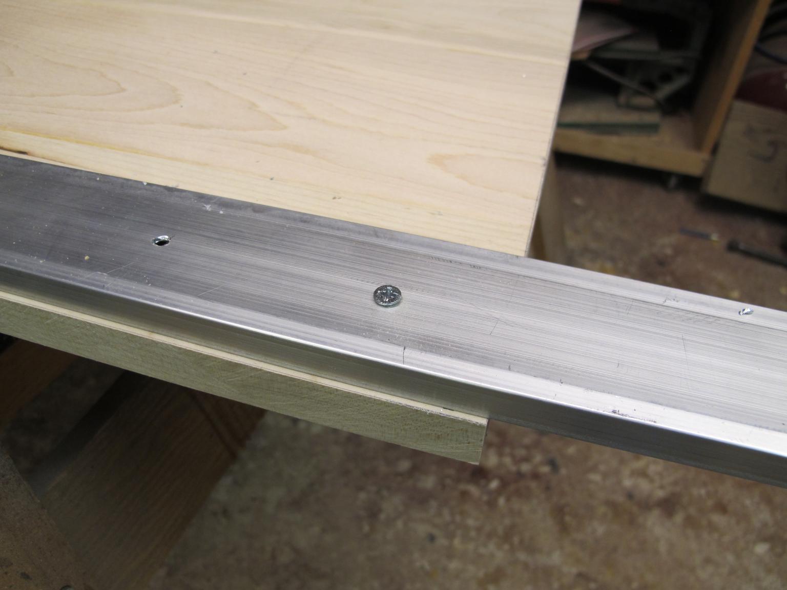

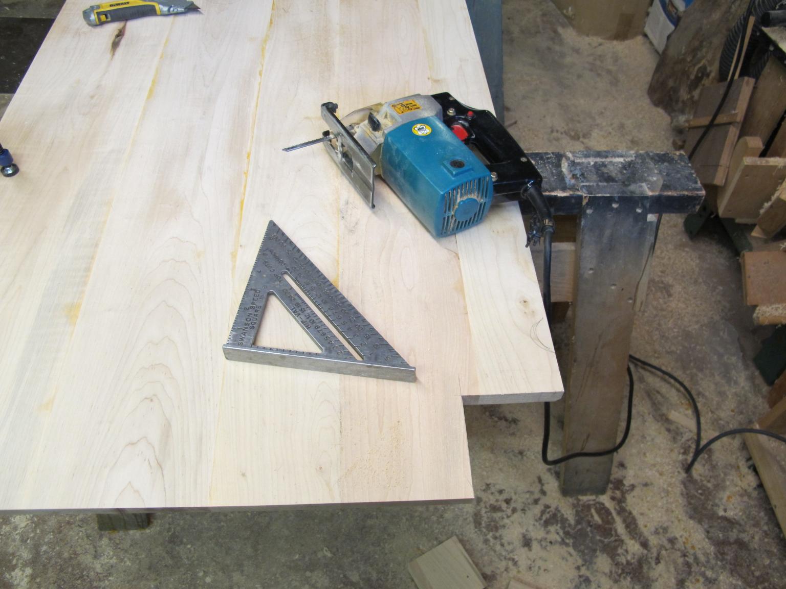

I sized the shelves using the same procedures as the top. Cut to length and width with the skill saw and a guide; then used the router, flush trim bit and a guide to finish off the saw marks.
The guide is held in place with double sided tape and screws. The screw holes are located in the area that will be removed where the shelf wraps around the legs. I also ran the chamfer detail around the perimeter of both shelves.

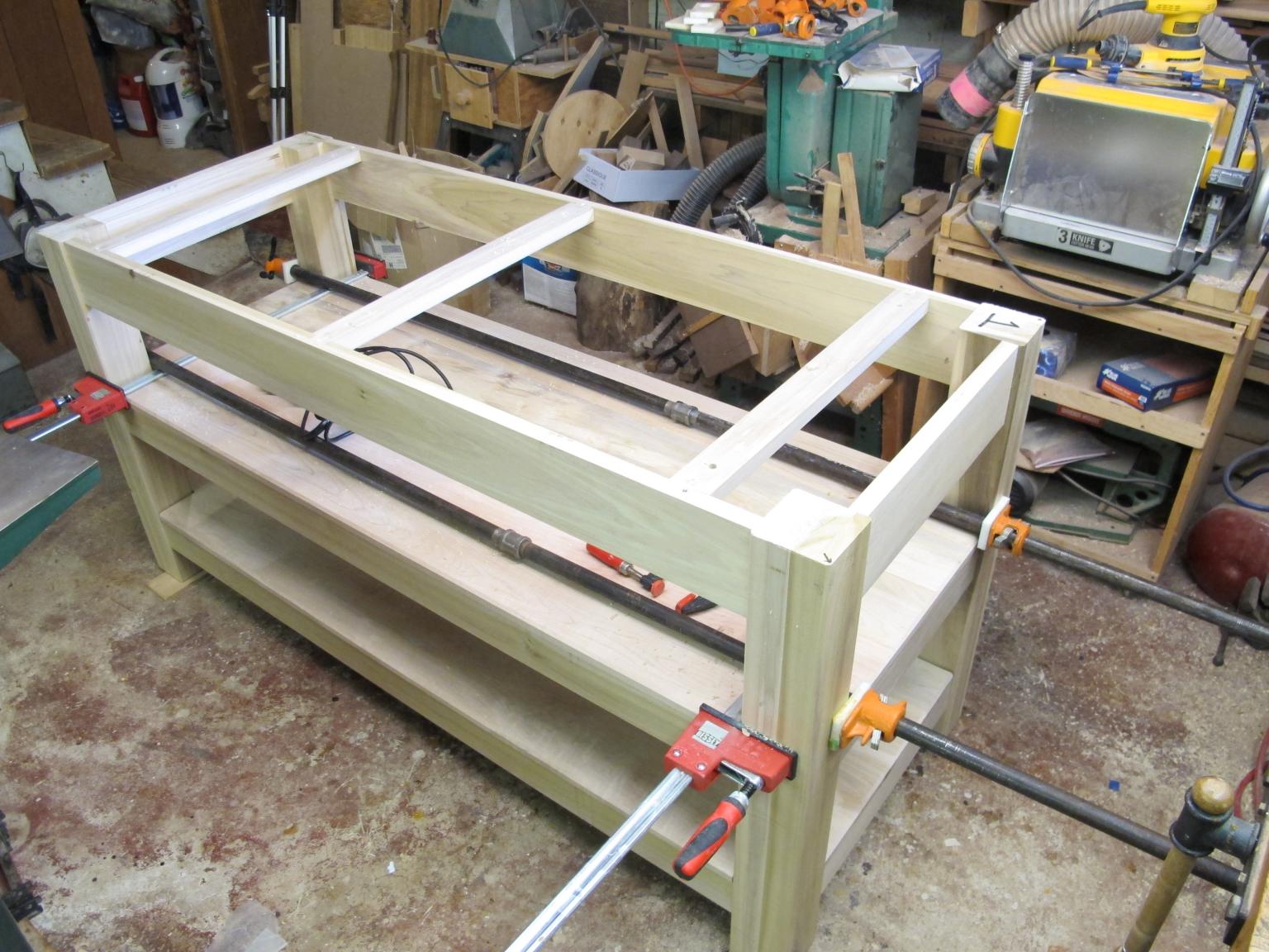

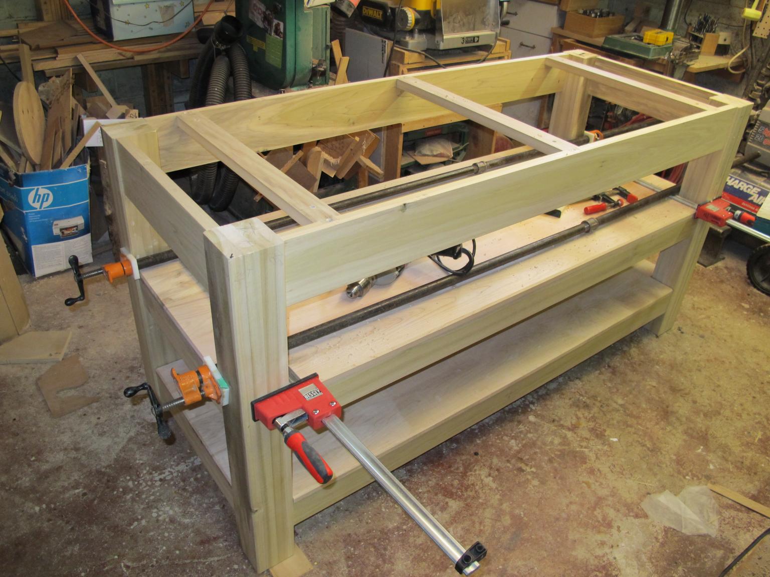

One more dry fit to make certain everything fits

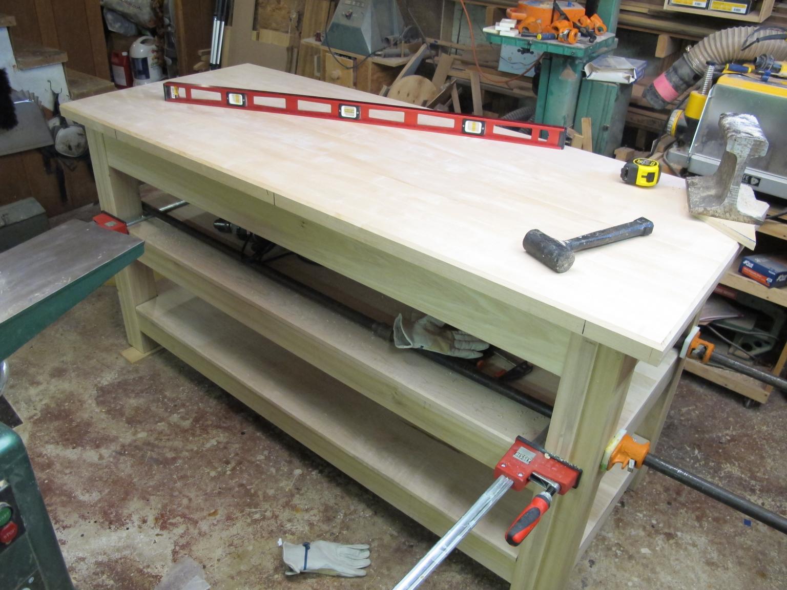

Set the top in place to locate and thread the lag bolt holes.

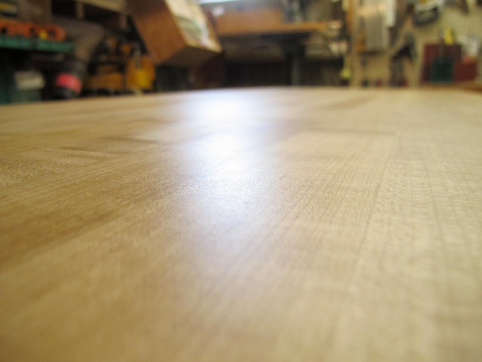

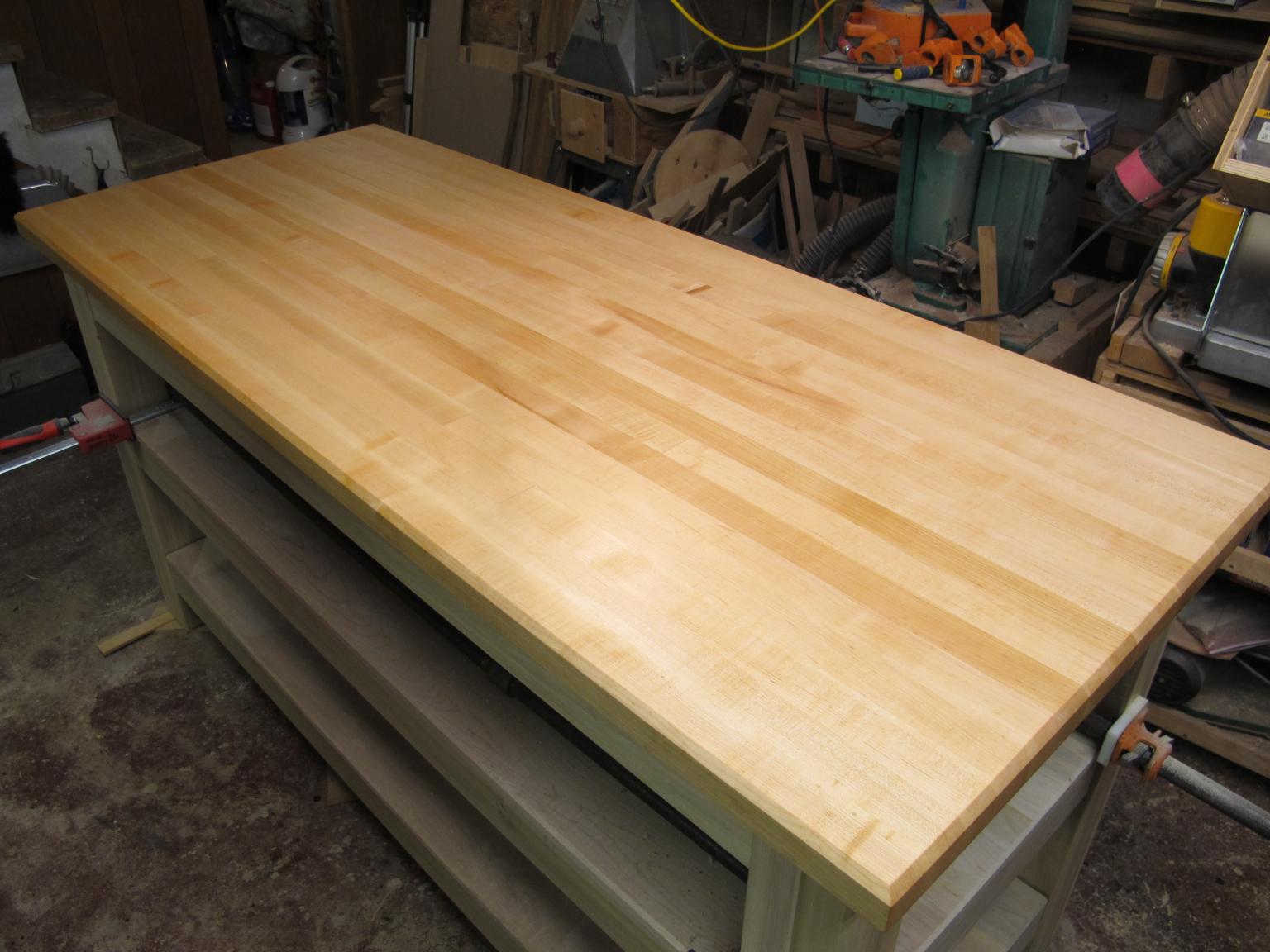

While I had the top in position, I did its’ final sanding and oiling. The top is sanded through 320 grit. I used two applications of mineral oil; allowing each to soak in about a day. Then, I used one application of hot “Bumble Bee Wax”- a blend of mineral oil and bee’s wax. Once that cooled, I buffed it out with an old towel.

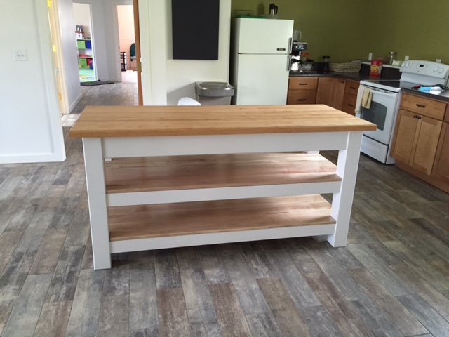

Several days later, I received this picture
I think the church members did an outstanding job painting and finishing the table. It looks right at home there in the kitchen.
