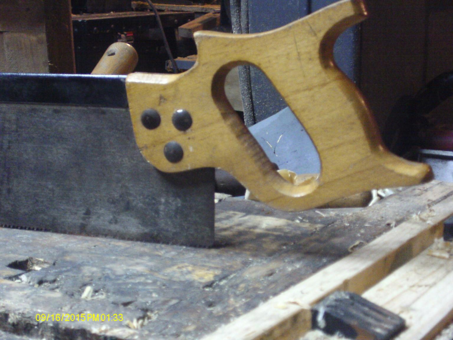

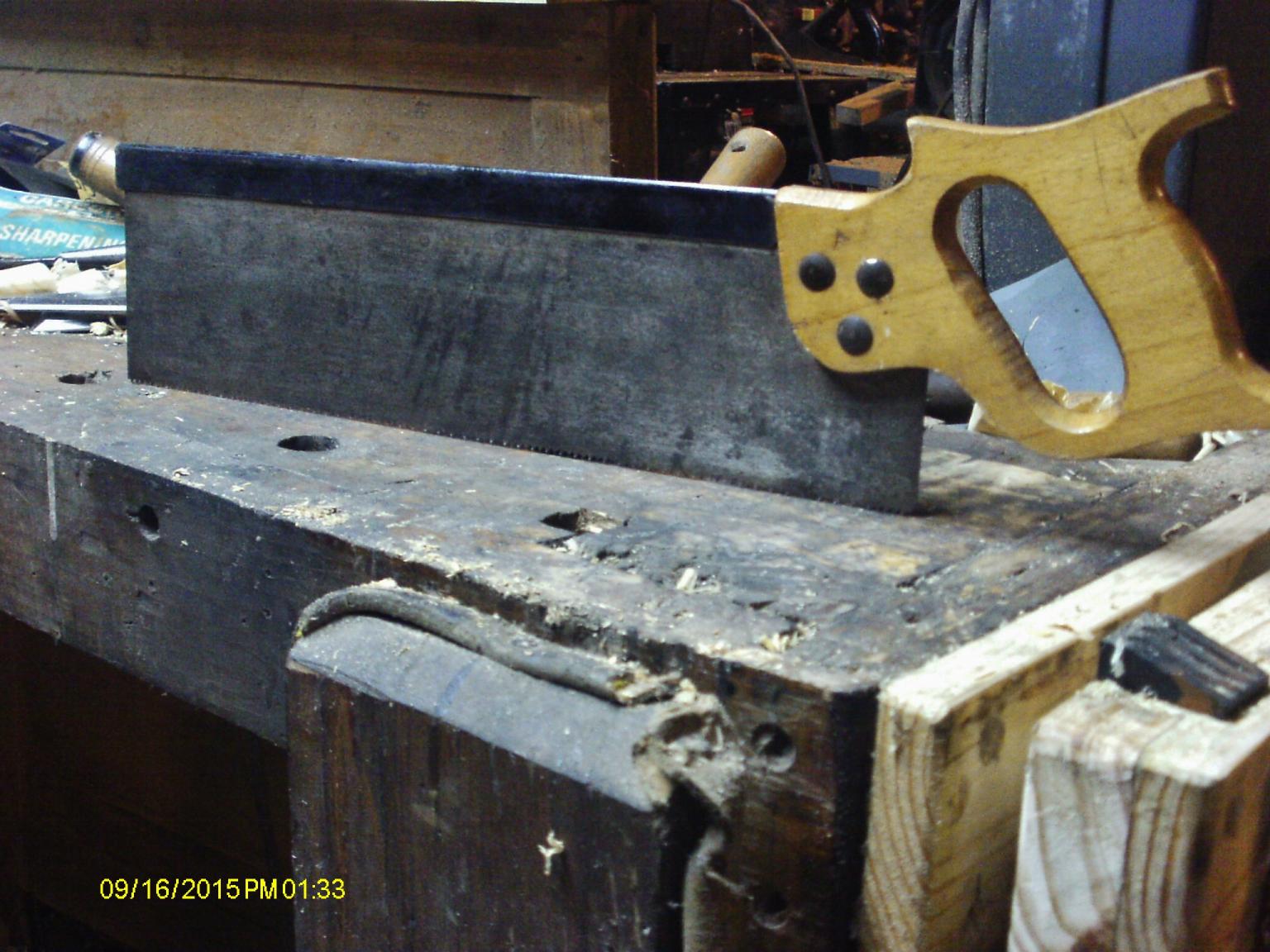

    Hand saw Rescue!
    Yep, you see something like this about all the time.. AND..they seem to think these should cost more than... Than that Stanley 14" one... Whatever paint they use on these things...it is a ROYAL PITA to get back off of the plate... Saw nuts were removed..and polished back up...Handle was removed for a while.. 80 grit on the Palm sander, then 220 grit, then 1500 grit...took a LONG time...before.. Steel back had slid down on the plate,, had to adjust it back out a bit.. Any etch was silk screened on, anyway..so that was long gone... Time to hang this up in it's new home sweet home? Before I added the handle back on, I gave the steel parts a rub down with the 3in1 oil.. I MIGHT have too many backsaws? Nah...

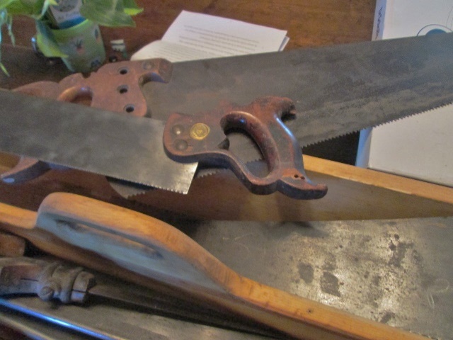

    took a couple of pictures of this saw and miter box - still in the previous owner-built box. didn't see any marks on saw blade and the whole thing appears to be in fairly decent condition. have not priced and put on floor yet at the restore. someone will get a deal i suspect.

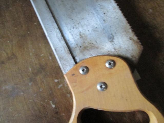

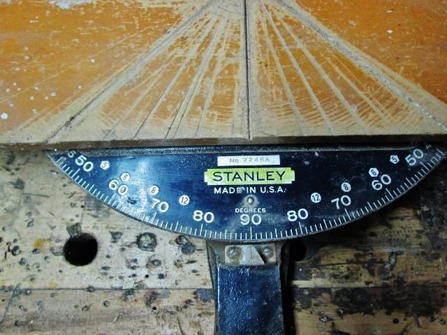

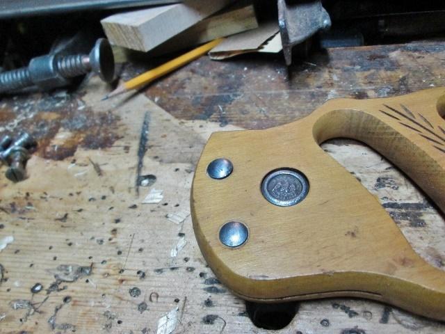

    Mitre Saw rehab

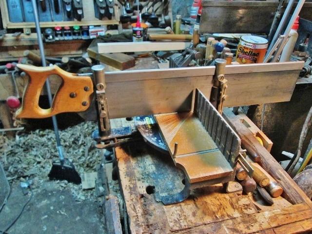

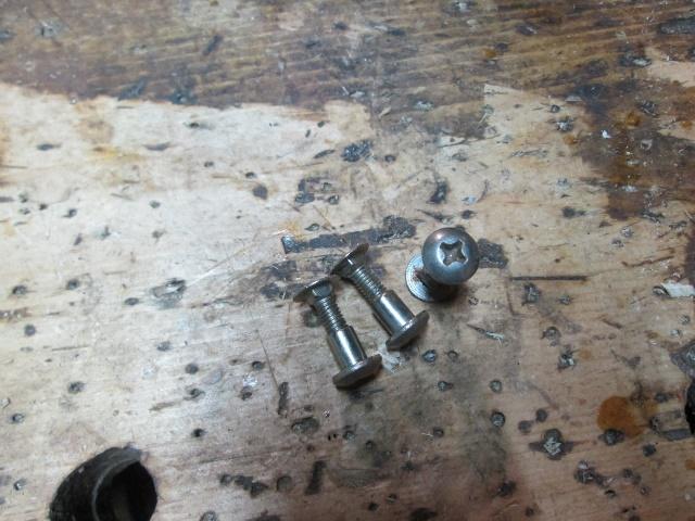

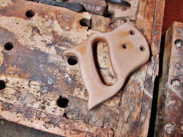

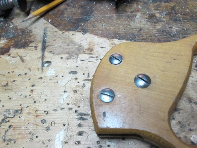

    Well, today was speding hauling the Boss around, while she did some shopping....decided to stop at a store in Anna, OH.....and spend a little "Me" time....and as few dollars as I could.... hey, for $5 and tax...it did have potential.....except for these things.. Which have no place on a saw. Decided to rehab this saw up, as a spare for the smaller mitre box... First off, these had to go....found a few better bolts in the spares box.. Forstner bits to recess these new bolts. At least the phillips headed bolts were gone.. Getting somewhere....took the bolts back out, needed to do something about that blockheaded handle..... Router with a roundover bit, sanders, spokeshave, rasp, and a piece of glass..... Getting there.... Wire wheel to get rid of the old finish. Sander to polish the saw's plate.....put things back together.. And set up a mitre box while the first coat of amber shellac dried.....then a test cut.. Mitre box? Just an old Stanley No. 2246A. Another look at the saw? Had to raise the depth stops a hair, this is a full 4" under the spine, 24" long, with about 22" tooth line. Seems to be even better than the other 4 x 24 backsaw I have. I do have the 4 x 26 backsaw the mitre box was made for....needs sharpened, and a split in the handle needs fixed. I think I can "make do" with this new $5.38 saw.....? Note: Couple of months ago, I had stopped at this store....found two moldy ( yellow fuzzies) Tongue and Groove planes....could have got both for...$5 each...saw the same planes all cleaned up, and hanging in the "showroom"....$42 each....YIKES!! Oh well, I do have that Stanley #45....

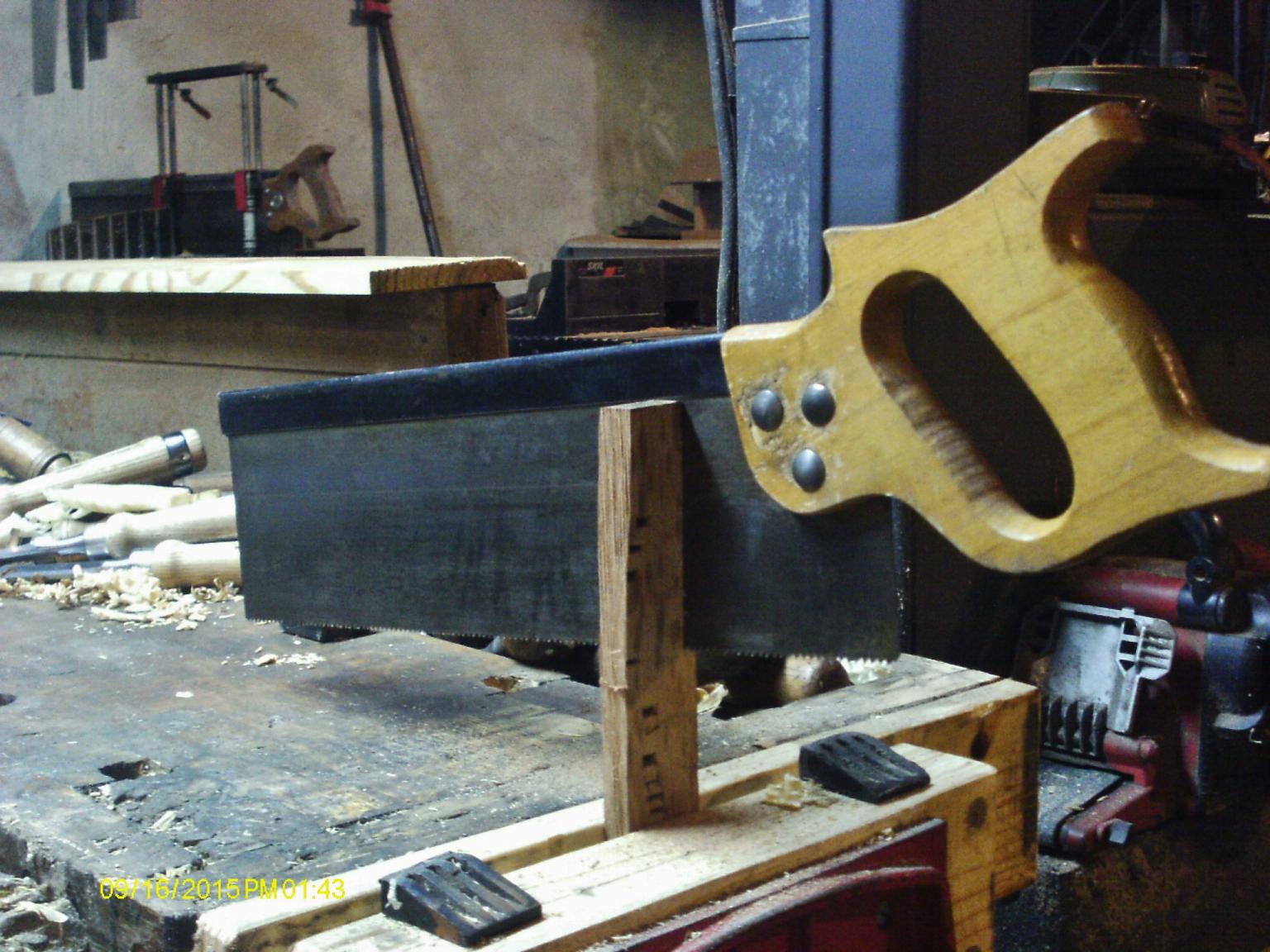

    Another came in the mail tool

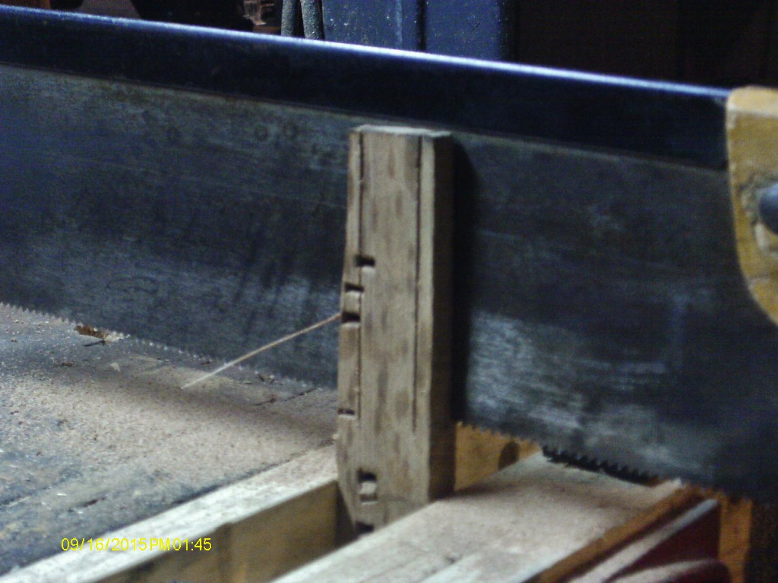

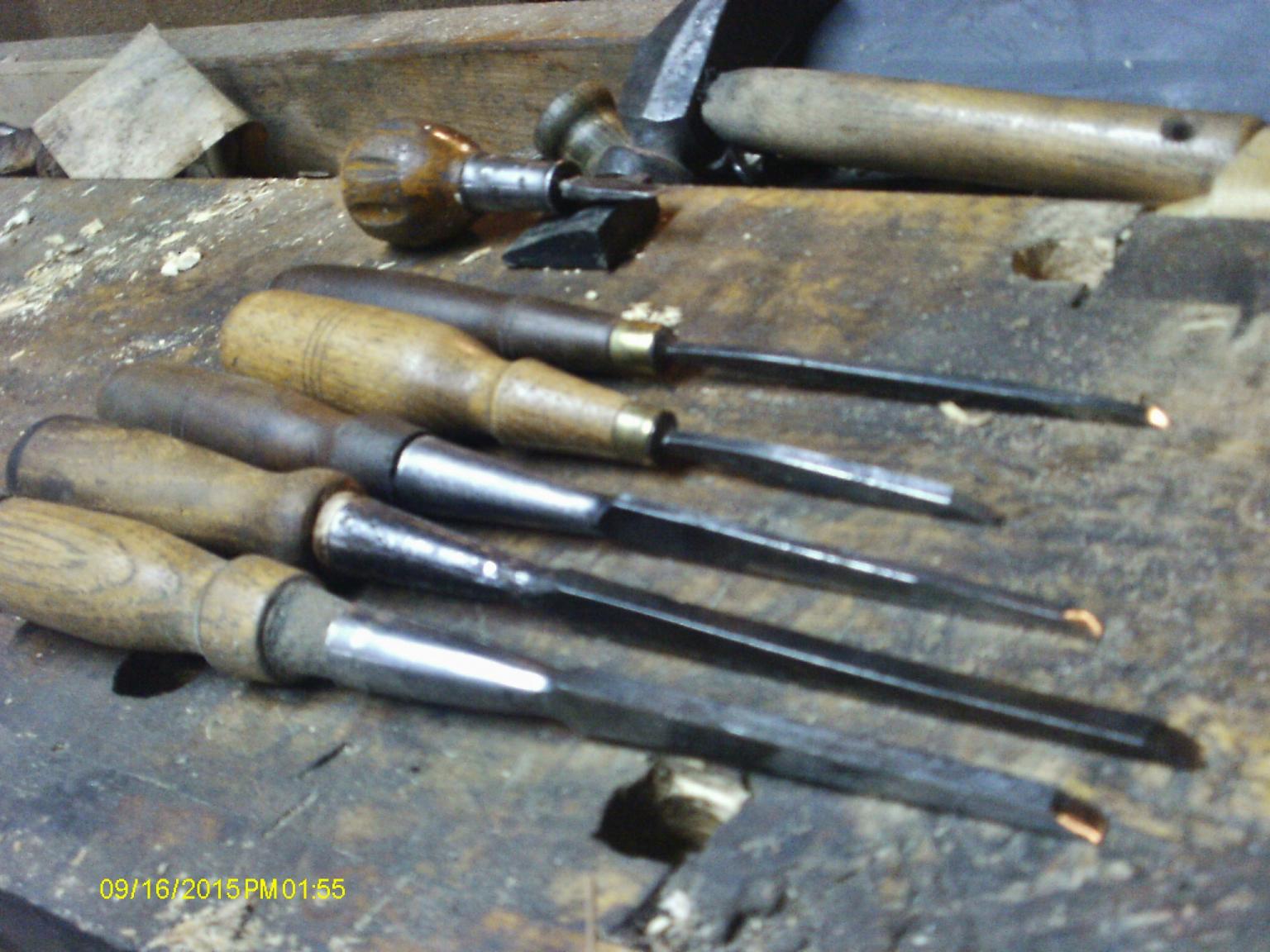

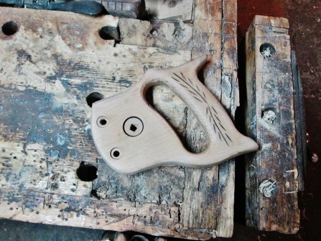

    Was dropped off real early this morning, hadn't even finished my 1st Mountain Dew of the day! Big padded envelope. item was stretch-wrapped to a large sheet of cardboard. Finally dug it out of all the packing, and hauled it to the shop. Not the prettiest thing on the block. Plate is just a hair under 14" long. Might have to work on the handle a bit, seems a bit chunky? Back is blued, steel bolts, no place for a medallion. No etch, either. Got out a scrap of white oak, just to see how it does cut....as a rip saw.. Full depth, nice and straight, did NOT need any wax on the plate. Tried a few more cuts, maybe try to make a tenon? This shows the first two cuts, and the third inprogress. Those little squares in the wood? Was trying a couple of these out. Managed to accumalate a few mortise chisels....anyway, got the fourth cut done, laid the scrap over, and cut the shoulders.. That scrap WAS 1/2" thick, by 2" wide. Not too hateful? Now, about this here chunky handle.. thinking about firing up the bandsaw, and trimming the back edge a bit, so it isn't so wide. Maybe a round-over as well. has a Sandvik flavour to it, don't it. $5.99 + S&H....not too bad....
