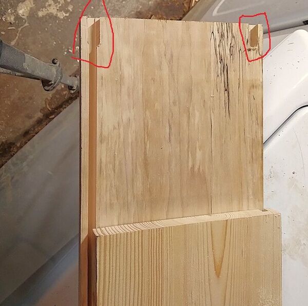

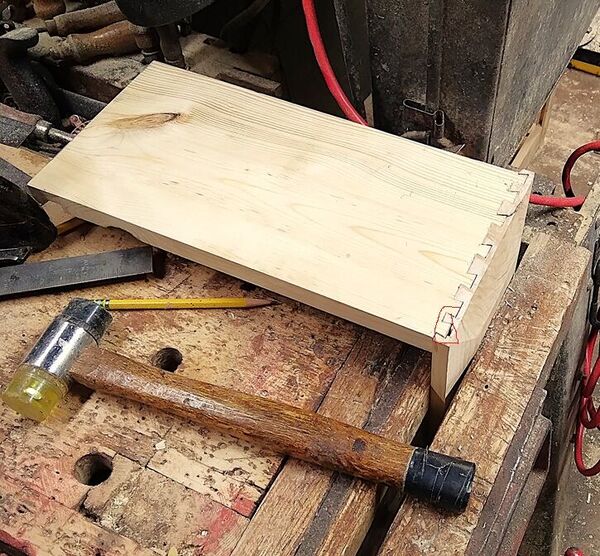

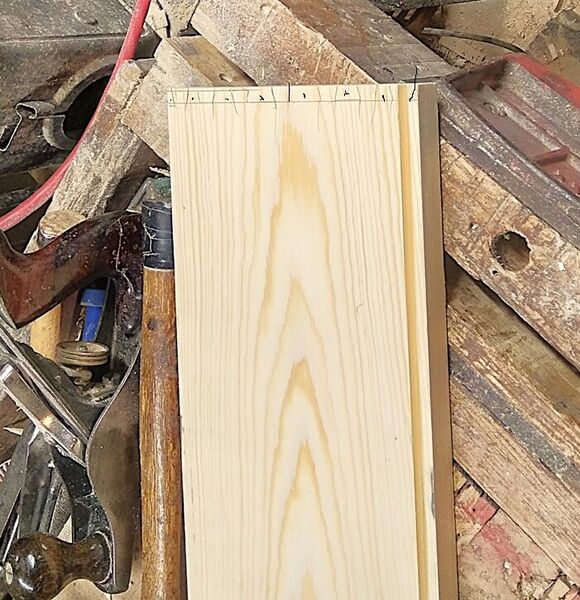

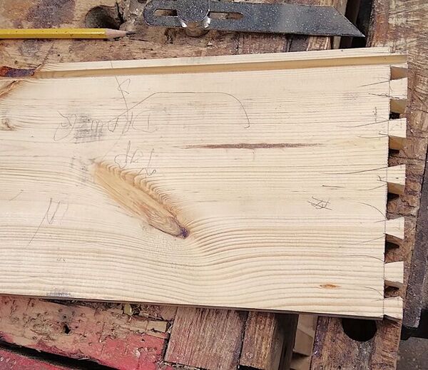

    Day two, another practice session. Laid out the tails. Coping sawed and chopped the waste. I was very please how nicely my tails looked, pretty clean. Then I transferred the pins and darkened the

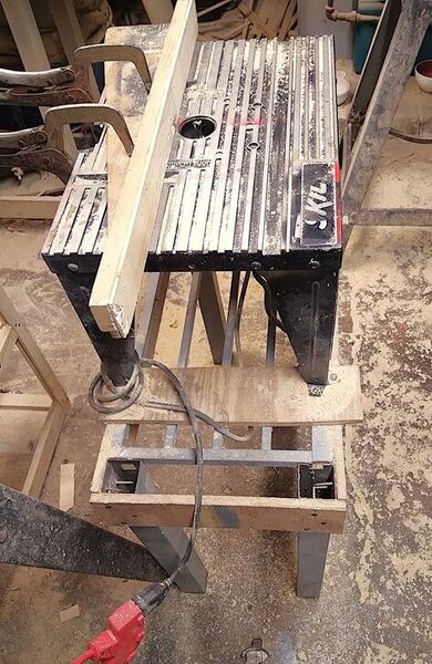

So..when I made those 3 drawers for the current project....and found not being able to use the right thumb....we have ways..
Router table, adjust the fence..
Sockets were cut (Pins first?)

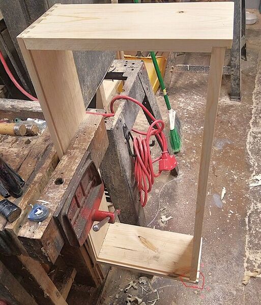

And because I always use the bandsaw to remove waste between the tails..
Note: In building drawers, make sure a tail covers the grooves for the drawer bottom..
Reason: I can SEE a lot better as to where I am sawing, cuts are square face to face..and, I usually try to leave the lines, and cut only on the waste side...
Part of the groove is a bit deeper...needed that mallet to dry fit right off the bandsaw..
Second end, dry fitted only with the drawer back in the dados..
YMMV, of course...

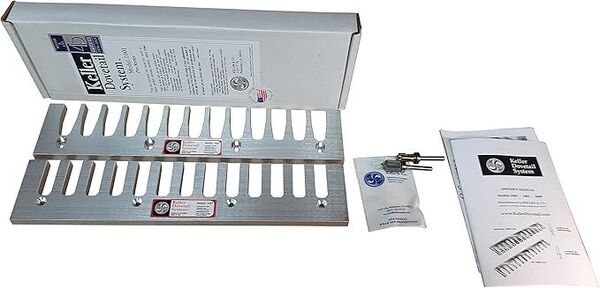

One of my favorite Dovetail Jigs is the Keller. I have one, been a long time since I used it, but I loved it. My dad bought in the early 90's for box joints to build his bee hives, he then gave it to me after he decided buying the hives was more cost efficient.
I made some pretty nice things with that old Keller, I still have it today. It doesn't get much more simpler than the Keller, IMHO.
Here is the exact one I have. It takes some initial set up and dialing in with your own home made backstop, but once ya get it right, it does one thing great, and that's making through DT's.
I made two blanket chests using my Keller among other items, such as drawers and more. 🙃

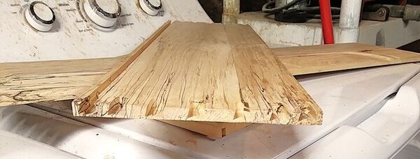

They look great John, amazing what a difference the poplar makes, isn't it?
Mahogany is a good one for this too, saws and pares very easily.
Thanks JWD and you bet, the poplar was a major difference in workability and sharp edges. Mahogany makes total sense, with the even and consistent grain and molecular structure of the species, I haven't worked with Mahogany in years, I'd love to get something going with it.
