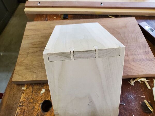

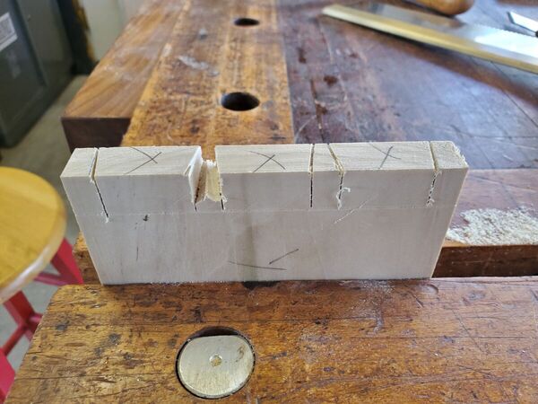

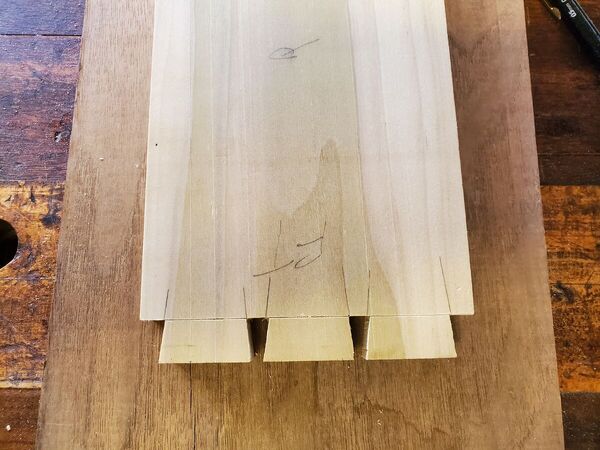

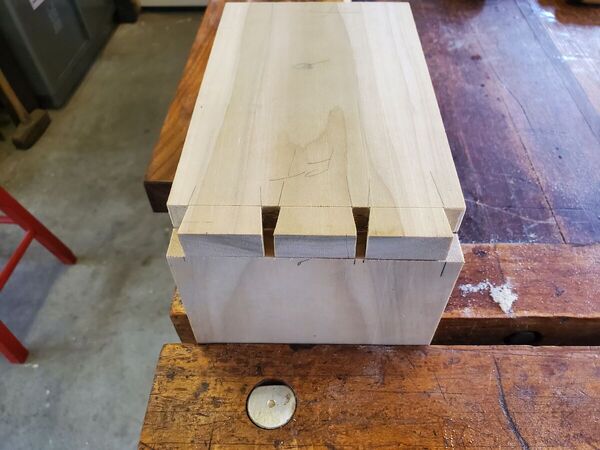

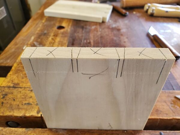

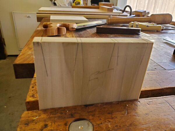

Day two, another practice session.
Laid out the tails.
Coping sawed and chopped the waste. I was very please how nicely my tails looked, pretty clean.
Then I transferred the pins and darkened the scribed lines with pencil, my eyes are horrible. Marked out the waste so I wouldn't get confused and accidentally cut a pin out.

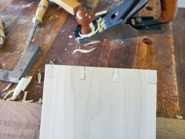

And, guess what I did? 🤣
So I cut off the end of the board and started over.
The pins were looking pretty good, I am getting used to this a bit.
I should have taken a picture of the boards together before I cleaned them up, the joints looked pretty bad and IMO they don't look as clean and crisp as my second attempt yesterday. I cut these DT's at 1:9 and they were actually a tad too difficult to work with. So I think I'll be back to the 1:8 typical DT's for now till I can refine my technique with everything.
The image below looks much better than the joint really is, it does look pretty bad, worse than my attempt yesterday.
I was very hopeful while cutting and chopping, I felt more comfortable than I did yesterday, and I was sure this one was going to go together really clean, but it didn't. And I know at this point, it's down to technique, getting comfortable with it all, and confidence. I know I cut on the pin side of the line a little thus the gaps.
All in all, each attempt gets me closer to be better, and as it is with all new things to be learned, patience with self is key with me. I'll need dozens if not a hundred DT joints to be good and clean. It'll come!

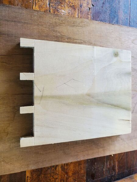

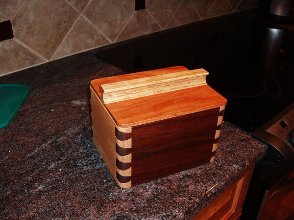

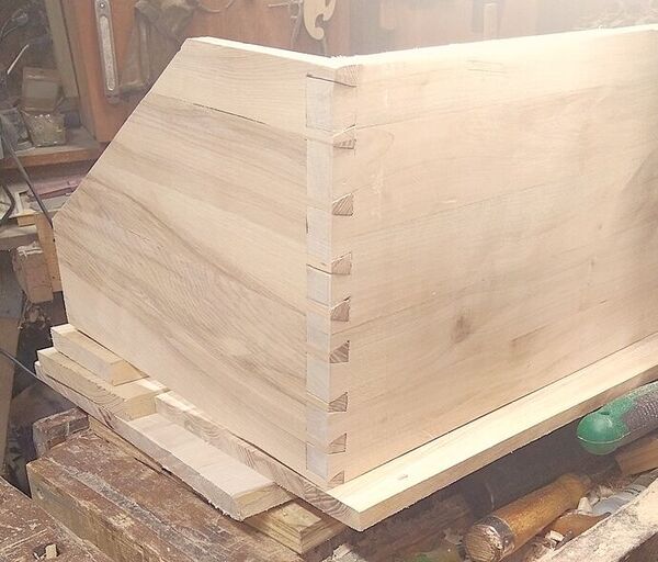

Hmmm...I always do pins first...easier to mark out the tails, that way..
Dry fit...
Needs a bit of fine tuning..
Back corner of a Bread Box...

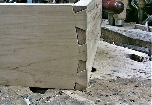

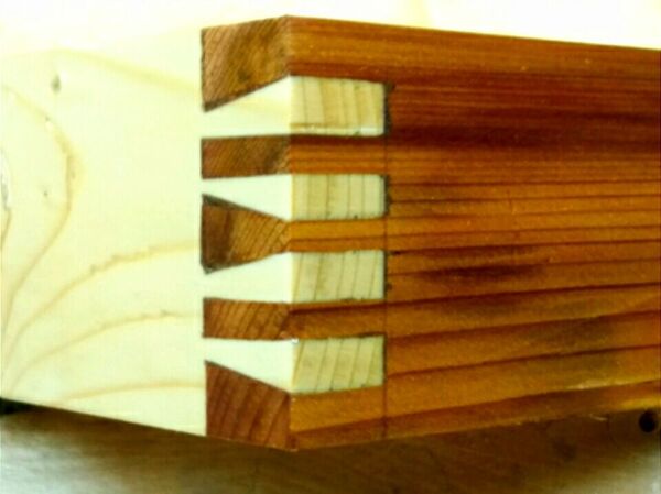

At the state fair 4-H woodworking competition, the skills test for the top category is to hand cut a dovetail joint. Every once in a while there is one that apparently, they have no idea what to do. One last year looked like a double set of pins with 1/4" gap between them.
@kmealy did it look like this?

1 hour ago, MrRick said:
@John Morris your day two practice came along nicely. Keep up the good work!! 👍
Thanks Rick, any suggestions on closing up those gaps?
Gaps happen mainly because placement of the saw edge was put on the line instead of inside edge of line. Just be very diligent where and how you place your saw tooth edge to the line whether penciled or knife scribed. It is better to be too tight on the pin openings (if you're doing tails first) then not. You can always pare on opening to fit the tails. Also practice how you place and move your saw. The motion of sawing should be inline. Your wrist should be locked and the saw, hand, forearm, upper arm and shoulder should all move together inline like a trains wheel in motion. Practice to the side on a 2 x 4. Scribe a perfect pencil line all around on the 2 x 4 and start cutting. Watch your ability to cut all around on that line. If you are off its because you've not stayed inline this motion.

For now that's how I'm doing them, till I get feisty, but for now I'm sticking with seemingly tradition.
Thanks for the tips Rick!

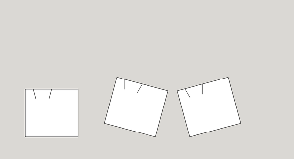

One thing I found that helped me, when cutting tails, was to position the tailboard so that I am cutting a vertical line instead of trying to maintain the angle.
Left image show the tail drawn out. Center image is how I would position the board for cutting the left side of the tail. Right image for cutting the right side of the tail. It works for me. The other thing I do is to carry the cut lines across the end of the board and down the "back side" to make sure I'm keeping things square and equal.
Thanks Lew! I can try that!
