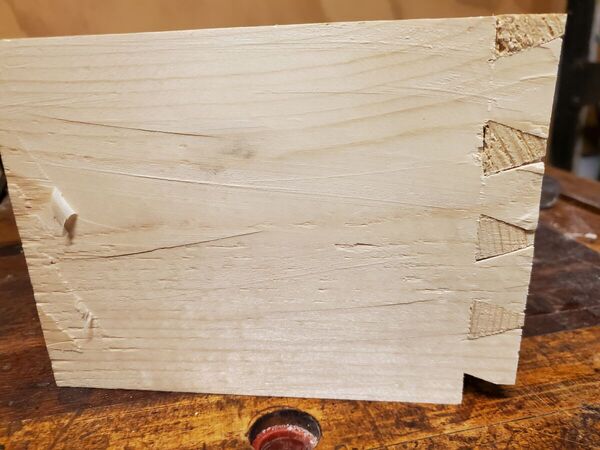

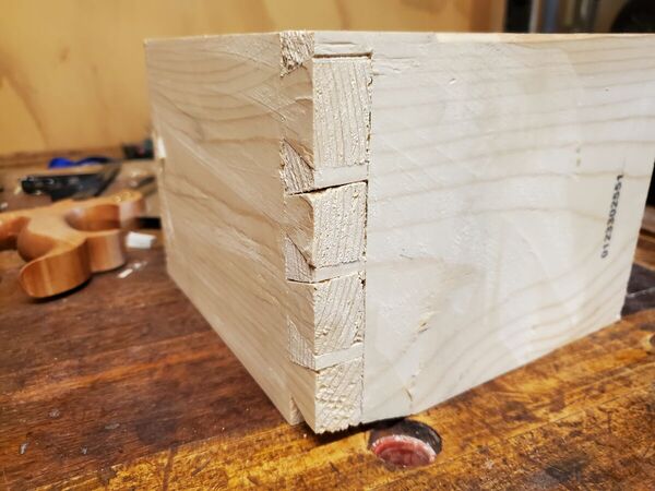

My attempt a couple weeks ago yielded sloppy results, I was using 3/4" pine and the softness of the pine made it difficult to chop the waste out.
Earlier practice
My attempt earlier was rushed too, I clicked on a YouTube video in my home, took mental notes and carried them into the shop and just went at it, I also had a little too much coffee.

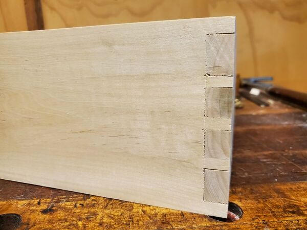

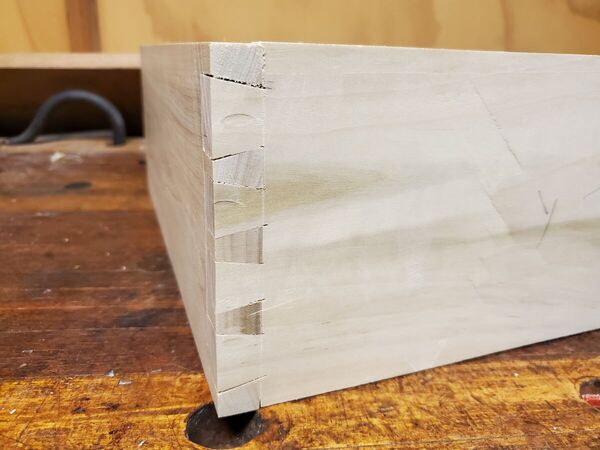

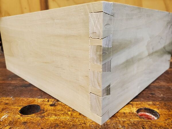

Below are my dovetails, and, it was a fit the first shot, I pressed the joint together and gave it some taps with my steel hammer head and they sat in pretty good, not bad! Still needs much work, but it's light years ahead of my attempt above, but my above attempt was a needed stepping stone to get to this point. And uh, ya, I need to be careful how I tap my tails in to the pins, you can see some hammer marks in the tails. 🤷
The tails and pins sat a hair proud, I planed them down with a few swipes of a plane.

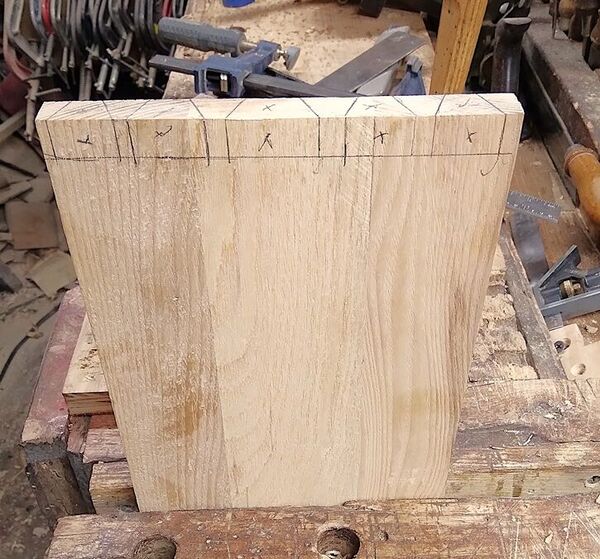

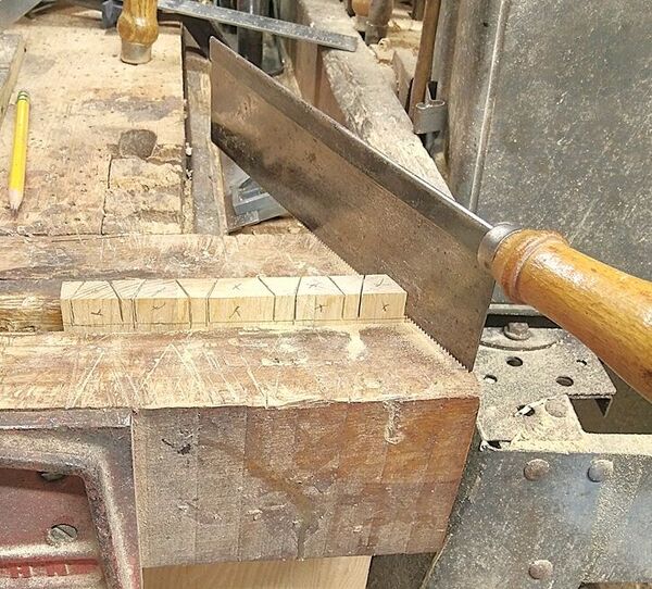

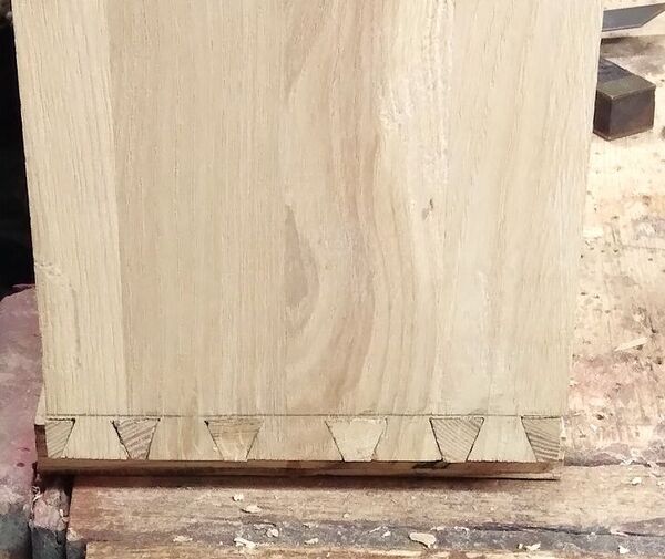

    Day two, another practice session. Laid out the tails. Coping sawed and chopped the waste. I was very please how nicely my tails looked, pretty clean. Then I transferred the pins and darkened the

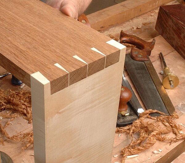

Always saw on the waste side of the line
Always mark which is the waste...usually with an "X" Oh, and knife the "Baselines" keeps things from splitting out into the face of a board..
Sometimes, I forget to abuse the Baseline..

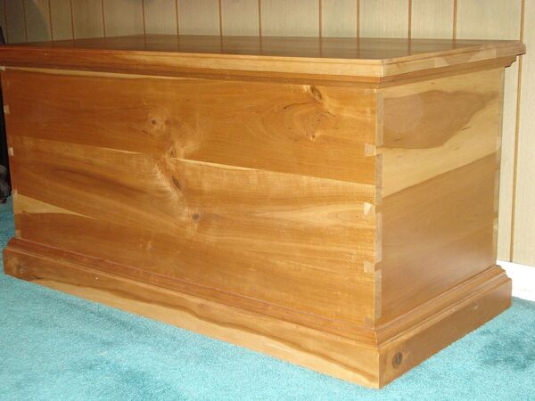

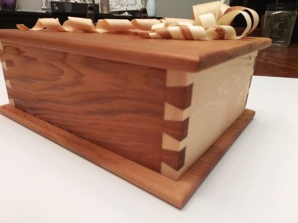

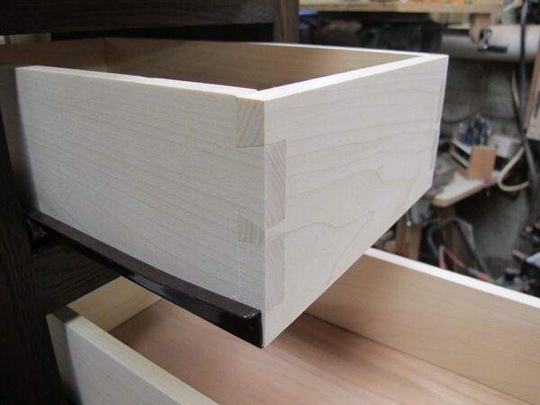

One of the earlier pieces I made for Mimi was a blanket chest. I had been using a Porter-Cable dovetail jig for dovetails but wanted to try my hand at had cutting them. I talked to a friend, who collected early American chests and we discussed the joinery. I was surprised to learn that the current dovetail "philosophy" is very much different than what it was way back then. He showed me that dovetails were quick and dirty ways to make strong joints. They were most often hidden, sloppy connections. Often shimmed to fill imperfections and covered with veneers. It wasn't until later on that it became a status thing among woodworkers
A close inspection of the lower front corner shows where I had to add a thin piece to fill a gap.

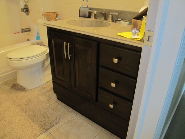

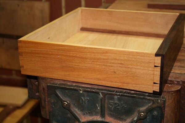

I was getting a little better when I got to redoing our bathroom. The vanity was made from red oak but I used poplar for the drawers and added false fronts. Through dovetails.

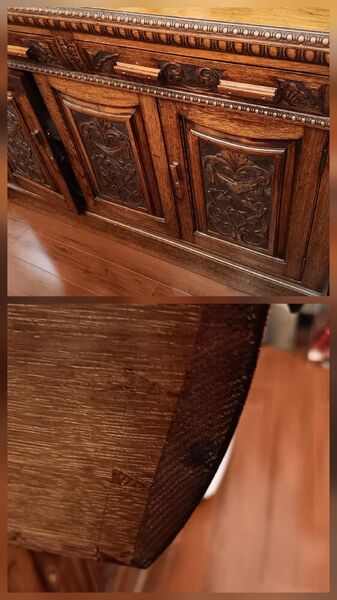

I have an 1830 English sideboard (with certificate of authenticity) made out of solid oak. The drawers are hand cut dovetails. The dovetails are quite perfect. They are "London style" look closely and zoom in. Keep in mind these were hand cut by saw and chisel. Back in 1830!

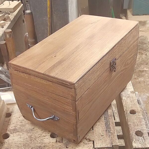

Sometimes..things take a curve..
Sometimes they're done in contrast
