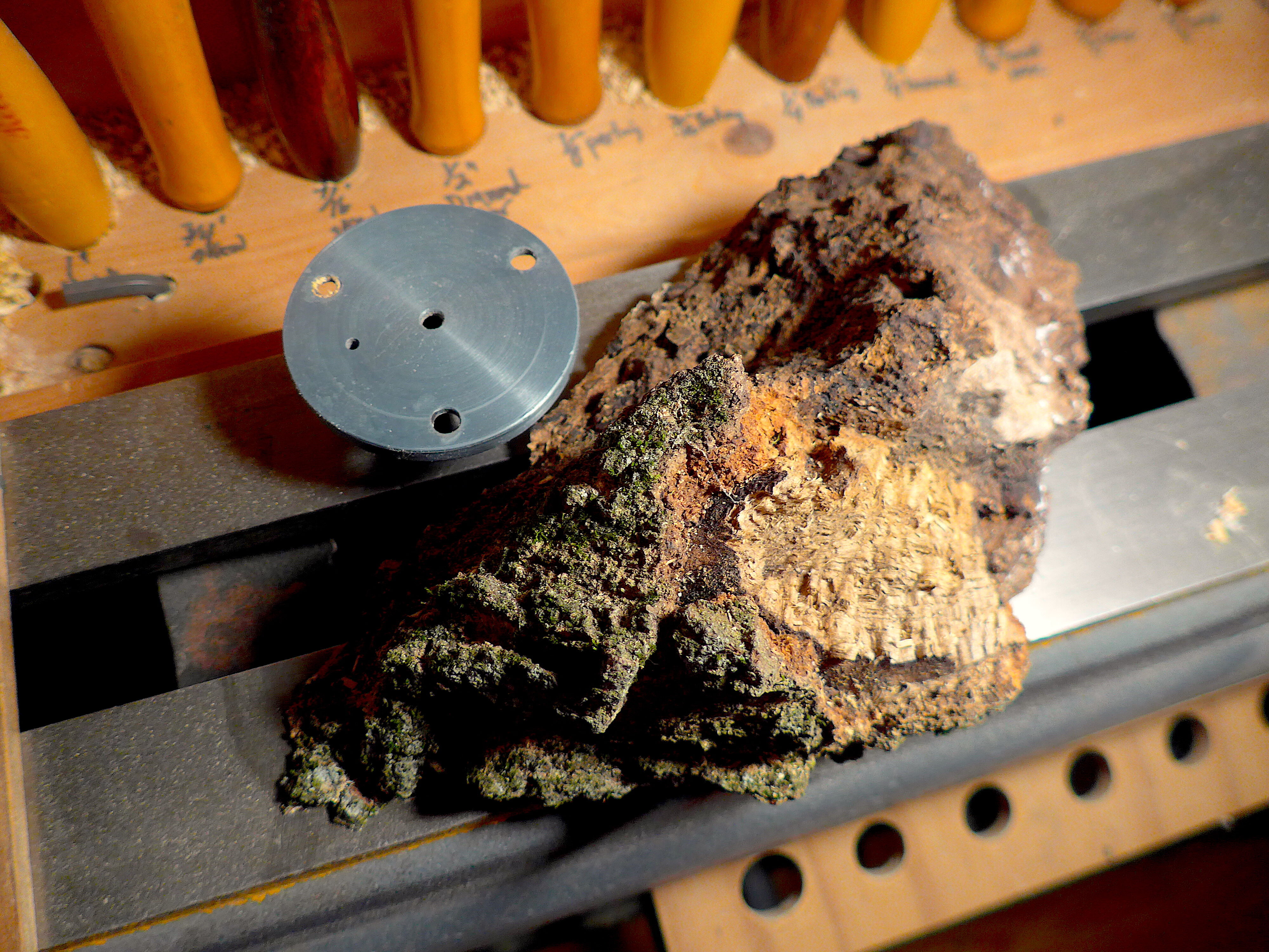

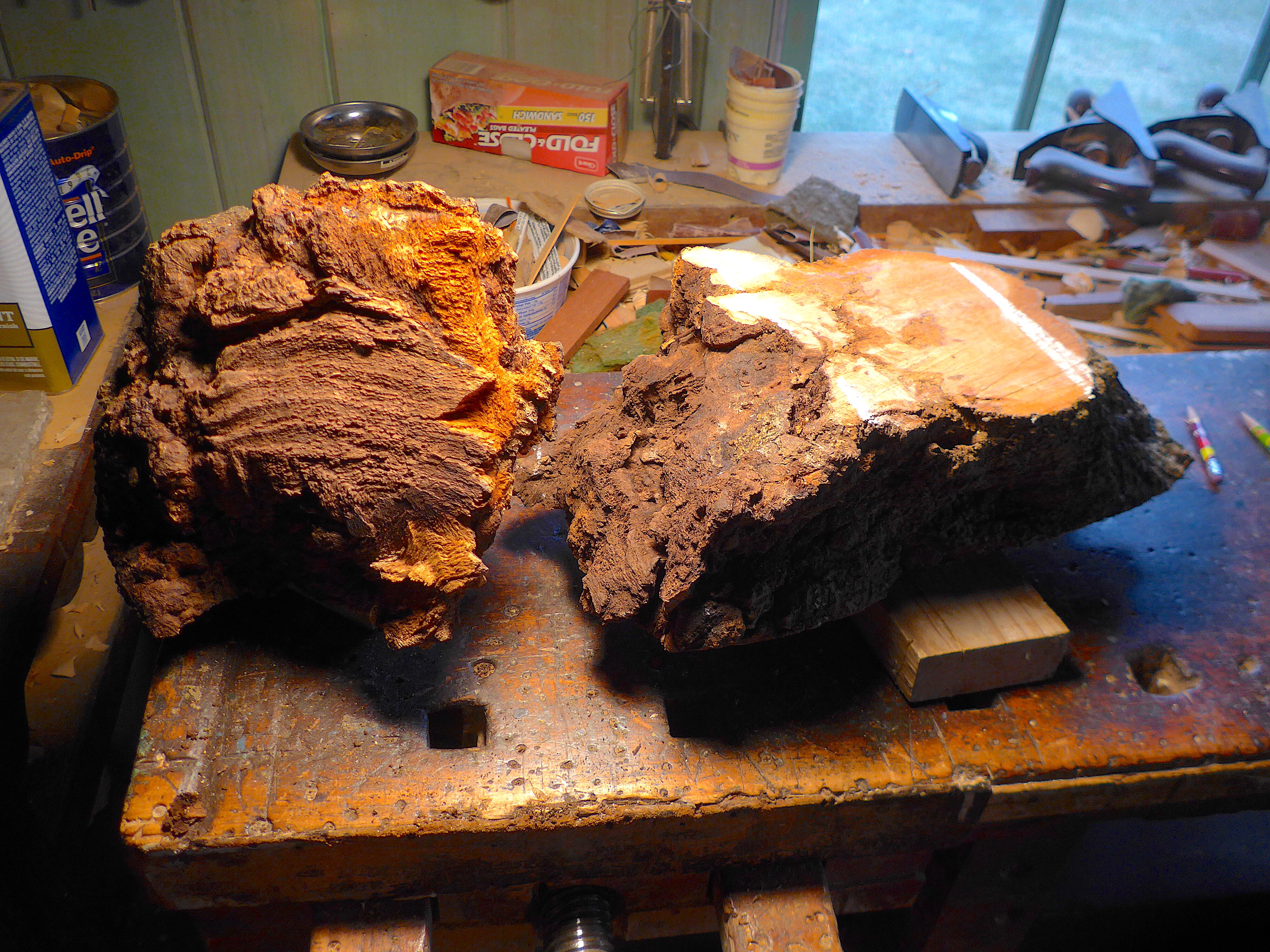

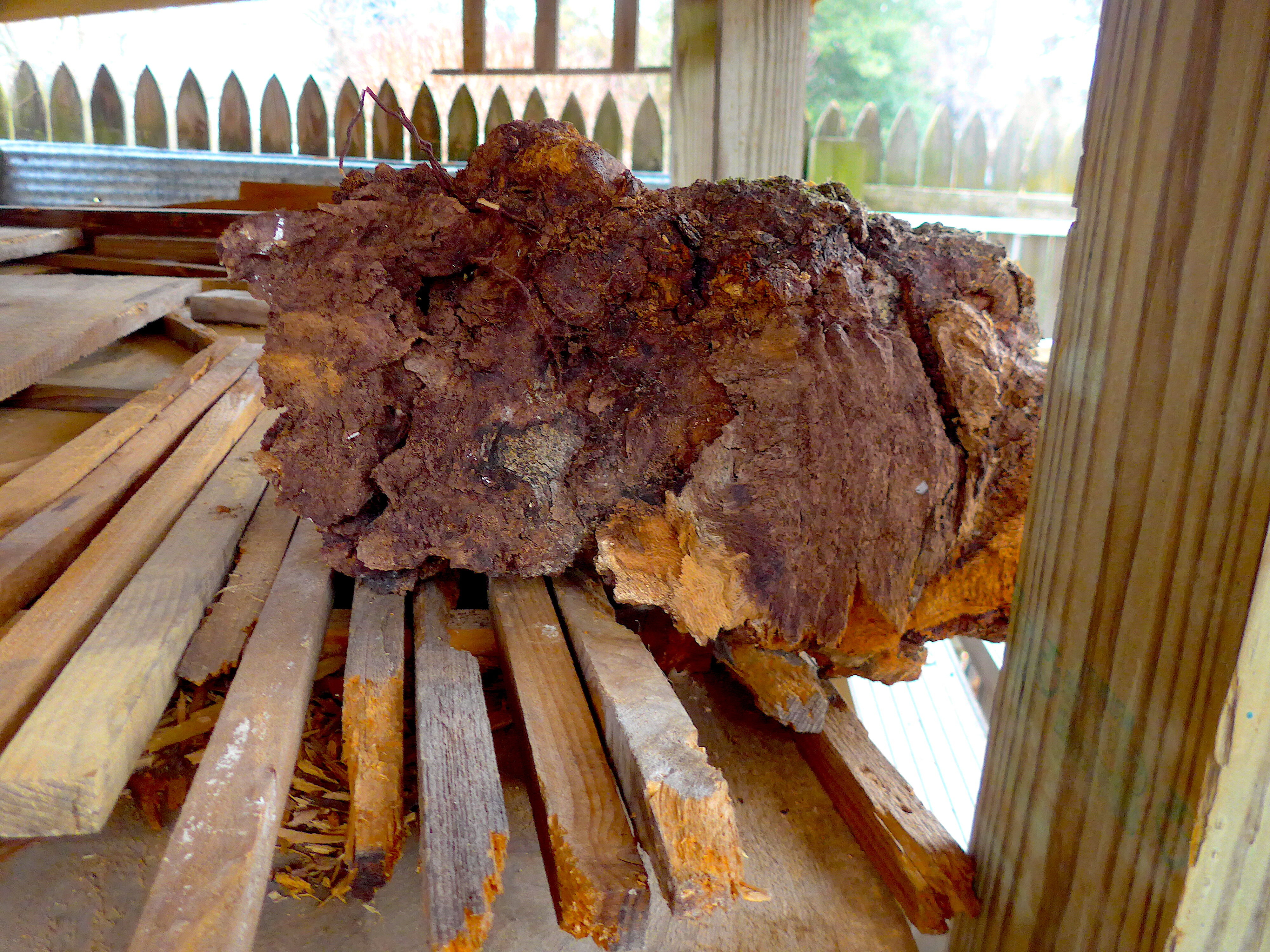

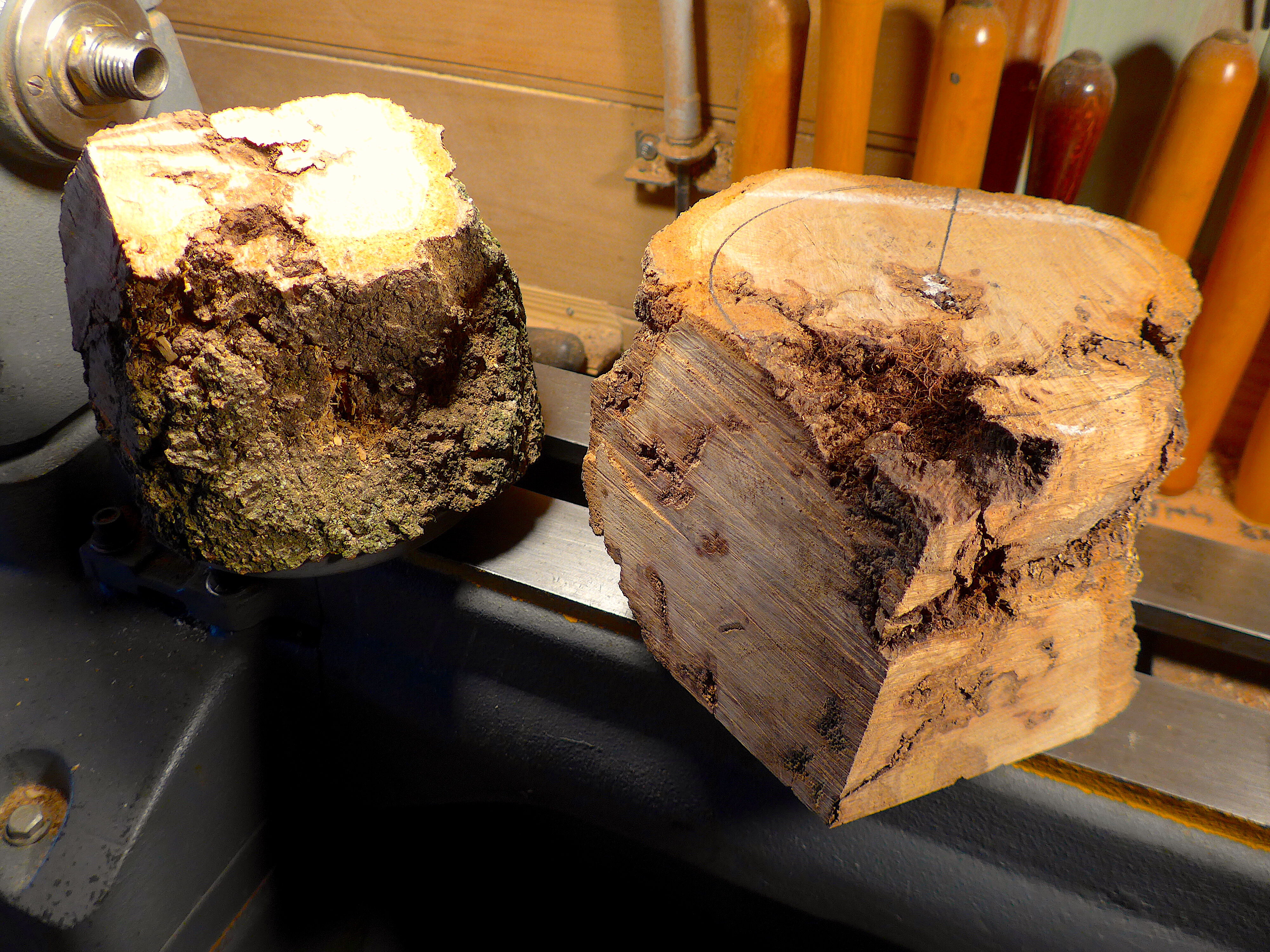

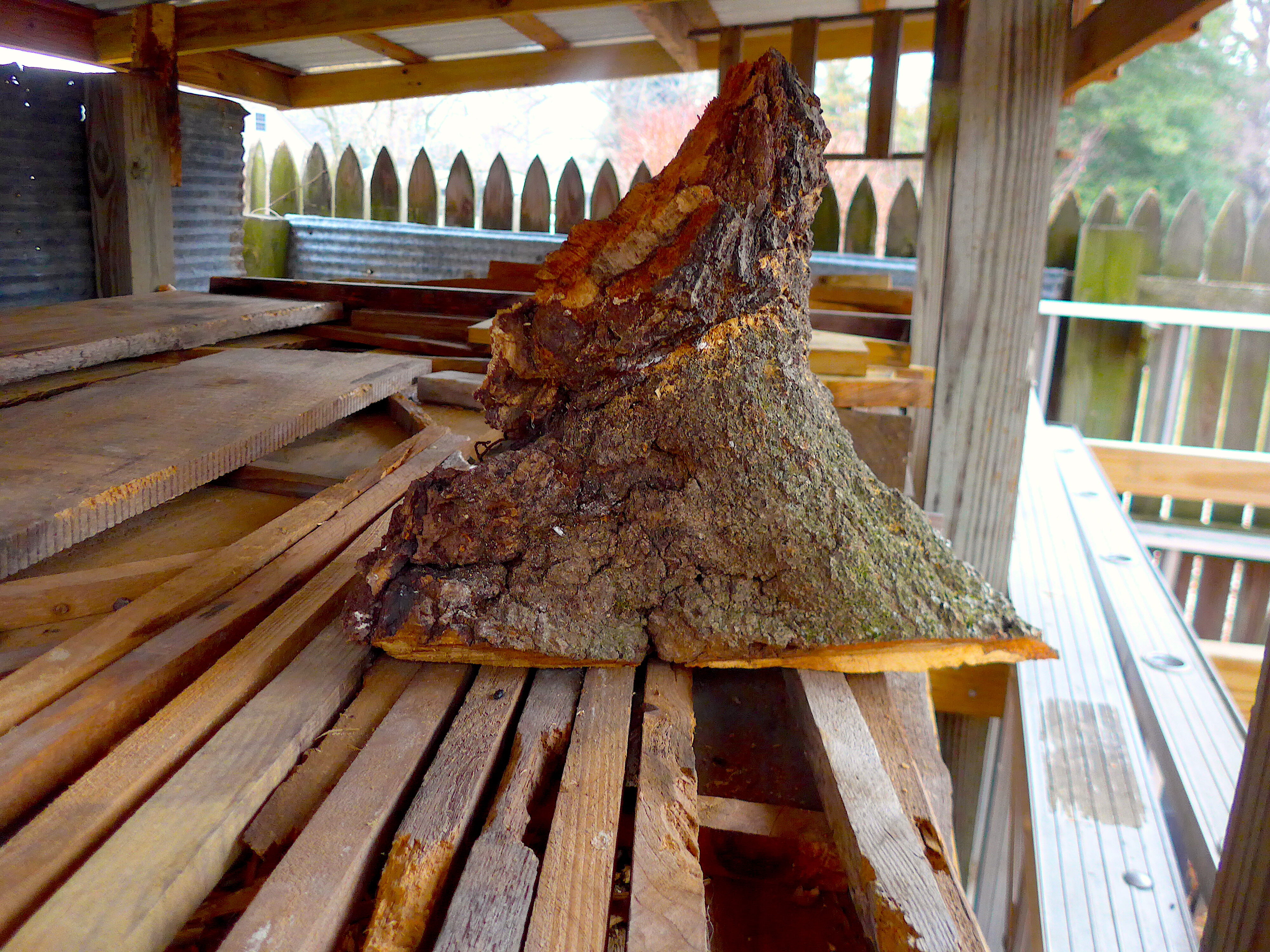

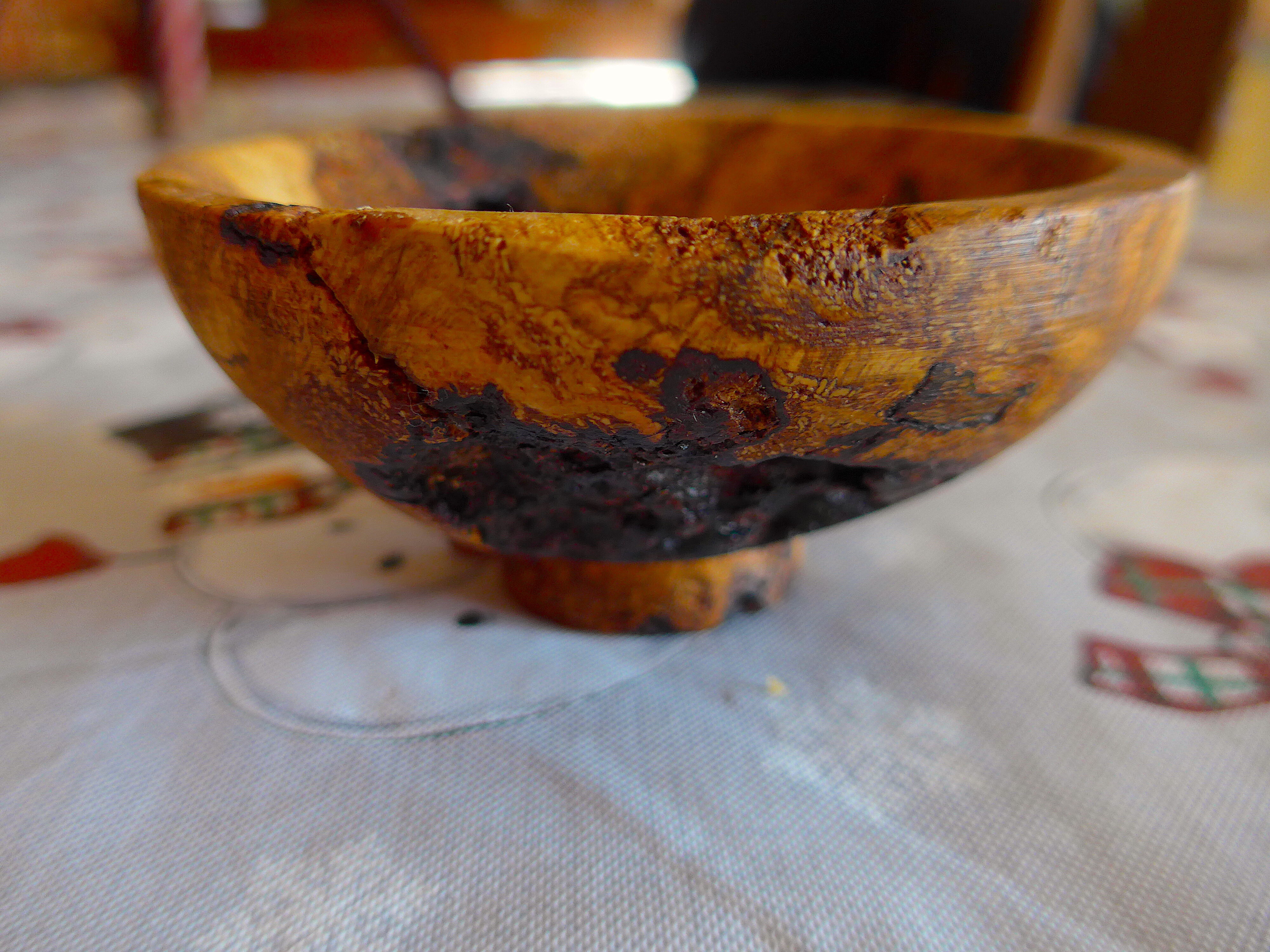

If I remember correctly. Lew had asked the members here to post their burl wood. Here's a couple that I have. The first one is shown next to a 3" face plate and I wonder if it can be turned??? The last two photos show the another burl from different sides. Both are red oak!L1110678.thumb.JPG.aa7aa3b450a7ac246fe823d5d9388121.JPG

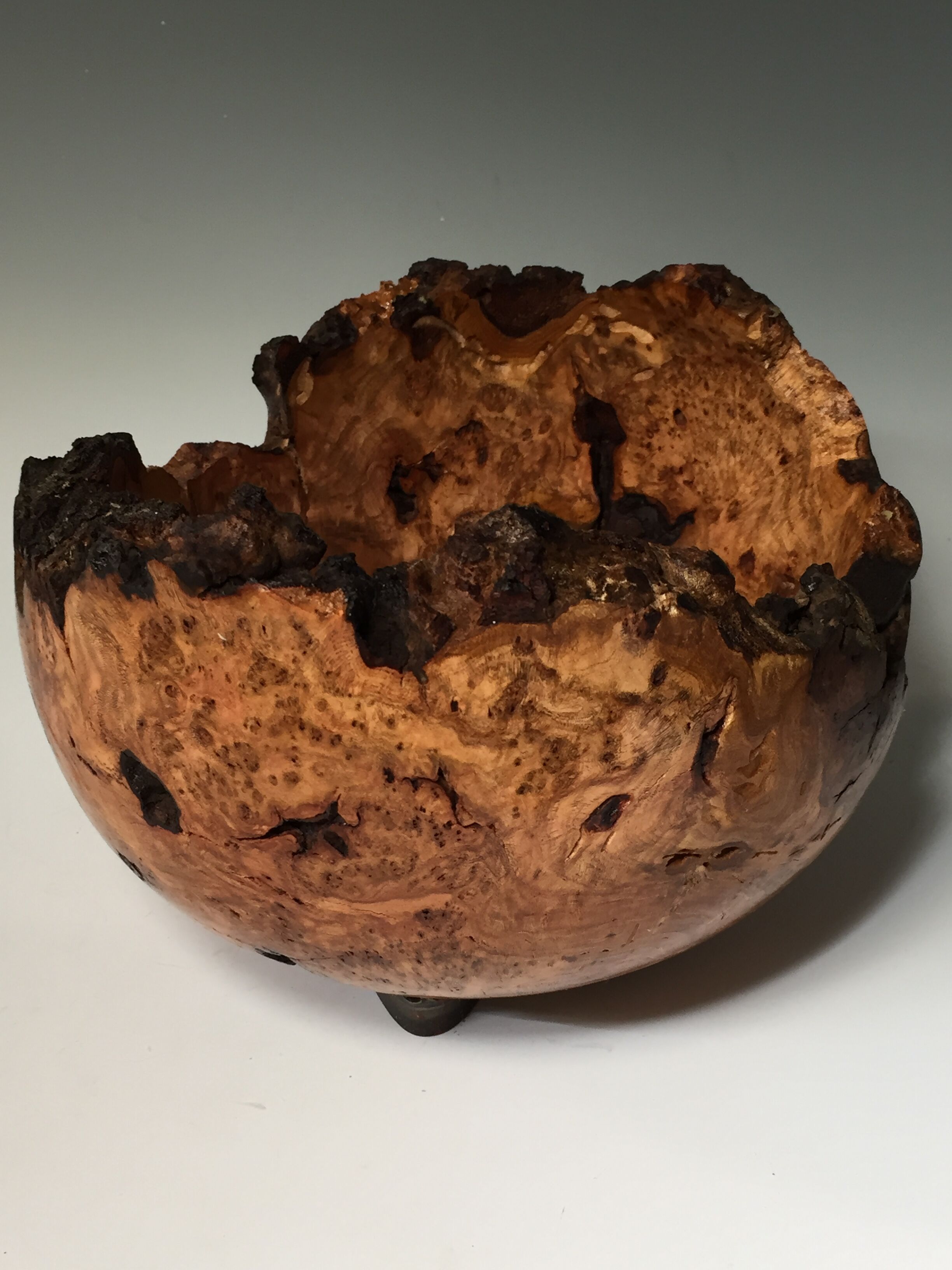

  • Have to take pics of the uncut cherry I have in shop but here are a couple completed bowls.  this was a commission. Lady in NOLA cut this from a tree in her yard. I could not see a way to turn

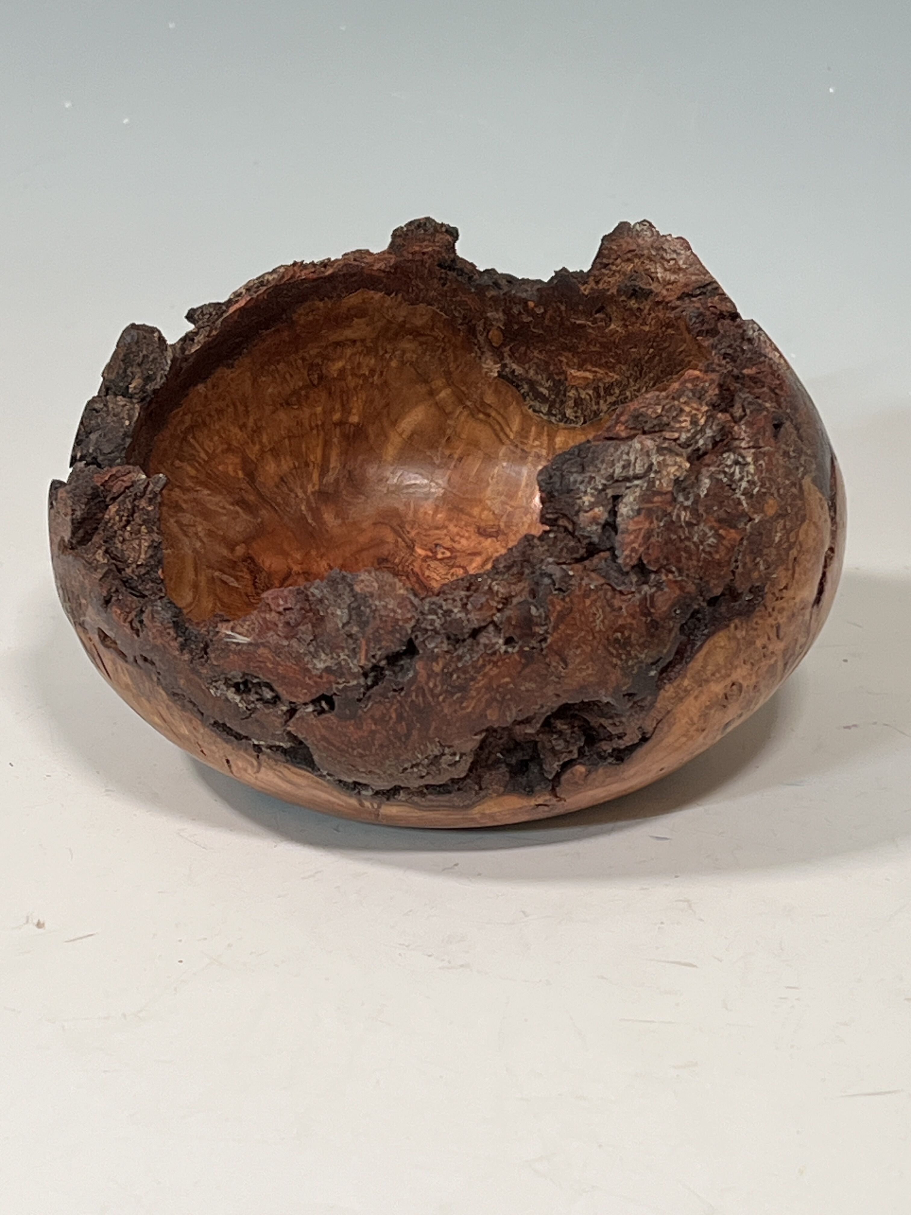

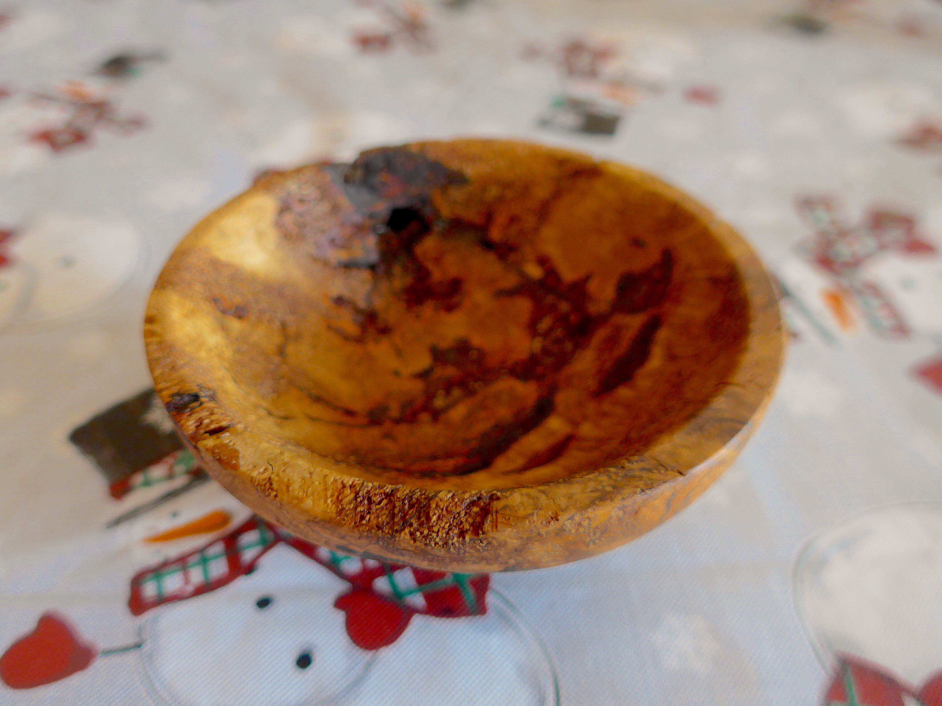

    Burl #1 is turned and finished. I was afraid to make the walls any thinner because of the inclusions. My wife wanted the spigot left on... I can remove it any time. Finish is linseed oil.
  • Gorgeous pieces, @Gerald
Awesome looking pieces, Rick. Sure looks like they could all be turned. It's amazing how ugly they can be on the outside and beauty hidden inside!

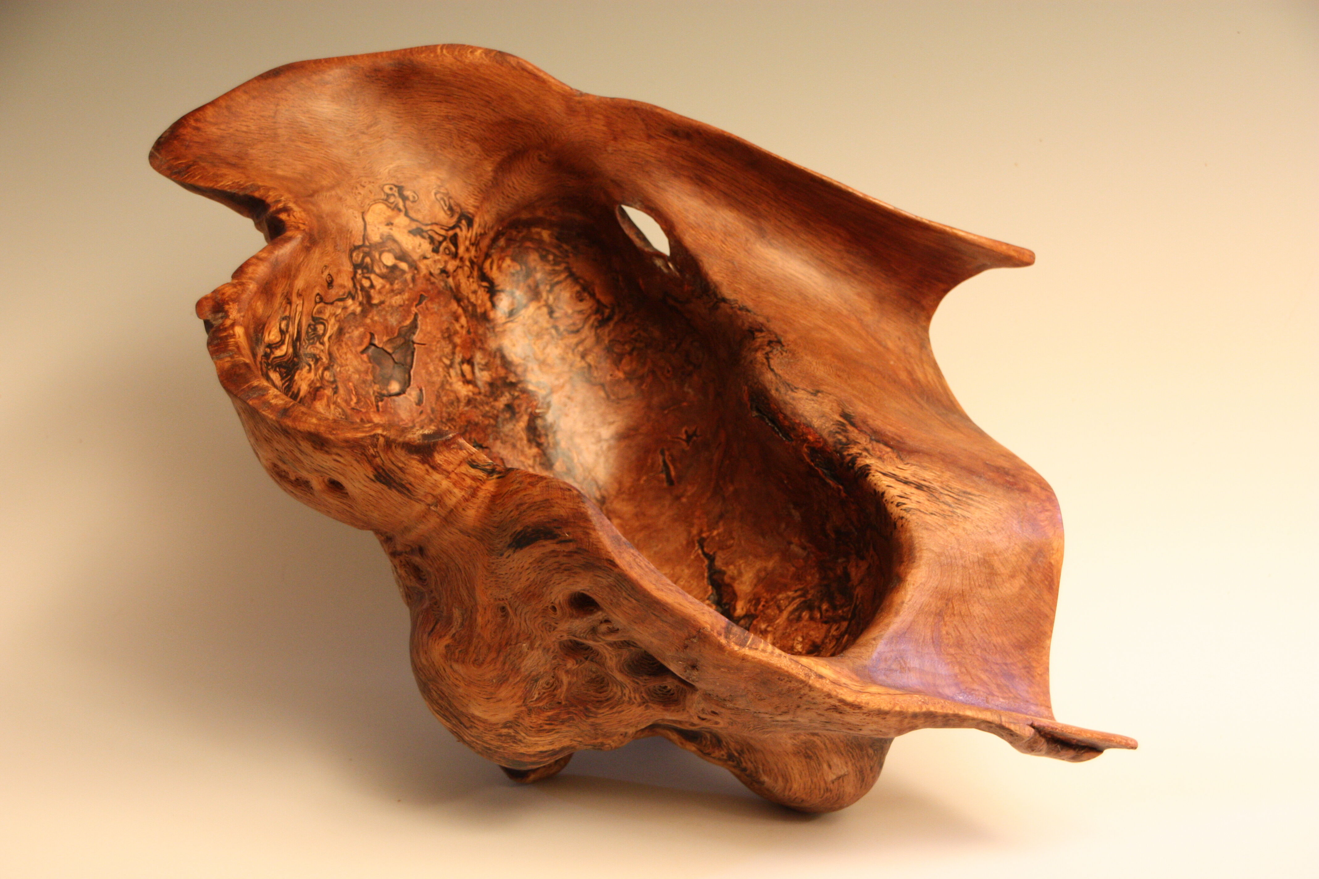

this was a commission. Lady in NOLA cut this from a tree in her yard. I could not see a way to turn without really cutting it up p and it had beautiful swirls under the bark. Turned a bit yo hollow and then power carved. I found it to have 3 ways to display. This is the one I like best. This one is live oak.
Forgot about this one. It came apart and had to glue it back together so is a little thick.

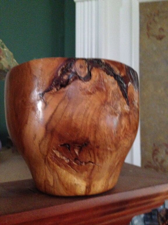

IMG_4345.thumb.jpeg.d1a5dbeac3398818d265aad47ebbe59c.jpegI call this one Jeremy’s Bowl as my oldest ga e me the burl he discovered in a workshop. This was only half of the burl with the tree min the middle. IMG_0878.thumb.jpeg.ea6701def062fb49e86fa72ec85fe53f.jpeg
A friend gave me a gigantic cherry burl plus two more smaller but still good sized ones. I mad this bowl for him. Had no problem with bark coming off and it did not break.Just maybe I am getting better
Burl #1 is turned and finished. I was afraid to make the walls any thinner because of the inclusions. My wife wanted the spigot left on... I can remove it any time. Finish is linseed oil.L1110683.thumb.JPG.496a28cb047db8810245464b43859bf5.JPGL1110684.thumb.JPG.291134401234e7d2d0fc3d64e28638e1.JPG
That sure is beautiful!!
I think leaving the natural inclusions really accents the work of Mother Nature.
I leave mine a little thick also , especially when I have to glue it back together. Is it not funny that there are so many patterns in a burl?
I like the shape of it and for the thickness that's up to what a person likes. Nicely done.
Beautiful piece of art Rick. Well done.:TwoThumbsUp:

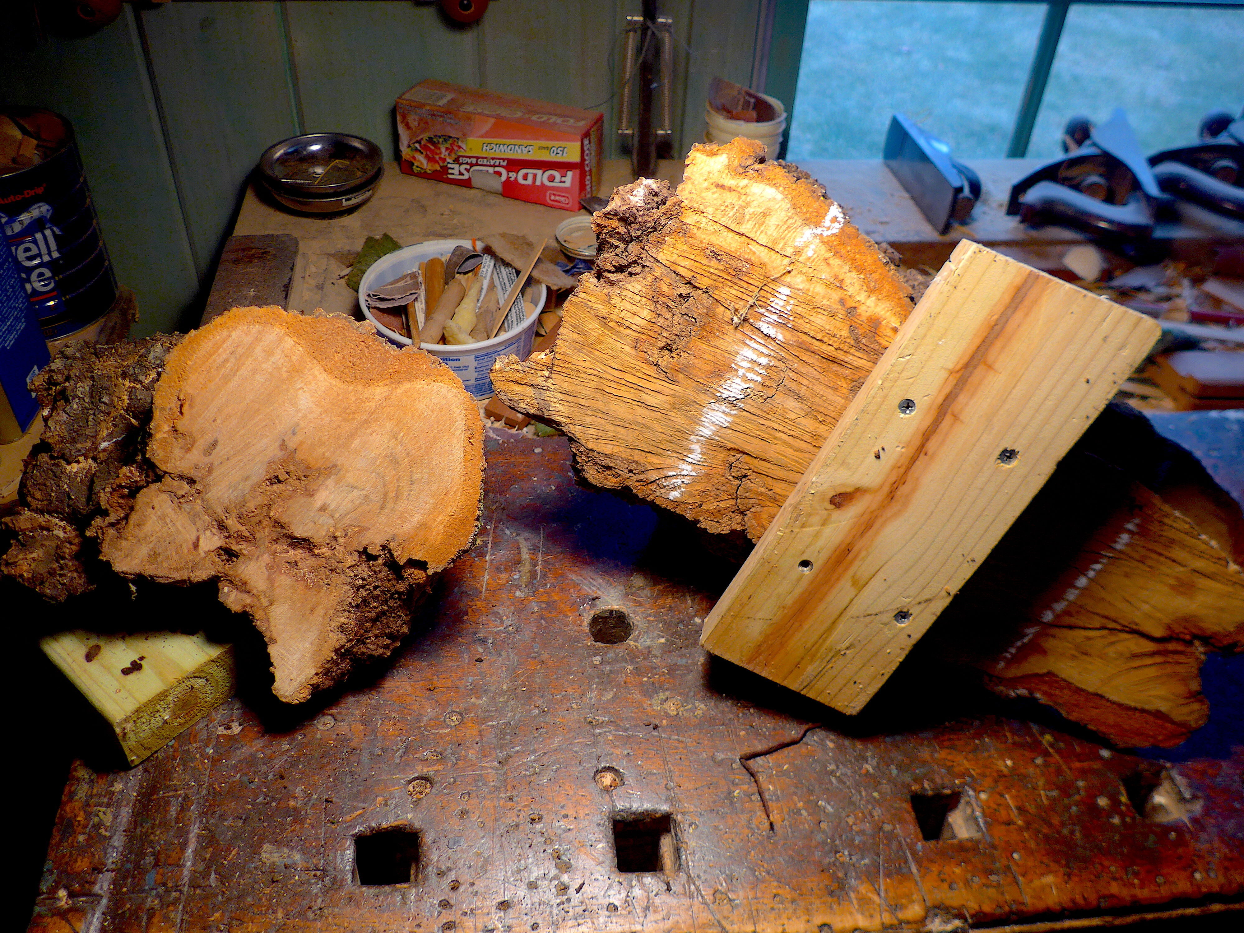

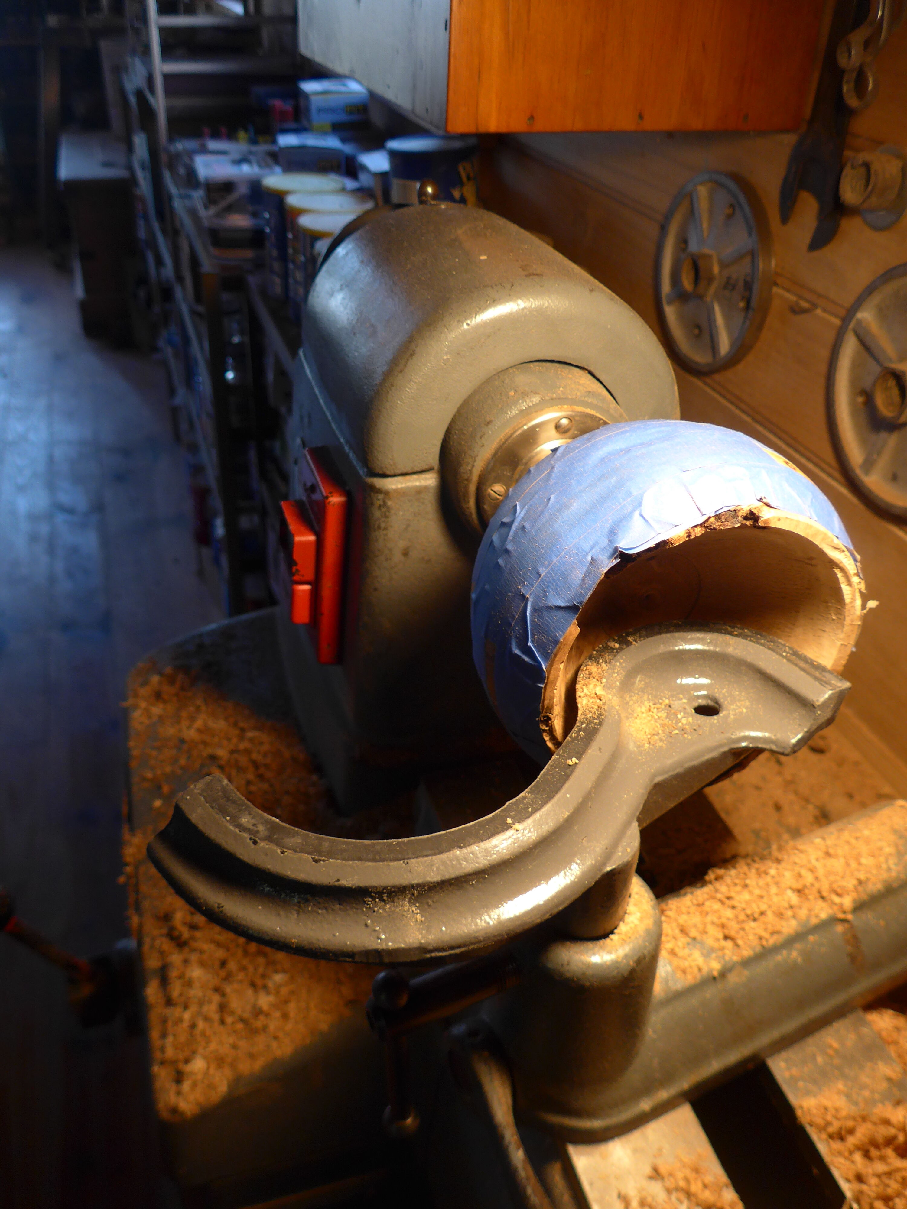

I'm in the process of cutting down my big red oak burl into smaller, turnable, chunks of wood that will fit on my lathe(16"). I've used a screwed-in-place 2X4, to be able to hold things in place while I use a handsaw to take off the extra wood to balance the pieces. We'll see where this goes!L1110691.thumb.JPG.afc08555b321a27e4484438c07ea5952.JPGL1110692.thumb.JPG.d3c66a70e5eaf989209b0b6c4aee1247.JPG
Burls cut down to manageable sizes. In order to have them fit the lathe, I had to use a hatchet to knock off the sharp corners. These things are HARD wood.This allowed them to spin without the corners clipping the banjo or tool rest. Things are still somewhat unbalanced but 10 minutes, with a roughing gouge, should smooth things out considerably. Now, for what lies within!!!L1110695copy.thumb.JPG.322a8819f237833707c5b10d60d8ad90.JPG

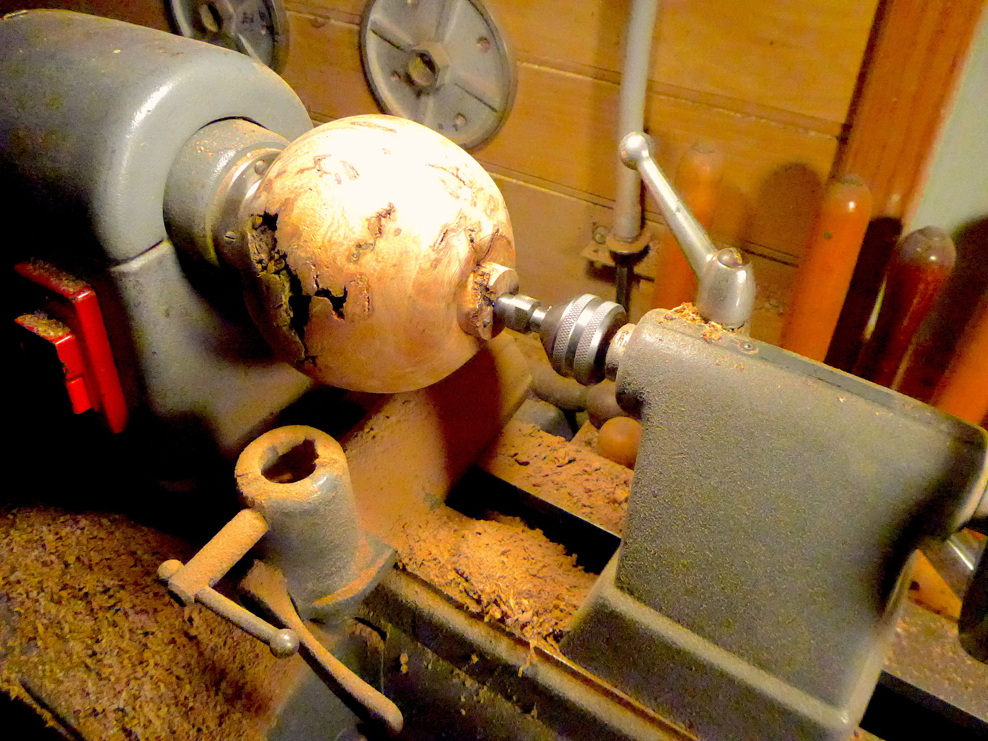

The outside of the larger of the two burls is turned and I'll do the inside tomorrow. May the inclusions not cause me a problem.L1110696.thumb.JPG.a9b576f6750ca29c15eacd4eef8bcb17.JPG
Love the shape!

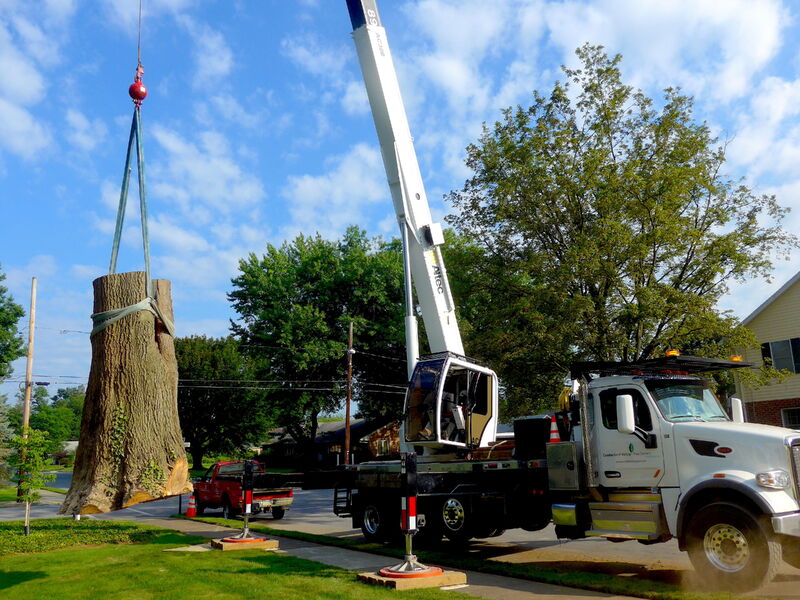

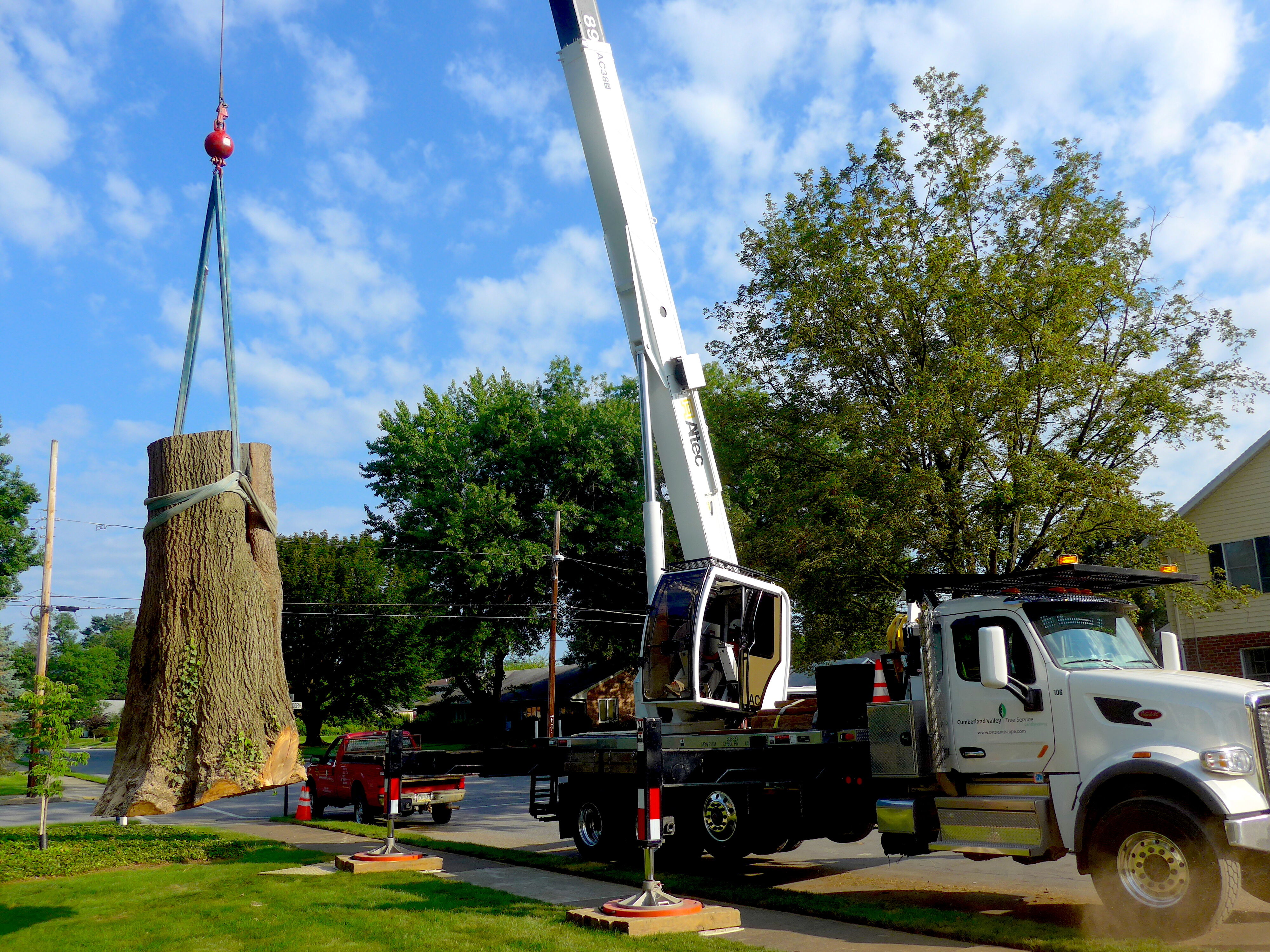

Here's the parent of my burls. Taken down in June 2025.L1100347copy2.thumb.JPG.834663c68a0479f445fa5c435d4d343e.JPG
