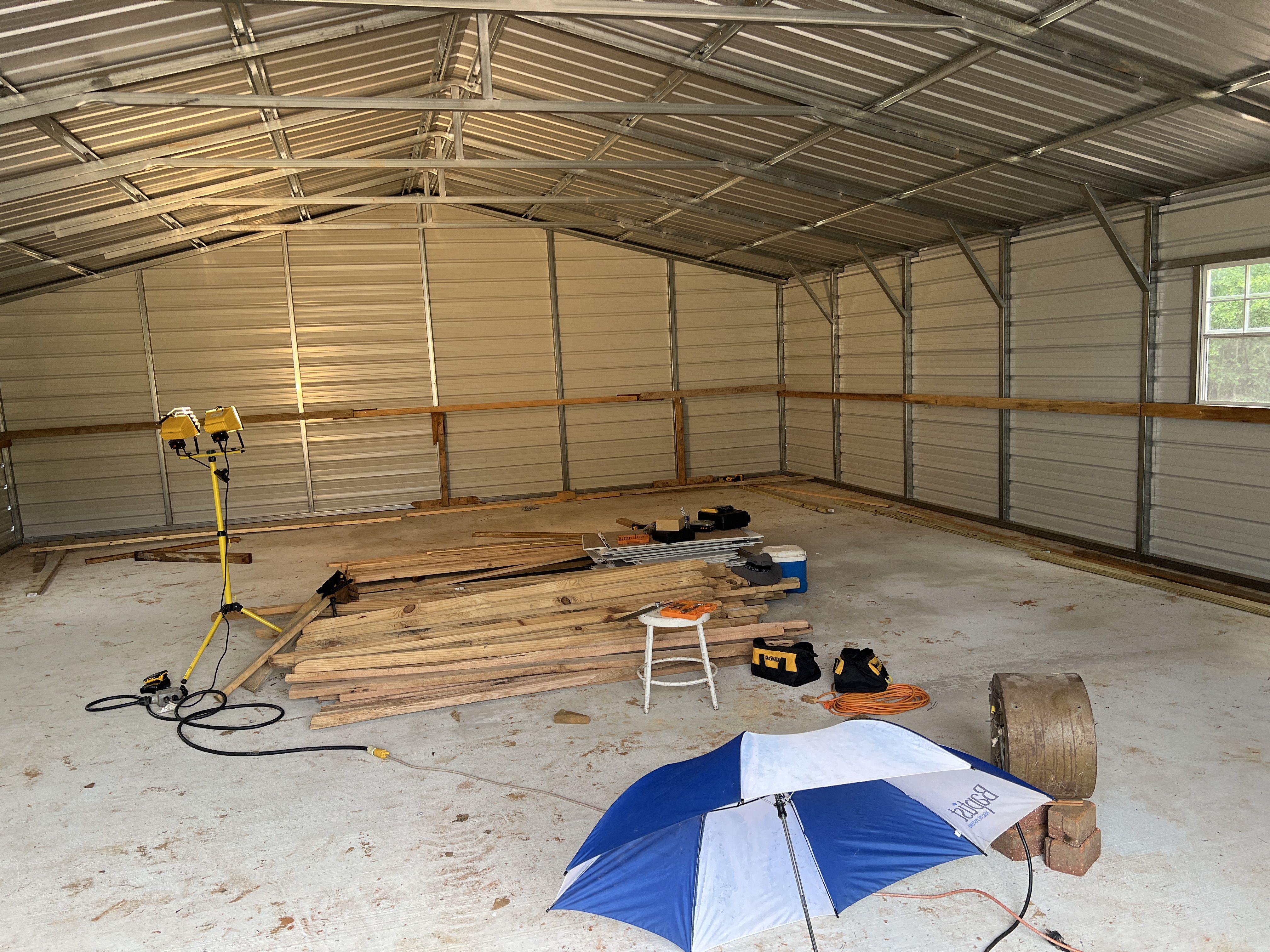

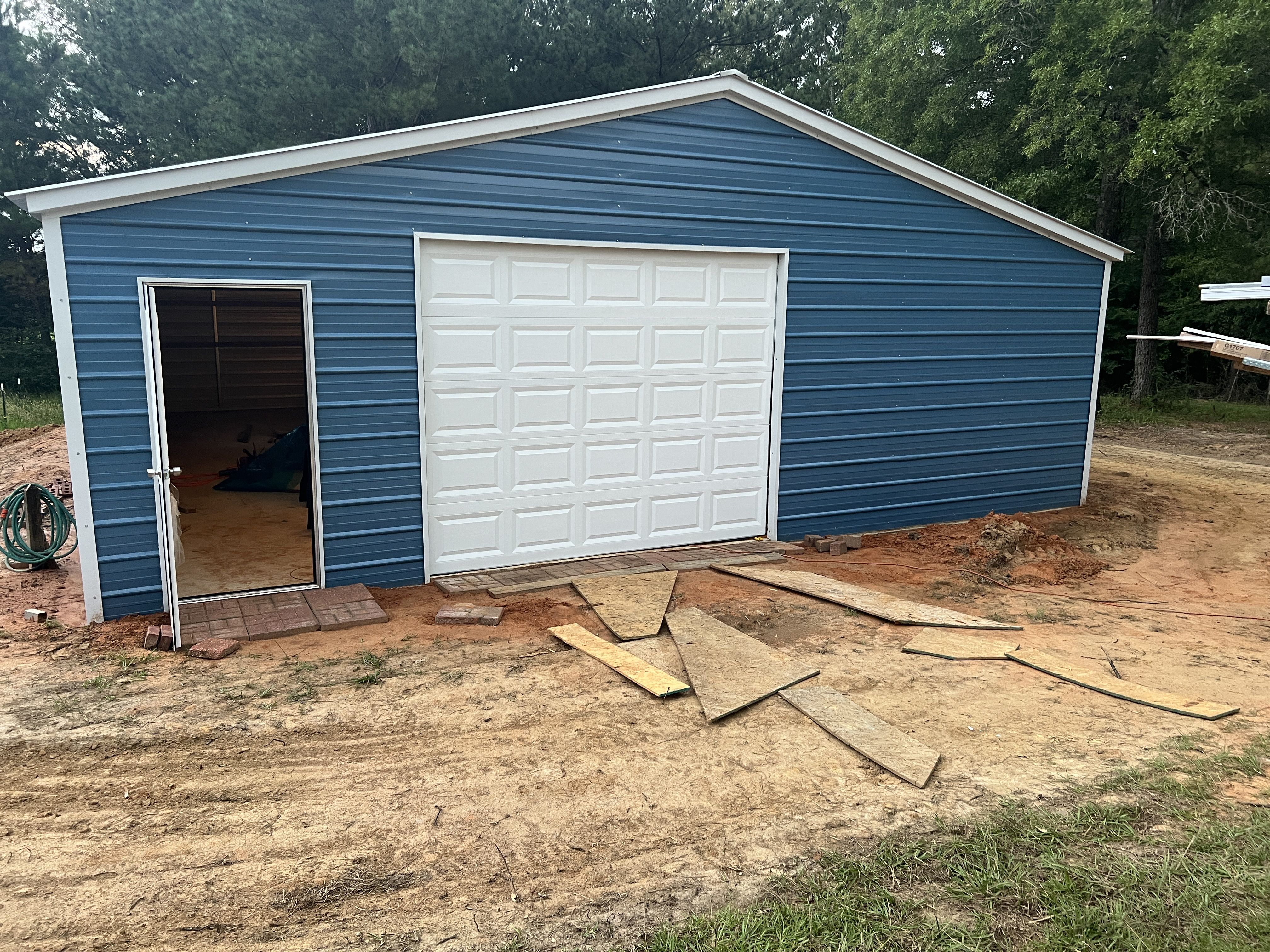

Today’s results. Moved lumber into shop. Had an idea to put brick under eaves of shop to control erosion til grad gets started, but have to get the dirt work done before can start grass. Got half the battens up for anchoring the walls. Ordered nails from HD and the delayed delivery til Tuesday. Guess I will go to Ace now.

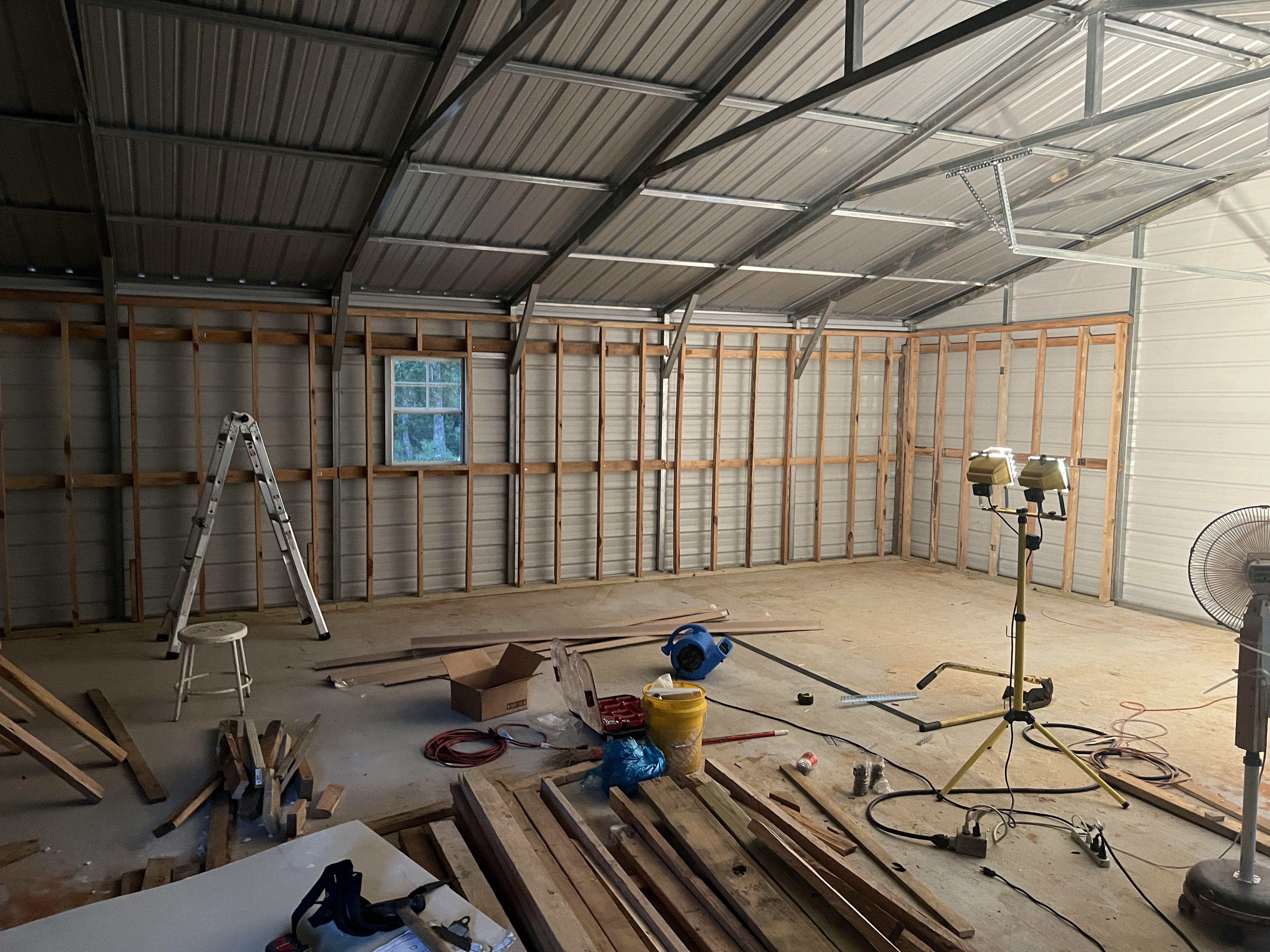

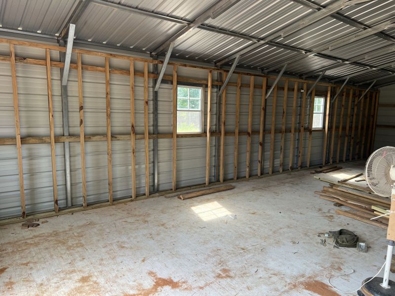

Yesterday was a hot one. A friend is helping me with the walls. After making a few mistakes we got rolling. Managed to get one 10 foot section of wall up and put the next section together. As we knocked off noticed we did not frame out the window.

Yesterday they taped and put on scratch coat of mud. We worked on shop wall framing and finished the East side except the windows. Also got the top and bottom battens in on the West wall and laid out studs to frame tomorrow. Hopefully we can get the framing finished tomorrow.IMG_0945.thumb.jpeg.ed706a02724869c85c3fcc0fc59c8fc0.jpeg
Finished the stud walls today. Stayed till 9 last night getting garage door installed. Turns out the opening is 1 inch taller on one side so will be looking for solutions. Started installing boxes for outlets today.
Door opens/runs best if level.  Add beveled strip to the bottom if the floor isn't level.  Top can be done best way if it is the culprit.

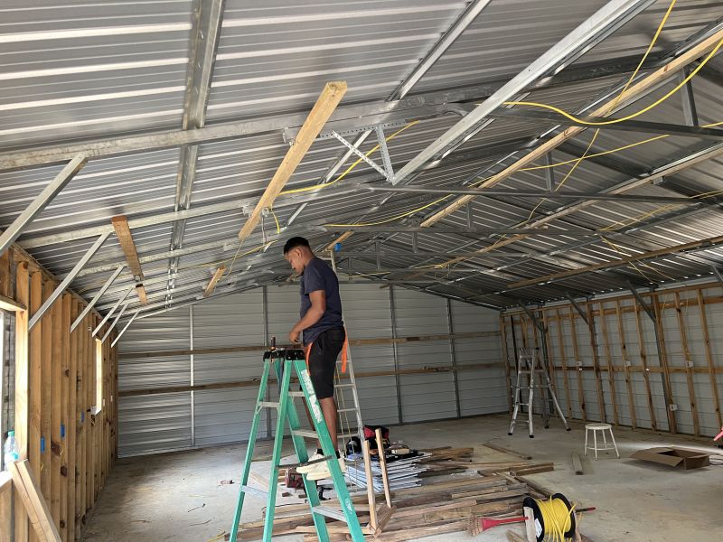

Lots of progress today. Trim carpenters started . Pictures are from about 3 so they did more after I left. Most of wiring in shop done today and finish tomorrow. Insulation will go in Friday. Worked on trench to bury cable to shed.

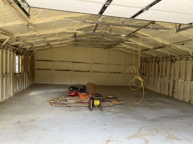

Nothing at the house today but got insulation at shop and I moved most of two loads of dirt to reduce grade around shop for mowing.IMG_0982.thumb.jpeg.db5a0d87ba7fcdf5cc29f887415b21df.jpeg
Guess I forgot to post this yesterday. Today I moved the plywood to shop . Scraped the foam off surfaces to allow top plates and ply to be mounted. Installed the top plate and called it a day.

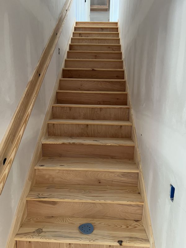

Almost forgot they installed stair treads and handrail today.

@Gerald...just thinking (well typing) out loud. Looking close at your shop picture, while the ceiling is still exposed and easy to route wiring, any considerations for outlet boxes and supports to possibly hang a couple ceiling fans? Might help in that Mississippi mud humidity circulating air from the mini-split. Just a random thought on my part.
