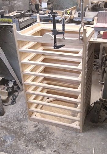

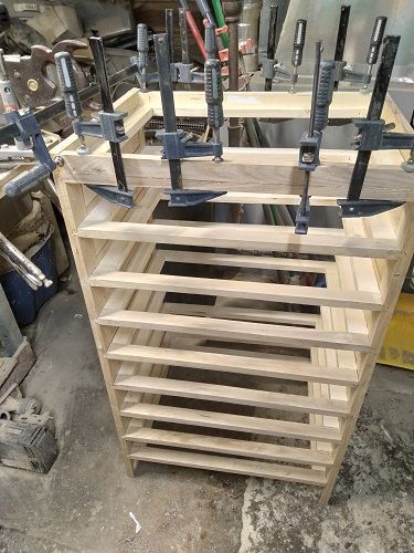

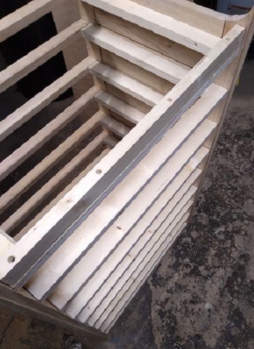

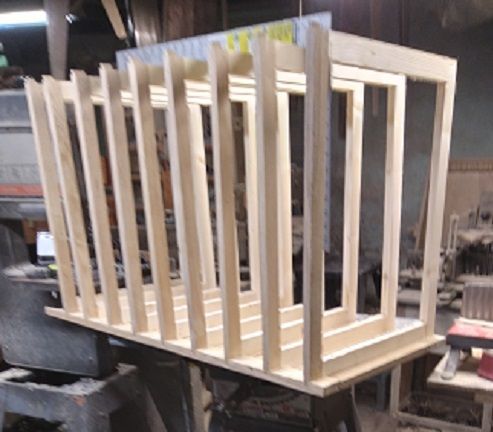

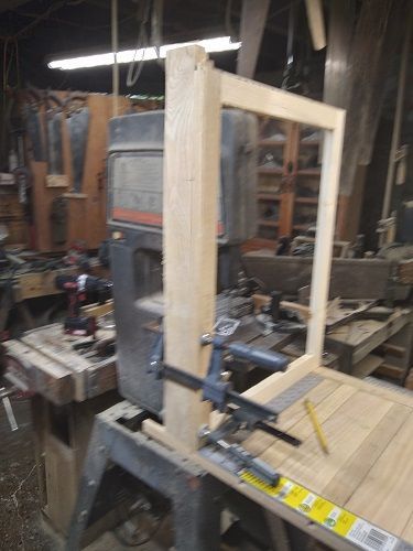

9 frames are done..:SaluteandRun:
Once the first dry fit was done..:TwoThumbsUp:

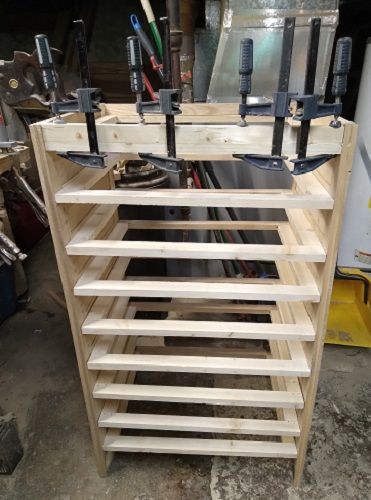

Decided to go ahead and install these into Side #1...:ChinScratch:
Keeping things squared across..drive the screw at the back first..:OldManSmiley:
and work my way along..:Cheer:

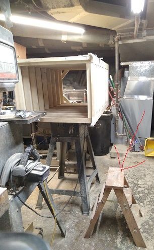

Until I got here...then the real fun began....remove this from the assembly table..place side #2 on the table..then install all them frames into Side#2..glue and screws..:JawDrop:
Then stand it up on it's own 4 feet..:TwoThumbsUp:
Next trip to the shop? :WonderScratch:add the back to square the case up.   There are 2 pieces to glue to the front, yet..:Tapping:
one across the bottom, and a smaller one up at the top..:ChinScratch:
Start time today? 0855hrs...quitting time?  1145hrs..:KooKooClock:

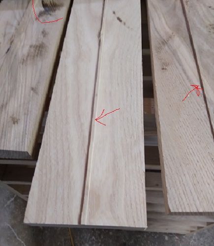

    3 planks have been sent to the shop..for now.. Back 2 were from the same 10' long plank..front one was a close match...except for.. This little area..which will be headed for the
  • steven newman
    steven newman
    Last night, tried the shop for an hour (not a good idea) and hauled that short, knot infested plank to the shop.. Yep, that one...and after removing the knotty parts... Ripped th

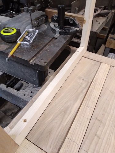

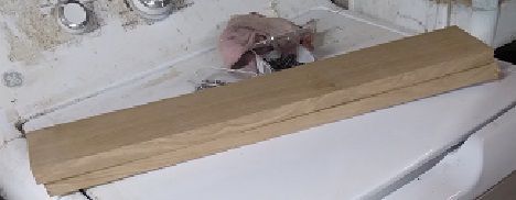

Seems I needed a few filler strips..cross cut the 4 footer down...top filler needed ripped as it was too tall...:ArguingSmileys:
This serve 2 items...a place to attach the top of the plywood back (easier to find) and...diagonal corner braces connect this to the case's side...then a slot is drilled in the braces, and I used a screw through that slot to attach the Top to the case..I also added an Ash filler up front..:OldManSmiley:
Will sand and level nice and smooth, to blend it in...:TwoThumbsUp:
There is a Pine strip for down at the bottom..:ChinScratch:
For when I can flip the case over....and, there is an Ash one....:TwoThumbsUp:
That will need glue blocks behind it..:OldManSmiley:

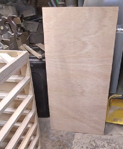

Today's "schedule"?   Cut the back panel to size, glue and screws to install..LONG clamp to pull into square, IF needed ( always is..:BangingHead:)
Supposed to get up into the mid 80s, today...I might just hide out in the shop...:rolleyes:
Stay tuned..:cowboy:

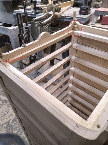

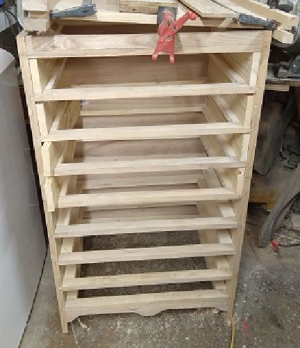

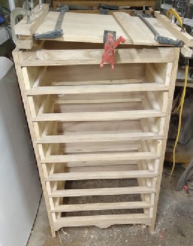

Ok..2 hours on a Sunday, in the shop....hauled this downstairs to the shop..:SaluteandRun:
Will need trimmed for size, as soon as I figure out what that is to be...:ChinScratch:
First off..I needed the pine filler installed, the one at the bottom of the back of the case...:WonderScratch:
Glue and 4 counter bored screws..then marked the plywood for length and width...:OldManSmiley:
Cut a few corner braces..:ChinScratch:
Glue and a few more screws..and an assist from a clamp, to pull them in tight.  These are to get a slot milled in them, to attach the Top of the case in place..slots allow the top to have a bit of wood movement as the weather changes..
Set this out of the way for a bit..:Cheer:

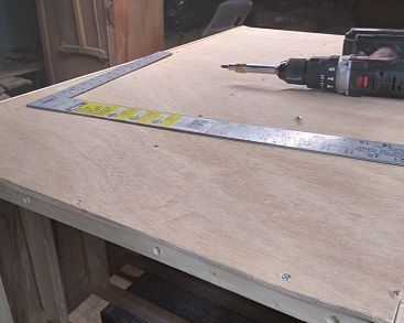

Cross cut the plywood for length...width?  Needed about that much peeled off one edge..:ChinScratch:
About the width of 2 saw blades...then clear off the top of the tablesaw..:SaluteandRun:

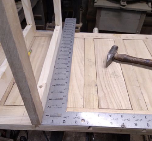

Plan here, was to install one edge into a bed of glue, and get it all screwed down,,,Had to make a mark at each Frame's center...as I can't see through plywood...:WonderScratch:

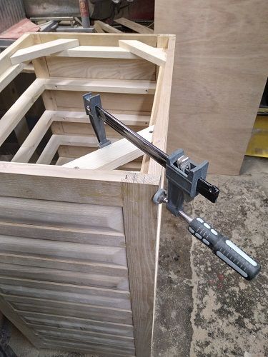

That done, had to spin the case 180...place a 3/4" Pipe Clamp and pull the case into square-ness..was just under 1/4" out...then screw this side off as well..THEN that step stool got used..:TwoThumbsUp:
I used a BIG square to reach across and line up with those marks I made..come out about 12-13" and install a screw..in each location..other than the top and bottom fillers..:OldManSmiley:

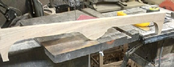

Fun part was setting this thing back down on the floor..had a fancy Ash filler to install..so I just set the case down on it top..There was a problem, though..:MachineGun:
As this sort of thing just will not do...tossed it out..cut a new one that DID fit:PullingHair:
Glue and screws, again..:TwoThumbsUp:

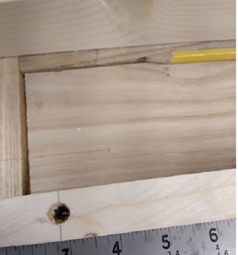

4 counter bored holes? the reason for the 5th?  pilot hole drill bit snapped off just below the surface,,:ArguingSmileys:
Replaced that...and added the corner blocks,,,and a couple extra screws...bad luck still going on...:BangingHead:
Arrow points to a split, being repaired...even though I pre-drilled the hole..so now I have to wait on that to cure..:Tapping:

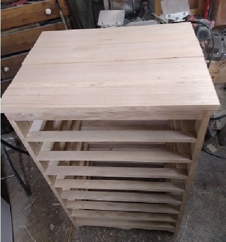

Don't you just hate it when you drill and still get those splits. Great follow along and now to bed.

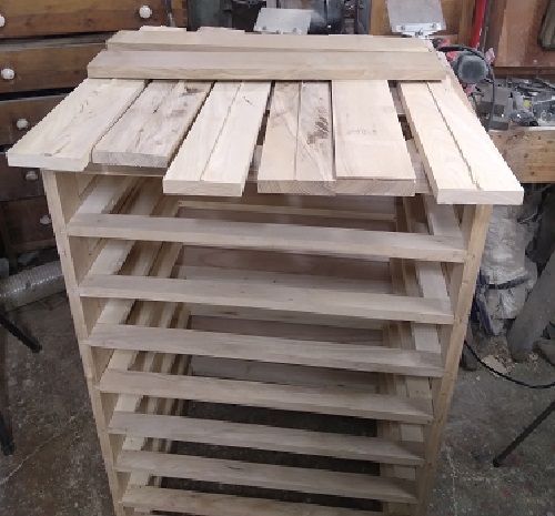

"Fetch & Carry"  is an old term from the English Army...what we would call a "Work Detail"....where you were to go Fetch items, and carry them for units NOT on Work Detail....

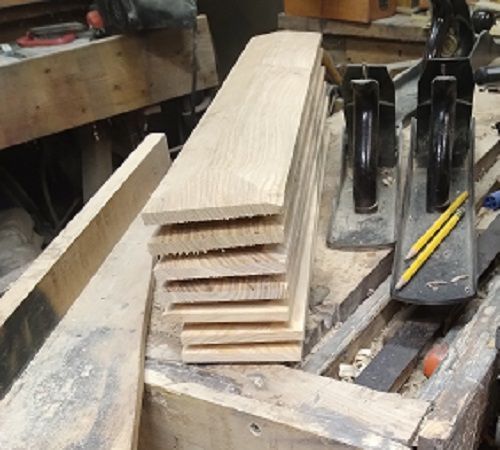

So..part of today's tasks, was to Fetch & Carry planks to the shop...fist batch was cut up into blanks for 8 drawer fronts..
And some (most) needed resawn down to 3/4" thick...saw doesn't quite reach all the way..
This will have to be removed...2nd trip?
Was these 2 planks..which were then sawn up to make..
4 blanks to make a panel for the Top of the case..
Needed to put away a lot of stuff, though..
To have room to run the Jointers..
At this point, I decided to call it..
Sweep up and Quitting time!  Was getting too hot in the shop..
Stay tuned..

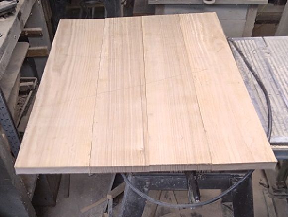

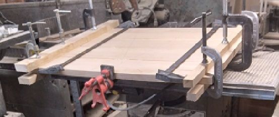

0855 start time, this morning....quitting time was 0955hrs...:KooKooClock:
Still cooling down at the moment....while doing the Photo Edit stuff...busy day, this morning?:OldManSmiley:
yeah , you could say that...:ChinScratch:

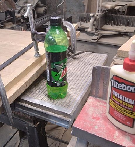

Started with these...until..:TwoThumbsUp:
Dry fitted...then..:SaluteandRun:
We have Glue Up!  :Praise:
Next?  :Cheer:

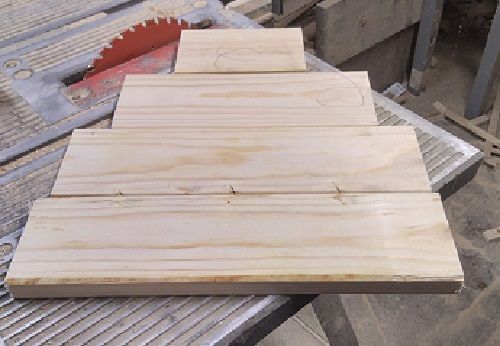

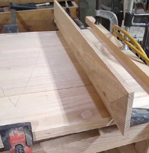

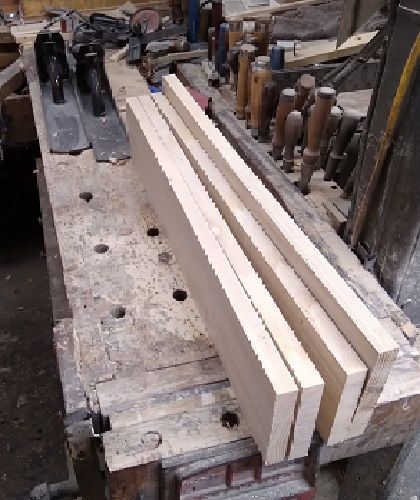

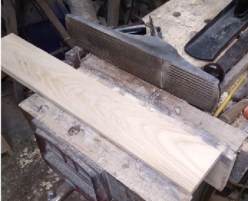

Have 6 blanks to clean up and level..this is a "Before", and..:JawDrop:
This is an After...:TwoThumbsUp:
The last of those 6 blanks was .."special":ChinScratch:
You can also see the first 5 that were done...why is #6 standing up?:WonderScratch:
I was getting too tired, to plane all of that off....we have ways..:ph34r:
THEN I can lay it down, and finish it up..:ChinScratch:
Had a spot right about there..that needed planed down level...:TwoThumbsUp:
Drawer front #7 and #8?:WonderScratch:
Didn't need much done to them...:ChinScratch:

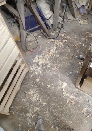

Late night..shop had cooled down..
So..I made a mess on the floor..
Tilt the blade to 15 degrees...add the Zero Clearance Overlay...set the fence 3/8" away from the "bottom" of the saw blade...
Turned this into Raised Panel Drawer Fronts...as for the drawer at the bottom of the case..
Opening was a bit smaller than the others...this was ripped to width BEFORE all the raised panel work...
stay tuned..

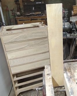

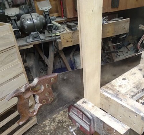

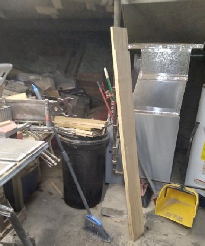

Late start this morning..back to Fetch & Carry, again..:SaluteandRun:

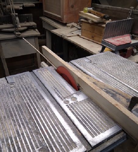

Pine, 1 x 4 x 8'.....when my 5'10-1/2" frame has to duck to get down the shop's stairs...2 planks was about enough, for one trip..:rolleyes:
Before I could use the saw to cross cut...I had to "Un-Bevel" the blade..:OldManSmiley:
Back to 90 degrees..need 16 parts, about 18" long, or so..cutting around a few knots..and winding up with these shorties..:WonderScratch:
That I could use on a future Project..anyway..:ChinScratch:
This is what those 2 planks gave me...had to trudge back upstairs, and Fetch & Carry the other 2 planks..and see how it goes..:Cheer:
All 16 sides have been fitted...bottom drawer needed skinnier sides..:ChinScratch:

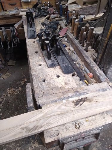

Unable to clamp the drawer fronts to the edge of the bench, in order to use the Stanley #45 to plough a groove for the drawer bottoms..due to the beveled edges.:ArguingSmileys:..I set up the tablesaw to do the same grooves..in 2 passes..:TwoThumbsUp:
Forgot to take the Phone/Camera along..was only to be a set-up trip..:BangingHead:..I guess I could go back to the shop, but the tablesaw is now put away...and the router table has been brought out..will set that up, tomorrow...:SaluteandRun:
