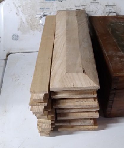

Not all that much...Had to fine tune the rebates on 8 raised panels..as soon were a bit FAT..:JawDrop:
And would not let the rails slide on all the way, without binding...so..:ChinScratch:
Clamped the panel to the vise, and run the Craftsman No. 3720 along, until the rail slides on..:OldManSmiley:

Same board...was also sanded to 180 grit...now...repeat for the other 7 panels...:SaluteandRun:
Stash those aside..have 9 rails to get ready, too..:Cheer:

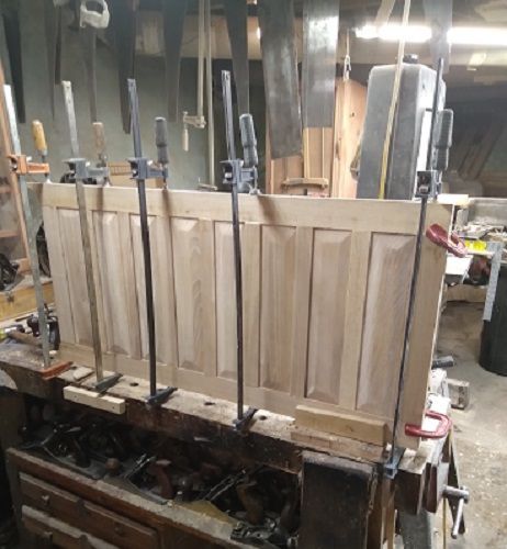

Set up one stile in the jig...with the best face towards me...then add glue to each tenon, insert into a mortise...Raised panel is next, with a small dab of glue centered in the groove..repeat the above until..:ChinScratch:
The fun can begin ( and the cussing:ArguingSmileys:) add glue where needed, and start to install the other Stile down onto the tenons....with the usual "Hammer assist"..add a few clamps.."adjust a couple rails" until they drop into their mortises..add more clamps..rag to remove any glue runs..:Cheer:
Add a few more clamps to center up the rails with the stile..:OldManSmiley:
And, call it a morning...Friday? :WonderScratch:  Need to start work on these 2..

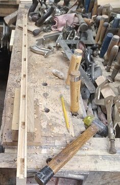

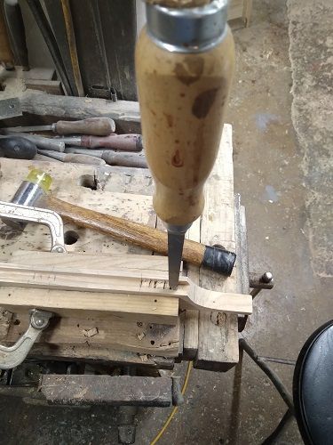

Tools used today...USED..:rolleyes:
10mm Mortise Chisel, 8mm "Pry Bar ( to clean out the chips) and a Hyper Tough Mallet..:OldManSmiley:
Digging a hole..:rolleyes:
4 whacks, 4 spots...2 trips along the Mortise..then clean things out.  Repeat 17 times..:JawDrop:
Moving the stile along as needed...( working way too hard, for a Friday:DevilLaughing:)
Some were a might too tight..:rolleyes:
Stile does have slight bow...will pull in when the WebFrames are installed..:TwoThumbsUp:
