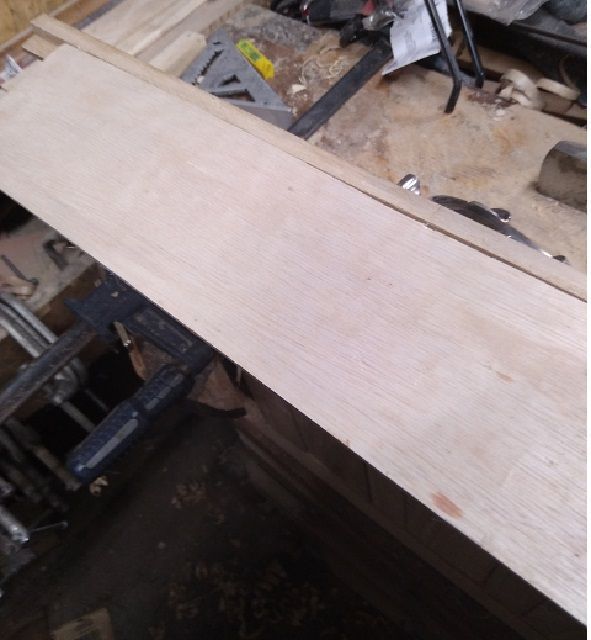

Popular Post steven newman Posted May 11, 2024 Author Popular Post Report Posted May 11, 2024 Shop Start Time: 1300hrs Shop Quitting Time: 1520 hrs.. Results? The inside view of Side #2, and.. Tools used today (besides a BIG Mallet) And a couple sanders... had 8 raised Panels to clean up and fitted...and 9 rails needed cleaned up... Awaiting assembly..calm before the storm.. Some of those raised panels.... Needed quite a bit of work... Letting this sit overnight,,,start on Web Frame parts, tomorrow? Stay tuned.. Grandpadave52, Cal, Larry Buskirk and 4 others 6 1 Quote
Popular Post steven newman Posted May 12, 2024 Author Popular Post Report Posted May 12, 2024 Side #2 is out of the clamps! With Side #1 standing behind it...seemed to match each other fairly close.. These 2... Needed to be cross cut down to ~24" strong.. Got 4 blanks! and 2 like this.. Firewood? Those 4 blanks needed one straight edge. to run against the rip fence.. Set to 1-3/8" width...needed 9 blanks.. had to trash that curvy one...ripped a replacement form.. Saving these "leftovers" to use as "fillers" between the top rail and the top of the case, and below the bottom rail..both get glued in place, later. The 9 rails were way too thick...I needed 3/4", NOT 4/4....so.. Set up the peel the worst face off, and leave 3/4" behind.. All 9 are clamped up into a single block, right now..letting them get used to things after all that ripping going on.. Will need to get them all squared up, and cut to 23-7/8" long...the same as the 1/4" plywood's width. Plan? a 1/4" deep by 3/8" wide rebate down the back of the side's back stile...to house the plywood back...front rail will also have a 3/8" joint at each end..using a sliding dovetail.. Uses the same fence as the tablesaw, BTW. The pine runners (where the drawer slides on) will connect to the front and back rail, with Mortise & Tenons...tenons on the runners. A single screw, counter-bored a bit, will fix the back end in place, in a rail, NOT a panel.. Clear as Mudd? Stay tuned...could be a very busy week.. HARO50, lew, Larry Buskirk and 3 others 6 Quote

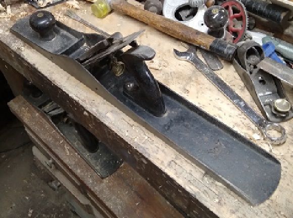

Popular Post steven newman Posted May 12, 2024 Author Popular Post Report Posted May 12, 2024 Laundry Detail, this evening.. Means I am down IN the shop...so... I made a mess on the floor...from.. A bunch of Ash Noodles... Had to move this away a bit..them cauls were a bit close to my arms... Tried to keep things square.. And to the right depth.. Until this sat flush...Finally.. 42"+ of rebate..one side done..I think side 2 can wait a day... HARO50, Harry Brink, Fred W. Hargis Jr and 4 others 7 Quote

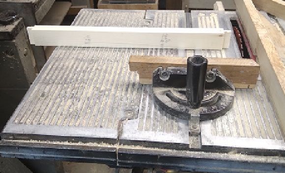

Popular Post steven newman Posted May 14, 2024 Author Popular Post Report Posted May 14, 2024 (edited) Router table fence...I used a slider.. 4 4 passes per rail...until.. Those 18 tails were done. The tails have to match up with this 3/8" dovetail bit.. Which gets used in a hand held router, later...to mill sockets for the rails to get glued into.. That Mortise? Is where the Pine runner's tenon is to go...so.. I had to change out the 1/2" Dovetail bit, for this 1/4" straight bit...add a second fence.. And "Start & Stop" lines.. One per end..until.. Now done with the router table, for now...moved it back out of the way...have a LOT on Pine to cut up, with the Tablesaw...again.. As I need runners for the drawers to slide on...and a rail across the back of the case to house the other ends of the runners.. Boss Comes Home, TOMORROW! Ever lose track of what day it is? I woke up thinking today was Wednesday.....Senior Moment? Stay tuned... Edited May 15, 2024 by steven newman Larry Buskirk, Harry Brink, Cal and 5 others 8 Quote
