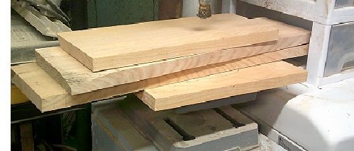

Bundle of blanks for the top of this chest of drawers...chewed up one will become one of the bread board ends...:ChinScratch:
Behind this pile..:DevilLaughing:
Are the 5 blanks for the drawer fronts...one is a bit too "plain Jane":ChinScratch:
Kind of bland....most of the rest look a bit better..:TwoThumbsUp:
may use a bit of the Replacement plank to replace the bland blank?  :WonderScratch:

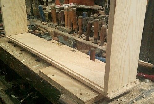

Drawer #1...getting the 2 sides installed..1st dry fit?:ChinScratch:
Second dry fit...:Cheer:
Getting better each time...:rolleyes:
Have to mark up the insides as to which goes where...Place drawer #1 aside..:SaluteandRun:
Work on Drawer #2  :TwoThumbsUp:
Set it aside and start on #3..:OldManSmiley:
Layout the "Tails" and then to the bandsaw..:SaluteandRun:
Why the bandsaw?  Because I can SEE where the cuts are going, trying to stay on the WASTE sides of the lines..more line I leave, the tighter the joint..then onto the chopping block..:DevilLaughing:
A plywood square, set up to protect the top of my bench from wayward chisel strikes..Extra bandsaw cuts help out with waste removal, too.:OldManSmiley:

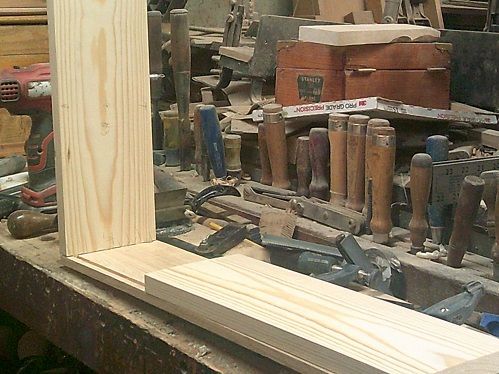

#3 Drawer..:WonderScratch:
Got one end done....looked at the other side piece..:WonderScratch:
Back and camera both said it was time to quit for a while...would need to plane that board flat, and then cut the tails...:GoodNight:

Wound up flattening that side for drawer #3 after all...15 minutes later...:TwoThumbsUp:
Now have 3 out of 5 done....will try to get the last 2 Saturday.....then it will be these two's turn..:SaluteandRun:
