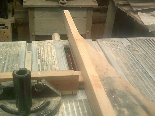

Kind of "Fugly"? :ROFL:  other board was only 8" too long..but the board was tapered...so, I cut the wider end...Next
Finished length will be around 40" or so...this allows me to trim the ends square.   These were run through as a rip cut..rip one edge, with the "better (Straighter) edge" against the fence...then flip the boards over, move the fence a blade's width closer to the blade..run run the freshly sawn edge against the fence...result is what you see here.:ChinScratch:

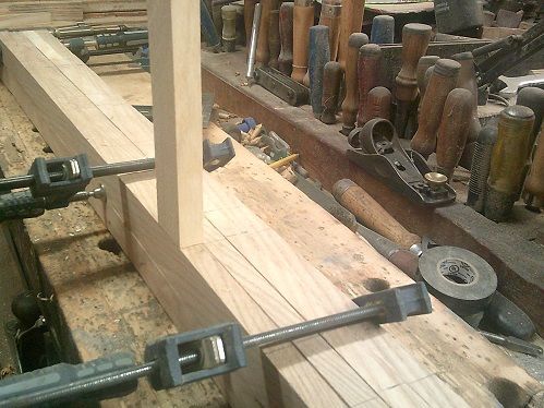

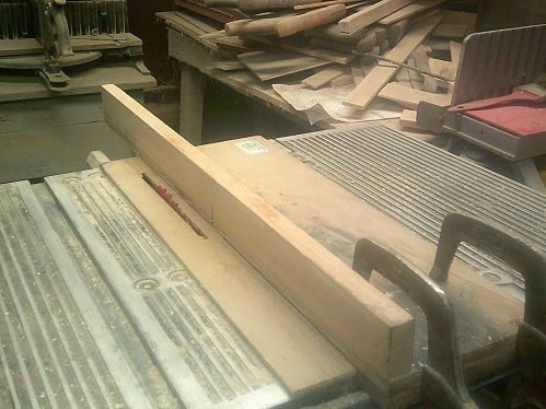

Next, find the center point..5-1/2" divide by 2..=  2.75"..set this from the fence to the center of the saw blade..:OldManSmiley:
These will be the 4 corner posts of the case.  a 32nd shy of the 2.75..but they all are the same..:TwoThumbsUp:

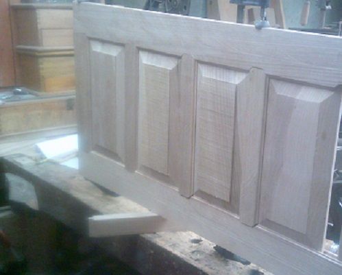

    One last look, before it gets hauled to the Bedroom tomorrow ( with Craig's Help, of course) Everything has had 2 coats of shellac... Plan right now is to haul the drawers up first...T

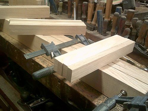

Rails have been figured out, and milled for length and width and even thickness....7/8" was just a hair too thick..Processing photos now...
Stay tuned..
Needed to mill the rails @ 11-1/2"  to start..will trim the final length later...:OldManSmiley:
Cut planks down to rough length..blanks were then edge so all the edges were parallel....then set the fence to 2" width..milled 4 rails...reset to 1-1/2" and ran the other 8...then set up a resaw fence..:ChinScratch:
WithOUT the mitre gauge..:JawDrop:..set to skim off one rough face (barely) then reset to 3/4" thickness..:TwoThumbsUp:
Two of the 2" wide rails are for the bottom..:OldManSmiley:
2 sides, remember...then two more for the top rails..:ChinScratch:

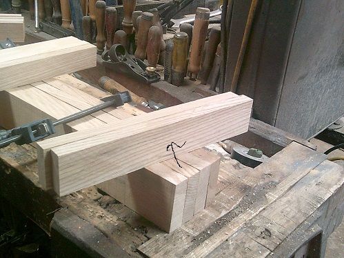

Rails...were squared up on one end, the cut to final length at the other end...setting them out for spacing with a panel blank to help out...stiles were a tad too long..:ArguingSmileys:
need to cut about that much off of the bottom...:BangingHead:
And about this much off of the tops.  Decided to...after trimming for length..:ChinScratch:
That I should thin the stiles down a bit....skimmed a blade width from each face..stiles are now 3/4" thick..and..:TwoThumbsUp:
NOW match the rails...makes it a bit easier for the M&T joinery coming up...:OldManSmiley:

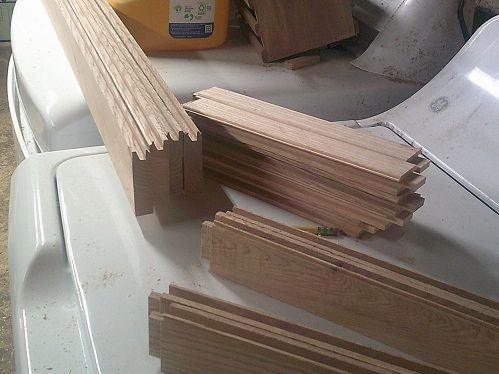

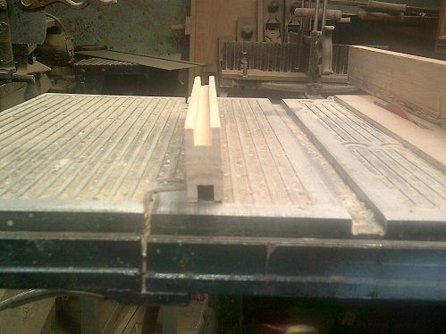

Once all the grooves were done...then do a few tenons..:Cheer:
Results?
Was trying for a slip fit..:OldManSmiley:
Just remember..do both ends...:BugEyeSmiley:
The top and bottom rail uses a special cut..:OldManSmiley:
All the red area will be gone, there will be a miter joint involved..:ChinScratch:
As the rails fit in a bit deep..:OldManSmiley:
Like at the bottom of the groove...and still have a 1/2" long tenon to chop a mortise for...middle rails get all 4 corners mitered..:OldManSmiley:

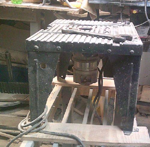

Router table just MIGHT get used, today :JawDrop:
Choice for the edge of the grooves...round-over, or...cove?  :ChinScratch:Will be a very small detail, shows up only on the outside of the case...picture frames the Raised Panels.  :OldManSmiley:
Pretty sure that some cussing MIGHT get involved?:ROFL:
This will be a 2 parter...Part 1:

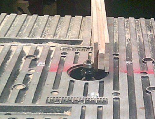

This contraption is a Router table..the router?:JawDrop:
Is from Black & Decker, a clone of the DeWalt No. 610..wrenches?:WonderScratch:
You need 2 to change a bit with..the Bit?:TwoThumbsUp:
Don't want to trust it this way...buried the bearing into the fence..:OldManSmiley:
Gives a bit of support..results?:ChinScratch:
This is the outside face of the rail...all the rails get such a molding done..:TwoThumbsUp:
Stiles as well..IF an edge has a groove, the outside face gets a molded profile..had watch watch which side of the stiles was to be the "outside" face..:ChinScratch:

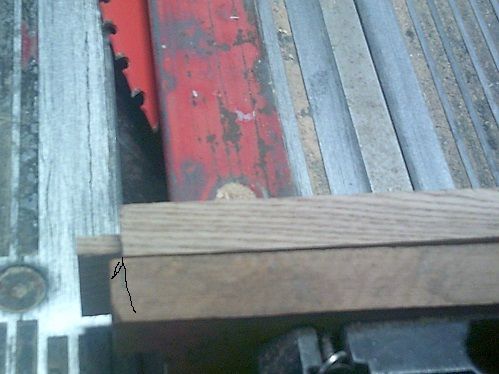

Lean the blade over to 45 degrees..there is a mark on the wood part of the mitre gauge..:ChinScratch:
So that each cut will be the same...saw set as to NOT cut into the tenon..:OldManSmiley:

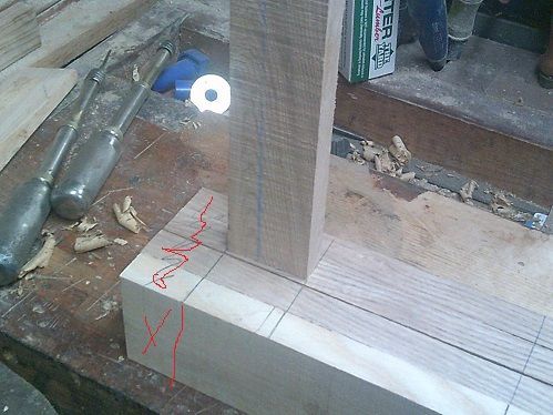

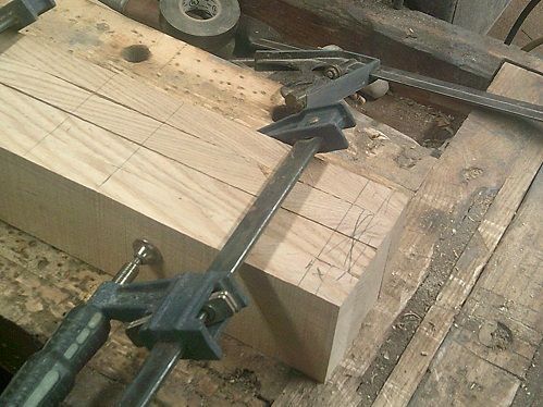

Parts are sitting in a mortise jig..:WonderScratch:
Sits right on top of the bench's leg..no bouncing around allowed...clamp a part into the jig..:SaluteandRun:
Lay out for the mortise..:TwoThumbsUp:
And have a few tools on hand...:ChinScratch:
Fancy handled chisel is curved tip, to extract chips from the bottom of Mortises..Dovetail saw to saw the miter cut on the stile. Small combo square to mark that miter cut...
Zig-Zag ruler has a depth setting of 1/2", by using the brass extension rod.  :OldManSmiley:

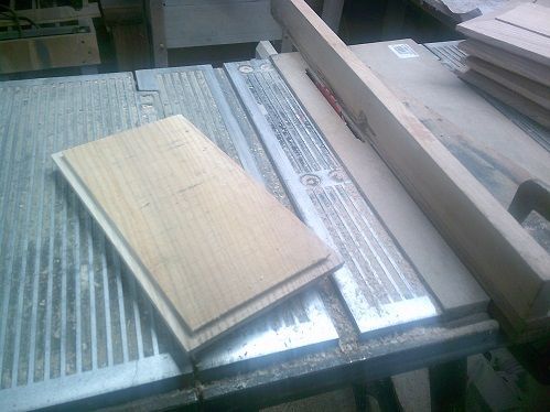

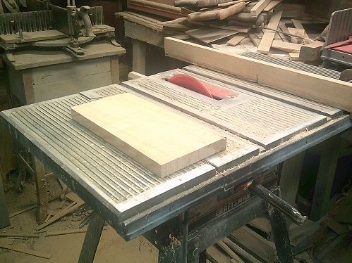

Raised 10 panels on the tablesaw...fronts..and..:SaluteandRun:
Back...then used one to layout out a couple mortises..:OldManSmiley:

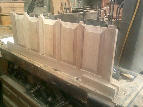

Then 3 more mortises were done...and a clamped up Dry Fit was done..:ChinScratch:
Was after the foot profile was bandsawn....rough inside, yet..:BugEyeSmiley:
Only things that will see that rough sawn look?   The sides of the drawers on their way by...:rolleyes:
