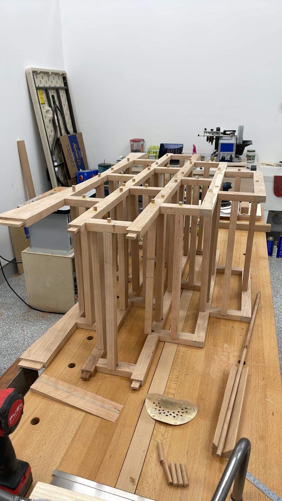

The dowels are 3/8” hardwood through dowels 1-3/4” and there are 36 of them per face so that should give me about 180 square inches of glued surface area per face assembly so I am not particularly worried about strength.

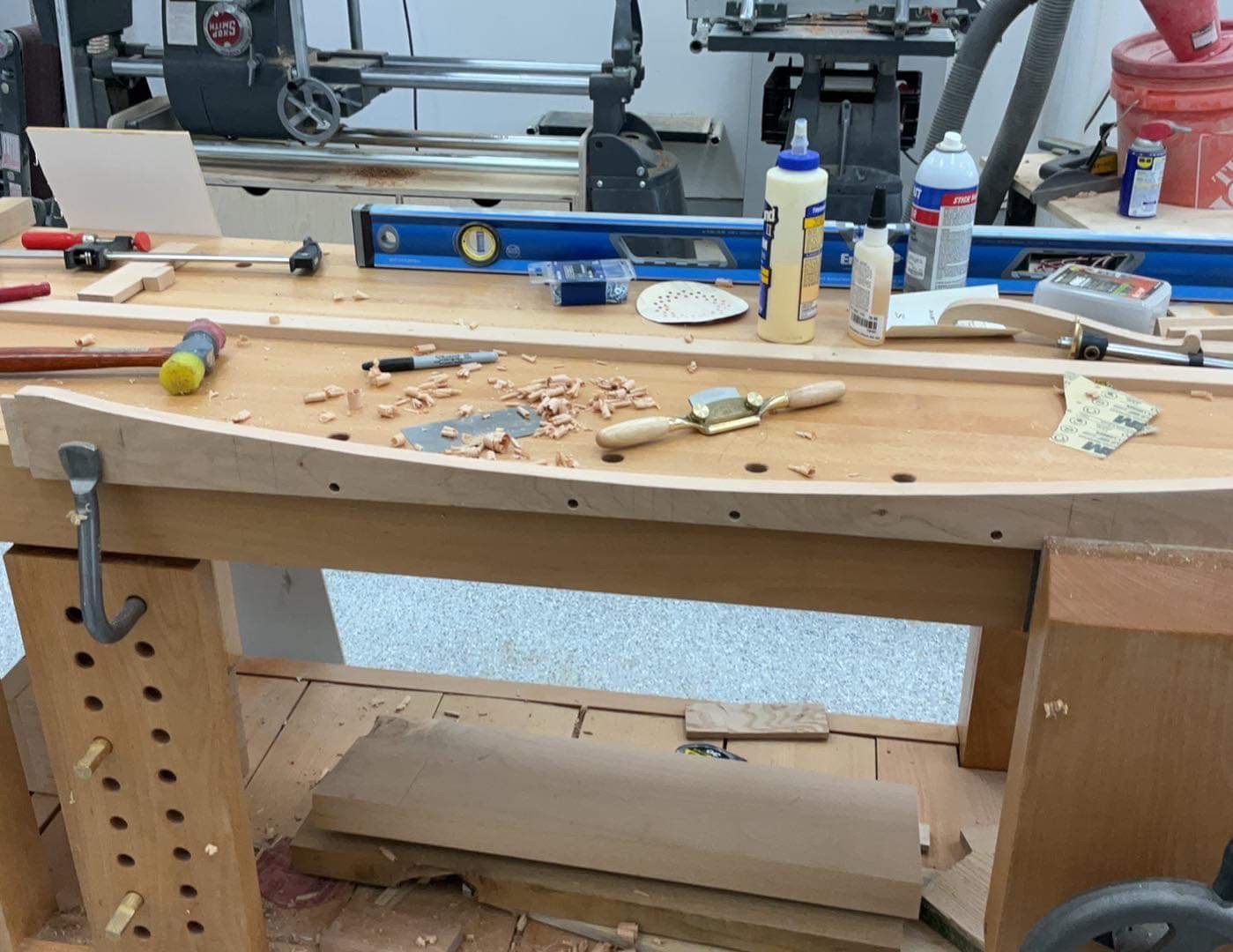

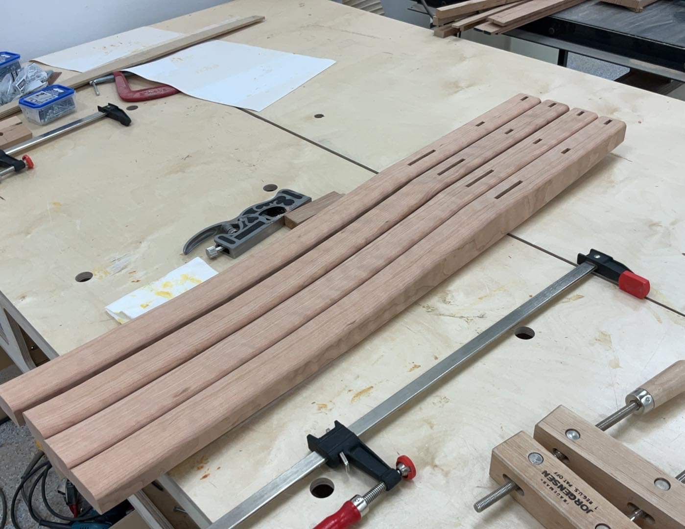

After playing the mad sparky this morning I have been working on the entry table project a bit.
Rough cut on the bandsaw.
Shaped with spokeshave.
Cleaned up with cabinet scraper.
Now that I have half a clue what I am doing, time to do the other one :)
Michael, is that spokeshave from Lie-Nielsen?  If so, how do you like it?
Yes I picked up a couple of spokeshaves for this project.  These are the Lie-Nielsen models and I like them a lot.
It has definitely been a learning curve in setting them up and using them but I am gaining a little proficiency with them.

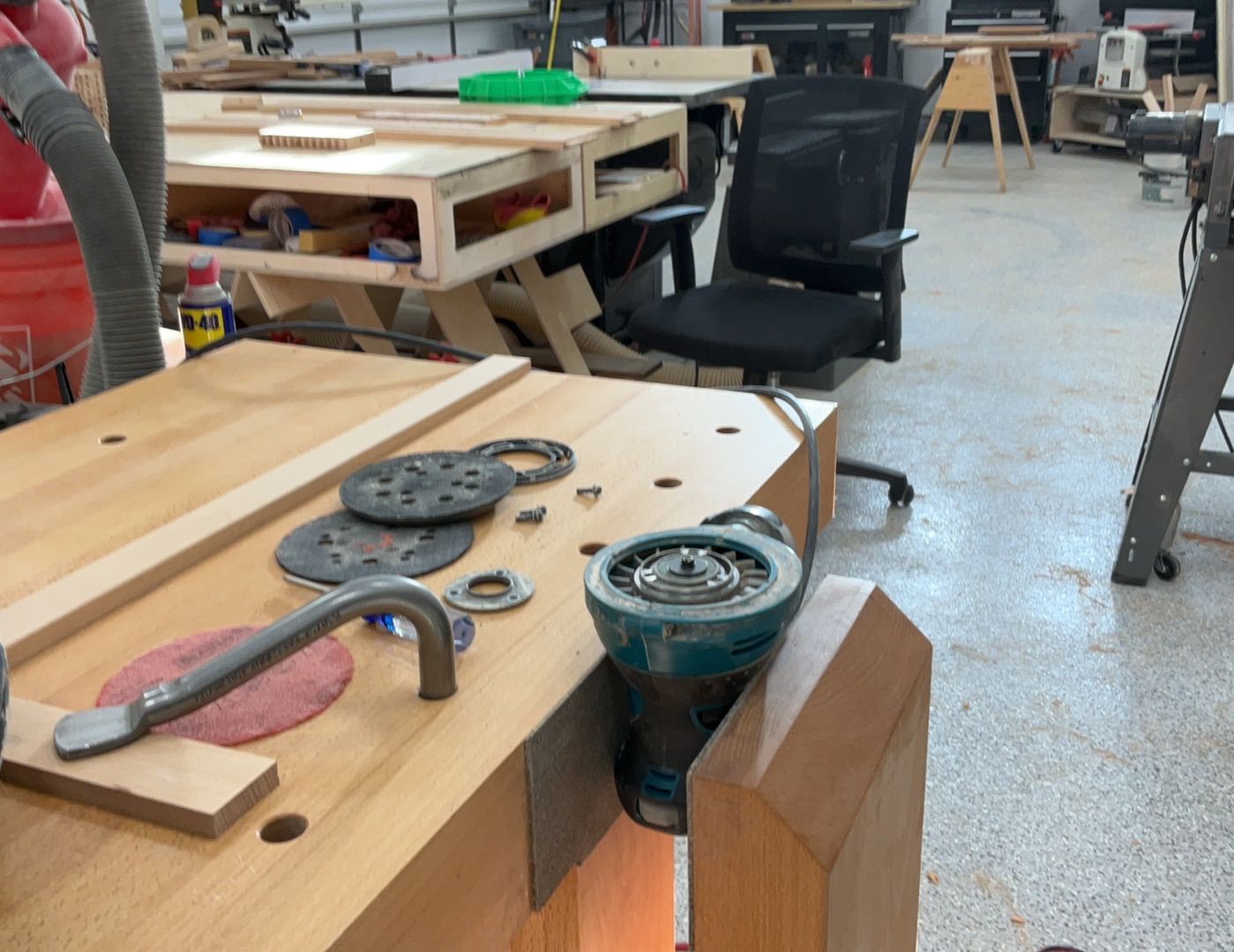

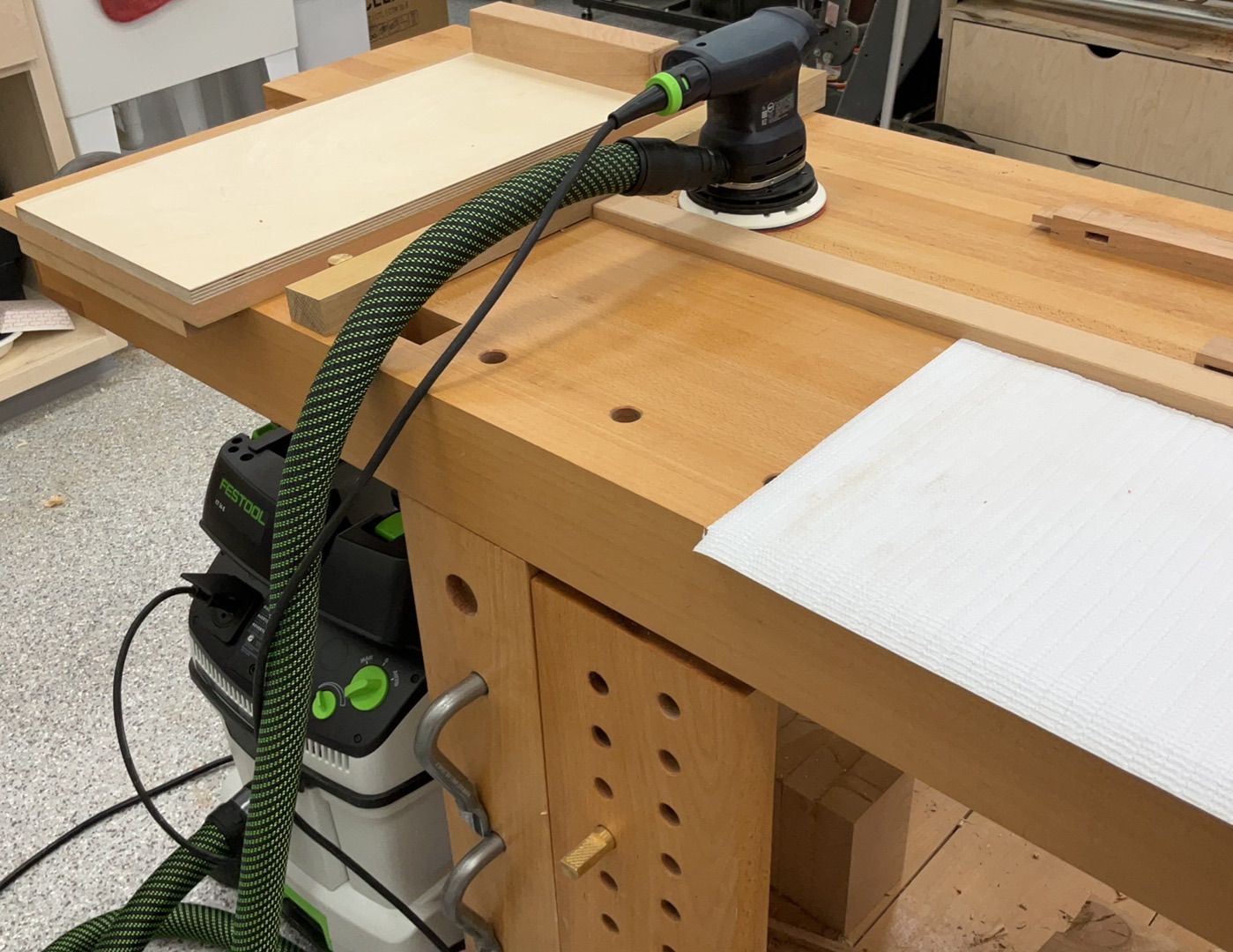

Well this project has been an interesting ride so far.    The trusty old Makita finish sander decided that instead of a random orbital motion it would be better if it just turned itself into a 5” disk sander operating at 12k RPMs so it could yeet parts all over the shop.  After much dissection last night and finding that getting parts to fix said sander was going to be next to impossible, I started researching stuff.
Alas poor Makita, I knew him well…
A few cups of coffee, a conference with the CFO later, and a shopping trip across town later…

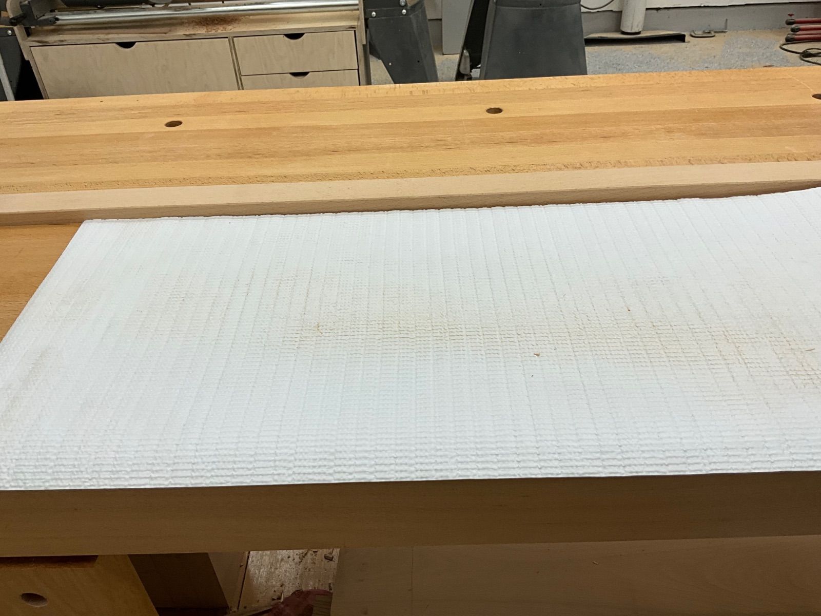

The shop has a new arrival.  I will write something more in depth later as I am still getting used to this but I do understand what the hype is about now.
Thus far, this is the best finish sander I have used.  The dust collection is excellent.  Maybe excellent is the wrong word.  The dust collection is shocking.
Nothing in the air, almost nothing on the workpieces, next to nothing on the work surface.  I sanded everything on the entry table to 220 and there is barely enough dust that didn’t get captured to discolor the sanding pad.

awesome project, and boy howdy on the festool, i have both of their offerings, and sanding along with the dust extractor is heaven for sure, so much so last week or so i found a used extractor about an hour away and went after it to have one for a few other projects, amazing collection and they are awesome sanders,
best of luck with the new shiney,

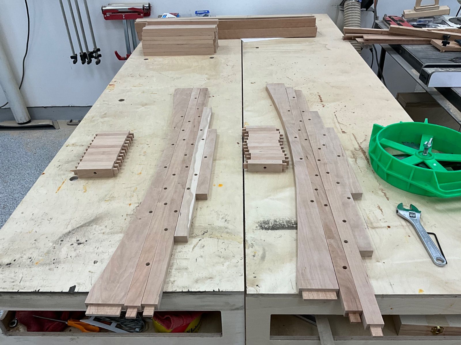

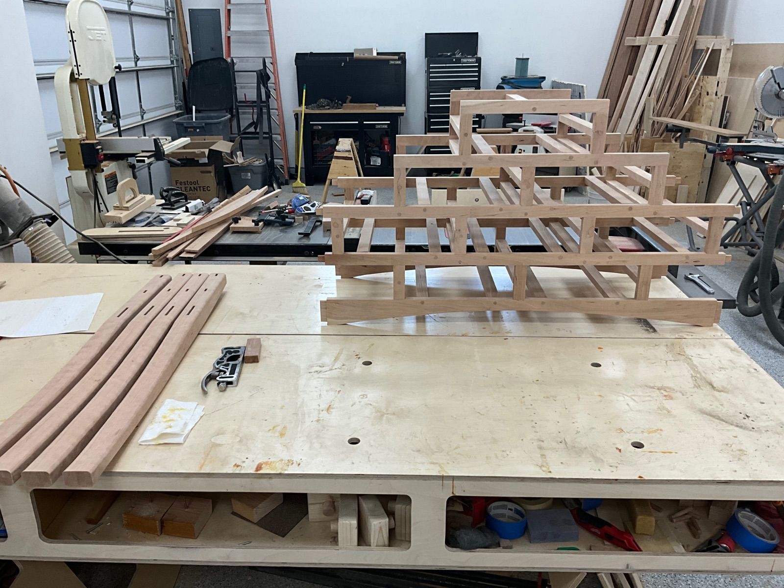

A little progress here and there.
Legs are mortised, fitted, and rough cut and the dowelling progresses…
Impressive Michael. Like putting together a 10k piece puzzle. At the end everything just falls in place.

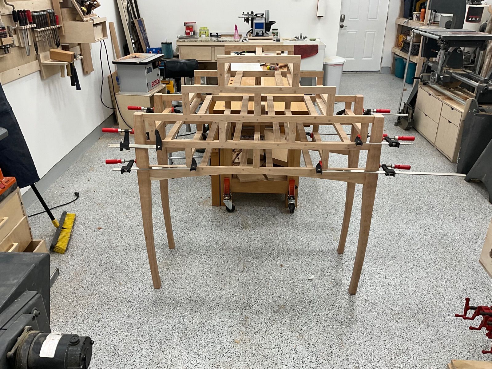

Well the world’s worst glueup is finally done and the main parts of the table are sanded.
Have to get started on the tops and drawers now.
And we have achieved some level of assembly….
