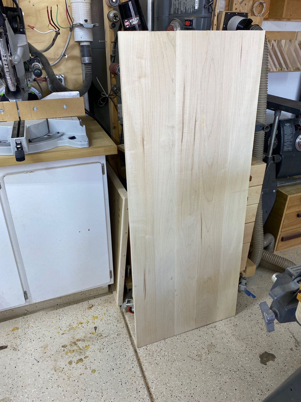

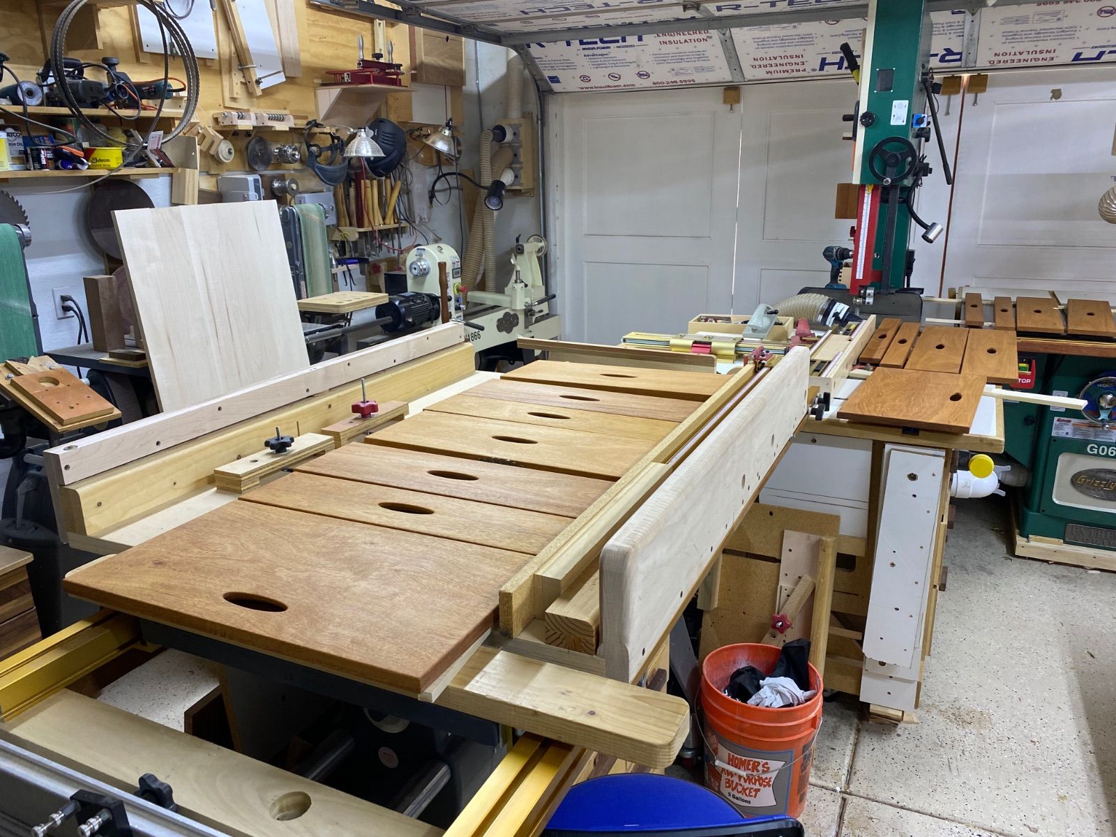

The drywall guy showed today and finished up so now we can get this room done. Seems like it’s taking forever. I glued up the pieces for the countertop today. Tomorrow everything should be dry enough to paint.

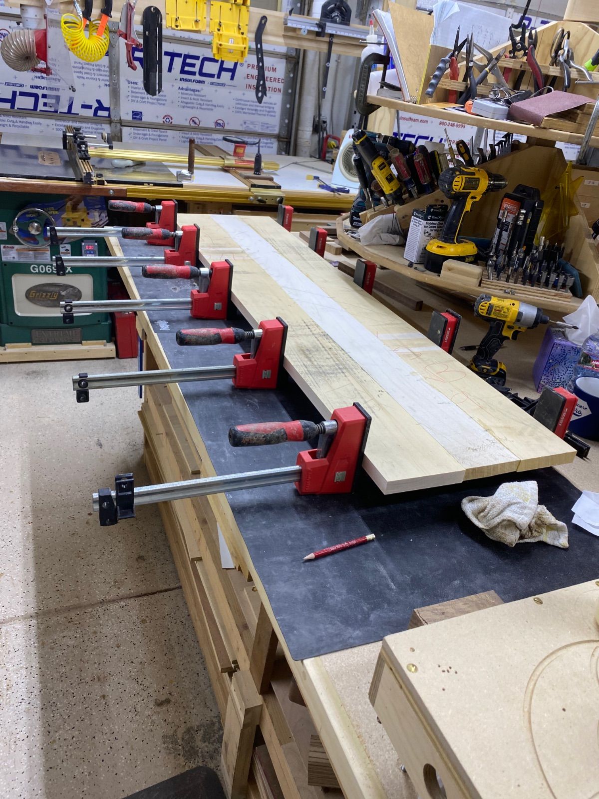

I finished up the countertop blank. I will put a mahogany edge band on it then it’s ready for install.
Paul

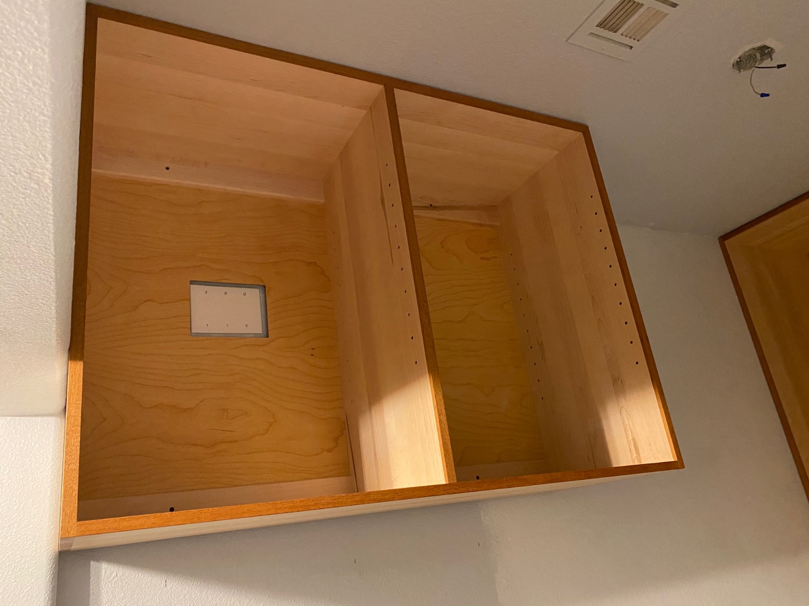

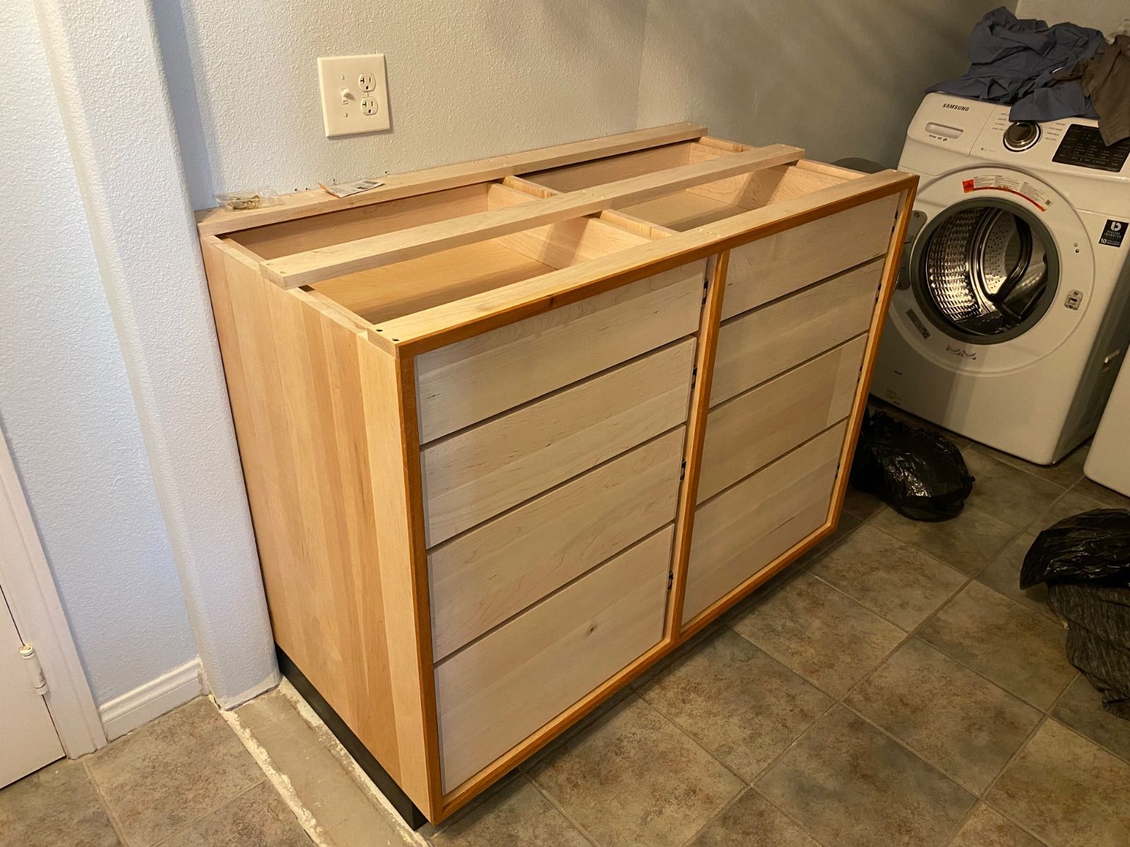

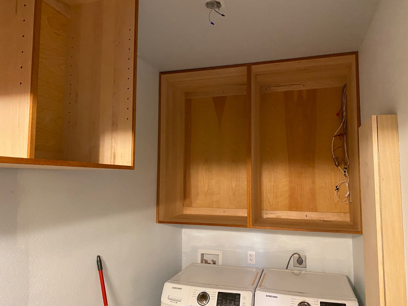

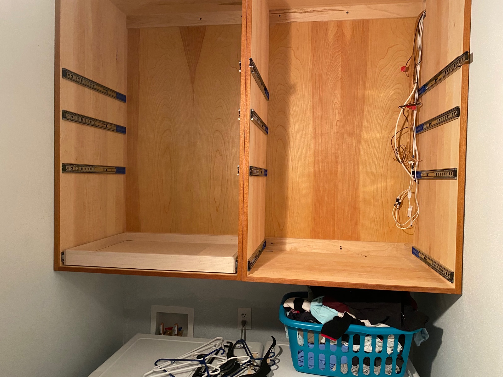

Things are now moving along. We got the upper cabinets installed. Next the lower cabinet and a little tile work.
Paul

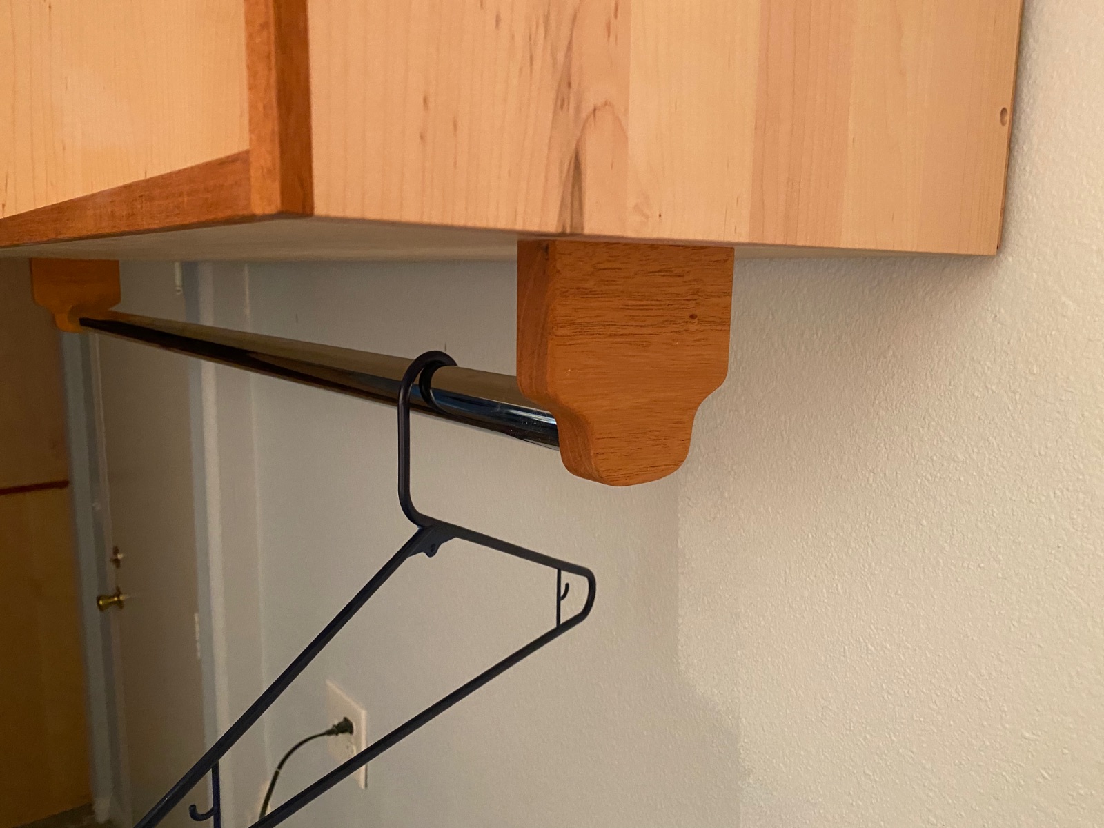

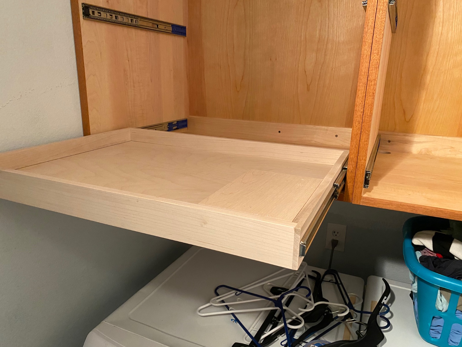

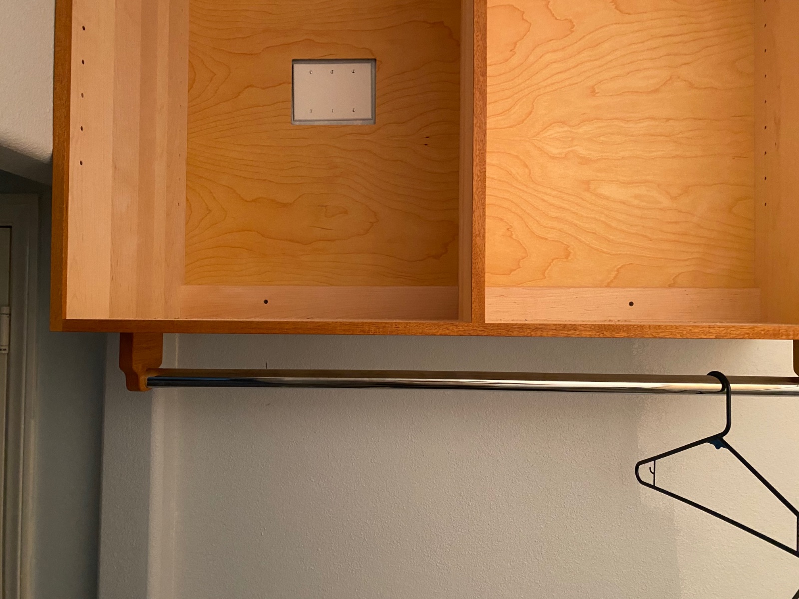

Making progress. Completed the hanger rack and got all the drawer slides installed. One drawer installed. Tomorrow is another day 🥺
Paul

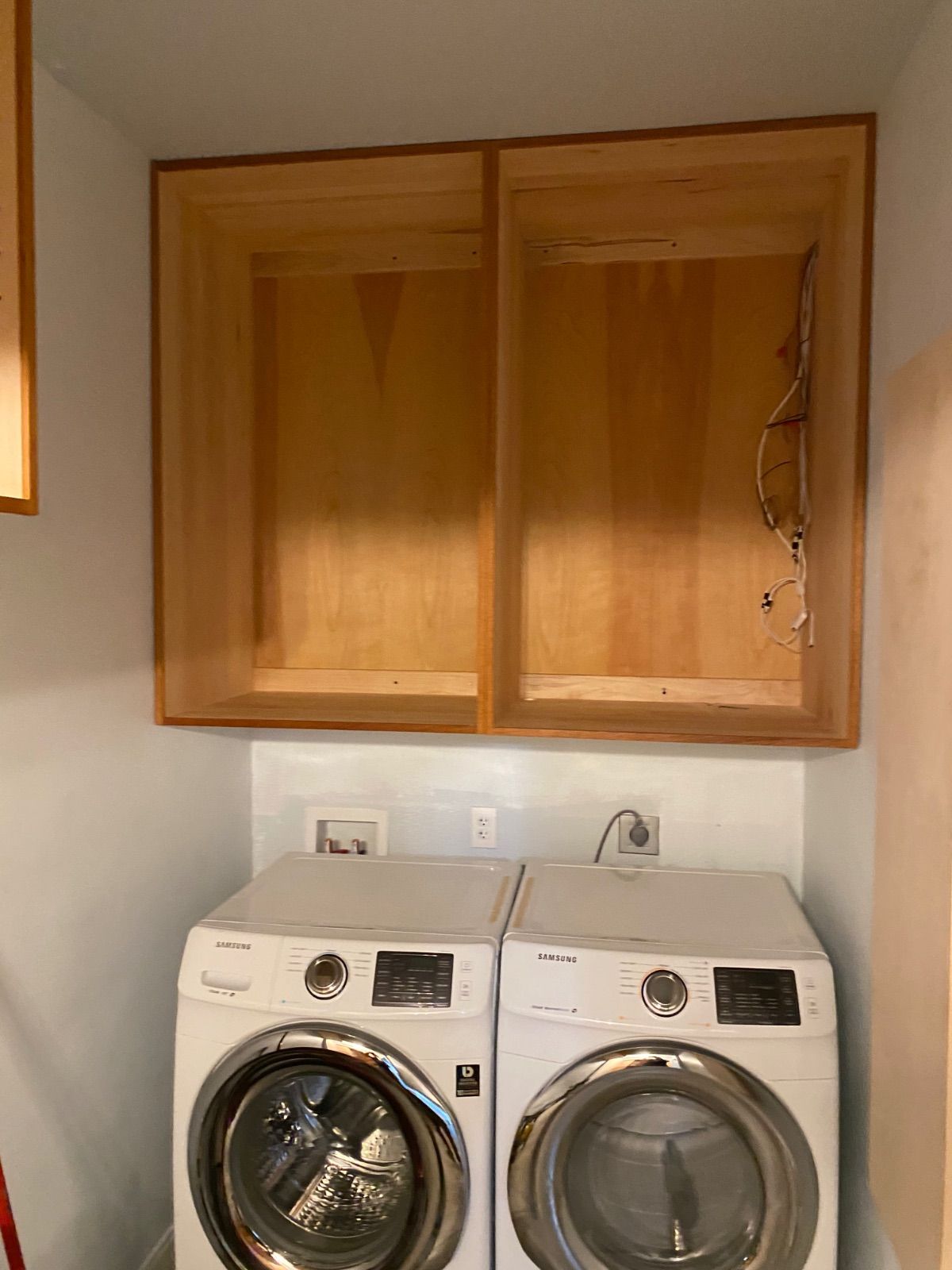

It is looking nice, Paul.  What is the plan for the wiring you have in one of the upper cabinets?
Danl
That’s all the speaker wire and LED wiring for the family room.
Paul

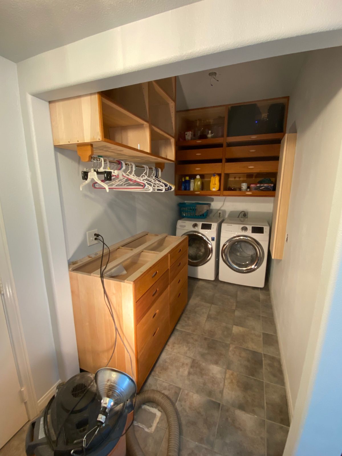

Well the out of town guests are gone so all my excuses for not getting back to work just evaporated. I got all the drawers installed in the lower, shelving in the other upper and the drawer fronts made and first coat of finish on. Onward and upward.
Paul

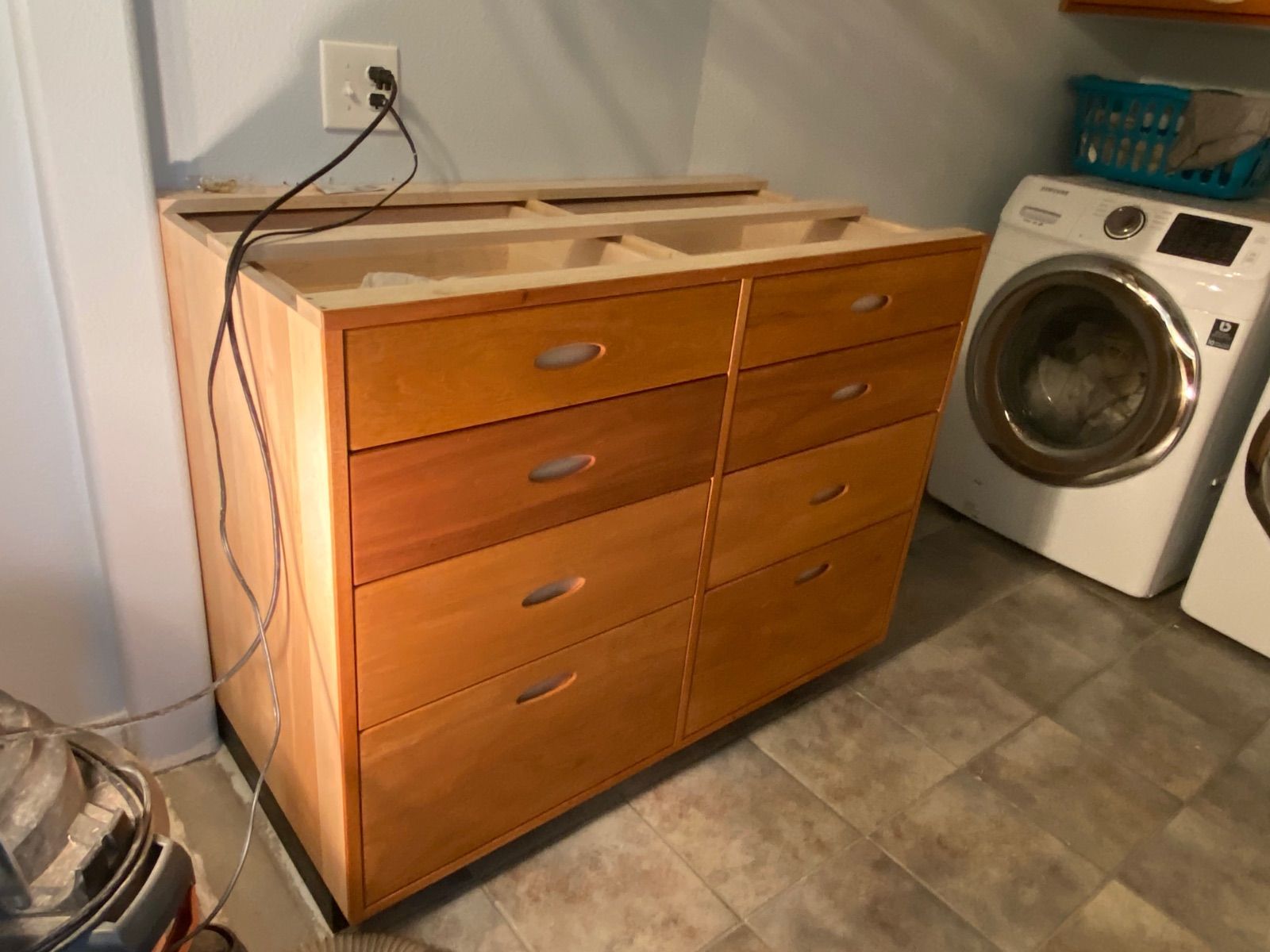

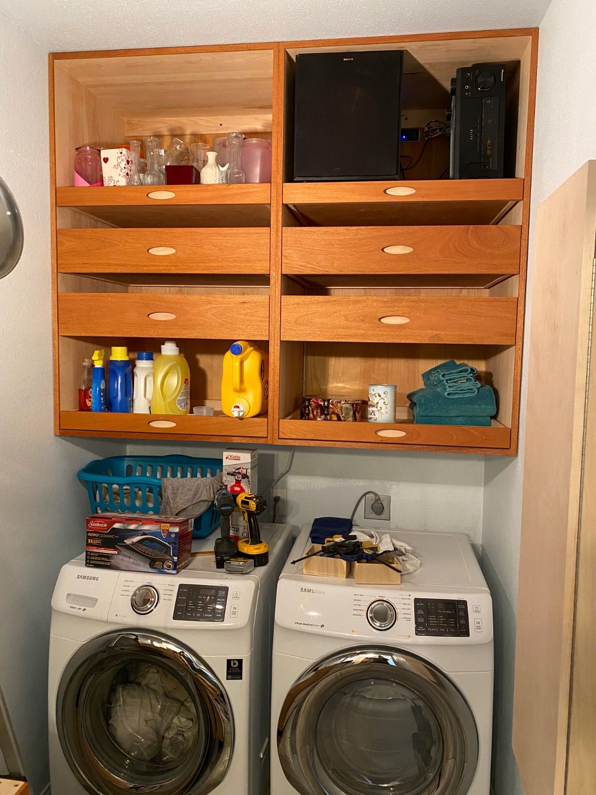

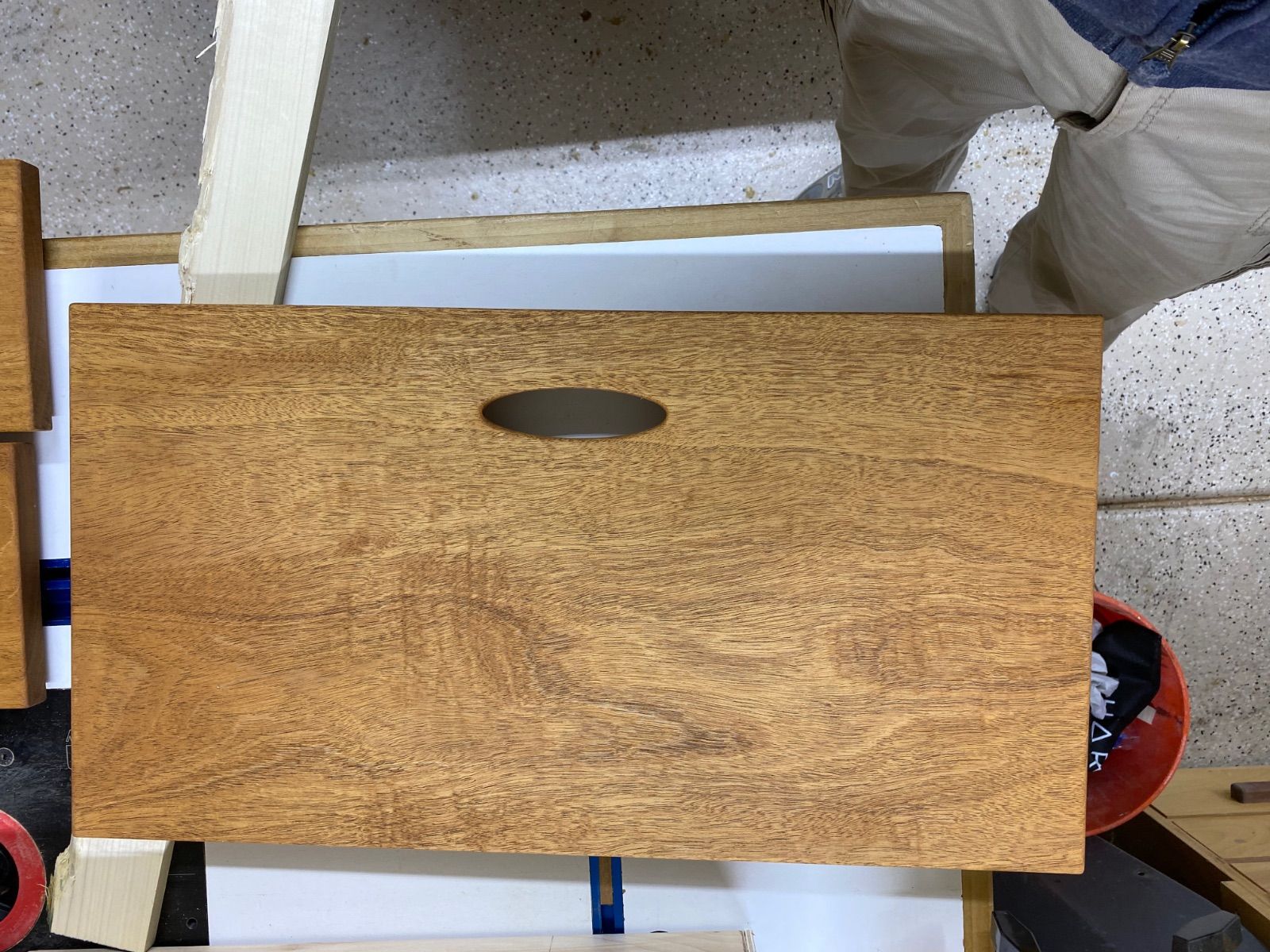

Making progress. All the drawer fronts are on.
Paul
Thanks Lew. The wife called for flush wooden handles and that’s what we came up with. It’s a three step router design that was quick and simple to do. I used the Shaper Origin to cut the blank oval opening but could have just as easily used a template and collet, then a 1/8” radius round over for the face and the bottom is a cove bit to cut out the recess.
Paul
love the drawers. What is that a stereo in the laundry?
