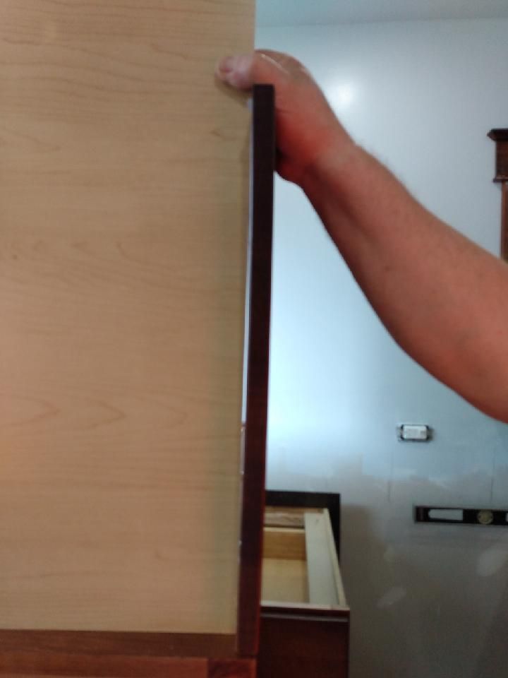

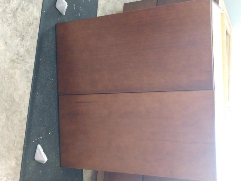

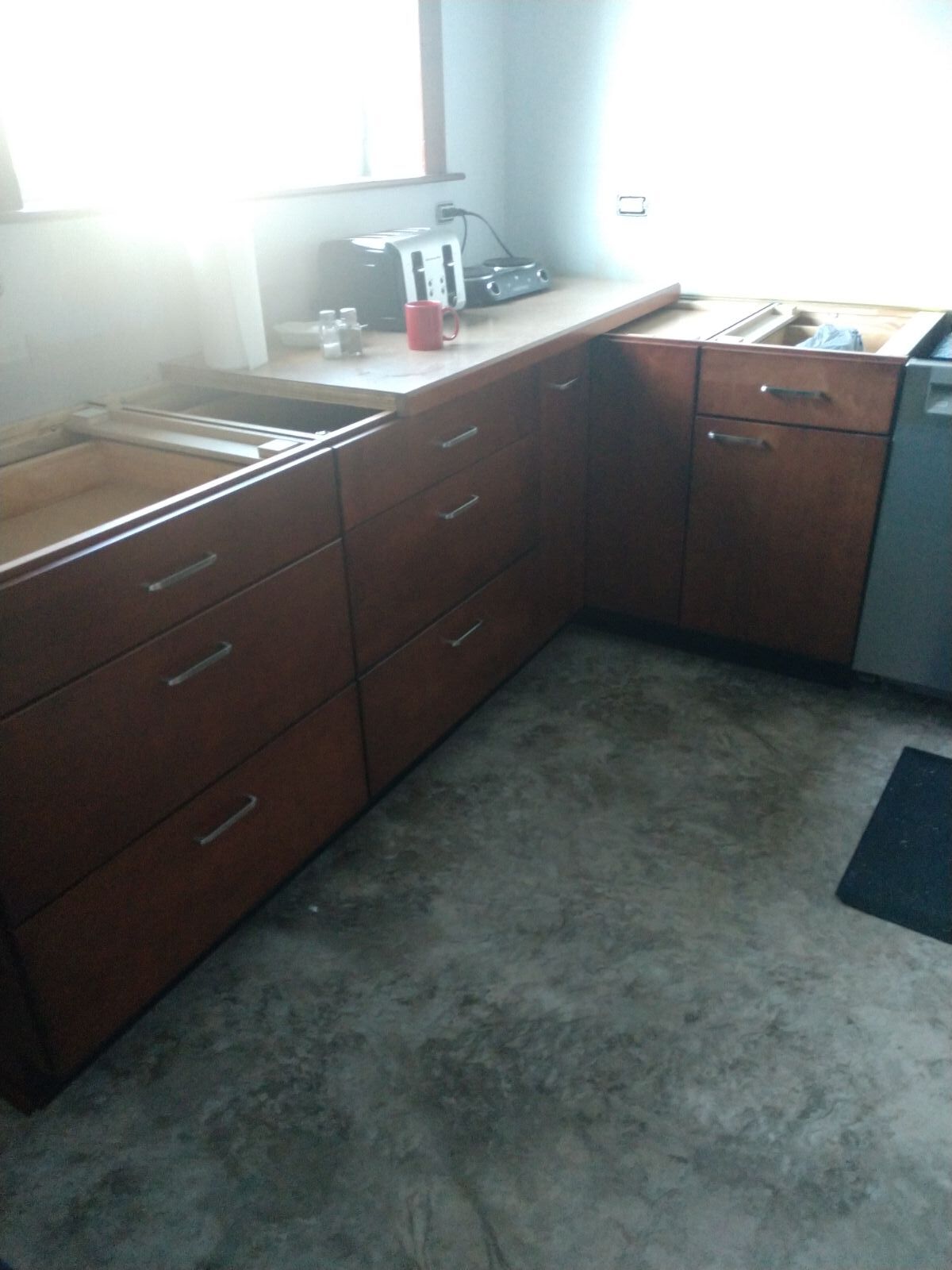

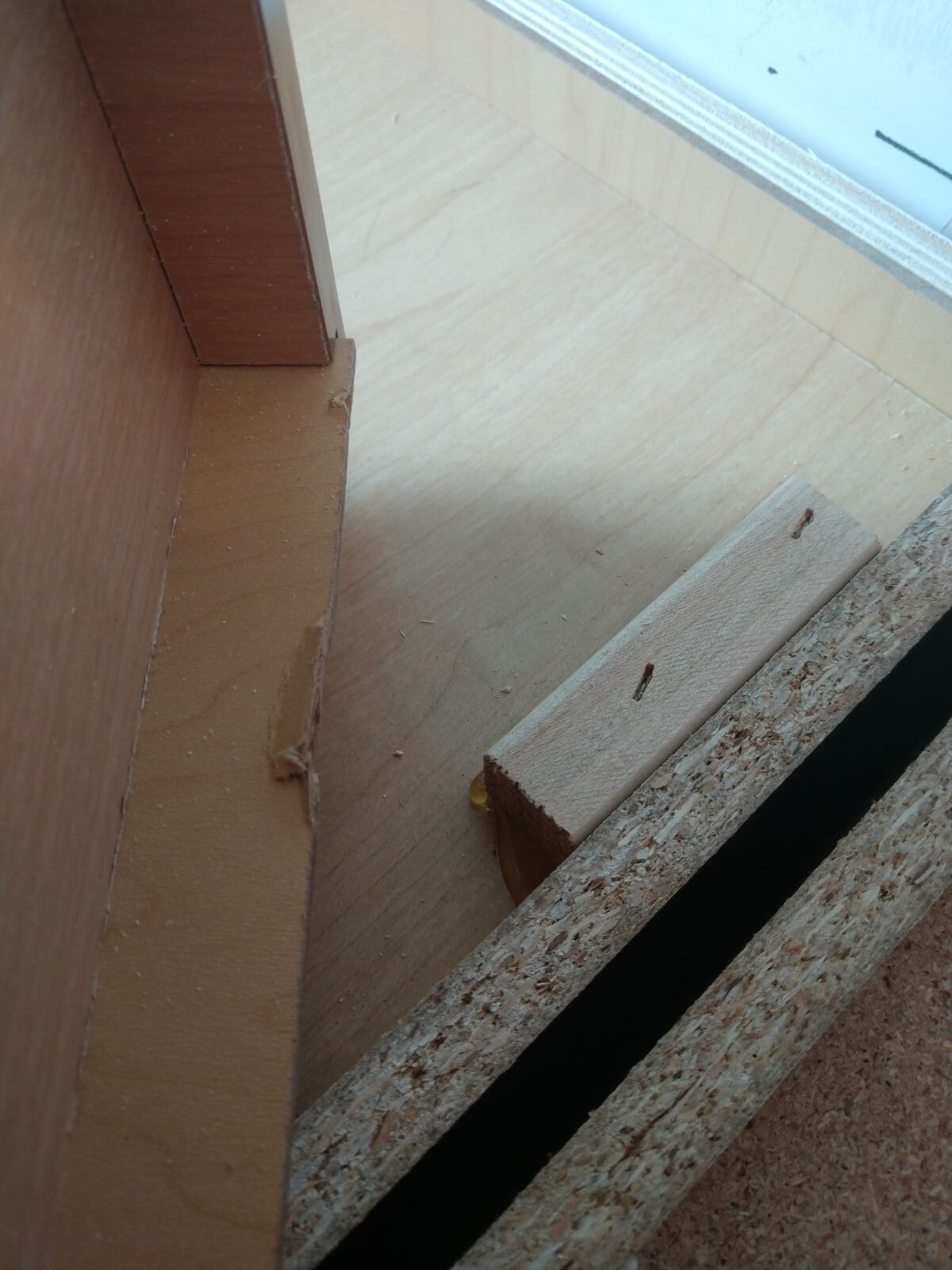

After we finished the baking station we started on the pantry & frig cabinets. I bring the upper and Patti says she doesn't like the mismatched doors,
a33.jpg.2e57efcf94f404dd1003adb9c1205008.jpg sorry pic is sideways.
 I told her I didn't like the bowed door 1/8" in 18".
Set them aside & remove the doors from the frig cabinet.

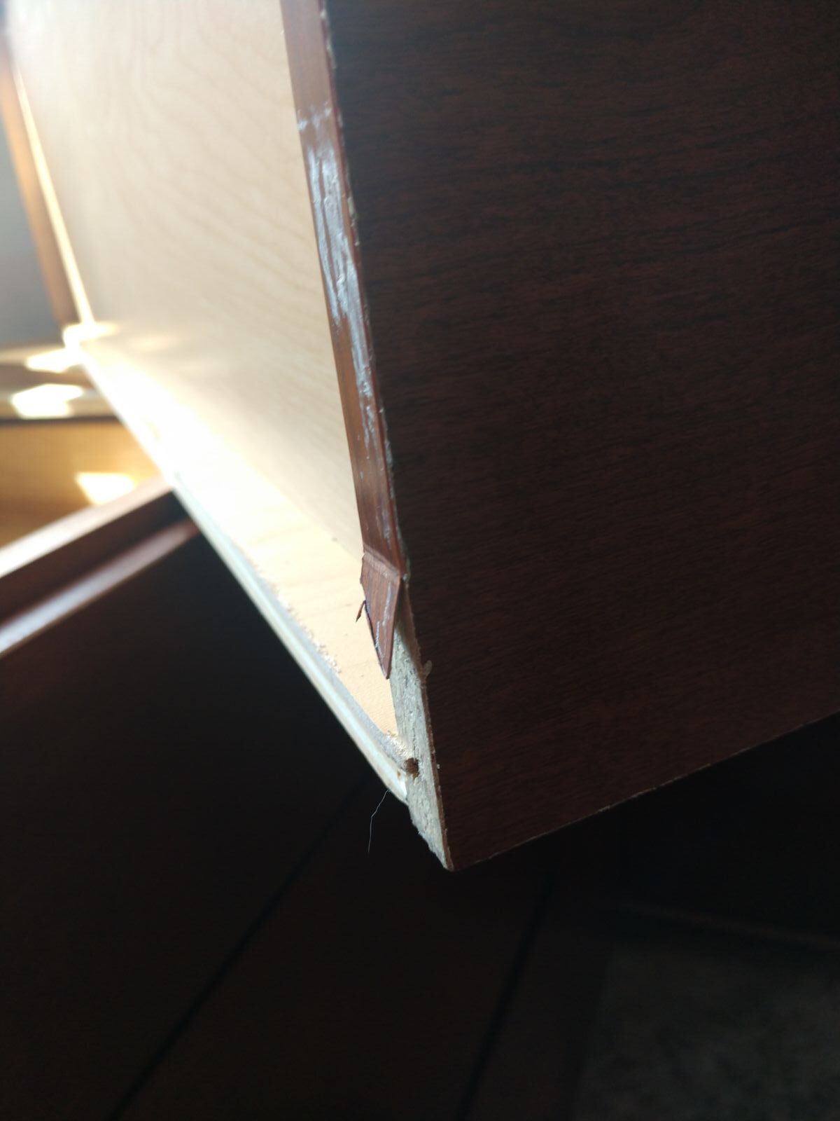

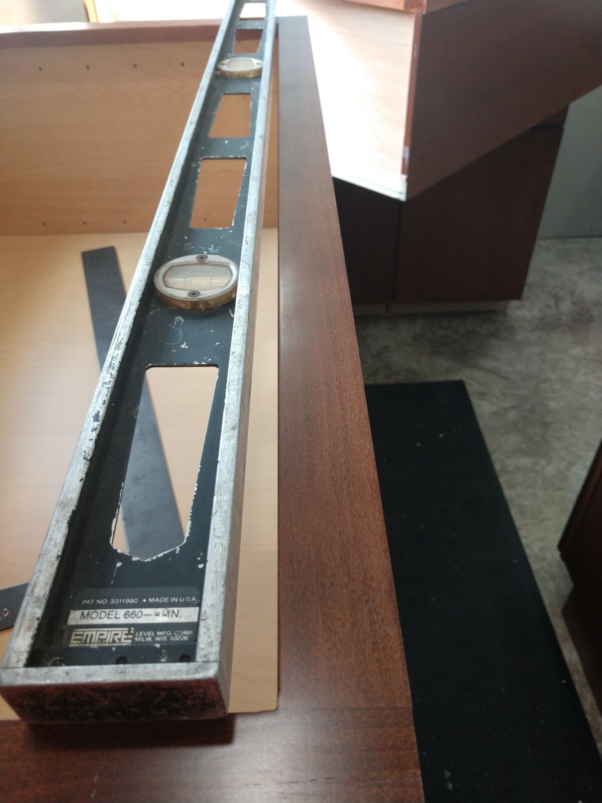

Frig cabinet bottom has some damage so I can just flip it. No such luck, the back is extending below the side. Lightbulb turns on & realize the problems are on opposite corners. Take a cross measurement on the face frame and see that we are not square by 3/8". Check the pantry cabinet and it's out by the same 3/8" but in the opposing direction.
 39.jpg.0df1e596290519452810865f1e88d76b.jpg    41.jpg.64c1be66ac141ce608d417242fa93308.jpg
 Two replacement cabinets will be here in a month. Thanks Murph.

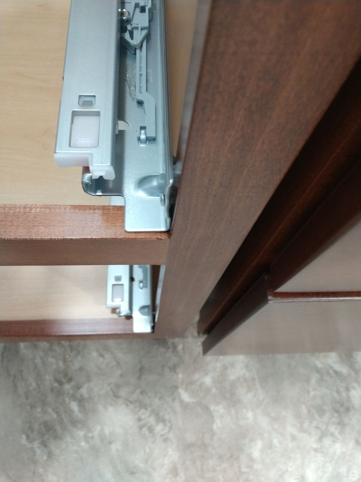

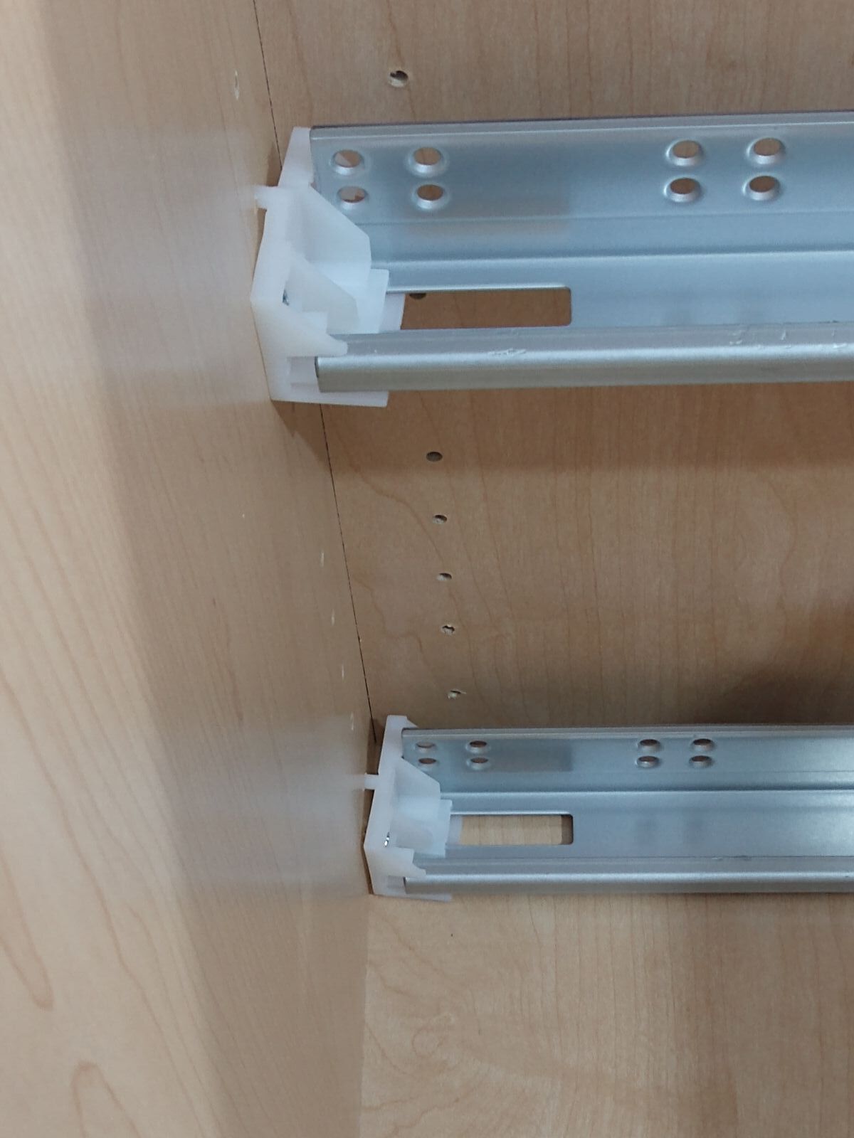

That's what I thought. We were having some problems with removing the drawers from the glides. I looked at the back of the glides and see the white support with one screw and think this may be due to the shipping process, snap it back into the hole, quick fix. I look at the front of the glide and find that the screws are not completely seated, more than a dozen. No pride, just get it done.

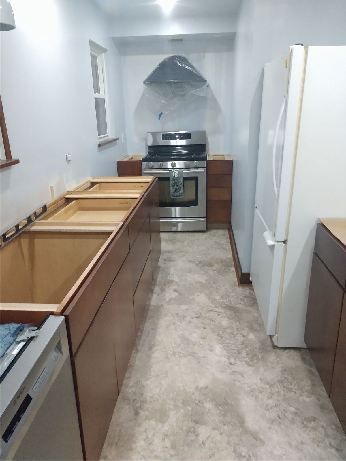

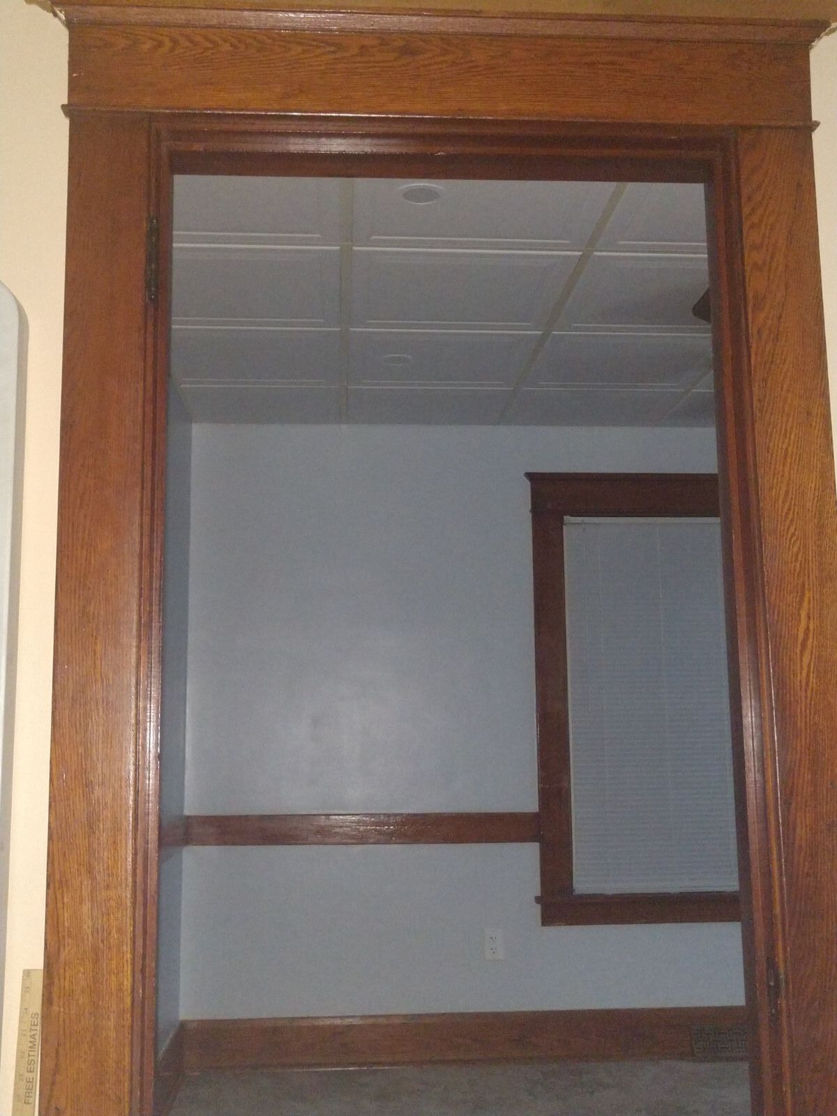

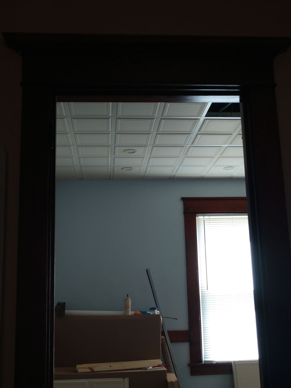

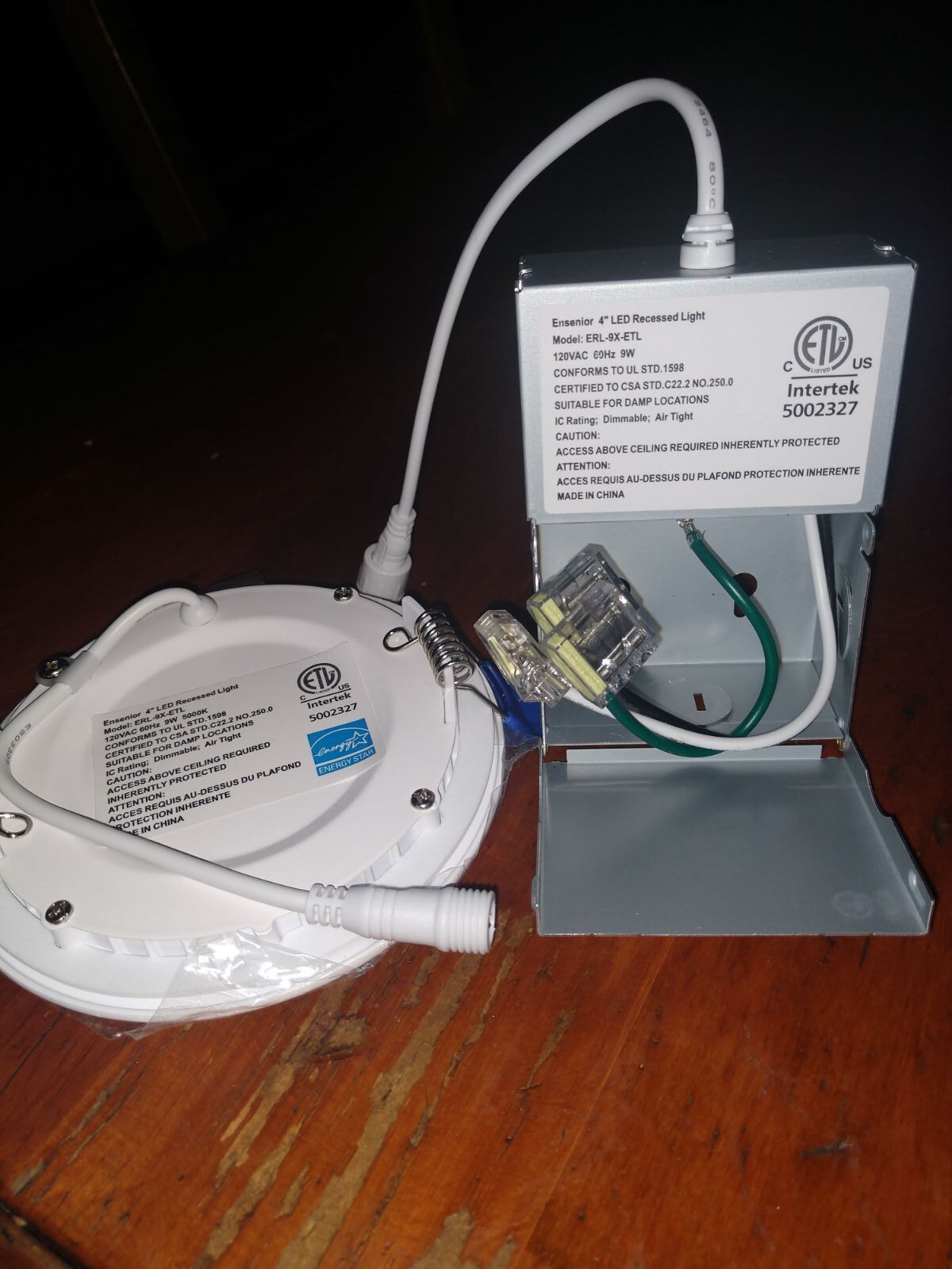

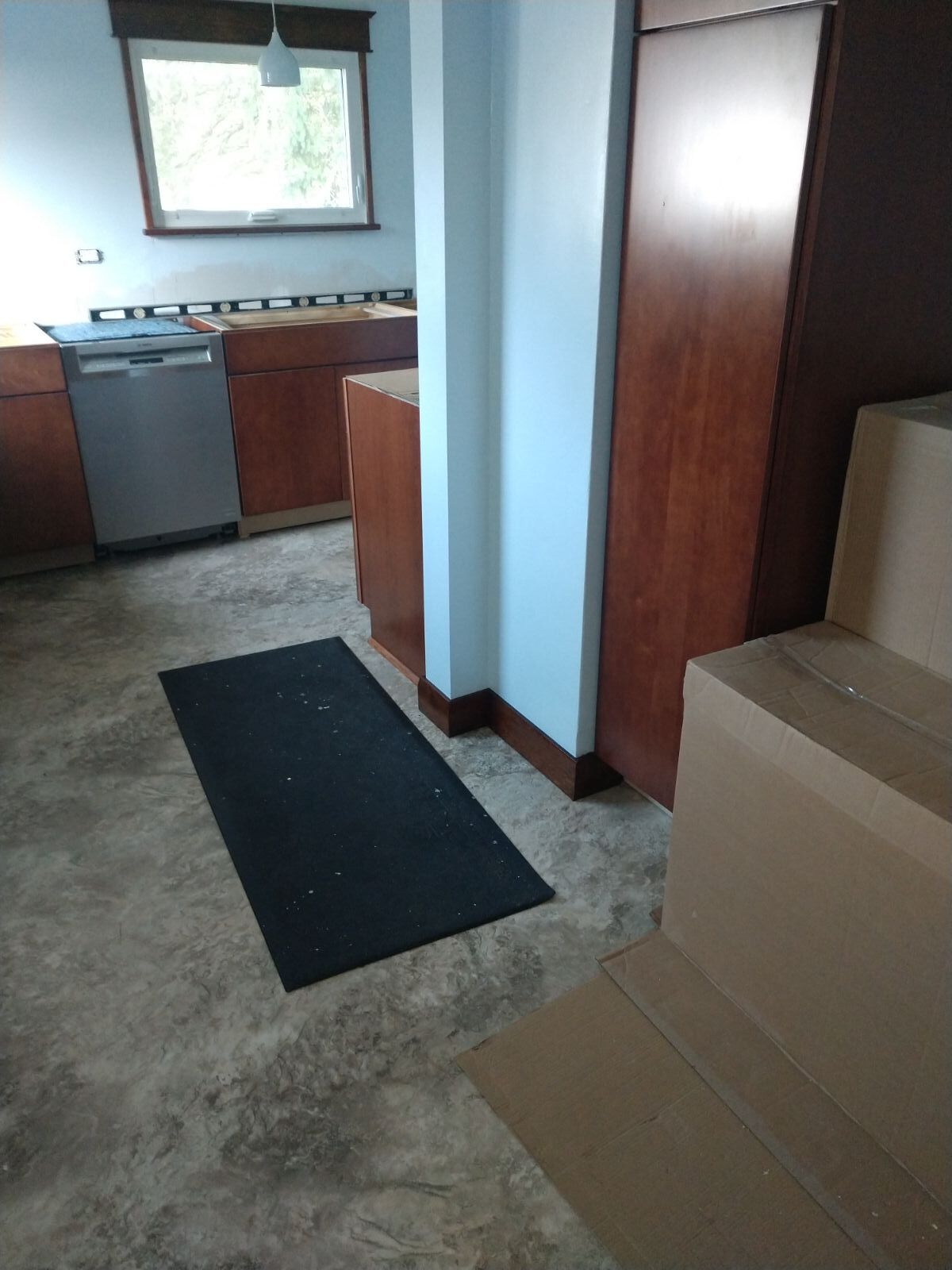

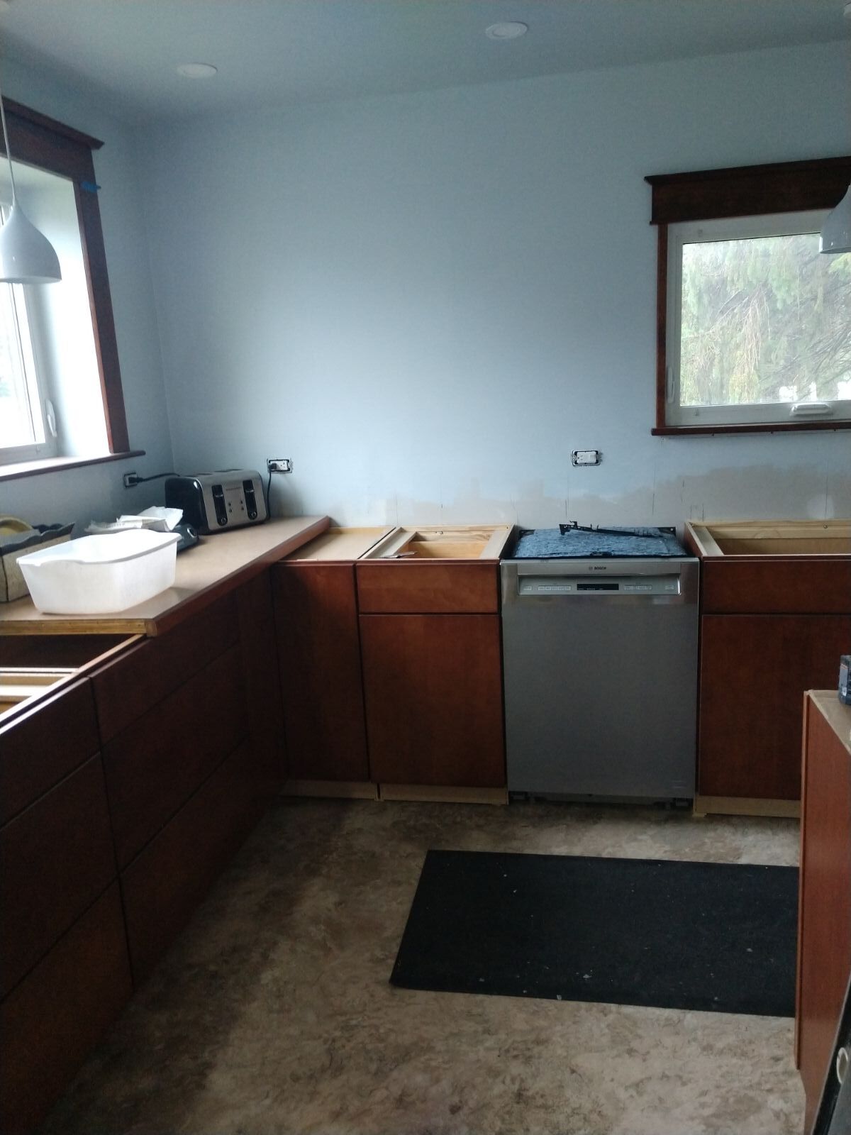

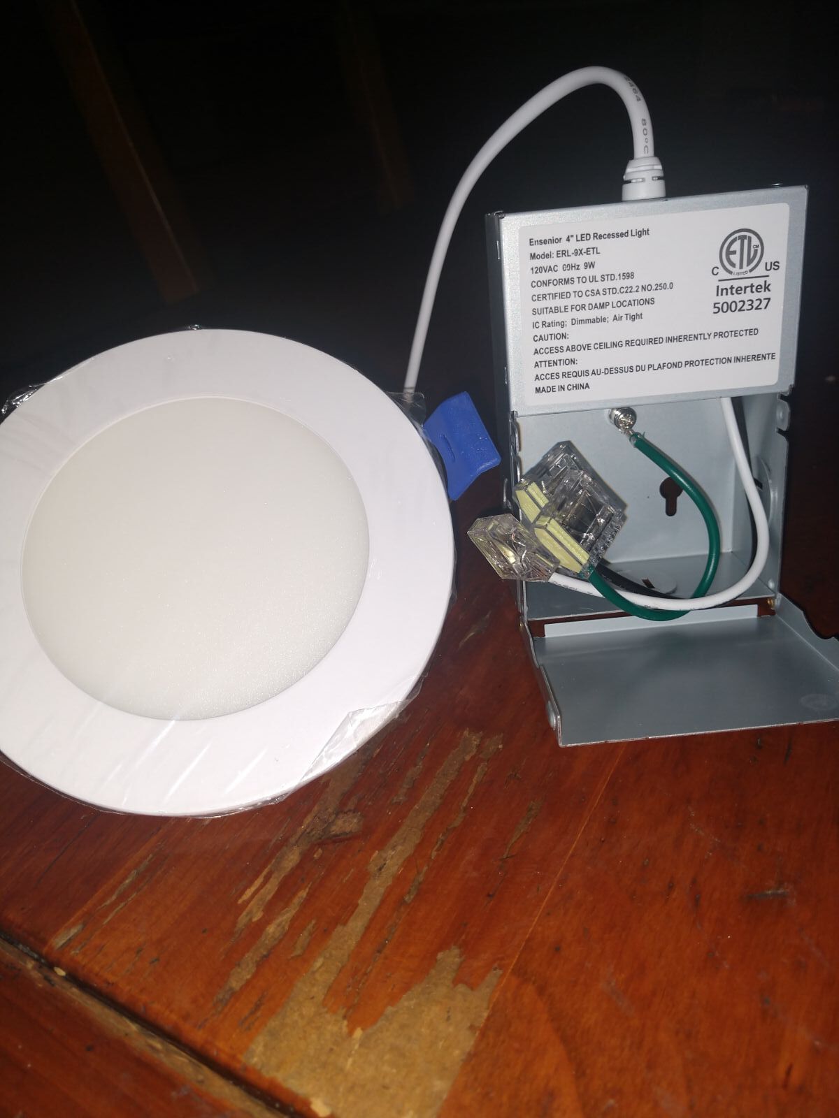

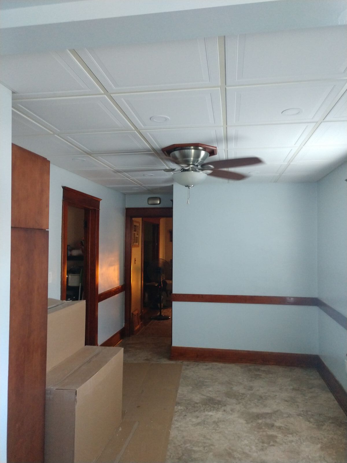

 We have been working on a shorter list of things to bring this project to a close. Counter tops have been ordered & my hope is complete by next week, the tile guy is ready to install the backsplash above the counters & behind the stove. Plumbing is complete up to the sink install and using Pex for me is the way to go. Dishwasher is in place and needs a countertop and drain hook up to be complete. Stove and vent are in place temporarily and will be permanent after the tile install. No trim around the window near the stove, just a sill. Still waiting on 2 replacement wall  cabinets , above frig & counter next to it.  New baseboards where needed and 1/4 round through-out. Replaced the ceiling panels & LEDs in the eating area & polished up the fan. LEDs are 3" and finish at 4 1/2" wide. I used a 3 1/2" hole saw for the fixture and the j-box with driver is 3" wide. When I did the hard top ceiling in the new section I was able to leave my fixture wire above the drywall, tape, mud & paint then go back and drill the locations of my fixtures. I made my connections in the j-box below the ceiling, connect the light, slide everything in to place. Need to make 4 floating shelves but the heat & humidity is keeping me out of the shop for now.

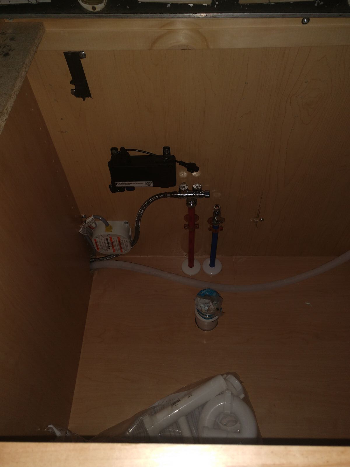

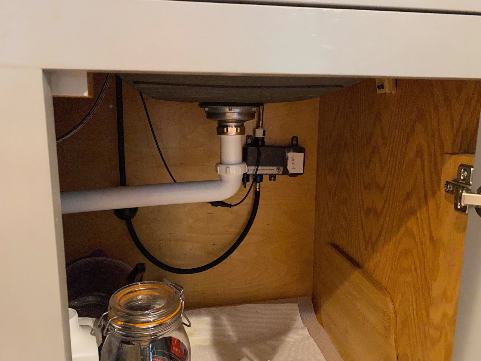

If I may make a suggestion, in this pic the black box hanging off what appears to be the rear sink cabinet.  This looks like a battery operated faucet control.  If those answers are both yes, I want to suggest moving it, and not actually mounting it until the sink and plumbing is installed.  That looks like the controller that I have, and kinda mounted in the same location.  It is a real PIA to change the batteries.  I am sure part of my problem are the hinges I used on the cabinet, they only allow the doors to open 90*.  "One day" I may move that thing over to the side...
 @Fred W. Hargis Jr we ordered the dishwasher on April 10th and it only took 15 weeks to be delivered, fast efficient service no matter how long it takes.
@Cal looks like the same. I went lower with the location this time and I hope it's better. I'll agree it's a PITA to change batteries. I did learn since having this faucet in the old sink to be sure that the water dept. isn't working in the area before changing the batteries:BangingHead:

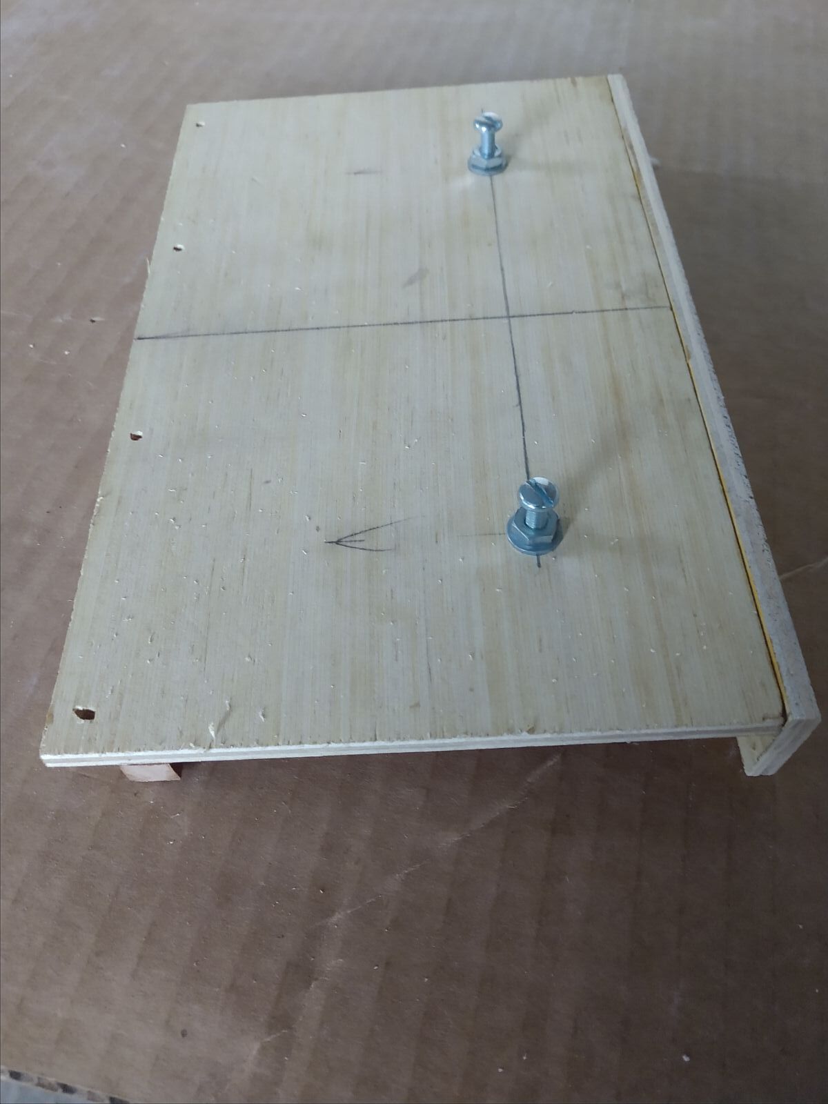

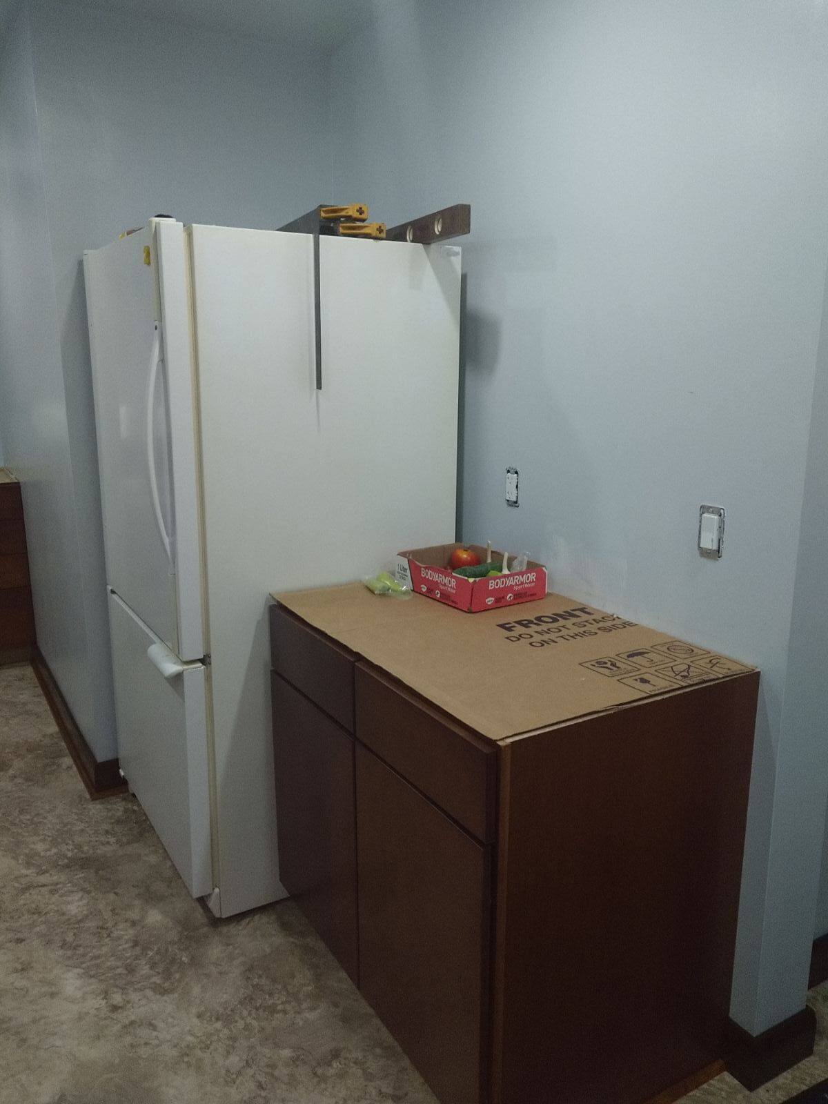

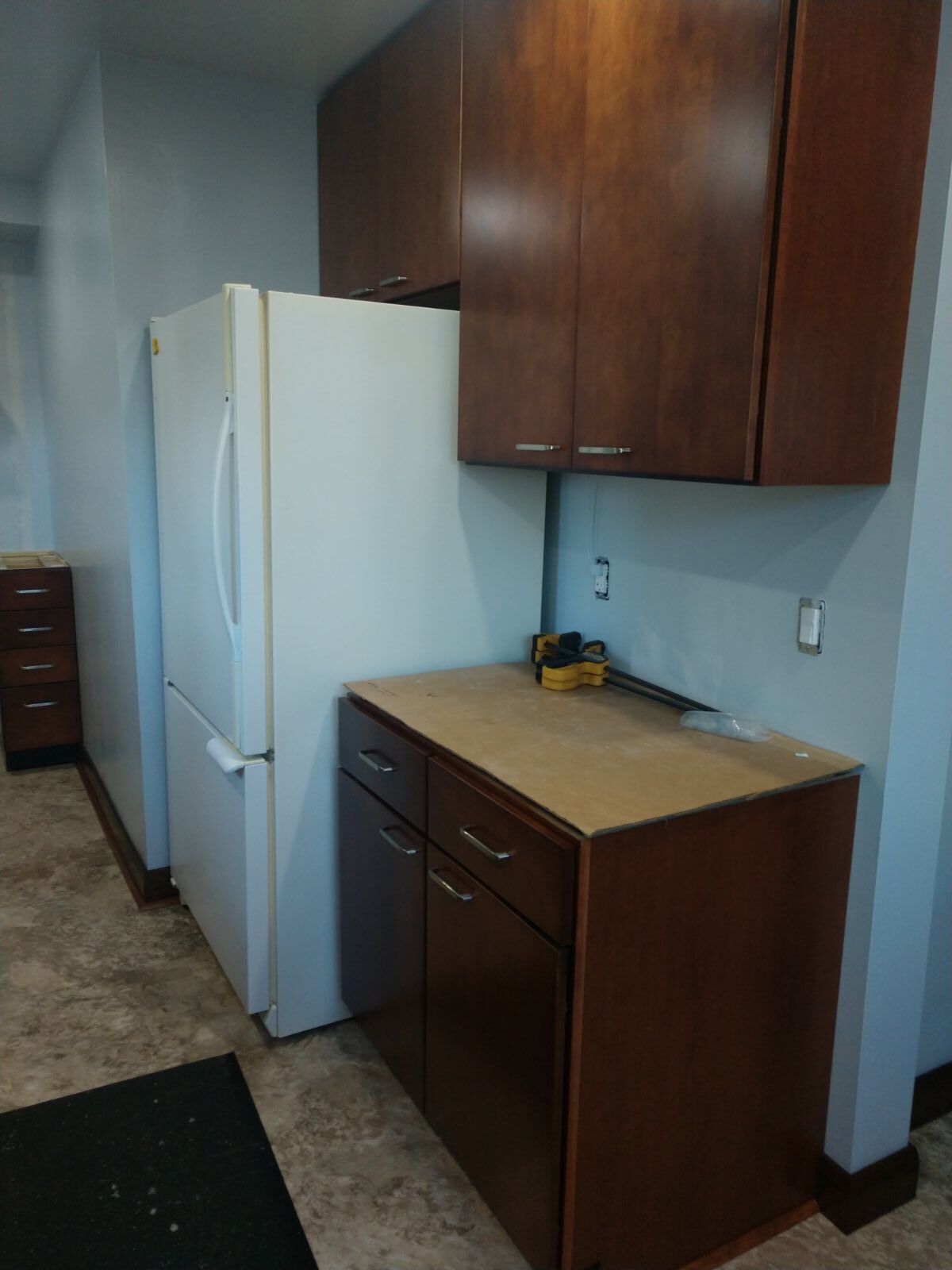

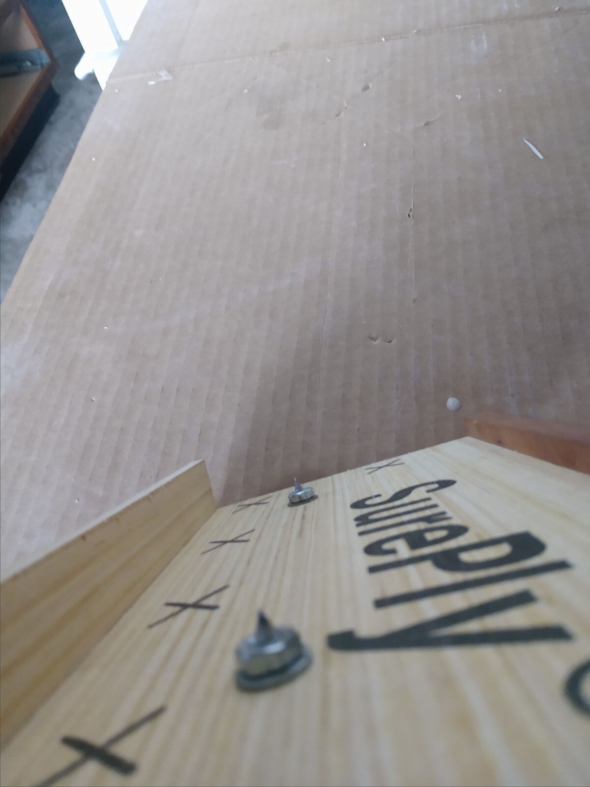

I did install the 2 upper cabinets & all the door & drawer pulls the other day. Made a marking jig out of some scrap and a couple of sharpened bolts. I tacked a scrap board to the edge of the jig and centered it on the face left & right and that placed the handles 3 1/4" down from the top of the drawers. Tap each bolt with a hammer and it left a mark for the brad point drill bit. We stayed the same on the taller drawer fronts so we don't have to reach down as far. I removed the scrap board and glued a piece to the oppisite side and this placed the handles on the doors 1 1/2" from the edge.

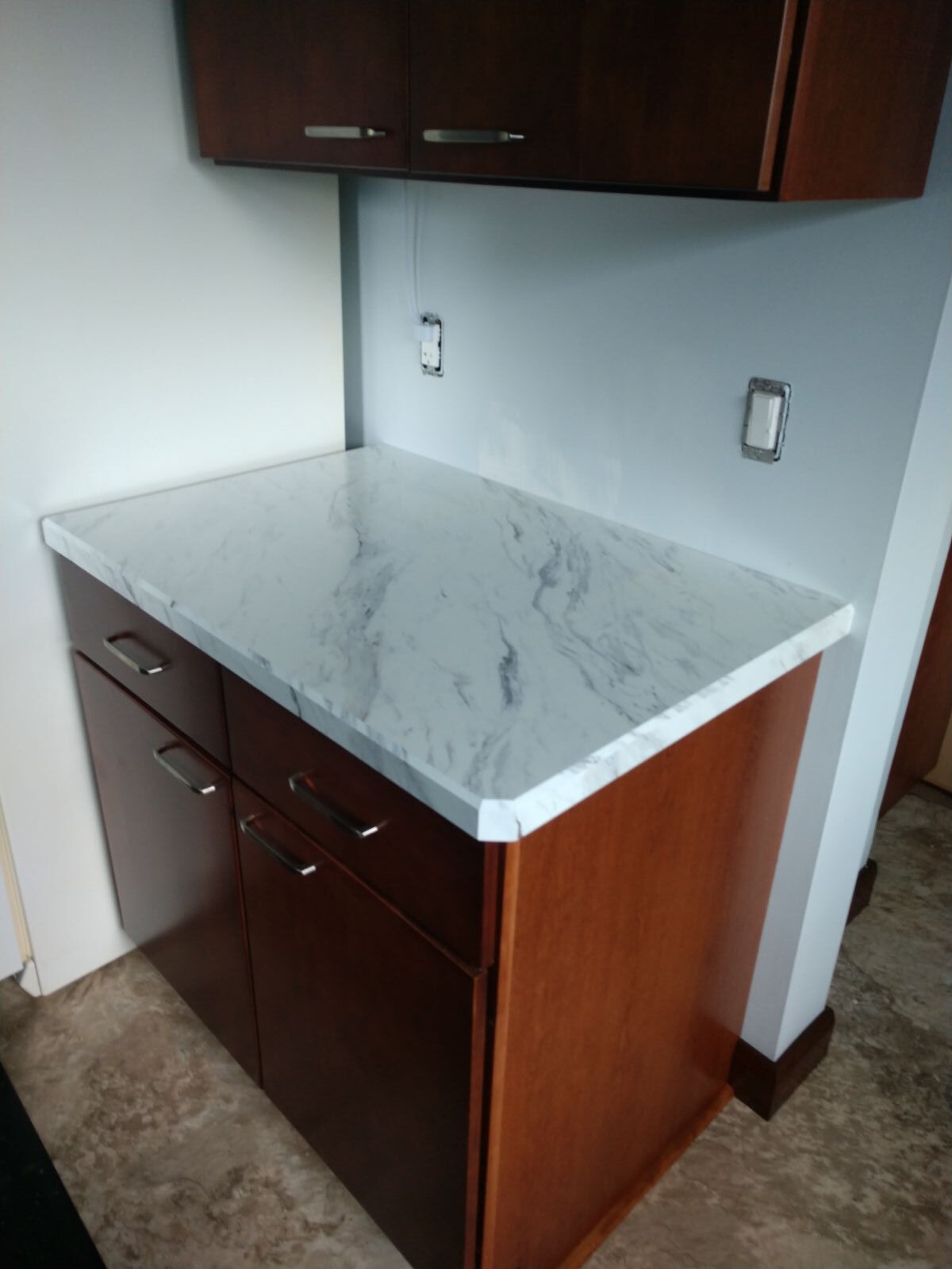

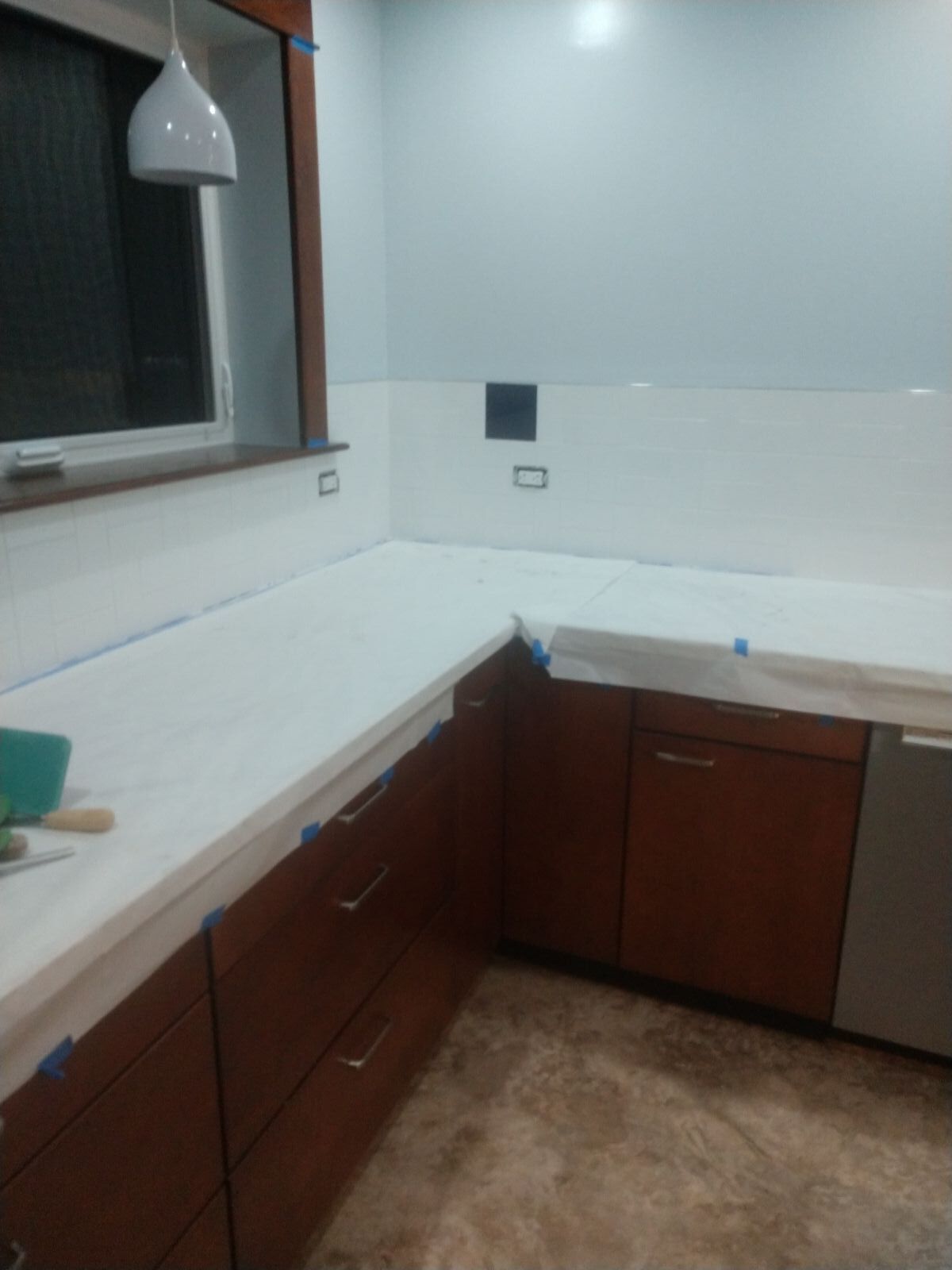

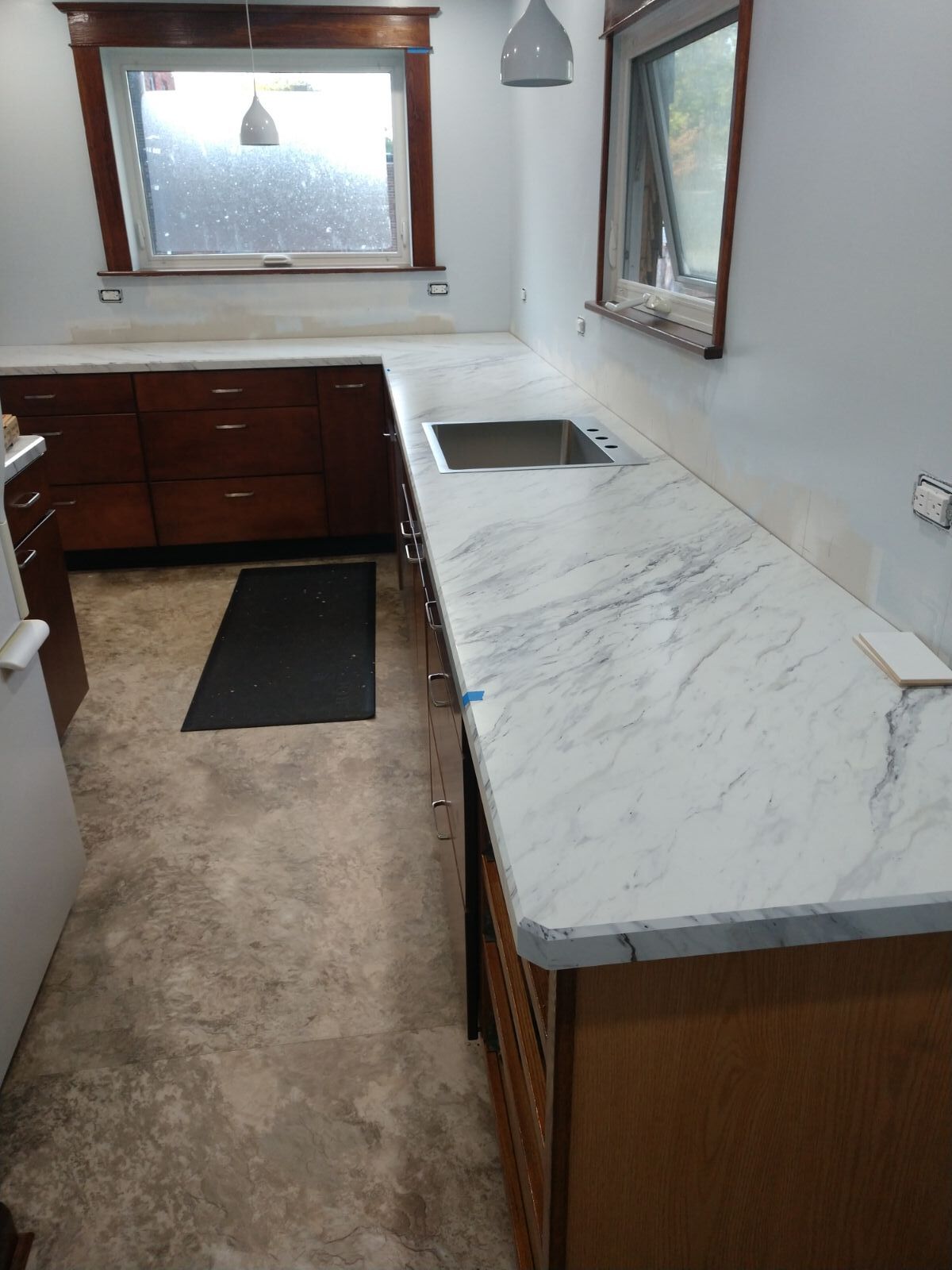

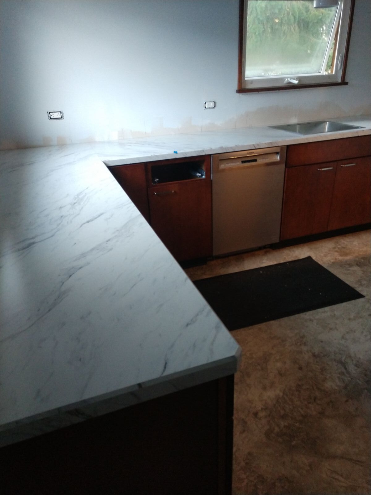

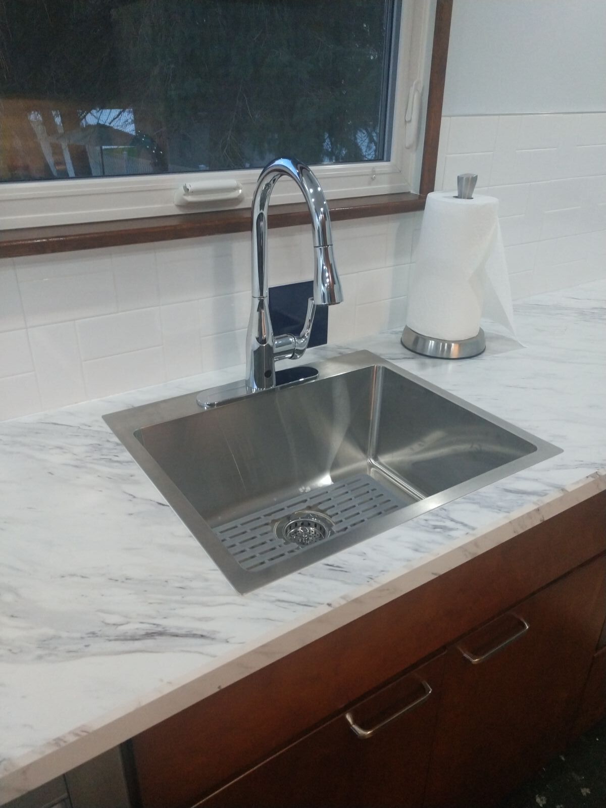

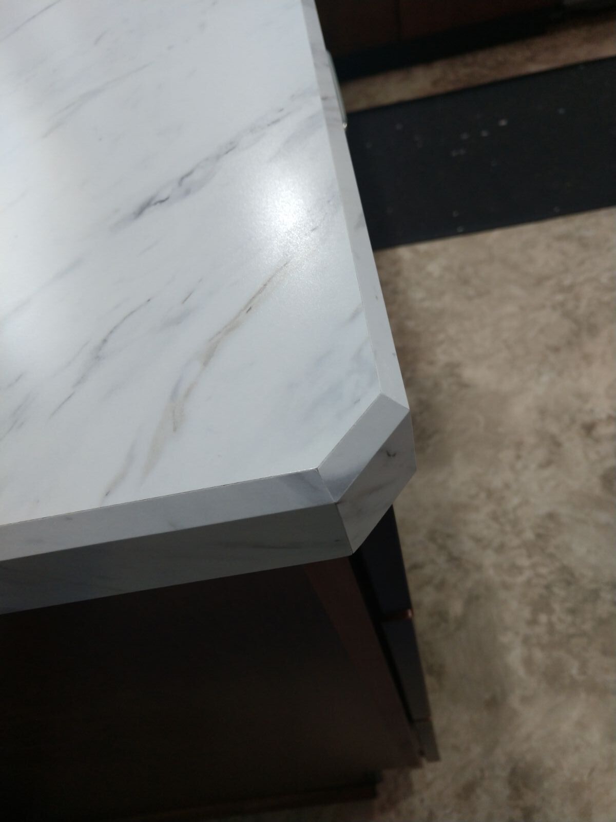

Countertops installed. Set the sink in to check fit, I'll mount the faucet and install permenently after the tile is installed. Blue tape shows the 9' counter space with a double sink that we use to have. Went with a single sink and that leaves 5' of counter left & right. Her baking station in 8' to the corner. We gained 72 sq. ft. & 16' of countertop space.

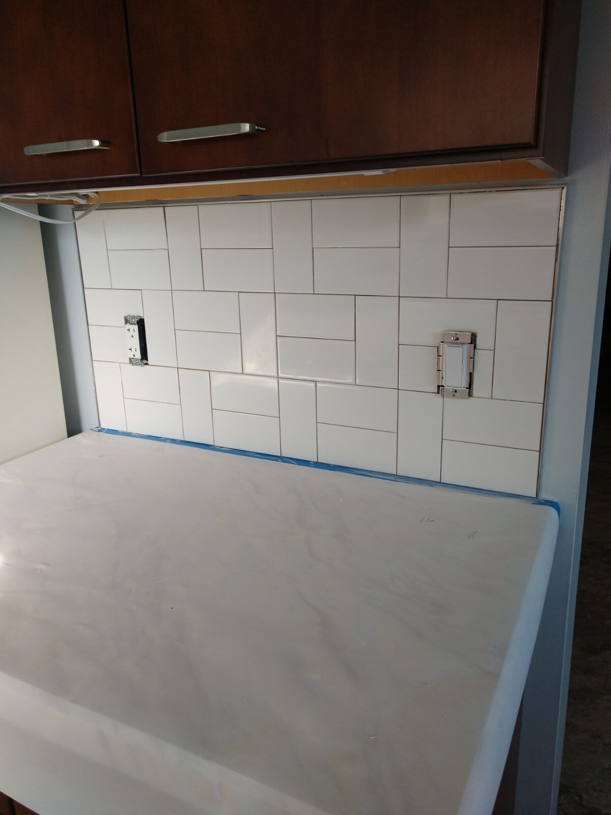

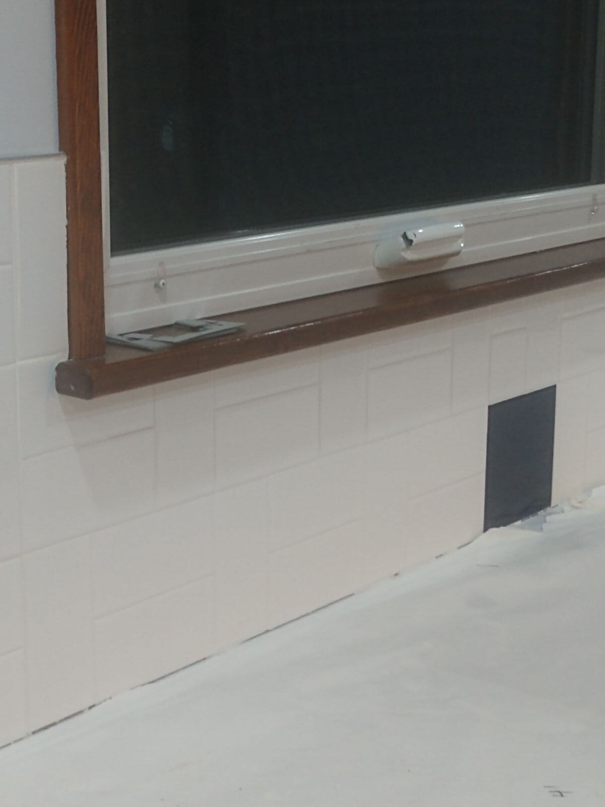

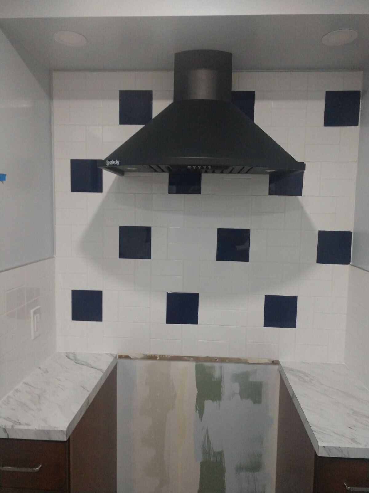

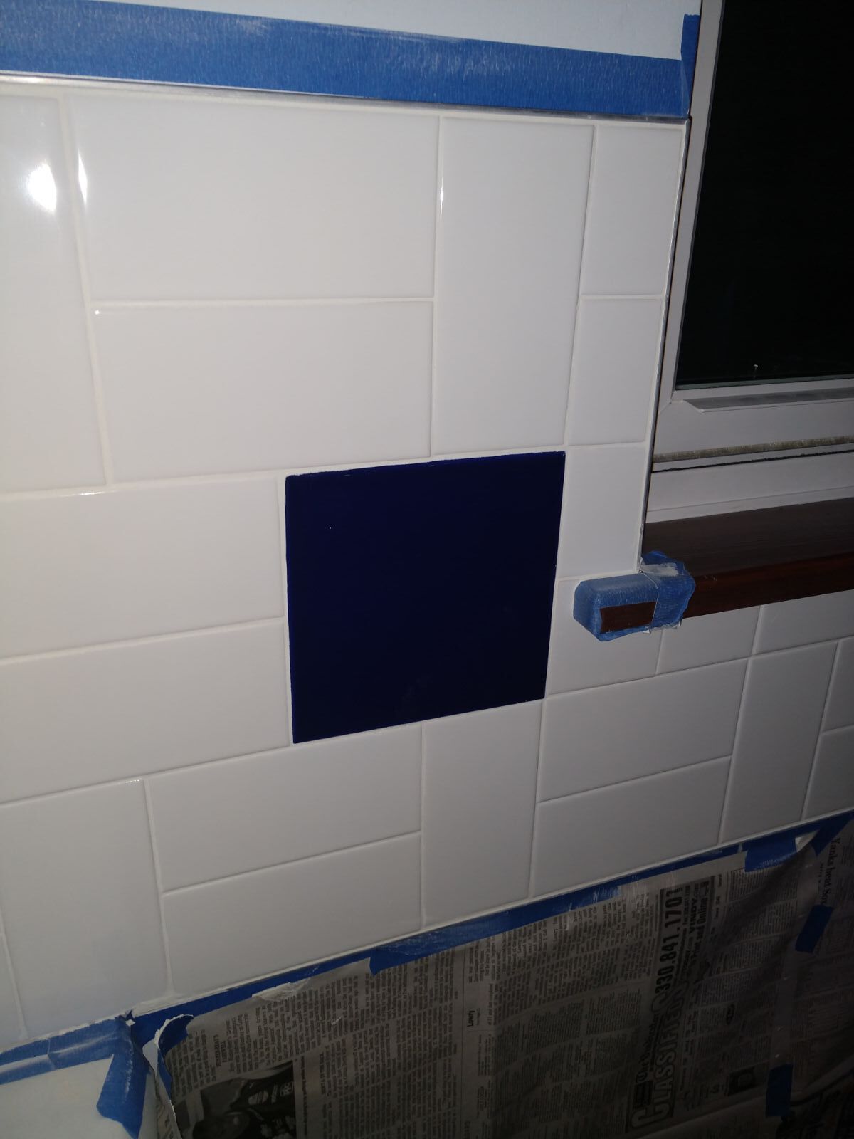

  Well thanks to Patti's "we got this" attitude & youtube we completed our tile backsplash. Installed the tile over three days doing a row at a time. I think using the basket weave pattern was more forgiving than a straight subway pattern. We purchased 7 boxes of 3"x6" tiles, 560 total, and used around 500. Added some color with 6"x6" colbalt blue tiles, color match to her kitchenaid mixer. When I installed the window sills I left a 3/8" gap from the wall to let the tile guy cut the tile square around the window and slide it behind the sill. He didn't benefit from that but I did. I made a jig to hold the tile in place with some scrap plywood and used a 4" diamond wheel and my grinder to cut the odd shaped pieces around the windows & receptacles. Straight tiles were cut with a $24.00 tile cutter. Broke a few but overall it was a success.
74.jpg.b46b7192002b5c3a71b809f21cfc61e5.jpg  77.jpg.851a1ae458e14997a2998c0ae012c29e.jpg
75.jpg.d156e5a98c0d2642c0cf6a94f836579a.jpg   80.jpg.bab3983d38d4a04f4e9769e91720a854.jpg

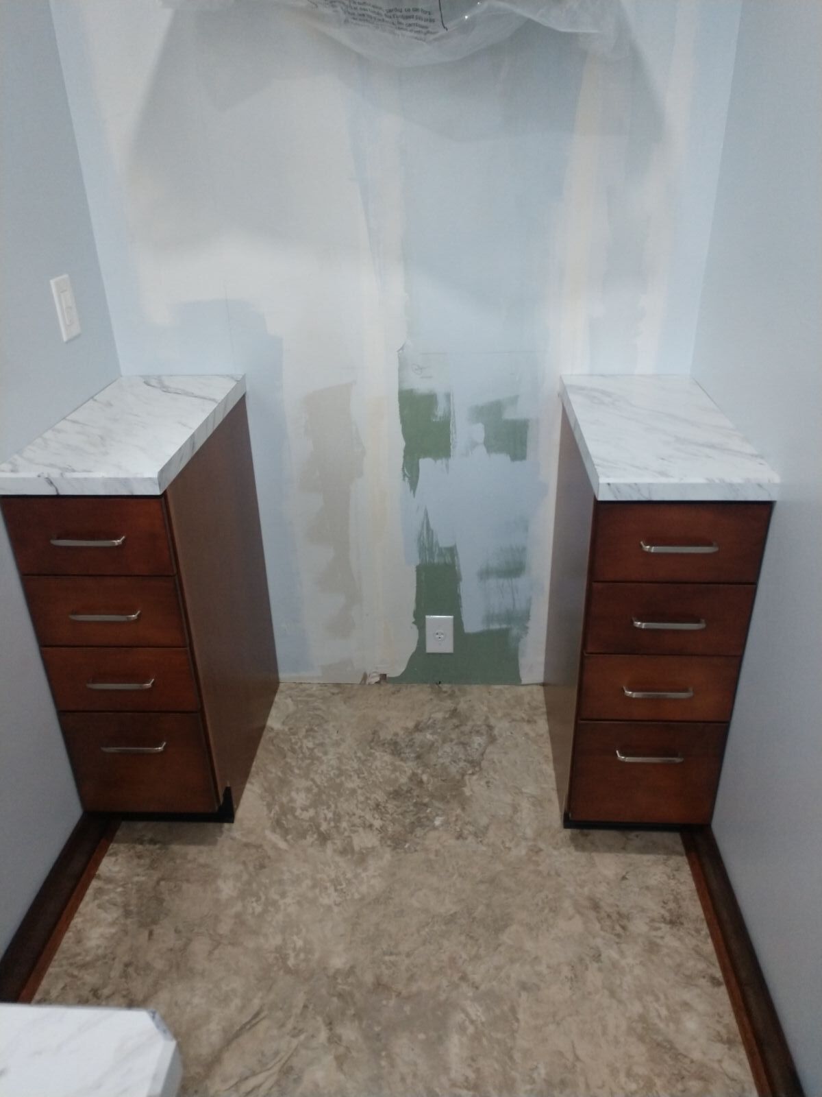

 Did the grout over a 2 day period and then sealed it. Waterproof between countertops and tile. Installed the sink, plumbing and hooked up the dishwasher. Cut the chimney for the hood vent to size and installed the hood. New gas line for the stove will be next week and hope to be cooking by the weekend.
