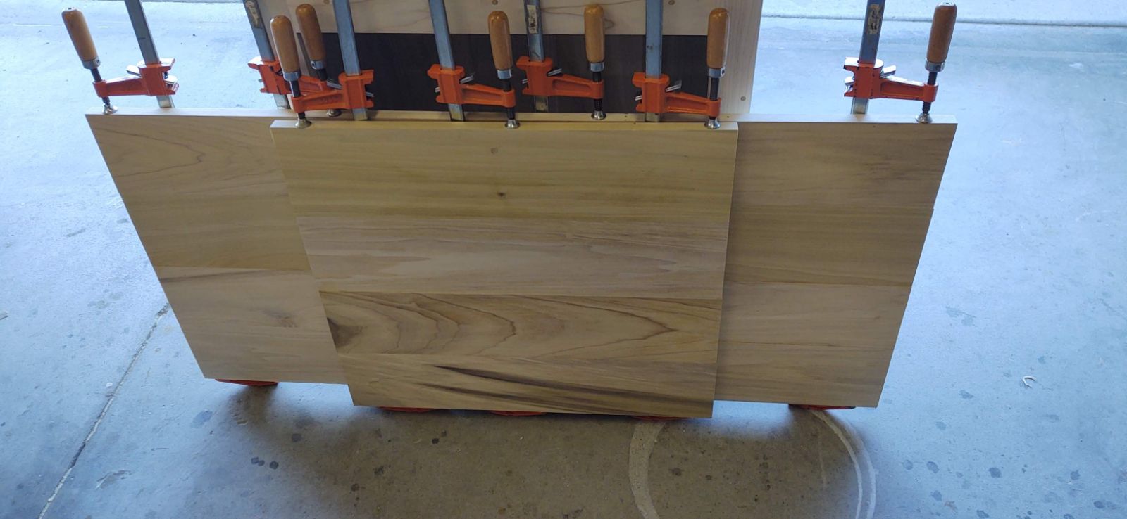

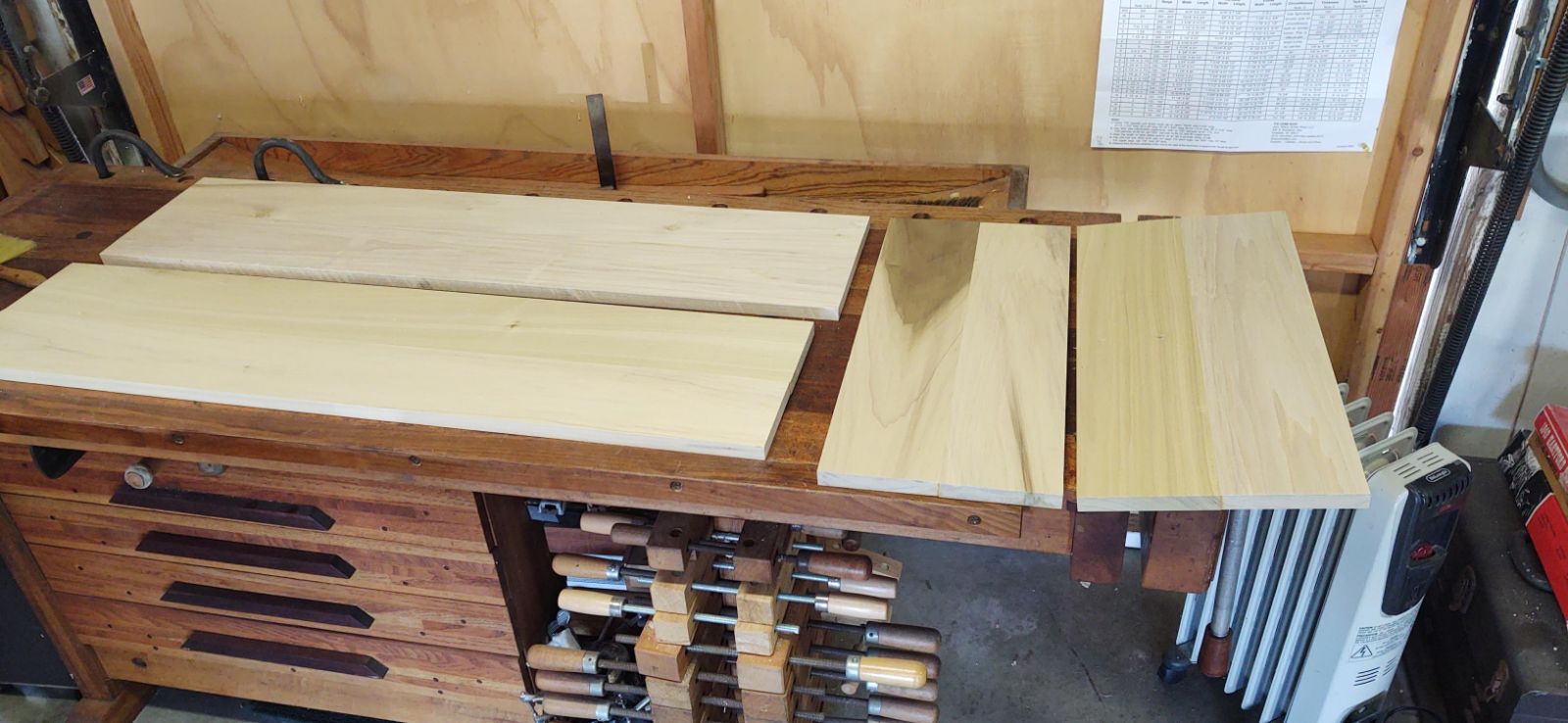

I took the glued up smaller panels and joined them, and glued them up to form two larger panels.
I joined two edges together at the same time, you'll see two shavings coming from my jointer. This way, even if my iron is slightly off, and the edges are not square, it won't matter, all I do is flip one board 180 for the glue up, and the boards will join straight.
Two panels below, for two doors, top and bottom doors of the cabinet.

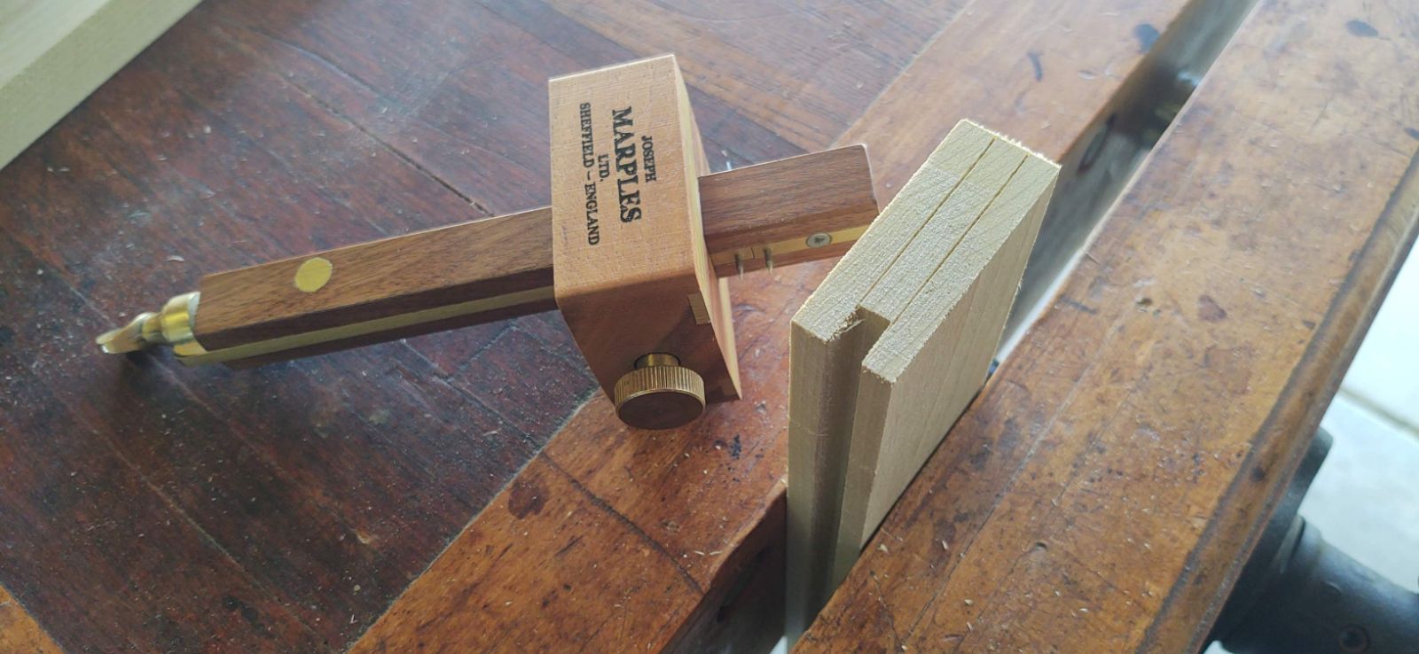

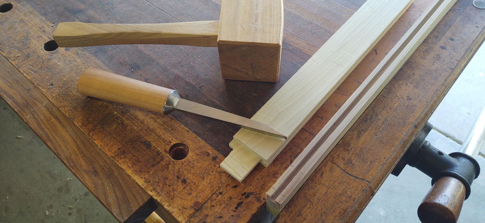

I moved on to the door frames now, I am doing haunched tenons on the rails, with the mortise on the stiles. I marked everything out first.

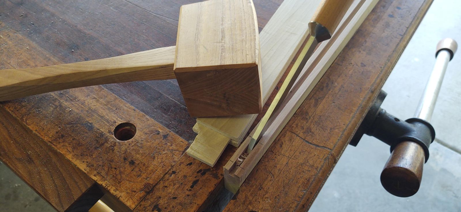

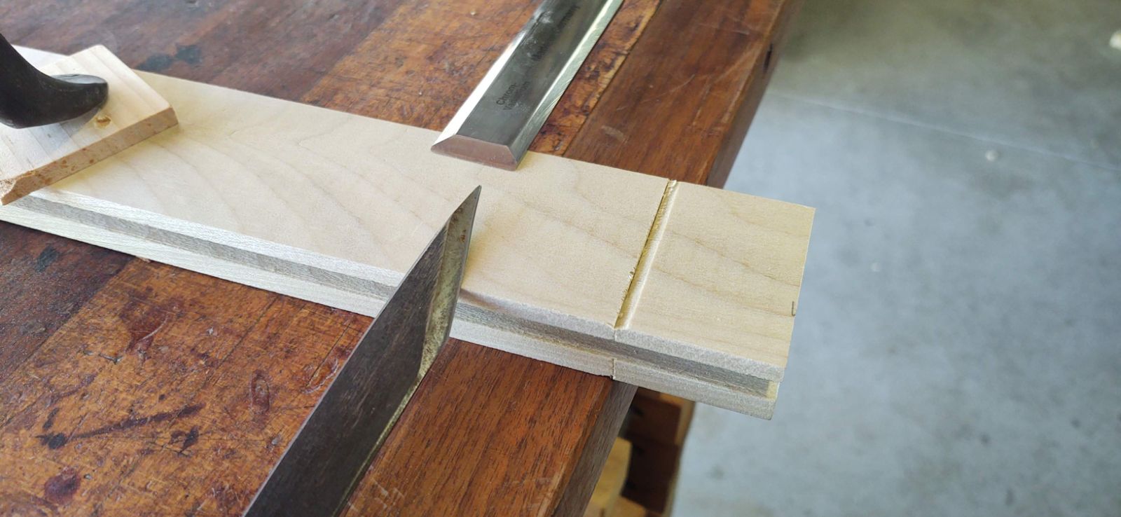

A little trick I learned recently, knife cut the cut lines, and chisel some waste out, before cutting the tenon.

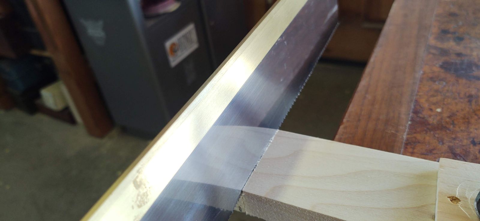

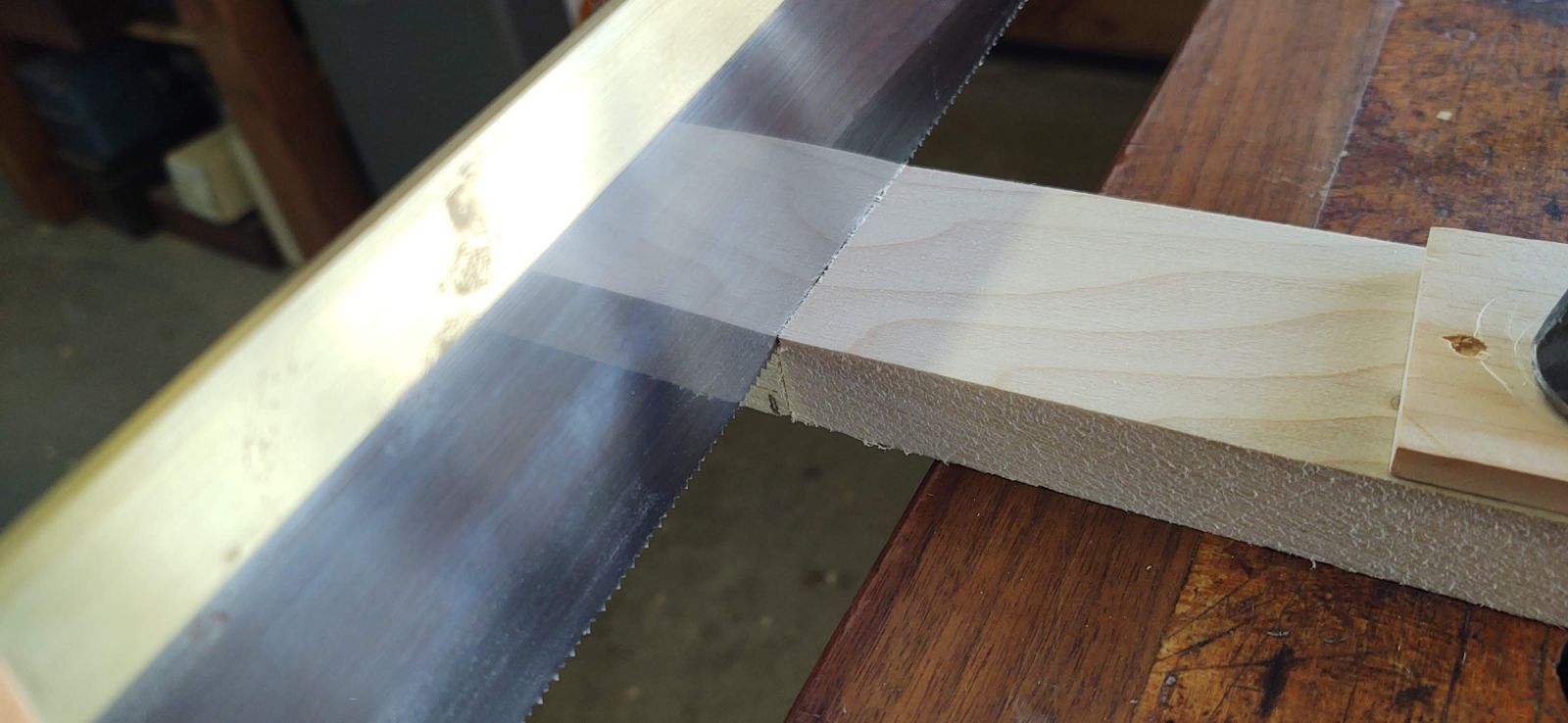

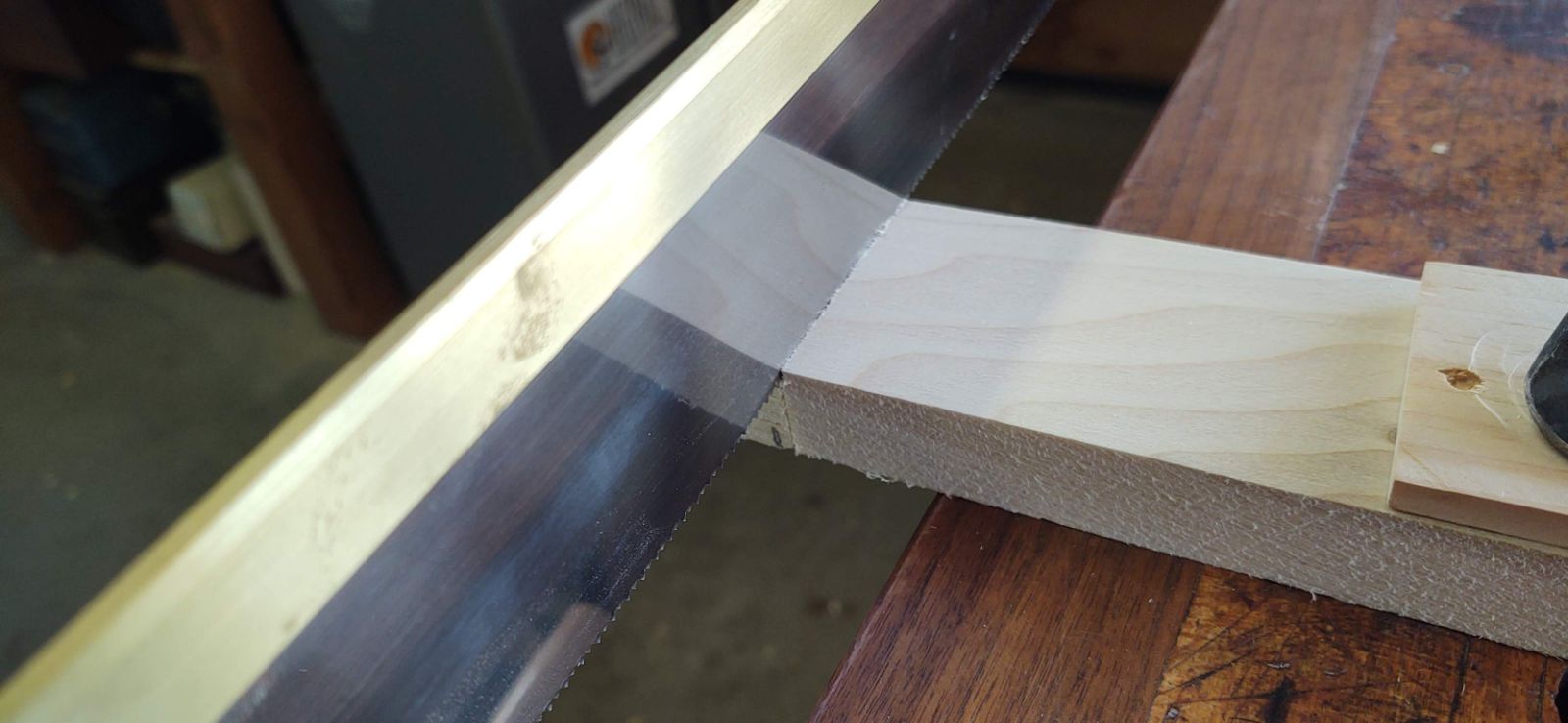

Another trick I picked up along the way a few years back, can't remember where, perhaps on the Lie Nielsen website where I purchased the saw from, but as you cut, you can keep your eye on the mirrored reflection, if the reflection is angled, so is your cut, if the reflection is straight, so is your cut.
Your cut is angled right.
Your cut is angled left.
Your cut is straight.

I marked out the mortises in the stiles and went to chopping with my 1/4" mortiser.

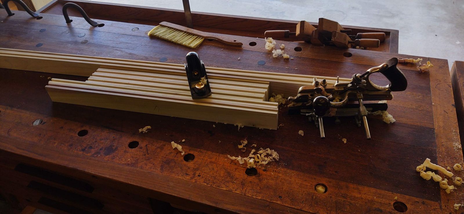

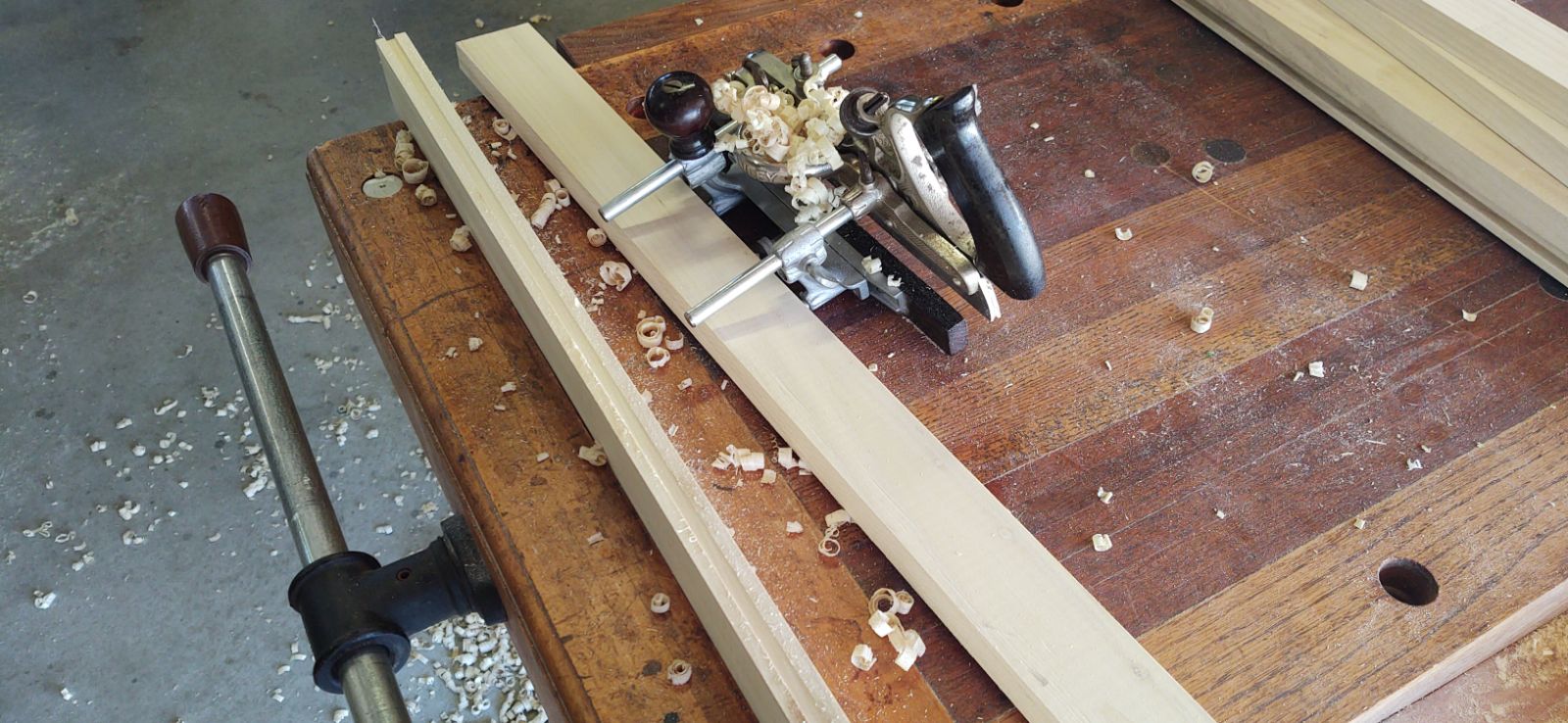

Grooving out four more stiles.
