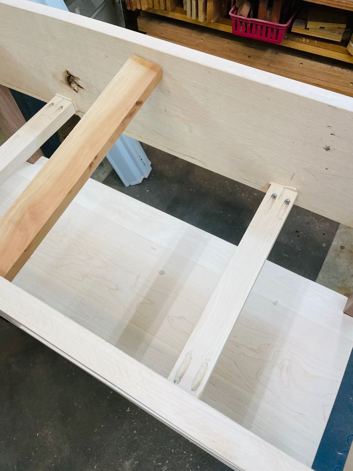

Had to place the supports to attach under drawer slides and center support for the front rails.

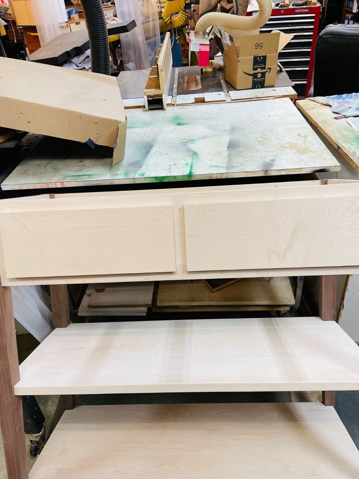

IMG_4792.jpg.02a320b38bbfc08efd2e769ec72e004d.jpgOk could not resist a peek at how they will look before routing the edges.

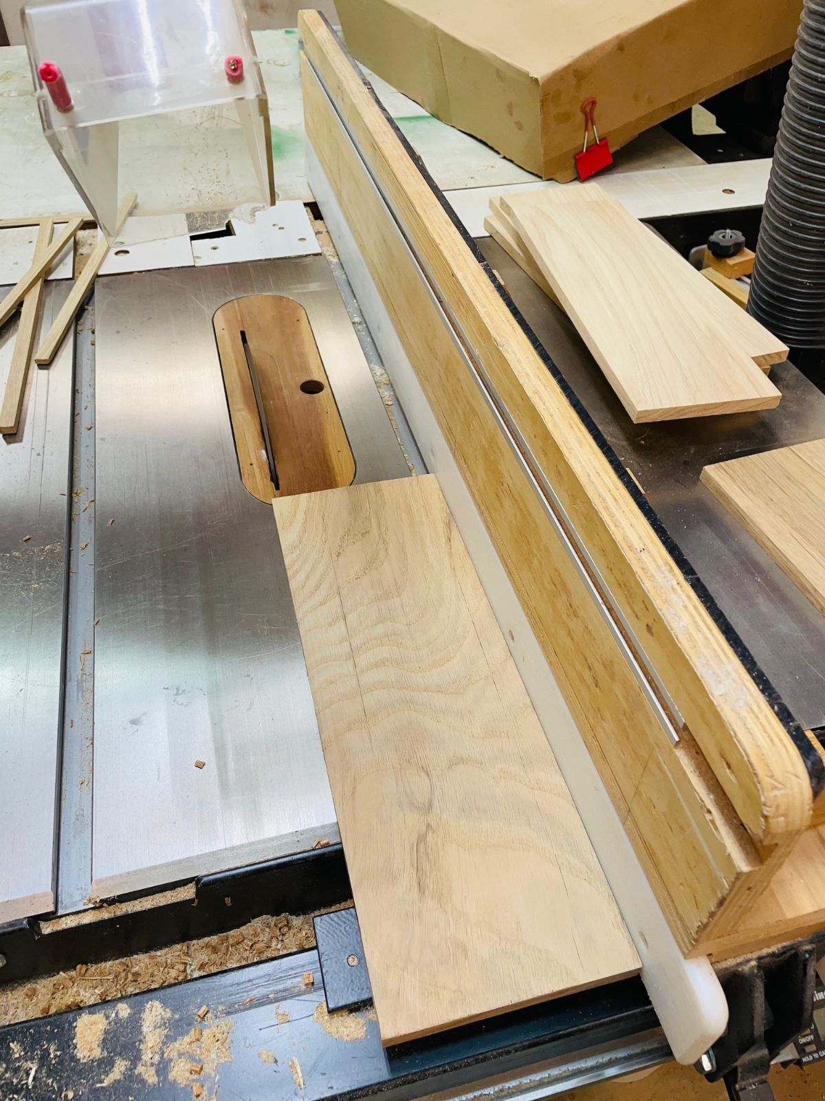

IMG_4794.jpg.ceb0dc5cae4d823100c264633daff6df.jpgTime to rip the drawer sides to height .

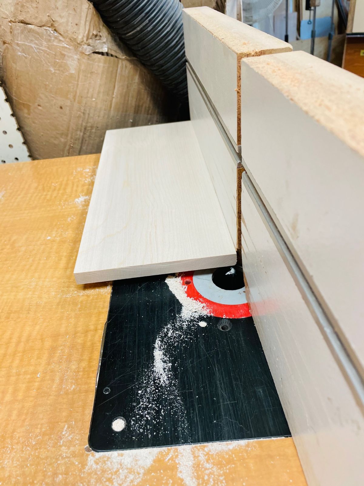

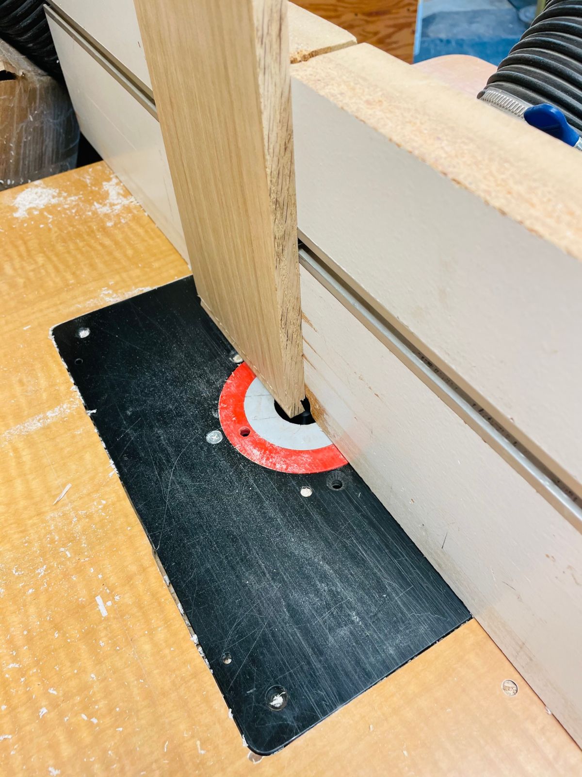

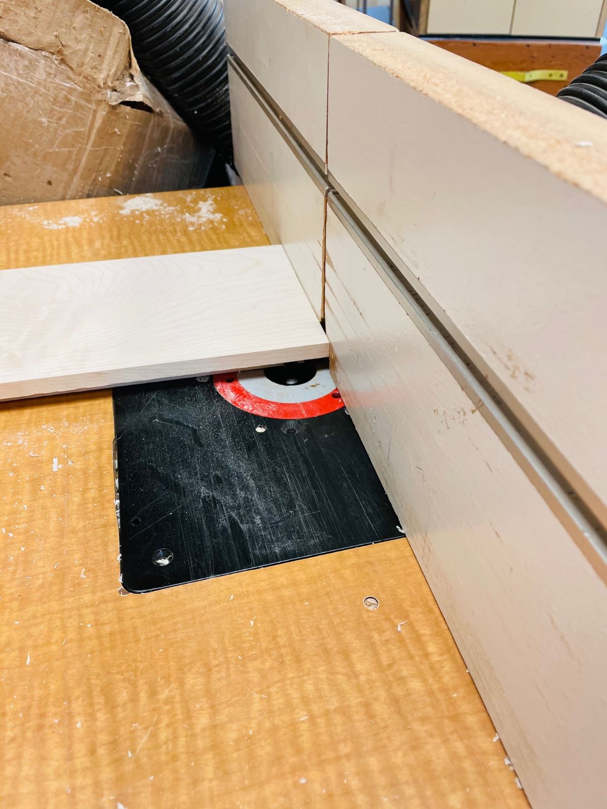

IMG_4797.jpg.04bfc6d740548a7880bdfed6a7cc8375.jpgNow you cannot see what the bit is doing but this is cutting the dovetail recess for drawer sides in fronts.

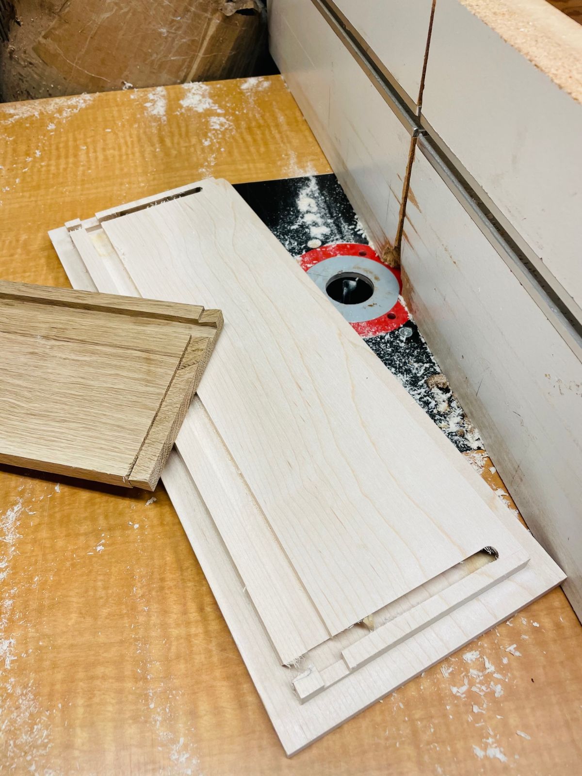

IMG_4795.jpg.ca4211635e72e02c93019c1d16d7b908.jpgTime to finish the day with cutting the sliding dovetails in drawer sides. Hey if I get lucky may have drawers ready to assemble tomorrow.

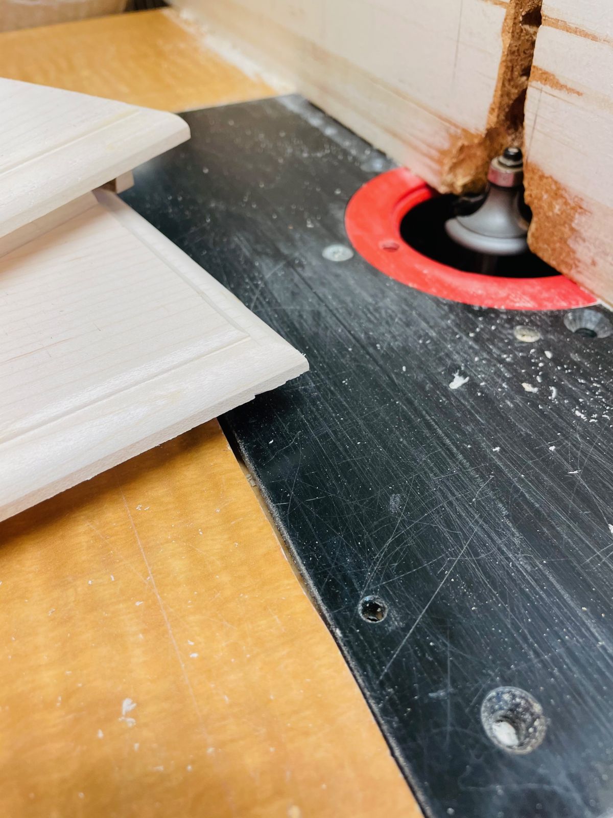

IMG_4812.jpg.c84de7e92b18482e32a0c3d172518ea5.jpgCut the edges of the drawer faces with a French Tabletop bit. Could not get the full profile but it did most of what I wanted.

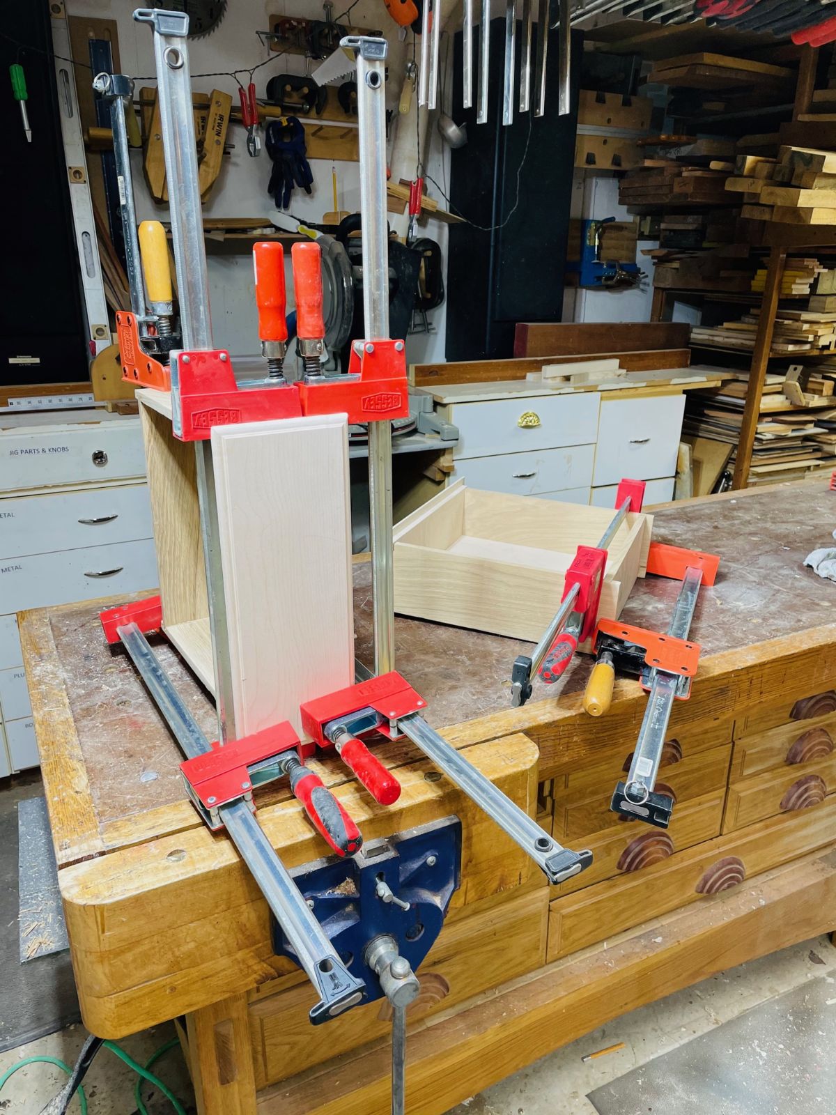

IMG_4813.jpg.286daf111abec02054f87a1a0c7af523.jpgYes that is a lot of clamps on that one drawer. Remember I said a problem existed. Well this is to hold those pieces tight to the drawer. Plan to put some pinnails in there also.

@sreilly24590I have done the sliding dovetail with 1/2 ply for drawer sides and solids form the front. This allows the drawer face to inset into the cabinet without needing that extra piece in front of box . It is a little tricky getting the cuts right but the drawer front is indexed perfect to front of cabinet.

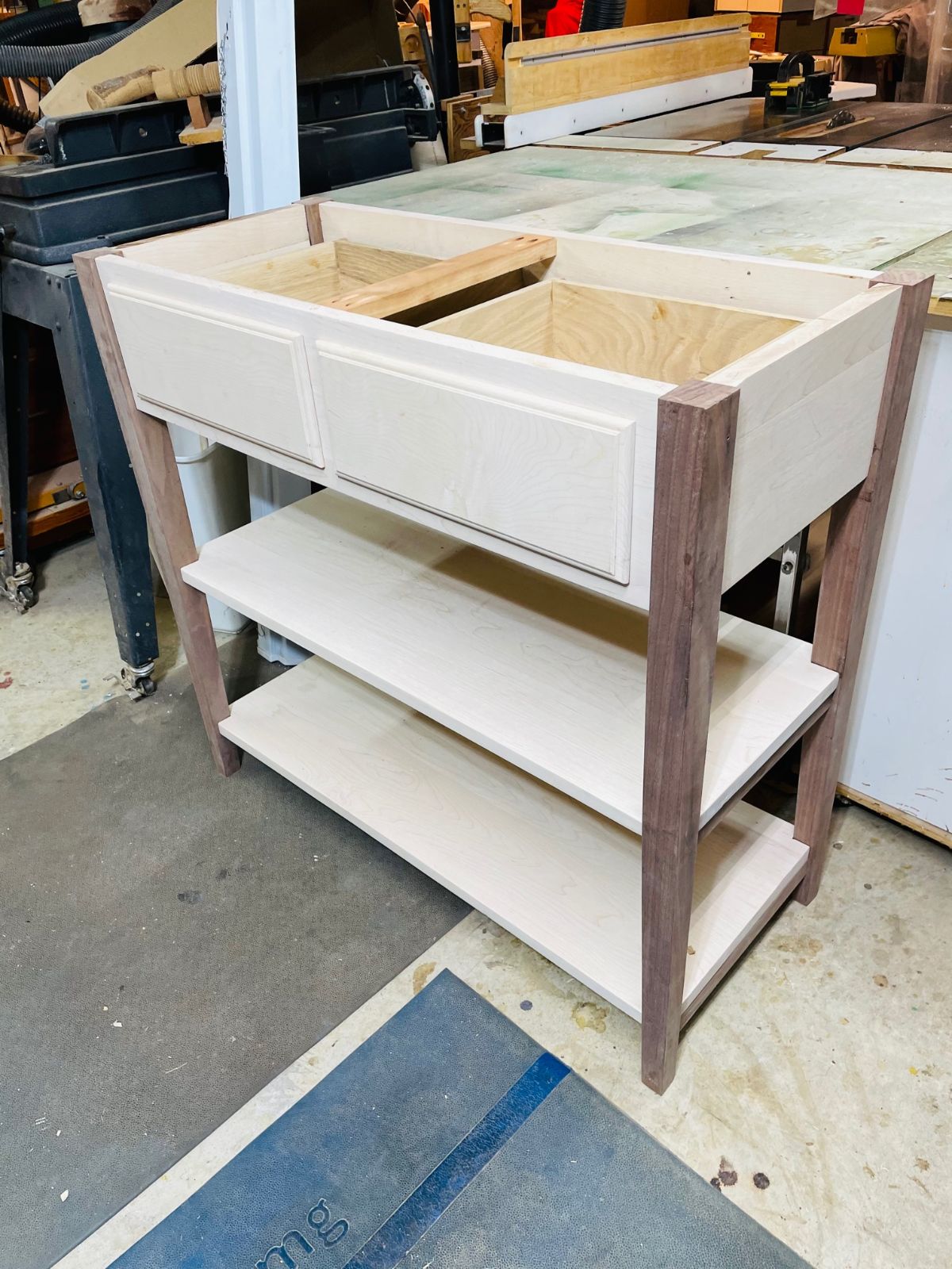

IMG_4814(1).jpg.7fda40c96e49291d738d63beb8e310f4.jpgCut the drawer fronts with a French Table Apron bit and will use the same on the top. Installed the drawers and now ready for the top.
