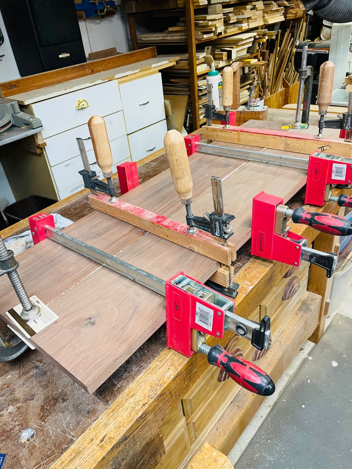

Well after the wife told me she wanted a coffee bar I tried to procrastinate. Bought the lumber 4 months ago and finally this week started building. Already had the walnut for top and legs so started with that,
IMG_4673.jpg.e813893d828078b5e354f9f15fdc9573.jpgIMG_4674.jpg.4df0893ff553c69788d6253be499affa.jpg
So this quick and dirty taper jig sees service. Have plenty of these clamps and they worked great for this.
So now time to clean up the saw marks and shave some of that old patina off. Did I mention the walnut has been laying around a while.:D

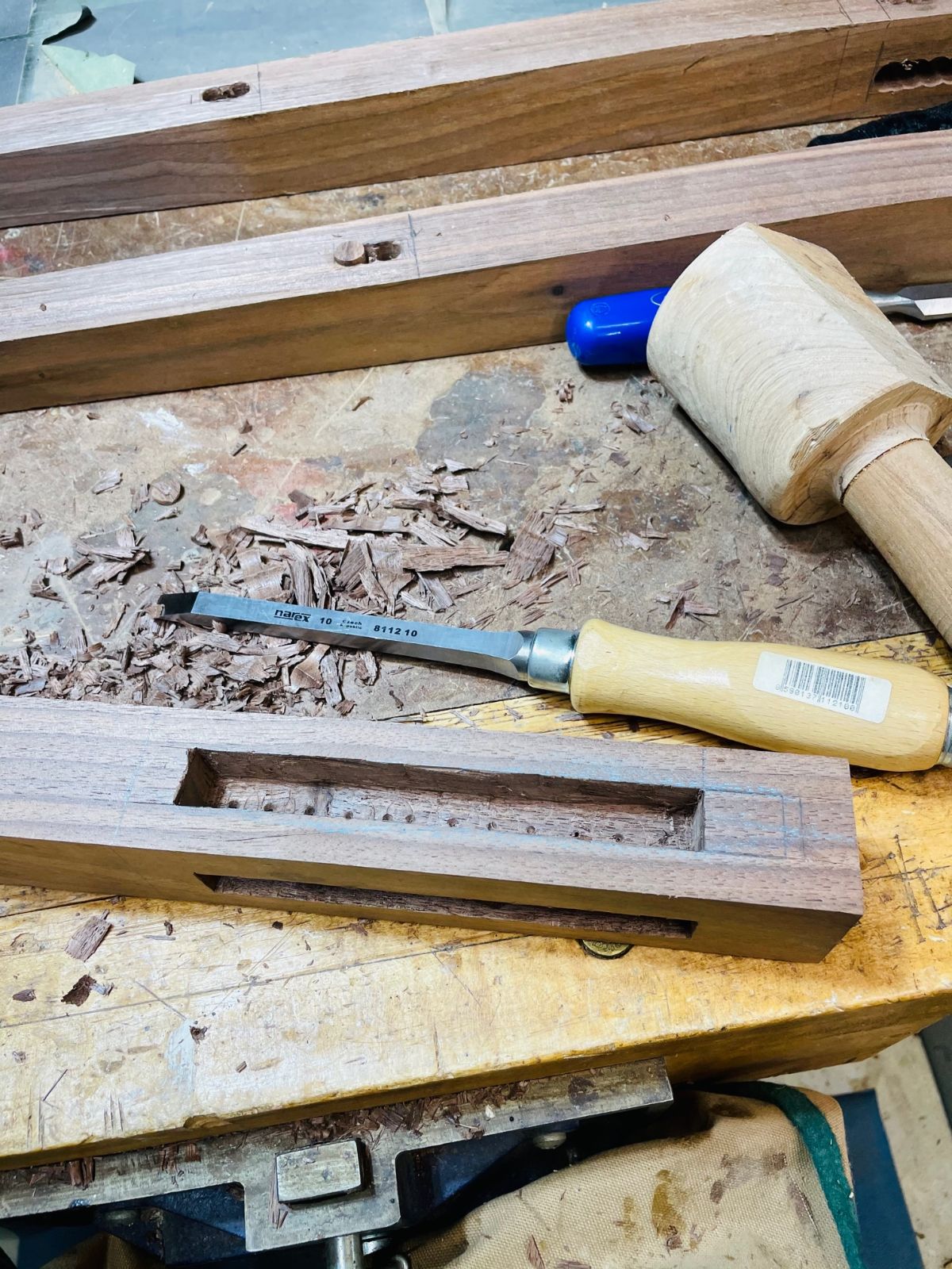

Well this has not been my week for shop work. Been getting records ready for change of woodturning club Treasurer (me) to someone else. Then the committee decided we needed to get a computer for him, The one I have is for our video productions. But all that aside I did mark out the 16 mortises and tested one for drill press. That worked well . So today will be more drilling and then cleanup with the Narex mortising chisels.

Got all the mortises drilled and started cleaning them up. Totally finished one and half of another cleaned up.

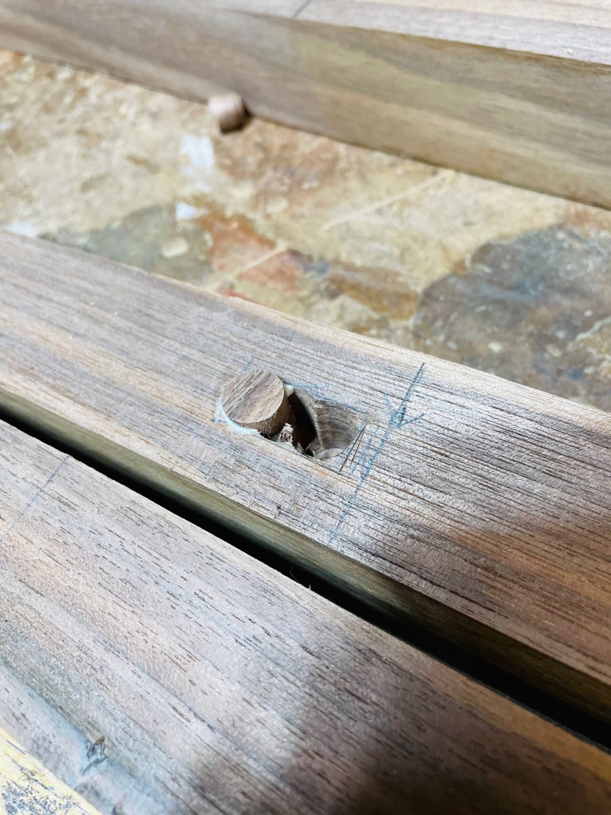

This is a repair of mortise too large.
IMG_4695.jpg.2ee7b7499df90ee98805be3e70f2192f.jpgIMG_4696.jpg.ede99bc9175157448271f97c550ea377.jpg
Since these mortises are almost directly opposed there may be a slight overlap requiring cutting an angle on the tenon so both will fit. The side is 3/4 deep and the front and back 1 inch deep.

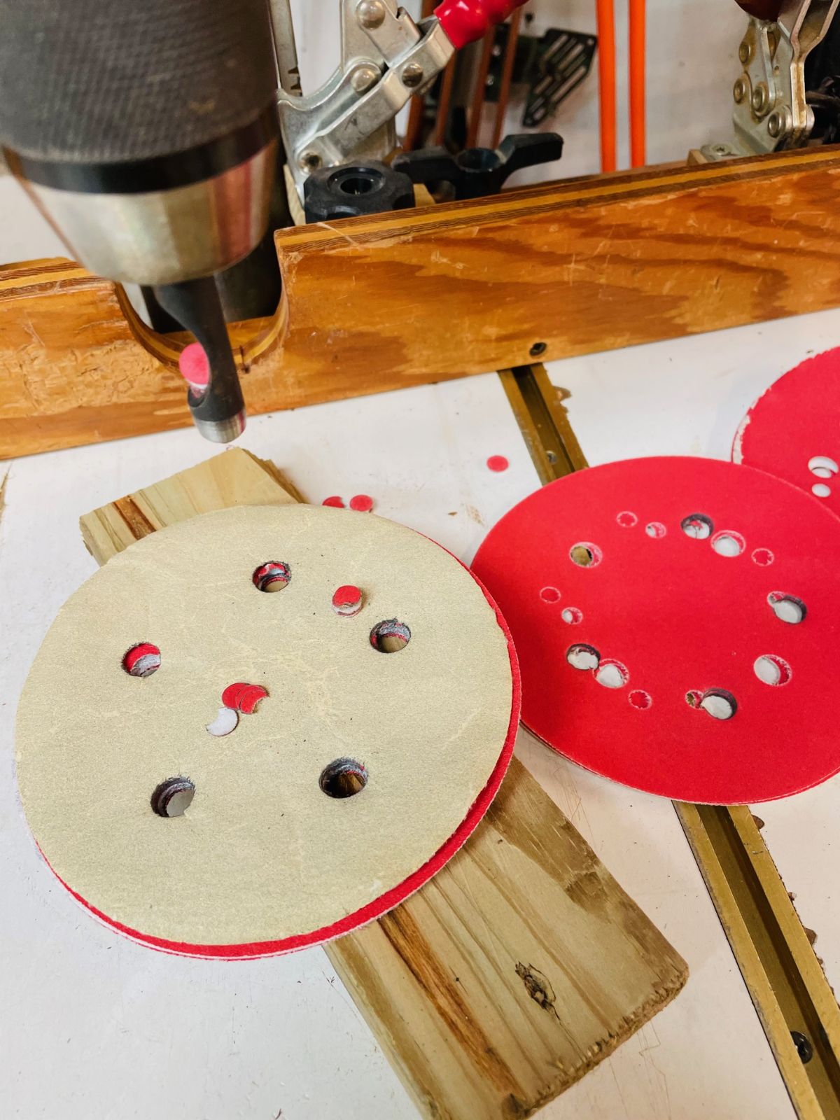

Sanding time but that is no fun. Needed sanding discs so used a giftcard and got some Diablo as they do not stock my preferred Norton 3X anymore, Bummer. Do not really like the Diablo and the universal pattern does not work on PC 5 hole sander. So had to punch some holes.

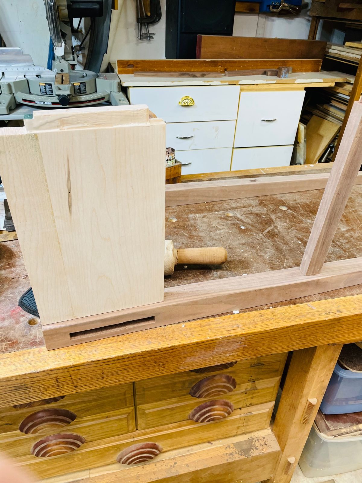

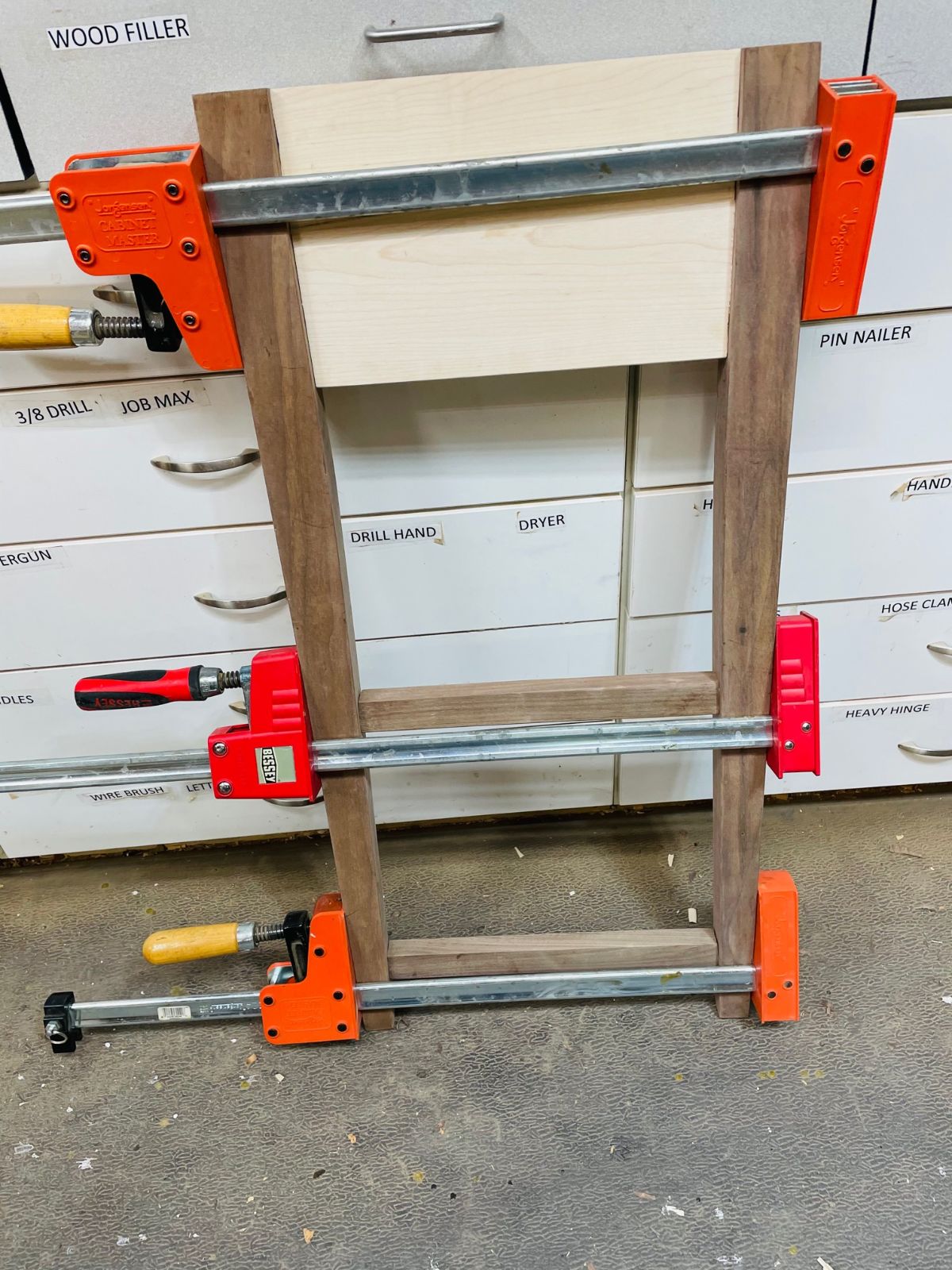

IMG_4737.jpg.d4aa61dc0684f2d9b3db2e67599457be.jpgIMG_4738.jpg.b7702513aefd6756f27cdf82d373d9a6.jpg
Then some glue and clamps and both end ready for shelves and drawer box.
