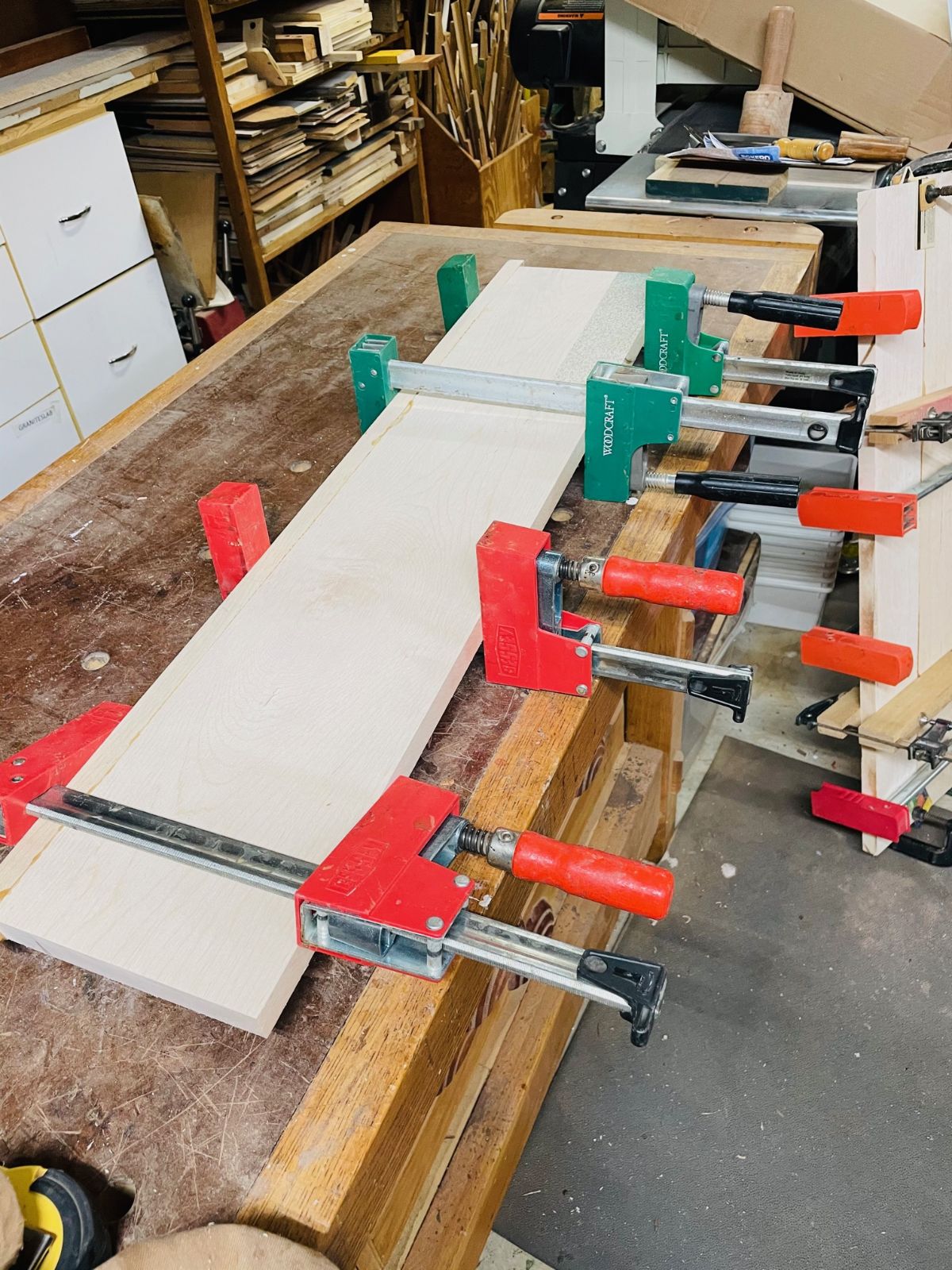

IMG_4743.jpg.dadc5c18231b5d341c85958781d8c47a.jpgJust getting round to showing yesterdays work. Got the shelves cut and ready to glue and glued one . Also did not have stock at 8 inch so glued on a piece to get there on the back. Ran out of cauls so will do the rest tomorrow.
Sorry left out the pic with the #8 in use again but that Glue Line Rip Freud blade did most of the work.

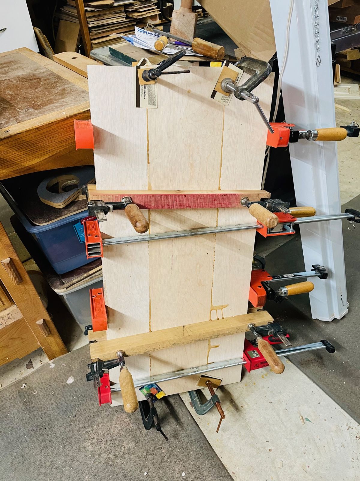

Gerald I notice you have glue running in to you clamping cross boards. Next time use was paper under those clamp assist .
Edited by Smallpatch
Thanks but the glue only got on waxed cauls  and not on the clamp bars. I did notice a considerable stiffness in the mechanisms so guess I need to lube those a little  with maybe a teflon lube and wax the bars. The thing is I used some clamps for this I have not used in maybe 3 years.

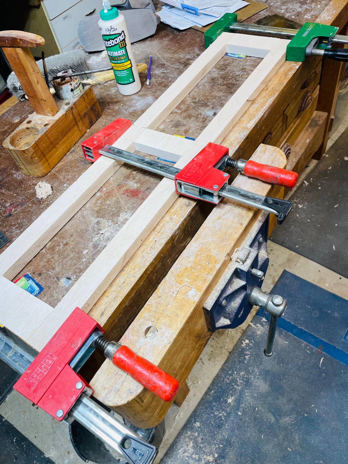

Got the face frame glued up for drawers yesterday. Today went to Lowe’s for undermount slides. Wound up getting regular Slides and will adapt to undermount. This will be a new experience but we only live it once so try something new. The whole face is 34 inches and drawer opening 15 each2B6A2841-4755-4633-87E7-1C1B72918D15.jpeg.223d50233fad7f73291e675895594eae.jpeg
Looking good Gerald. Why do you choose to under mount the drawers ?
Paul
Paul
Something I have never done. Started to do the old way with no slides but got to thinking that the wife who will be using mostly tends to pull drawers all the way out and down it goes. Then second is the option to not have a slide showing and since the drawers will not get that much use the center undermount  give a more elegant look. Drawers are 14x15 so not a large drawer to need lots of support.
Gerald did you use splines or anything when gluing up those boards?
Just interested to know!
No just long grain glue up . I am considering putting a screw , top and bottom , in that center.
Okay, how about the panels? Just glue as well?
Just curious about when folks tend to use splines or other joining techniques and when just glue. Helps me understand when I might choose similar options (when I can get back in my garage).
There are no panels. Ends are solid using M&T joint. To further the discussion I never use biscuits. Alignment can be achieved by planing the joint after glueup. As to strength side grain joints are as strong as the wood.

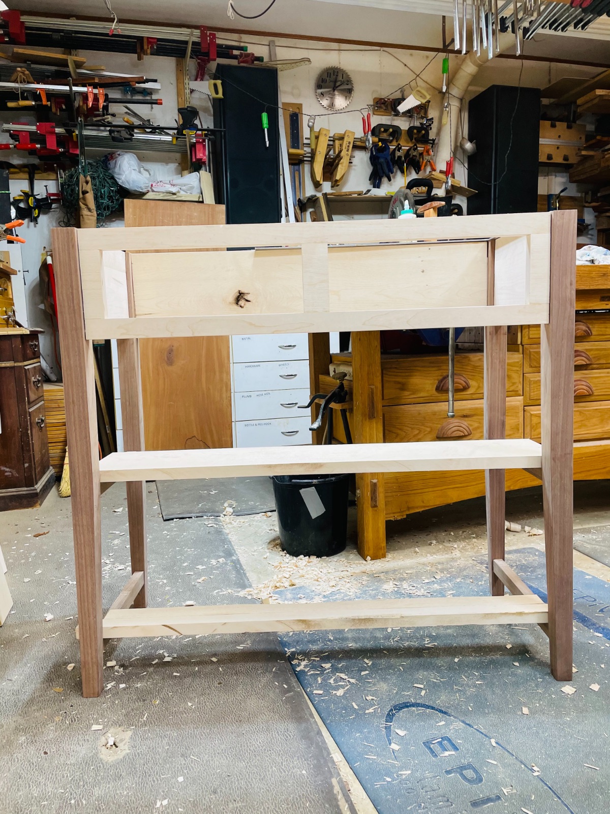

Now all mortises cut and just need a little tweaking. I laid some scrap on shelf support to show most of the look. Will have to cut notches in shelf corners to get them laid in. Now sanding time on shelves and front and back rail. 3D5DC15F-93D8-435D-9D49-EEDA841B9E3D.jpeg.98cdd40c31fdeffe5ec5b7b4473bd28b.jpeg

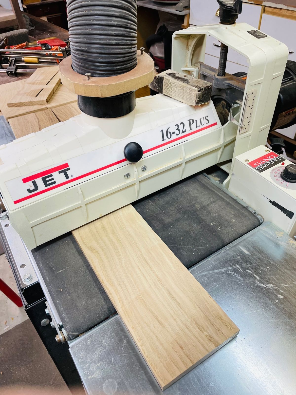

Getting close now. Today glued the front and back of the drawer box tenons in and screwed the shelves in place. Then time to prep some white oak stock for half inch drawer sides.
It's coming along nicely. Those tapered legs are gorgeous. I'll bet that fitting the shelves wasn't a walk in the park. Achieving those subtle things make for real class, though. It's a beautiful piece. Can't wait to see it in it's competed glory.
X2
Fitting taper legs, yeah I tried that once and it was a disaster.  Second try I asked for help.  :)
