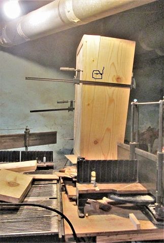

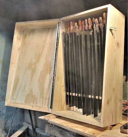

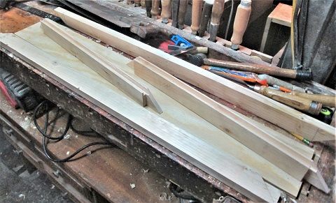

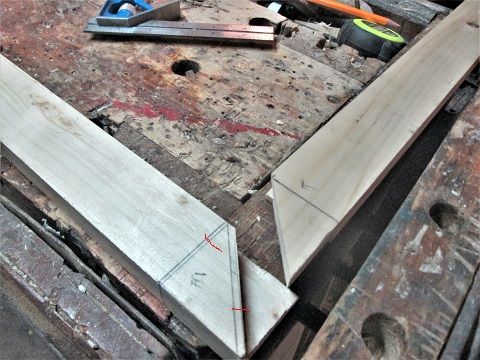

Well, while the saw til sits at a slight lean back....I wanted the front of the door vertical/plumb, as I have a few saws to hang on the door.

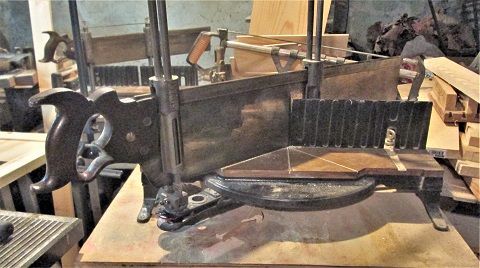

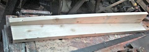

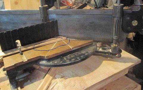

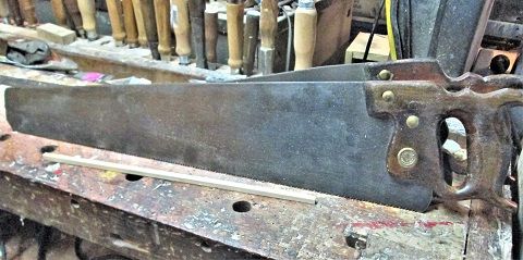

Cut one of the 1 x 4 x 6' planks in half....stood one straight up, and against the side of the til.   marked a line for the angle, and another for length...Mitre saw cut the plank for length, and to cut the plank in two....then the bandsaw made a cut..
Wide end is the top of the door....other board will be a stile...something like this?

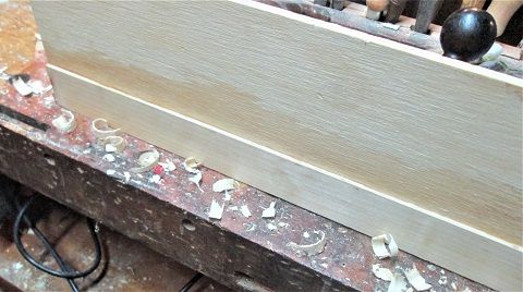

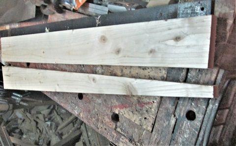

    Ok...hauled the other 1 x 10 to the shop....needed 2 pieces..a Top, and a Bottom....seems the board was doing the "Wave".. Hmm, not good... These were a part of the problem..

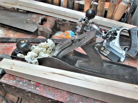

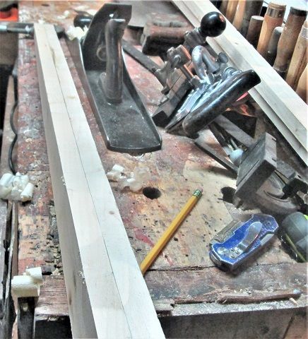

had edges to joint...Stiles and rails to cut to length, and rip to width.  Jointer plane is a No. 6 Stanley..B)
Had the Stanley 45 cleaned up, and set up with a #14 cutter..:ChinScratch:
Stiles and rail got a groove plowed..always seem to find a knot...:DevilLaughing:

Double lines?   first set was off a bit..:BangingHead:

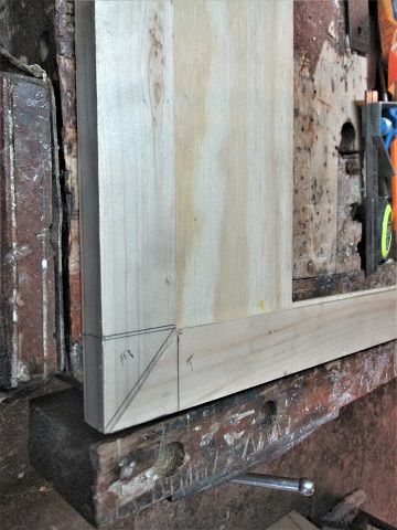

Had to re-align   joint is a half lap, and has a mitered corner...when viewed from the front..B)

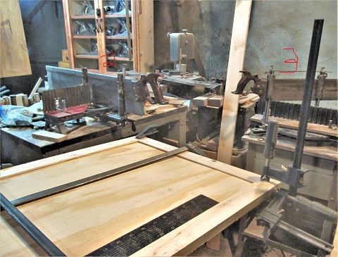

This is what you'll see...lot more glue area than a simple mitre joint..got all the stiles and rails milled..:ChinScratch:

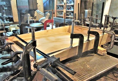

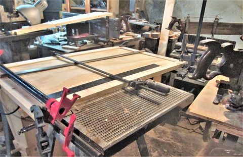

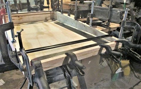

Then cut the plywood panel to size...then the real fun began..:ArguingSmileys:..fighting clamps that wanted to slip back off....gaps needed closed...corner checked for square..:BangingHead:

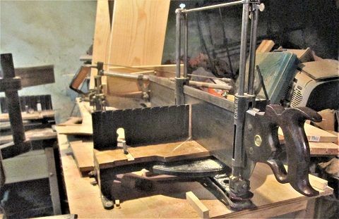

Yes, it was square..:TwoThumbsUp:. Made a lot of use out of the bandsaw, and the 3 Mitre Boxes...:BugEyeSmiley:
This when parts were too long, or the angle was hard to cut...:ChinScratch:
Cross cutting 90 degrees, and short piece mitres...will let this mess sit overnight...add the "collar" and hardware tomorrow....maybe see about hanging a few saws in the door?

Clamps came off today...and nothing moved. :Praise:

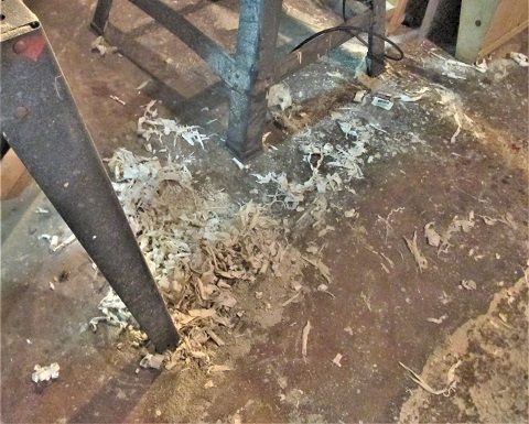

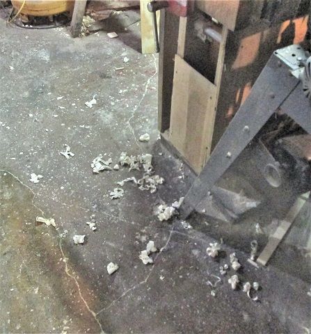

Follow the shavings,.....:SaluteandRun:

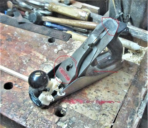

A Stanley No. 4c...actually, a No. 12-004, Made in England....just like the ones Paul Sellers uses.:TwoThumbsUp:

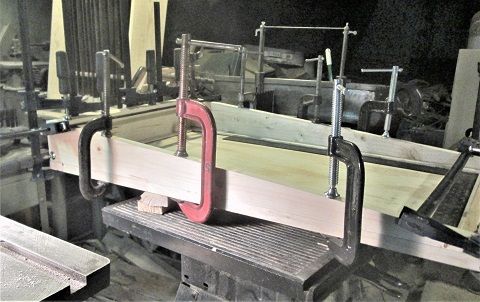

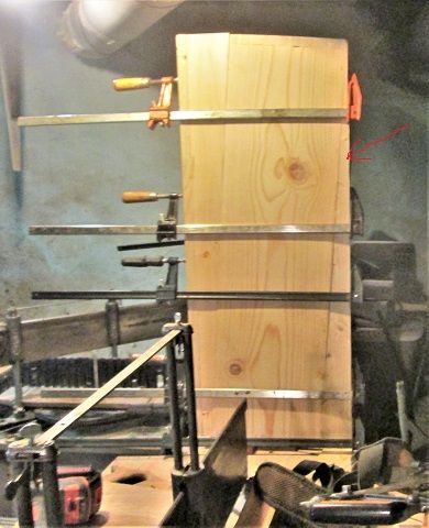

Then clamps and glue...hinge side..B)
C clamps seemed to work better
This is the bottom of the door.  Spring clamps were just the thing.  F style clamp to pull the sides to the bottom.
And the latch side.  4 small f clamps across the top. 2 more to pull the sides into place.  Let this sit a while....while I figure out how to hang 4 saws:WonderScratch:

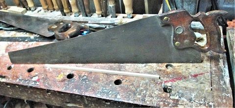

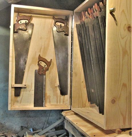

Like an Atkins 24" skew back, or...
Sheffield (Atkins) rip saw.   and..:ChinScratch:

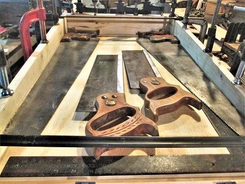

Something like this?  Without the square sitting there.  May add a pine strap across to fasten any hangers to...plywood is 5/16' thick, BTW.
May reinforce the corners with screws...and cover with plugs...maybe.:WonderScratch:

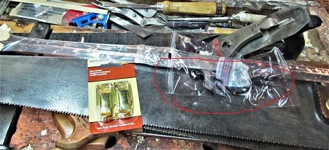

Hardware has arrived in the shop today..B)
Only needed one latch...may have another spot for the second one.   Black handle like on the Tool Cabinet, and a 30" Piano hinge...:TwoThumbsUp:

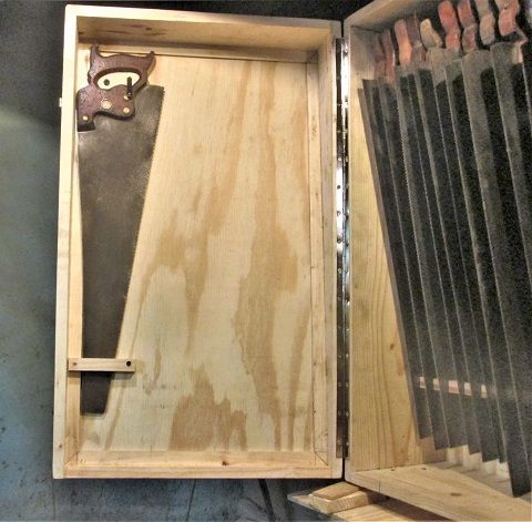

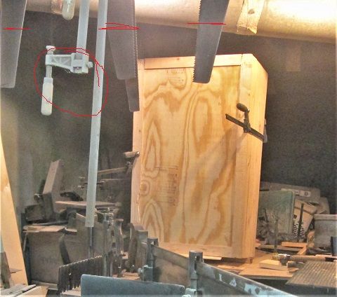

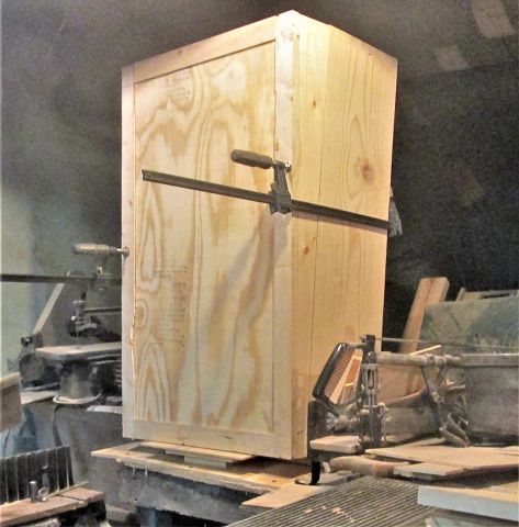

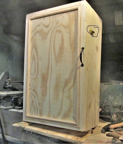

Test fit of the door on the case..:BangingHead:
Had a bit too much lean back with the case..:ArguingSmileys:..shimed the back of the case, until the door front was plumb..:TwoThumbsUp:
Shims out in front to hold the door up, until the clamps can hold the door in place...latch location ?:WonderScratch:
Door front needs sanded down, and trimmed out.  May attach the saw hangers to the door from the out side in.   Then hang the Frame Saw to the front of the door...

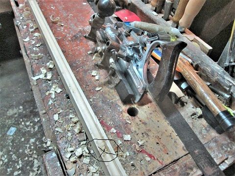

Hand planes were at work?

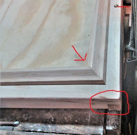

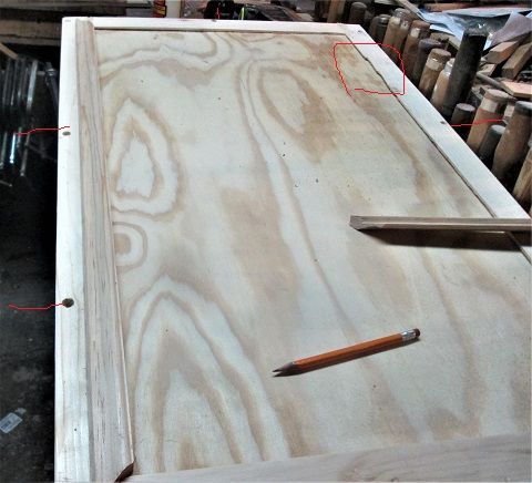

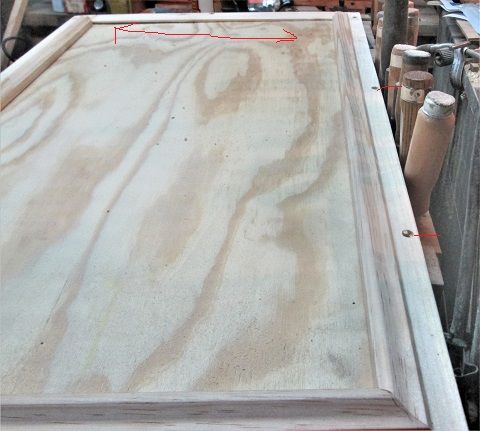

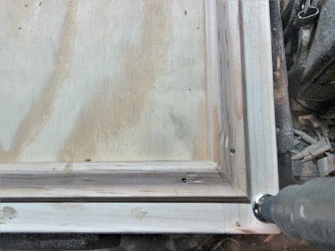

Counter bores, screws to reinforce the sides and the corners...big circle is where a blow-out from the #45 happened....hit a knot about 1/2 way into the groove's depth....
Edges were rounded over with a plane...all glue joints cleaned up with a plane...couple spots needed glue and sawdust filler.

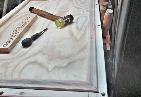

Glue and nails, and nail set...then try to make enough plugs for the counter bores...:ChinScratch:
Got all the holes plugged, trimmed flush, and everything sanded smoothB)

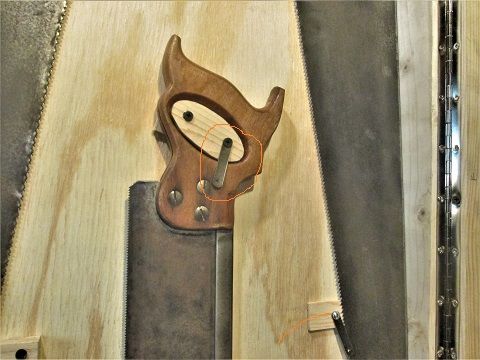

Trying to keep the screws from going through to the outside...grrrr.  Hard to hold everything in place long enough to drive the first screw...:ArguingSmileys:
Other two weren't much better to do....using a metal "Keeper":OldManSmiley:
Swing them down to "engage", and...:ChinScratch:
Swing them up out of the way to release a saw.
