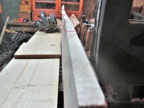

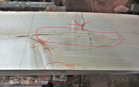

    Ok...hauled the other 1 x 10 to the shop....needed 2 pieces..a Top, and a Bottom....seems the board was doing the "Wave".. Hmm, not good... These were a part of the problem..

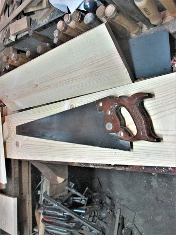

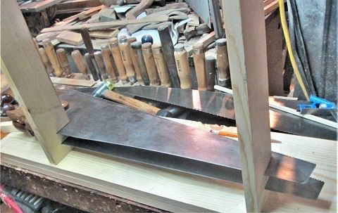

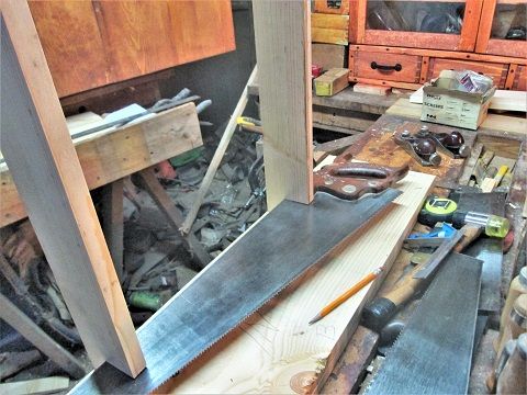

Part of doing any "Plan"....will be taking a saw, and laying it down on a board.    Mainly to see which way the saw with fit best....and NOT just tip back out....like the one I have right now...Need to cut a piece from the 1 x 10,  lay a saw on it....moosh it around until it looks right....then go from there.
Build a box-like cabinet around a stack of saws.   Whether to hang the saws by their handles ( slots in a 1 x 4?....spaced?)  or set the handles down onto a shaped 1 x 3...like I have now....with a slotted keeper up near the toes of the saws.
Door(s):   May do a single door....and add a plywood panel in a frame as the door.  Then the 3 short Panel saws will get a handle insert like in the door of the tool cabinet. ..and a keeper near their toes, to prevent them from rattling around.

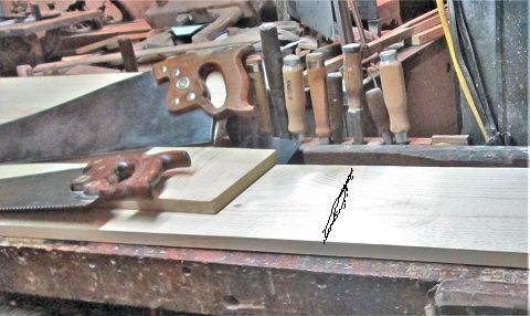

Not much got done, today..:DevilLaughing:..that Monday thing...I moved the one plank to the shop.:SaluteandRun:

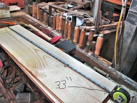

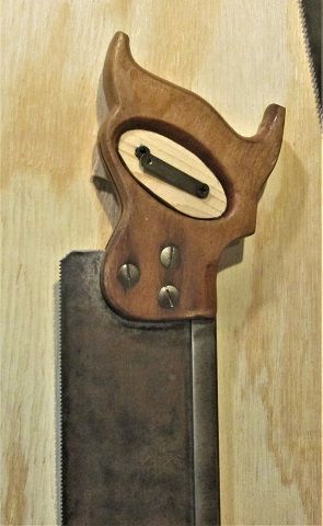

Line is about where a saw cut will be, as this plank will be both sides of the new til.   Those saws?:WonderScratch:

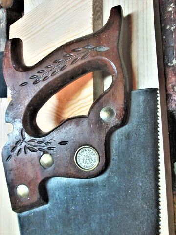

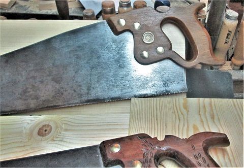

Atkins, Silver Steel, 8ppi crosscut, with the"Perfection" handle. :Praise:  Was about the longest length saw.  Was using it to lay out which way looked best, for hanging the saws in the til.
The "other saw"?:WonderScratch:
A Disston D-8 from about1945-49 era...11 ppi cross cut. :TwoThumbsUp:  Horns on the handles are slightly different between these two....will see how these hang by the handles, instead of standing on a dowel rod....:OldManSmiley:

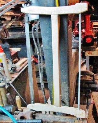

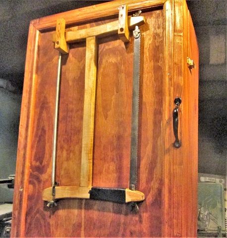

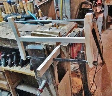

Maybe hang this saw up on the outside of the door, to let me know what's inside..B)
a Frame saw...sometimes called a bow saw...:WonderScratch:
More of a crosscut saw, for now.....may take it down to Piqua, OH, and have Chuck sharpen it up..:ChinScratch:
Stay tuned....:cowboy:

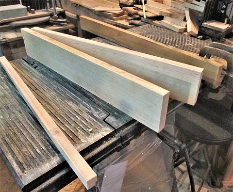

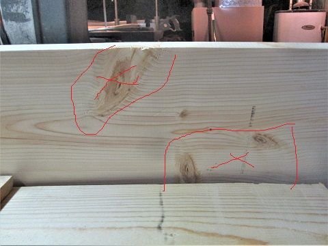

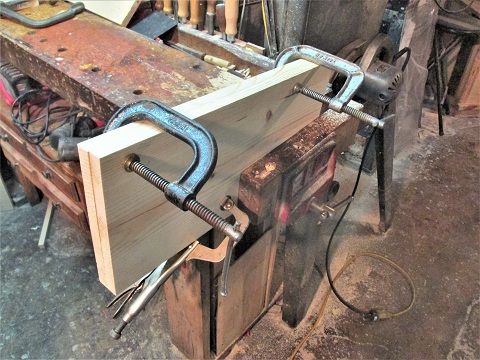

Ok...hauled the other 1 x 10 to the shop....needed 2 pieces..a Top, and a Bottom....seems the board was doing the "Wave"..:PullingHair:
Hmm, not good...:ArguingSmileys:
These were a part of the problem..:BangingHead:

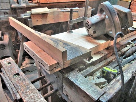

Try getting a square to line this up..:WonderScratch: This was soon on the way to the scrap pile.:ArguingSmileys:..then cut in the middle, and then on the far end..to get 2 pieces.
Then clamped these so they will STAY FLAT..:ArguingSmileys:.these two will be the top and bottom of the til...next..
Cut the other 1 x 10 into two blanks...33" long...end cuts weren't up to snuff, so..:MachineGun:
Two ends were matched up, then this end was trimmed so things match at both ends...B)

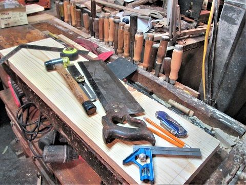

Thought about starting the dovetails....laid out the toys...maybe tomorrow, eh?:rolleyes:

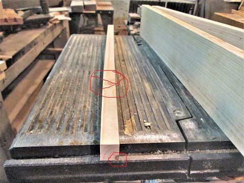

Skinny piece USED to be the middle of a 1 x 8 plank...decided to make the saw hangers...these two will do the "hanging":ChinScratch:
Why saw the middle out?:o
Thanks to a couple knots, this started bowing right on the saw.   Saw Hangers?:WonderScratch:

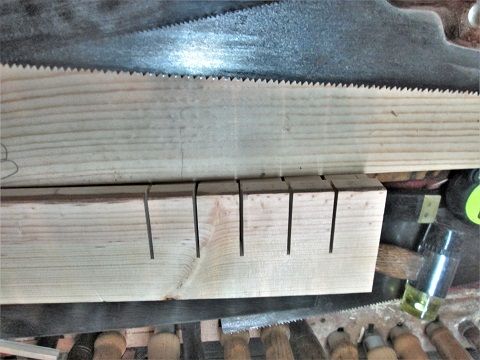

Will be hanging the saws by their handles...so, need a slot for each saw..:OldManSmiley:
Saw's blade was raised all the way up...then the two blanks ran through, so the slots will line up.  One done...:TwoThumbsUp:
Two done, was trying to leave a space between the handles....and...
5 spaces for saws done.   Non-slotted edge goes against the back of the case.   May run a few LONG screws in through the back.  :OldManSmiley:
