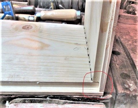

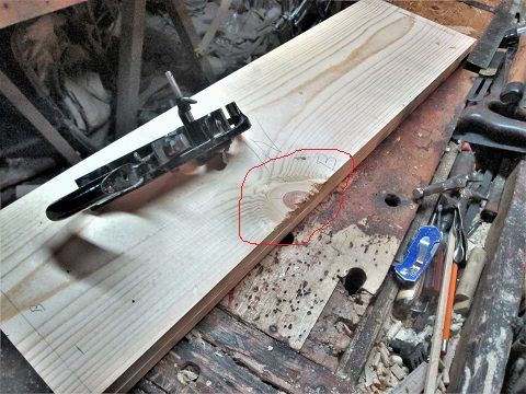

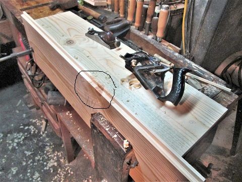

There it is...had to assemble it, then adjust it for a rebate I needed done....to house the plywood back of the case.
There was a problem..
Guess where the rebate needed to go....yep, right through that knot...
Sharp conquers all.  B) Then the second long side got it's matching  rebate ( was an easy one, too)

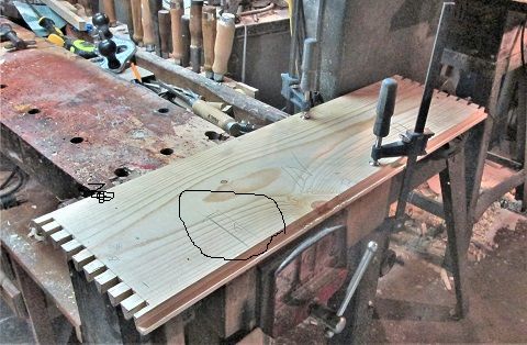

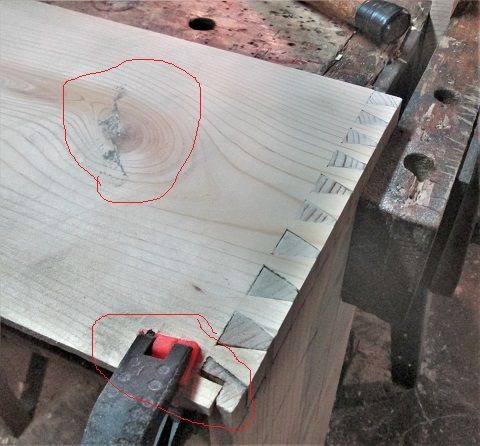

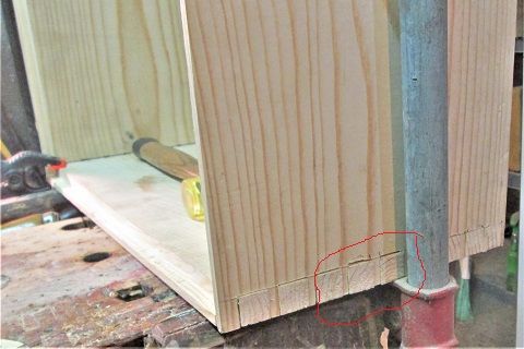

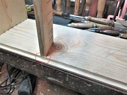

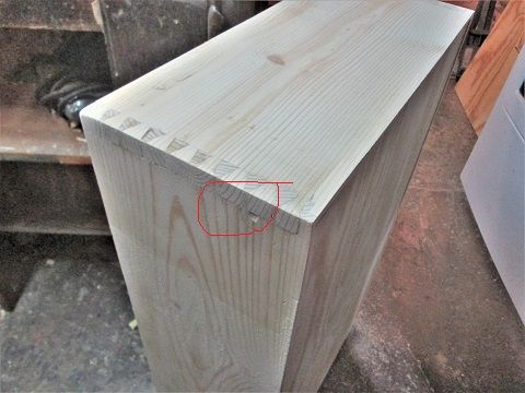

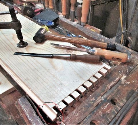

A skinny chisel helps out.   Problem is that circled corner.   I don't want that groove to show...so, when I laid out the tails..there was a special cut, going on
Right there.  This will cover the end of the groove.  Chisel to remove all the waste...dry fit?:ChinScratch:
What groove? B) Tail board is cupped a bit...so, when I do the glue ups, will clamp and caul right in the center of that bow.:MachineGun:   otherwise, corner fits.

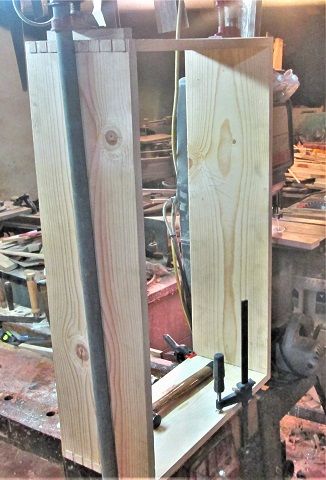

One corner dovetailed, 3 rebates done.:SaluteandRun:...Now, IF I can remember how I did all of this..:WonderScratch:..I might get another corner done...tomorrow....B)

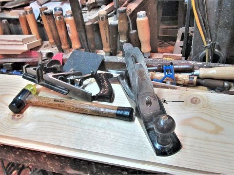

had to use that Millers Falls No. 11 as a small Jointer, as the side and the "bottom" panel didn't match up, width wise, imagine that. :WonderScratch:

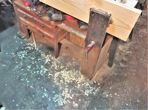

Floor was getting messy..:CoveringEyes:
Between the chips from the Wards 78, and the chunks from doing the dovetails....was getting hard on the feet.   Swept the shop, and closed up:SaluteandRun:

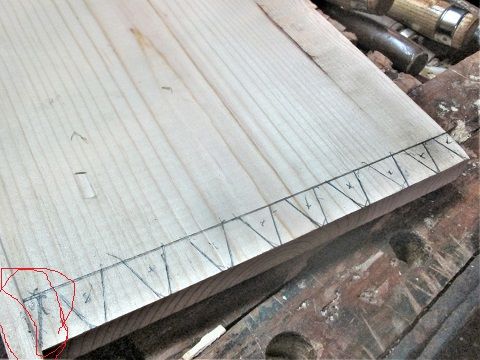

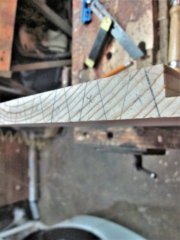

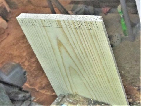

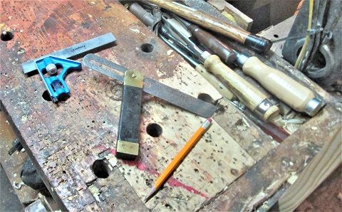

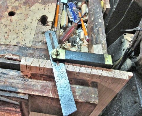

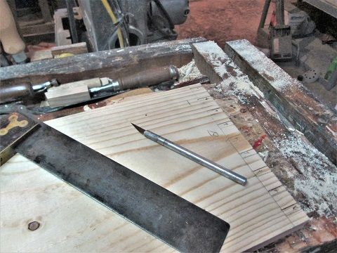

Tools to do a bit of layout with..and, since I do the pins first...:BugEyeSmiley:
laid them out ( maybe a little Dovetail 101?:OldManSmiley:)
Combo square to carry the lines down both faces...then lower the board down into the Dovetail CenterB)

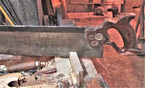

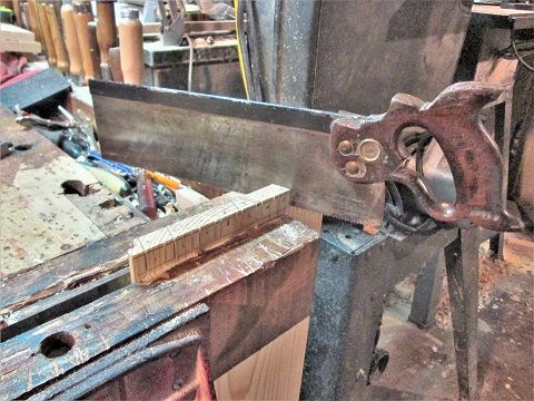

saw is a Disston No. 4...saw the lines..
Takes about 8 full length strokes to make each cut.....Then clamp the board on the bench..

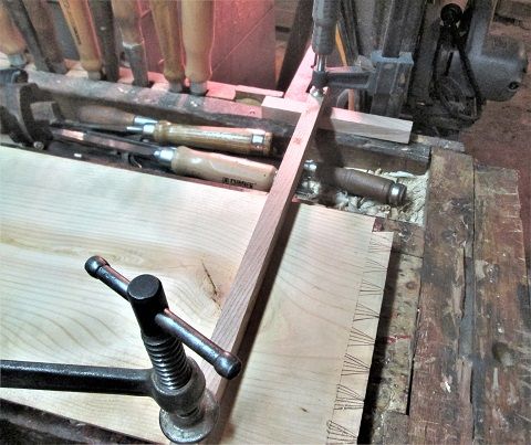

Used these two to make a Knife Wall baseline...something for the chisels to start at..:ChinScratch:

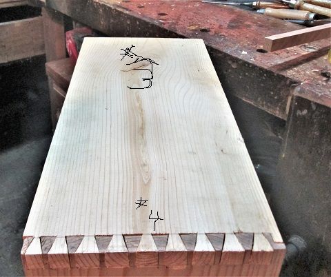

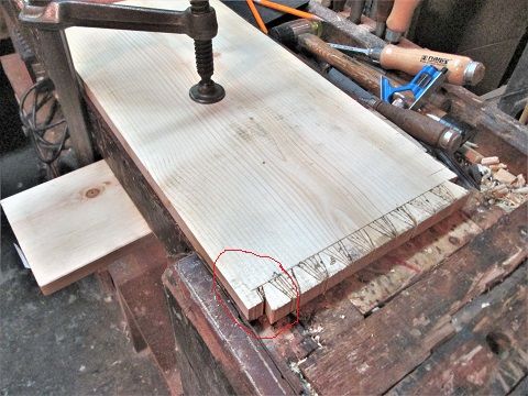

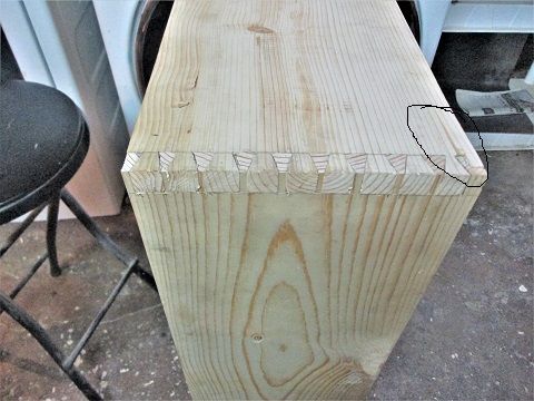

If I start on the outside face first ( the show side) I tend to get better results. :OldManSmiley: I leave that little tab out on the end, for support..as I then turn the board over..
And finish the chisel work from the inside face...less of a chance of a blow-out. :OldManSmiley: I then use these Pins to layout out the tails, and that special corner...

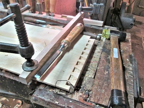

176686800_SawTilProjecttailslaidoutandcorner.JPG.9f3b4fcf1e9d96f75a8a3c03f1161fea.JPG

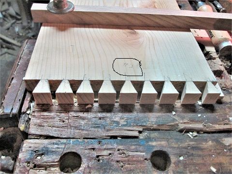

Where the red circle is.  Then over to the bandsaw to make a few cuts, trying to leave the lines...:OldManSmiley:
Then the chisels again.   Dry fit was...special...way too tight, had to pare a few spots, and fix a split...grrrr..:ArguingSmileys:
Trimmed the special corner a bit, for a better fit..:TwoThumbsUp:

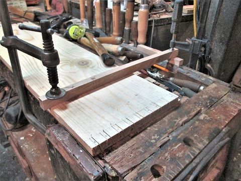

Then worked on the next corner...decided to work on corner #4...will do #3 tomorrow..repeat all the above steps, except tail board/Top needed a rebate, before I could lay out the tails..so, Wards 78 came back out...B)

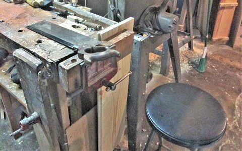

Figures, had to run the 78 against the grain..:DevilLaughing:..had to also use a way to clamp the board to the bench..FLAT...:MachineGun:
Kind of hard, when trying to chop out the waste, when the board wants to bounce around.:ArguingSmileys:..was finally able to dry fit corner #4...:TwoThumbsUp:
No splits!  Which leave corner number 3 for tomorrow..  wanted both a top and a bottom fitted to one side...and at least one top or bottom fitted to both sides..

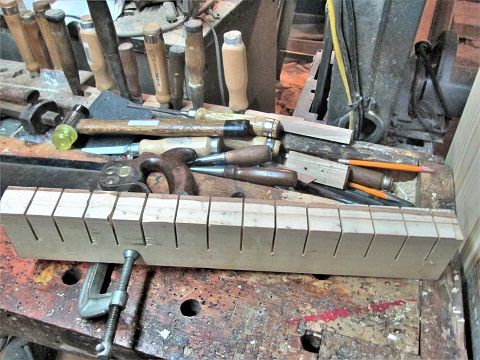

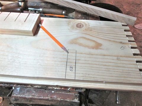

To measure for the length of the saw holders...needed the distance between the rebates.  then used a saw to locate where the top holder was going....:ph34r:
Good thing I wanted to angle the holder a bit....to better hold the saws in place..angled towards the top, so I needed to find out how much clearance I needed for the horns of the saw handles...the other holder was easier...maybe 5" up from the toe of the saw...didn't need to angle it..:ChinScratch:
1206618201_SawTilProjectdadolayoutbottomholder.JPG.95547611931213e5d72a36f9955358a0.JPG
Will need to bevel the top one a bit...:ChinScratch:

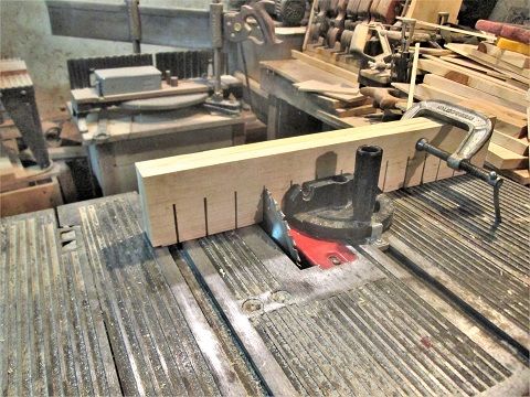

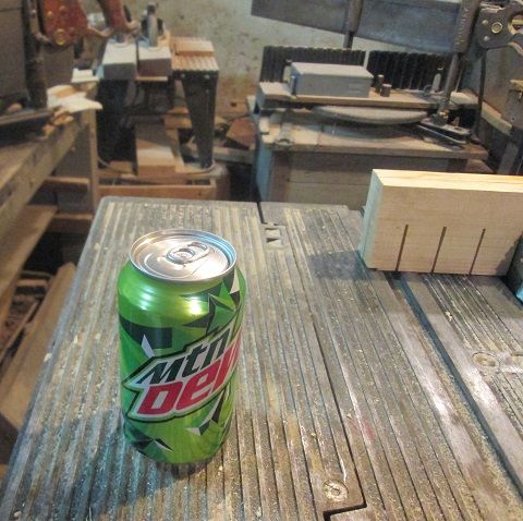

Ganged up the two saw holders, and cut the rest of the slots..:TwoThumbsUp:

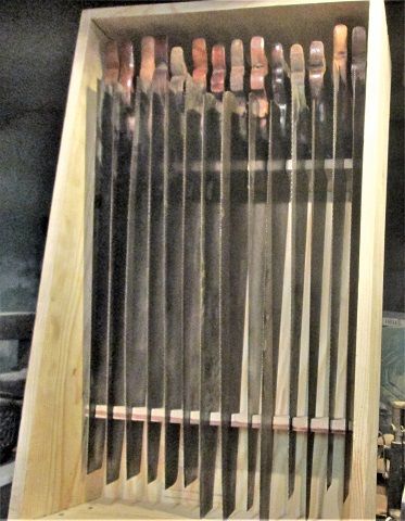

Looks like the til will hold 14 full sized saws....might be enough.  :rolleyes:  We then used that tablesaw to cut the parts for craig's project.   little silver chips everywhere.:BangingHead:

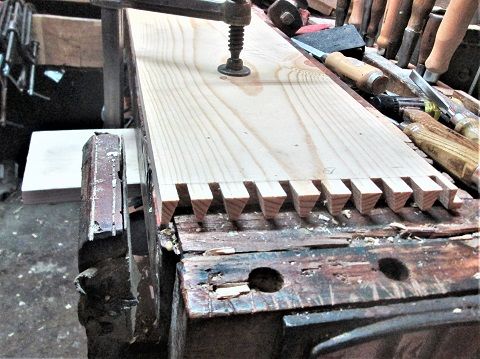

Pins were done, tails were next..:ChinScratch:
Used the pins to lay out these..bandsaw made the cuts...then..

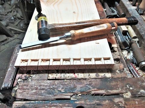

Chopped half way down, on the outside face...trying to get that corner just right..:rolleyes:
Then flip over, and finish the chopping up..:TwoThumbsUp:

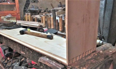

Looks good? :WonderScratch: Well tried a dry fit...had to pare a few places that were way too tight...was finally getting things to fit...:ArguingSmileys:
ah-yep...:BangingHead:.Snapped it right off...had pared the wrong spots.:ArguingSmileys:..so, glue and a clamp, til morning.  Also filled a huge crack in that knot...take a guess where that silver colour came from...:DevilLaughing:
Decided to at least get all four corners together for a big dry fit....:ph34r:
This is the side the door will be on.  Dry run of a couple clamps..B)
Checking how well some of the gaps will close up, during  a glue up...:WonderScratch:
Have a few places that could be better...will clean them up, while digging the dados out.  :ChinScratch:
And that was that, for today.  2.5 hours IN the shop.  not too bad for a Sunday.  NOW I can switch over to the Guinness..:TwoThumbsUp:.while a Bug Bomb goes to work in the shop...may need a few more "bombs"  to get rid of the pests. :MachineGun:  Time to kick back and just sit for the night.   :GoodNight:

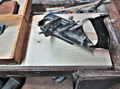

Needed one more clamp....to cure that "bounce" thingy..:BangingHead:..Dados were laid out...:TwoThumbsUp:

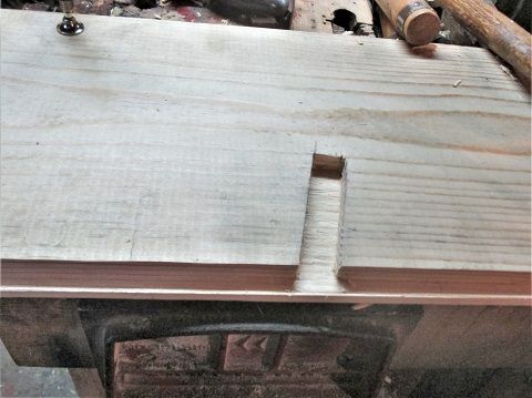

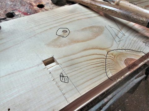

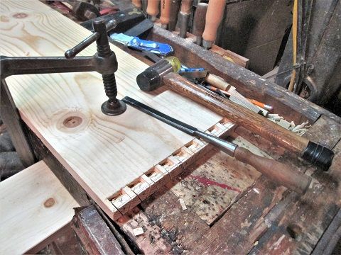

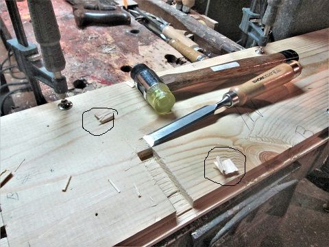

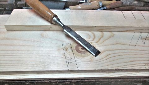

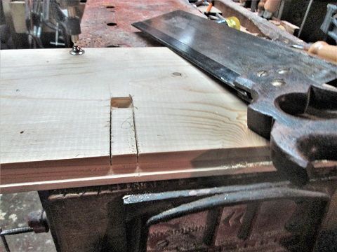

Like that knot? :ArguingSmileys: Cut a pair of knife walls along the sides of the dado.   18mm chisel to dig a square hole...:ph34r:
square hole is for the toe of the saw...sawed the walls of the dado....:ChinScratch:
Chisel and mallet to pop 90% of the waste out...:MachineGun:

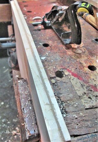

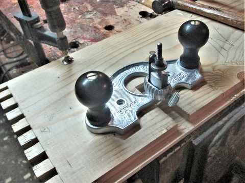

installed the 1/2" wide cutter in the Stanley 71-1/2....set the depth to match the rebate....and plowed the floor of the dado level and smooth...B)
Wash, rinse, and repeat 3 times..until you get here, the last of the 4 dados.  :TwoThumbsUp:

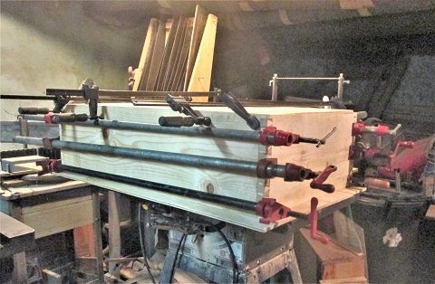

Check for fit....more thinking..:CoveringEyes:  Out came the glue and the clamps.  First off, where to do the glue up  at.....:WonderScratch: Maybe IF I turn the tablesaw around a bit, so my fat body can get by...then lay some spares of plywood on top of the tablesaw....hmmm...
Mallet to "adjust" a couple spots...set the 4 sides up on the "platform"   and started to install the holders....something wasn't quite right :BangingHead: ah...had them in the wrong dados...had to remember which way was "UP":CoveringEyes: 0300..give me  break...Forest of clamps showed up...
:SaluteandRun:
I merely laid the back in there....not attached, YET...after this picture was taken...2 more clamps appeared...can never have too many, right :OldManSmiley:
It was now about 0400hrs...time to close for the morning....letting this mess sit a while.   That big "Rising Sun" knot on the one side..had bowed the side in :PullingHair: So, I'll have to figure a way to "un-bow" it, in order to install the back...:BangingHead:

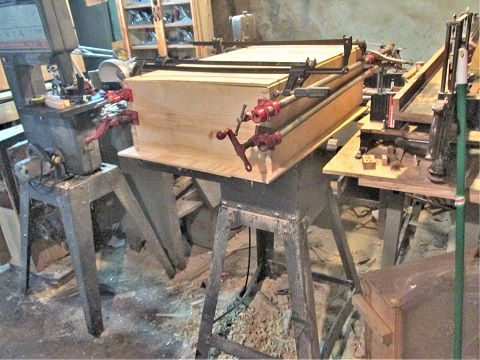

Roh-Kay, Raggy...started at 1430...ending at 1530...:GoodNight:
The Forest of clamps..
Removed these...no creaks, cracks or pops to be heard...at least from the case...:OldManSmiley:

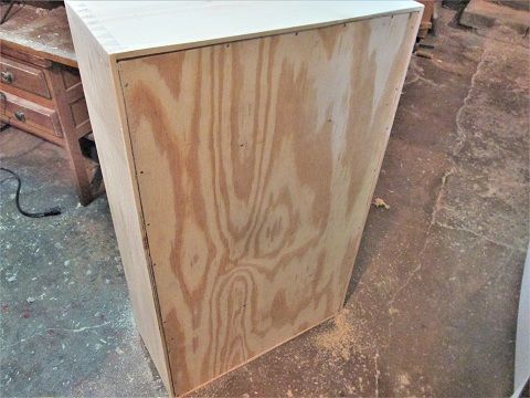

Out of the clamps,,,lay it down, bead of glue all around ..:TwoThumbsUp:

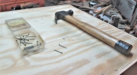

Hammer assist to get the panel in place, then nailed off..:ChinScratch:
Weird pattern, almost like an angry face?:DevilLaughing:

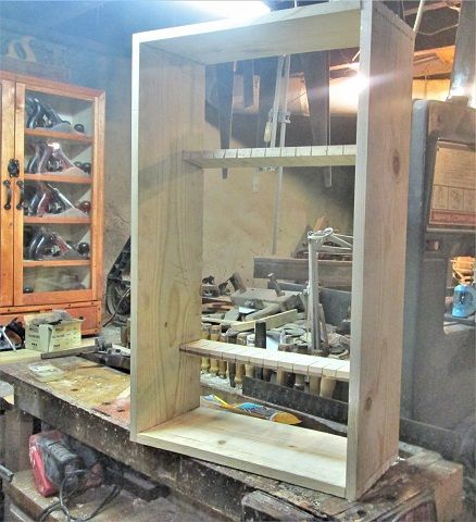

Cleaned all the corners up..:TwoThumbsUp:

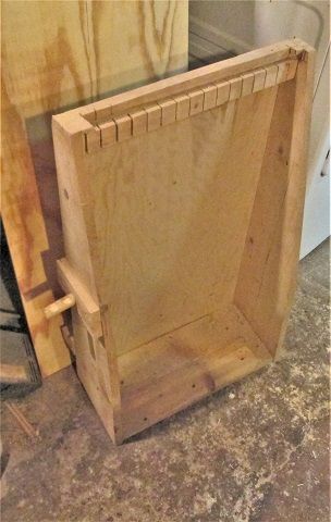

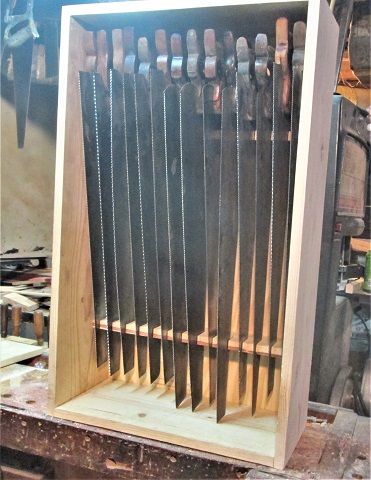

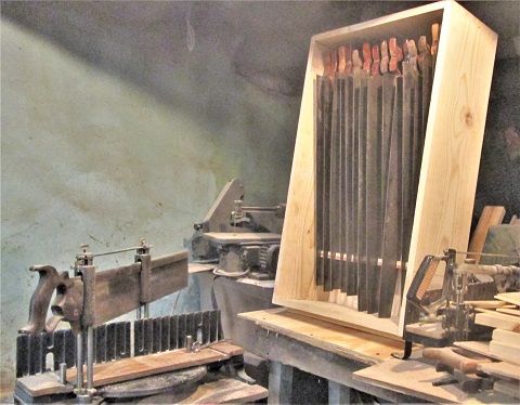

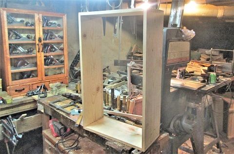

Test fitted the saws....Old Saw till was moved out..:OldManSmiley:

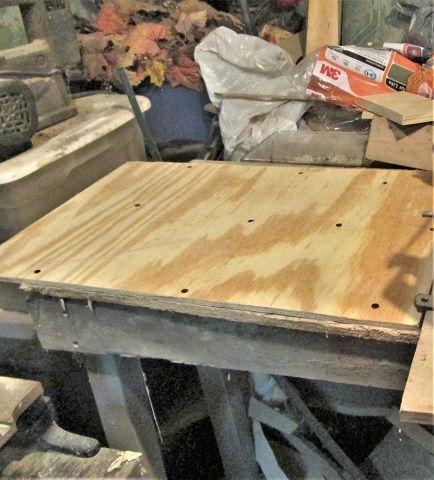

New plywood base laid down..( looks better than the old osb:BangingHead:)
Had to clear everything out of the way, including the tablesaw, and sweep the floor where it was sitting...:BugEyeSmiley:I added a 1x1 bar under the new til
Yes, I carried this thing over to it's new home, and fastened it down TIGHT.  :TwoThumbsUp:  waiting on me to make the door...that mitre box?

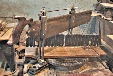

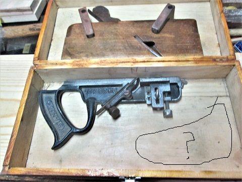

Stanley No.  346 Mitre Box and saw 4" x 26"  one of my "spares":JawDrop:
So...just waiting on the door to get made, and installed....:Tapping:
