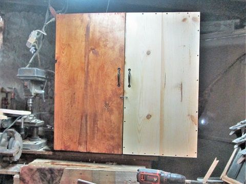

    Soooo....how about the $0.05 Tour? You have already seen it with the doors closed up... so.. Schving the right hand door until that door prop engages.. keeps the door from
  • Larry Buskirk
    Larry Buskirk
    Have to love the quality of those Maynards boards!  Pick through the pile, find straightest boards, load into car, ten minutes later unload same boards that now look like they've been formed to m

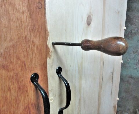

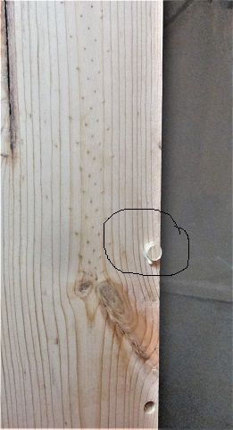

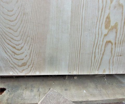

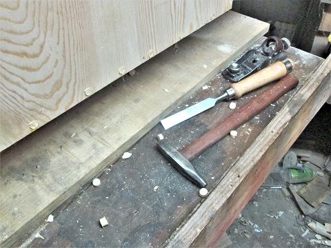

Plugs were trimmed flush, tonight...Tools needed?
A chisel wide enough to span the plugs, used bevel down.  A light hammer to tap the chisel, instead of my hand.  And a block plane to finish things up
A little handsanding,too.   Mixed a batch of my Famous Witch's Brew....not sure what all is in that quart can...but..
Brush it on,then wipe it down after a bit.   Door #2 will get it's turn...after I finish making 11 plugs...

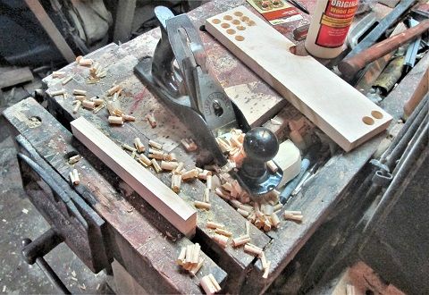

Was able to install 14 plugs, then the plug cutter started to fight...tore up two plugs...kepy trying to pull the wood and my hand towards the spinning cutter...let it sit a day, to cool off.
Door was adjusted to close a bit better...ran a handsaw in the gap at the top..seemed there was a little extra to remove....took it off from both sides at once...and watch the doors close.   IF I can make enough plugs tomorrow, I can get the doors done.   Might even slip out of the house, and buy a decent latch ?
stay tuned....

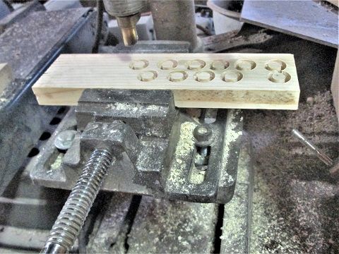

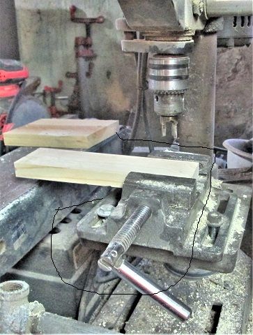

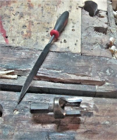

Ok..in order to mill 11 more plugs...I needed to 1) sharpen the cutter, 2) plane a board to fit the vise on the drill press..
1)
Mostly  a lot of carbon build-up...
2)
Board with the holes was too wide...planed off a bit of excess Pine..
So the drill press vise could hold onto the board....
Mill a plug, move the board a bit, mill another.  leave enough of a "wall" for the screwdriver to press against, when I pop the plugs out.

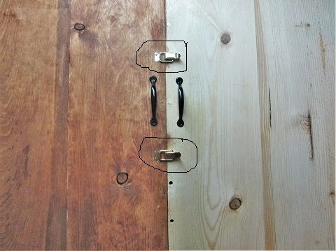

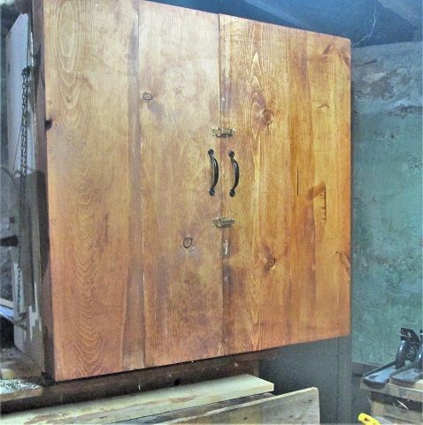

then install the latches..needed a screw starter..
Irwin made a nice one.   hardest part was getting the latches to pull things tight..
Hmm..guess I installed the latches first..oh well....

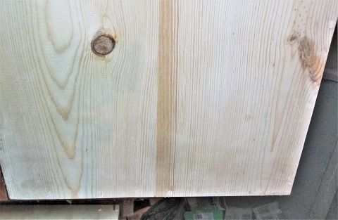

Door was sanded a bit, then the Witch's Brew was brushed on, and then wiped down..

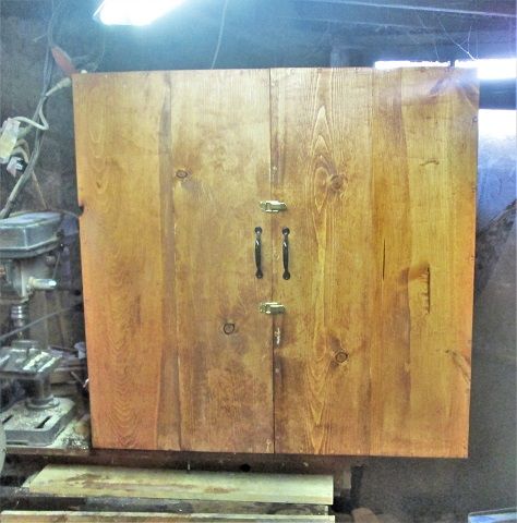

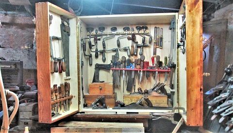

And now, for the Five Cent Tour?

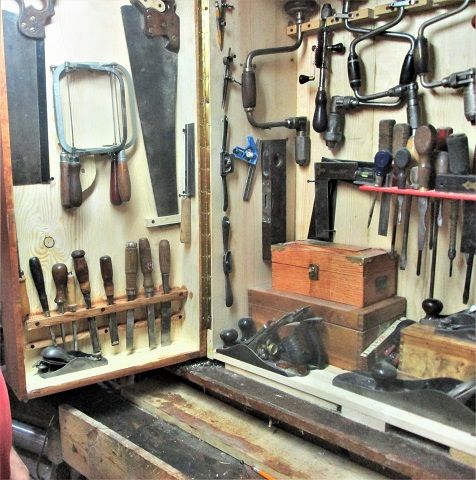

Open the doors, first..
Visegrips are for a glue-up going on..
41745816_TheFiveCentTourhammertilkeeperstrip.JPG.5623eb88fe17b0e26aeb642d7fd33da1.JPG

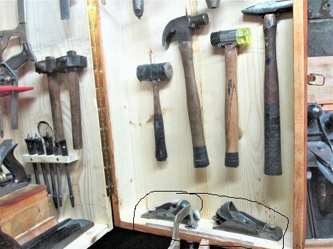

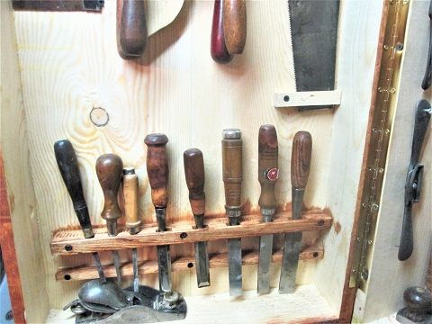

So these two planes do not go sliding off...I added a couple more keepers to the brace till...
Took apart an old brass hinge to make 2 keepers.. chisel rack also got a bit of finish.
did not feel like doing the insides of the case...and having that smell linger in there for a few months...Brew is 50% BLO..and STINKS....
Be sure to close the doors when done..
Insides are still a Work-in-Progress....trying to arrange things so they will be easy to find...
Getting a bit crowded in here..

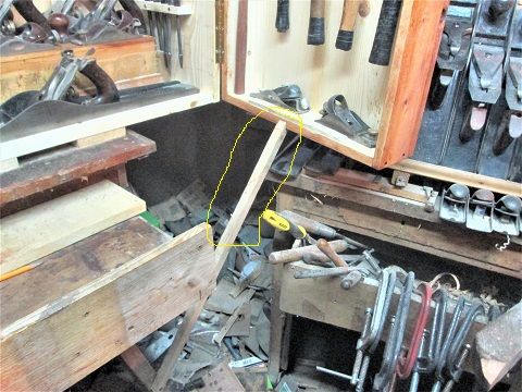

Schving the right hand door until that door prop engages..:TwoThumbsUp:
keeps the door from closing up on me, while I am looking around inside...the Left door?

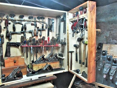

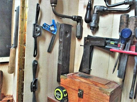

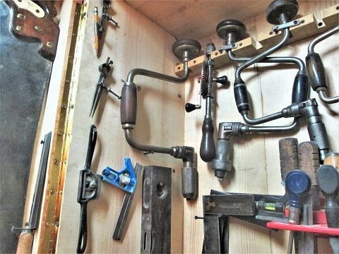

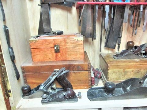

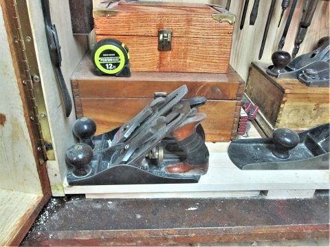

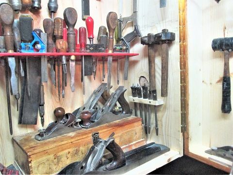

so..Lets start here at the bottom left corner?
A pair of Stanley No. 4s.  The cases for the Stanley #45 and the Stanley #71-1/2..next ^

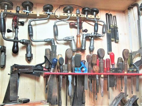

Then on up to the top..
Then turn to the right a bit..

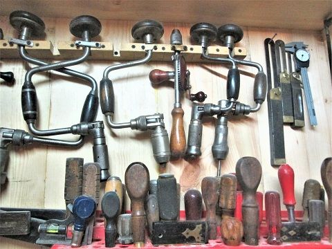

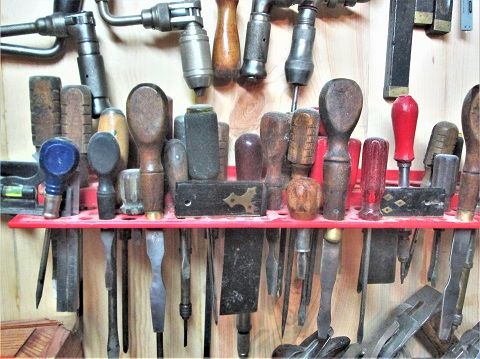

As for that Rogue's Gallery below all those drills...
Hmm, see anybody you know?   Below the Gallery..
Just a few planes...more of them Block planes?  They are just like Mice...on to the upper right corner..
Kind of crowded..as for that door..
More block planes?  Some Hammers. and the rest of the Egg beater drills.
Then just dis-engage the door prop..and close things up....
Hope you enjoyed the show.
