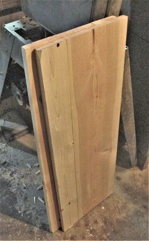

steven newman Posted March 22, 2020 Author Report Posted March 22, 2020 2 pine boards....1 x 4" x 4' have a slight problem.. They are laying on top of each other.....and the top board is even worse... Compound curves? May just take these two back to Menard's....either a refund, or two replacements....IF they have any good ones in stock... Heading to the shop in a bit....clamps are due to come off....I might want to stand there and catch them... FlGatorwood, Cal, Artie and 4 others 5 2 Quote
Larry Buskirk Posted March 22, 2020 Report Posted March 22, 2020 @steven newman, I've got 8' 2 x 4's there that by the time I got back home were twisted 180° from one end to the other. They were the straightest ones I found in the pile when I sorted through them. HARO50, Artie, Cal and 1 other 1 3 Quote
Popular Post Gunny Posted March 22, 2020 Popular Post Report Posted March 22, 2020 1 minute ago, Larry Buskirk said: @steven newman, I've got 8' 2 x 4's there that by the time I got back home were twisted 180° from one end to the other. They were the straightest ones I found in the pile when I sorted through them. 1 hour ago, steven newman said: .IF they have any good ones in stock.. Good luck!! Cal, p_toad, Larry Buskirk and 3 others 6 Quote
Popular Post steven newman Posted March 22, 2020 Author Popular Post Report Posted March 22, 2020 Well..those two curving boards cost me the same as a 20 oz cold bottle Mountain Dew.... Gene Howe, Artie, Larry Buskirk and 5 others 2 6 Quote
Popular Post Gene Howe Posted March 22, 2020 Popular Post Report Posted March 22, 2020 Shoulda bought the Dew. In my experience, warped boards just ger warpier.. Gunny, Gerald, Cal and 5 others 2 1 5 Quote

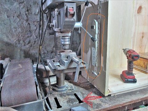

Popular Post steven newman Posted March 24, 2020 Author Popular Post Report Posted March 24, 2020 Lots of cussing going on, in the shop this evening.. but.. 2 planks out of the clamps... Decided to just go ahead and assembly this thing...needed a foot added to the back panel... So the back panel won't fall over....had to turn things around...as I needed to work from the "outside" of the case.. This is the bottom panel getting installed...gotta start somewhere...A little glue, and a clamp...predrill a few holes, add 2" long screws...remove clamp...flip this thing over, onto the bottom...and install the top.....then over onto it's side...Needed 3 hands, only had 2.. And install a side panel....in two steps.... narrow strip first, this time...glued and screwed to the back and the ends...bead of glue, move the clamps. And the sides are now installed....need to get this up off my floor...first I need to clear a mess out of the way... I need this spot cleaned off....add two foot pads.. Screw these two items down....this way, cabinet sits up off the tabletop so the doors will swing open...then the real fun began.... And a few 3" screws to make sure it stay put...Had to move the drill press a few inches to the left... hang the chain for the chuck key..and hang the powerstrip...DP handles were right up against the side of the cabinet....now there is a bit of clearance... Might spend tomorrow making hangers for this mess... Then work on the doors....I saved up all the scraps, and cutoffs....to make the hangers with... I am plumb worn out....try again tomorrow.... Stay tuned Cal, FlGatorwood, p_toad and 5 others 8 Quote
