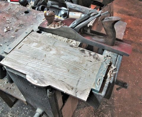

Long and short sides....Then this thing came out of the clamps the other day..needing flattened down
Ends trimmed for square, and for length...width?  We have ways...
Back edge had a knot, buzzed that off, and then made a lift/handle...To get the thicker sections down to the thinner areas...resaw as much as I could...then the planes, again..
Going across the grain, doing the scrub plane thing....then more sanding...test fit?
Almost done, just one little spot to flatten down....lid is 3/8" thick....might be rough to find a pair of hinges.....
