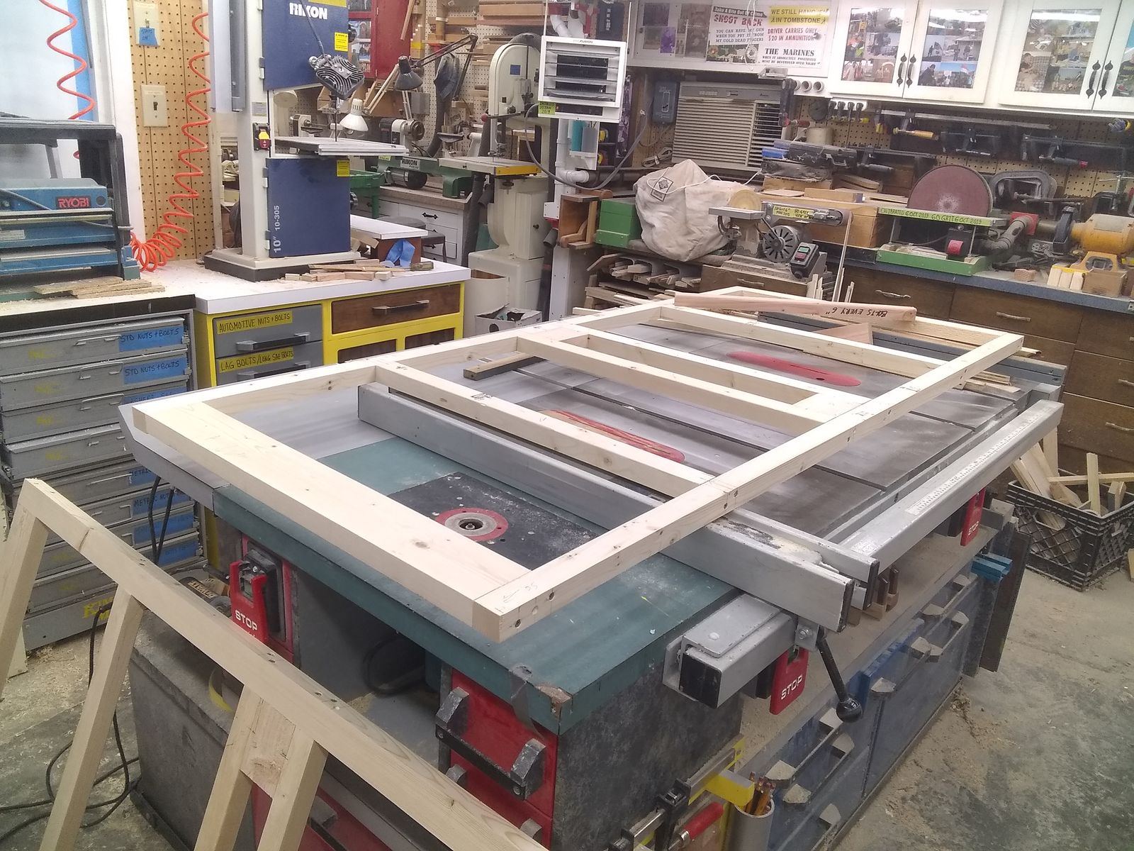

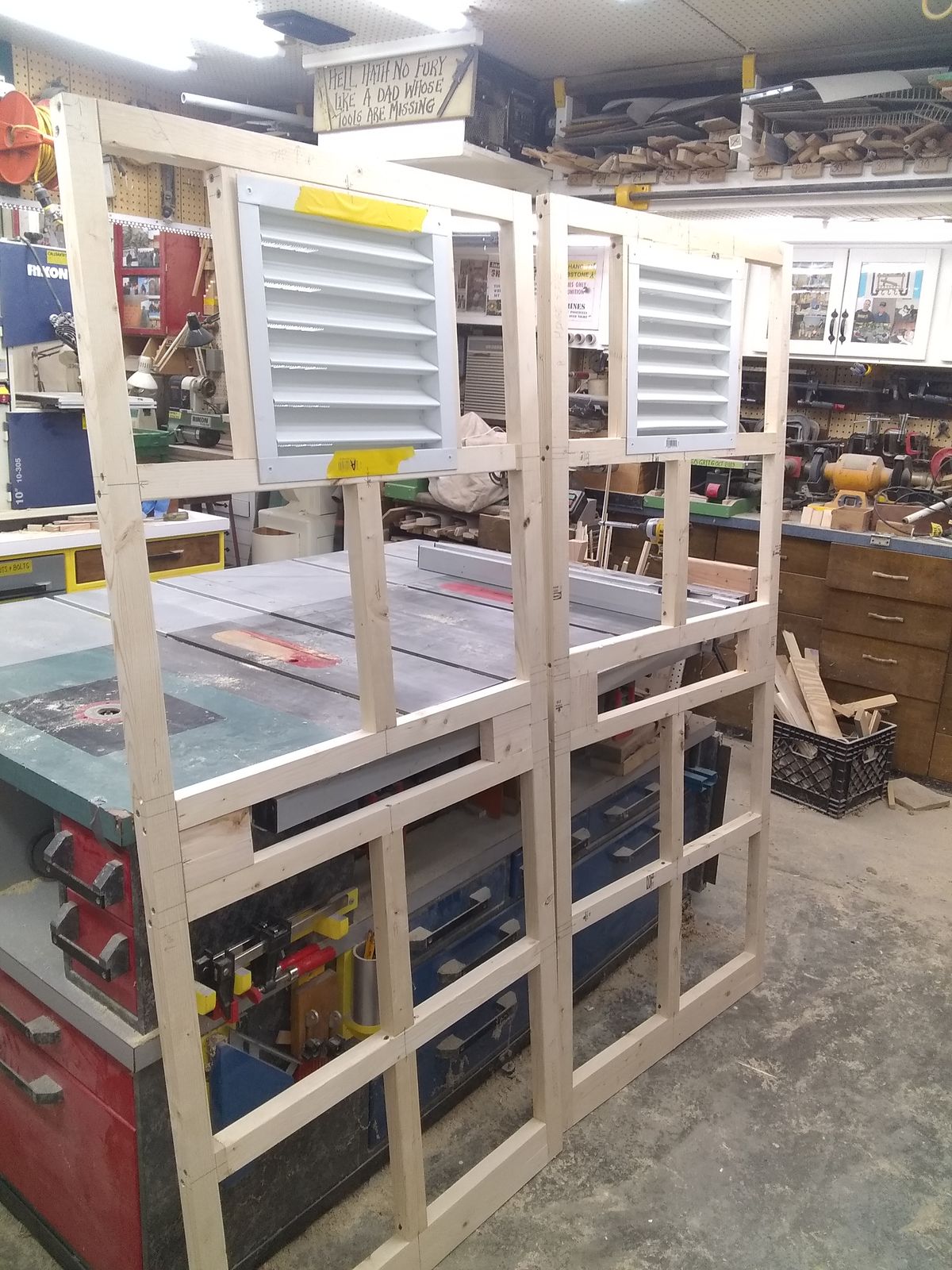

It starts with a good square frame with braces for the doorknob.  I made the center brace with knob supports for both sides because it was easier to make the brace then insert into the frame.  Plus If I screw up I have a 2nd chance.  :lol:  The vents are roof vents, they were the size I wanted and made installation easy.  I had considered making my own but when I saw these thought, why???  $7 each.  So I splurged.
1628773362_Doorframebegin.jpg.bcb92d55b5ae9efd7e95741b11067aee.jpg  834284050_Doorsframedone.jpg.445b4ec2b36525d8921a78fa0f3bb127.jpg

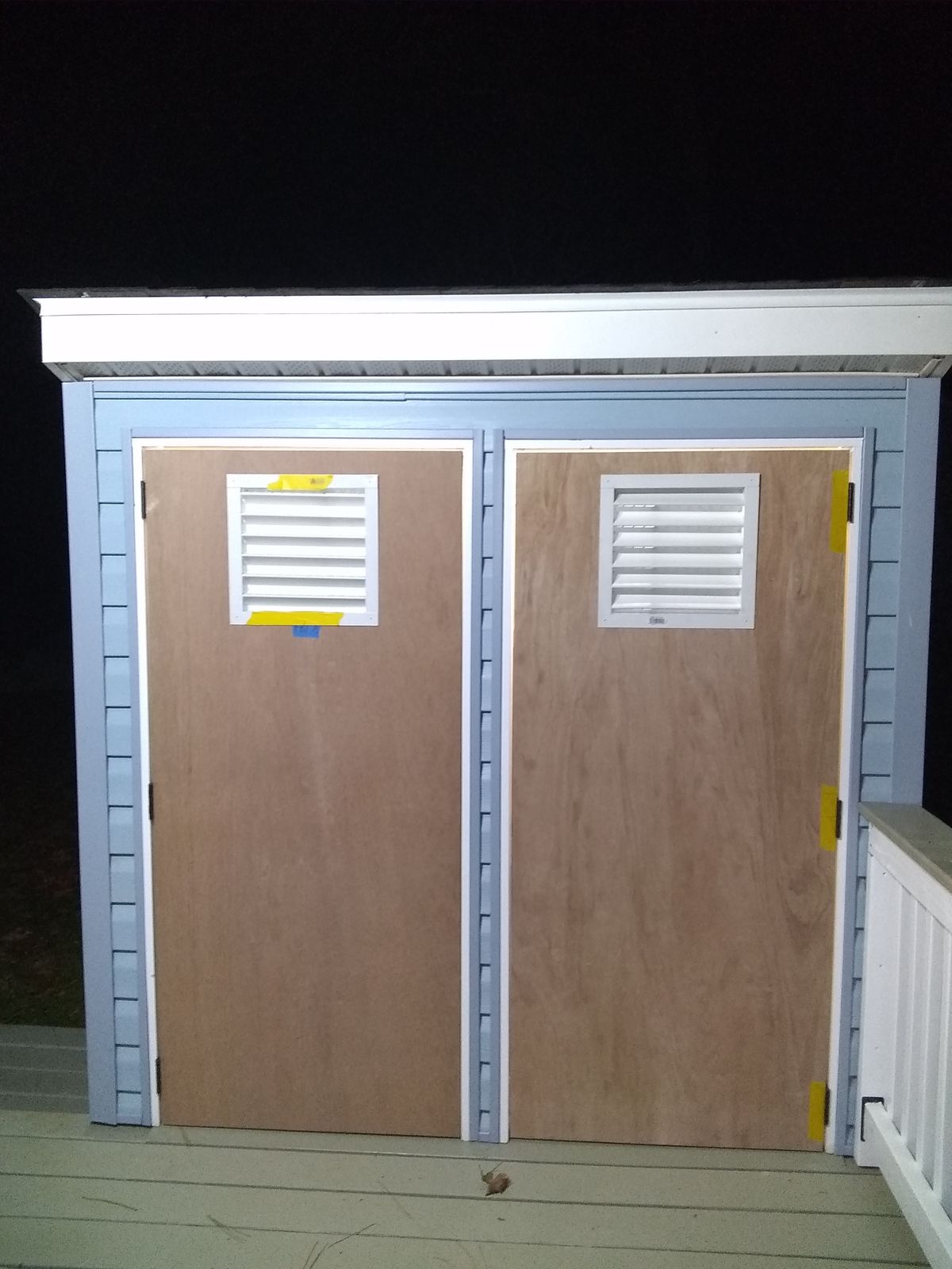

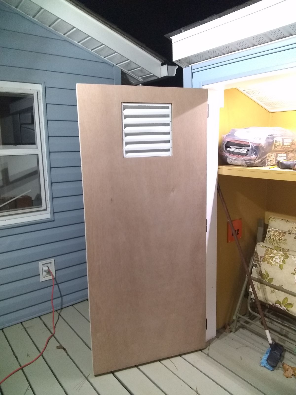

Dry fit after skins glued on.
1623576170_Doorsdryfit(1).jpg.5bd4c40d6c42722c8a7c27f31f4cfb81.jpg  1031598166_Doorsdryfit(2).jpg.a92cf65cf985239733fb41273d5b0145.jpg
