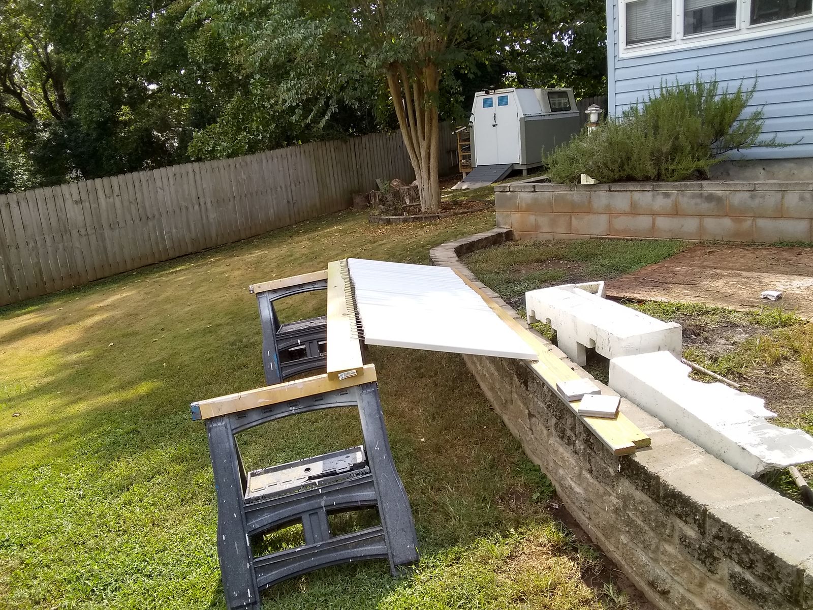

Well I speeded up production by making this rack to hang the stiles on so all 4 sides get a coat of paint at one time.  Now we wait for 2nd coat to dry.
Then back to shop to drill all the holes with my jig.

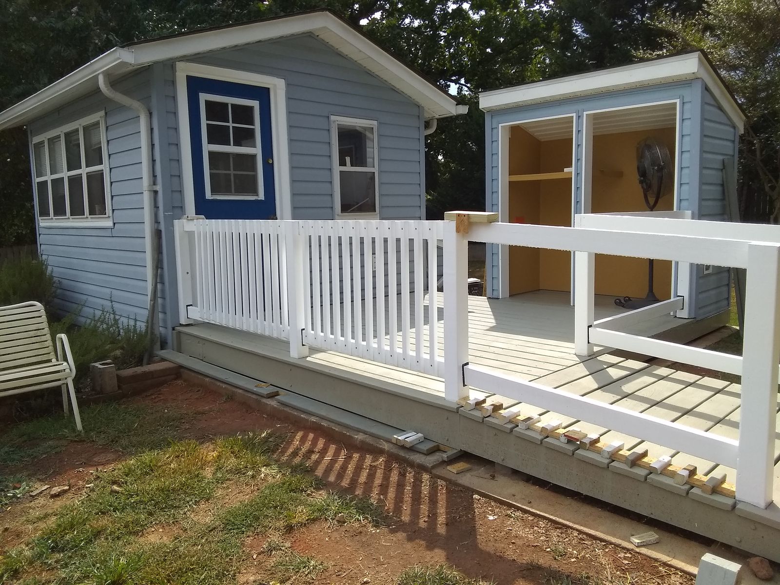

These 16 were hanging in shop all night and ready to install.  Rain stopped to I got out in the nice sauna and put them up.  Staring to look like the old deck again.  Finally the piled up pieces from previous deck has all been used.  Had 4 extra stiles left, the rest were warped or broken.  I am starting to see the finish line on this project.

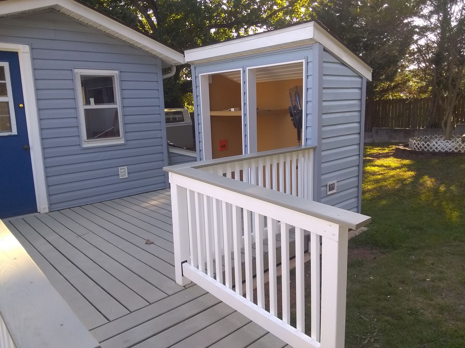

I have the strange idea of putting a top plate of 1" X 3" just so you don't get something caught in the stiles.  Just thinking aloud here.  :)
I am with you on that.  Previous deck rail had a 5/4 x6 board on top.  Going to do the same thing again here.  Have to get them this weekend and start prepping them for install.  Have yet to decide on paint color.  We had white last time, was a pain to keep looking clean.  I can use the deck grey color, or take the blue from the door to the building and use that.  Both would be a lot better than white.  I know some use a 2x4 but I like to set my cup down and know it will stay and not fall off easily.  Plus it covers any imperfection in the lines of the rails.  A nice cheat...:D
And, the cap offers some protection for the ends of the balusters.
A question, what is the black area around the lower rail at each up right?

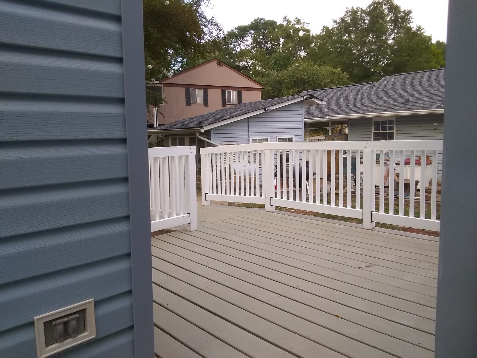

To attached the lower rails I used some metal end caps that came black.  I used a 3 inch #10 SS screw to attach the plate to the 2x4 then a 1 5/8 #10 SS screw to attached the plate to the 4x4.  The upper 2x4's I mortised in for strength.  Lower ones code allows this so I used them.

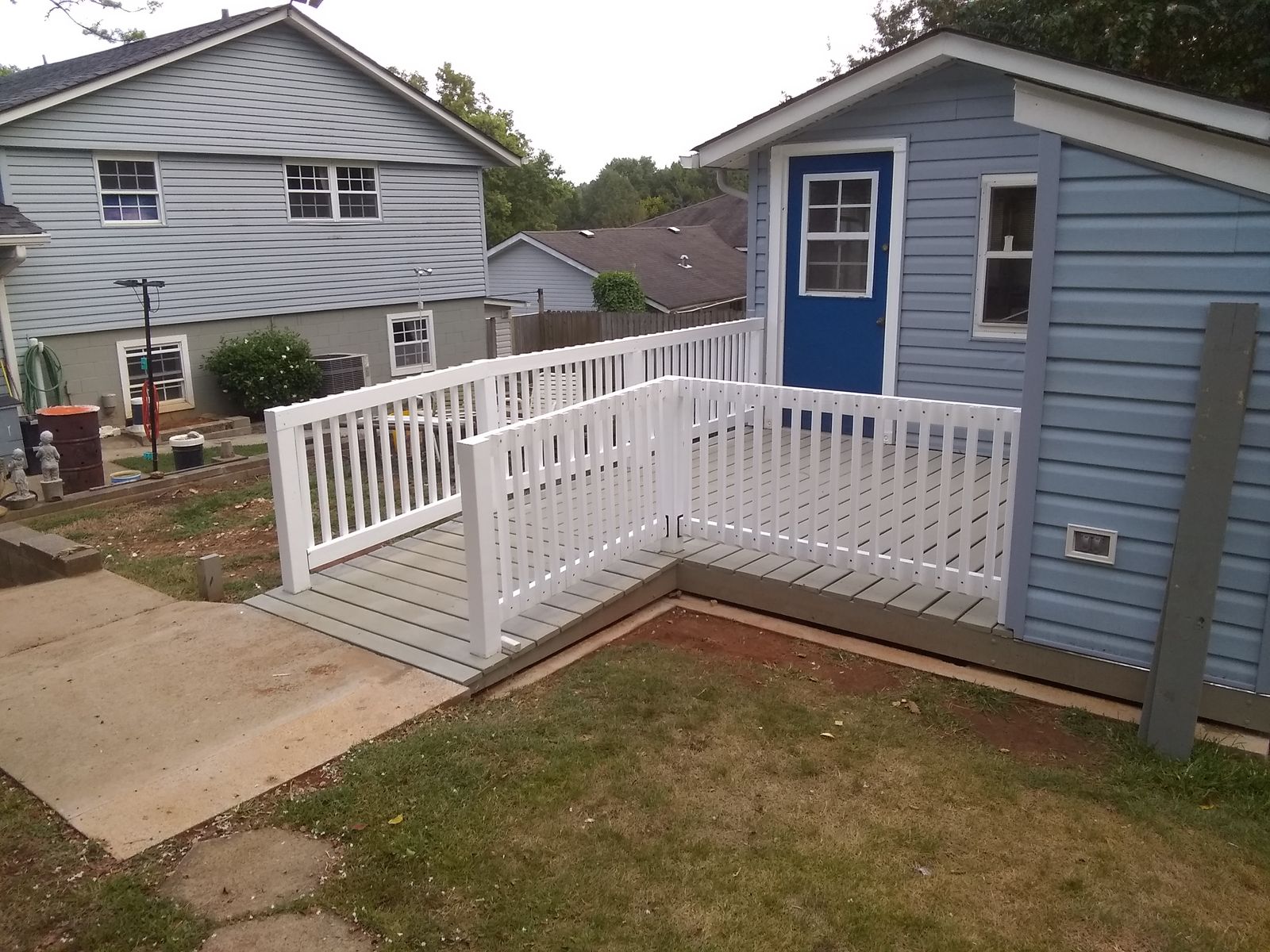

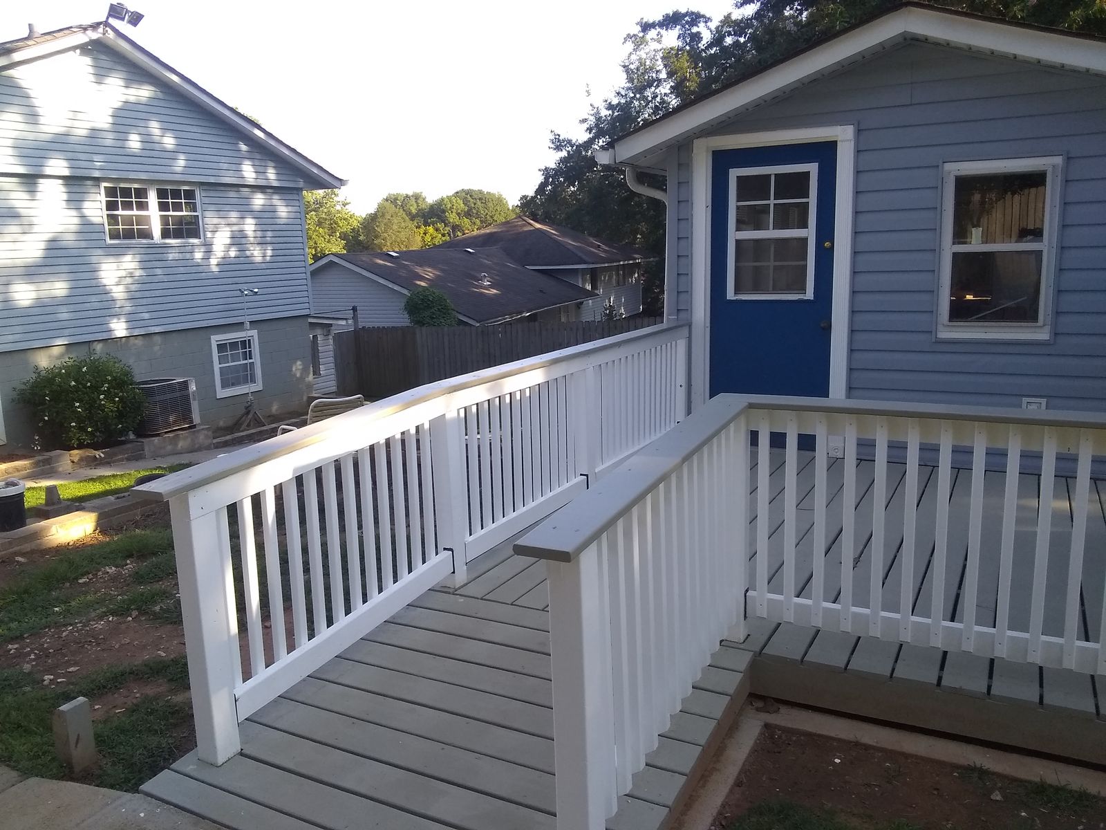

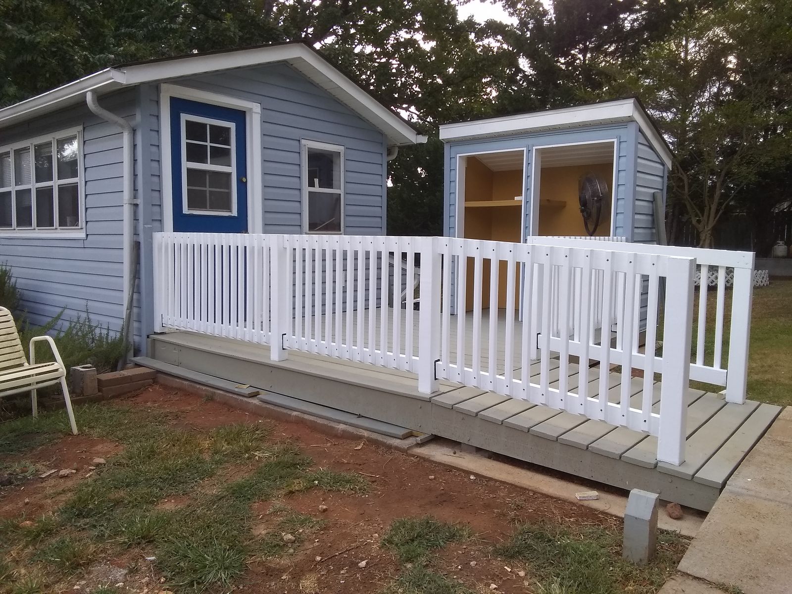

All the uprights are now installed, minor paint touch up but this part is done.
view from back porch
view from side
and finally a view looking from behind into the deck
That's a beautiful job, Gunny.
That's great!  Nice looking new space.
Tomorrow a top rail, still have yet to decide which color.  Grey from the deck or blue from the door.
I'll work on the doors next week...….
My vote will be grey which won't show the dirt as well.  But, then you can get a power washer for about $100 right now.  An electric one that does not have that much power, you can wash the house, car and all this.  I have one which will eat wood if you get too close or take the paint off the car.

My wife thought the same thing.  I painted a short board of each color this evening and let her take a look.
She tells me the Libra in her won't let her decide.:JawDrop:

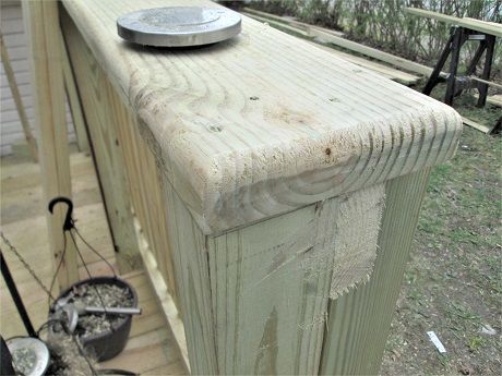

Well we went with the grey.  Good choice!!
That looks great.  The color matches the deck floor.
One suggestion, draw a semicircle on the ends and use a belt sander or sabre saw to remove those corners.  The overhang is perfect.  You did a great job on this project.  Looks very professional.
Good idea, and I thought about that while having a beer and enjoying my handiwork.  Minor detail, but you are right much better to round them than bump into a 900 corner.  Have to get on it and then touch it up when I check the rest.  If weather holds might get done tomorrow.

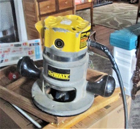

187605683_PorchProjectDewaltRouter.JPG.cefacb1abfb5a0ade3d7d7aaa641d4ce.JPG = 682258712_PorchProjectRouterresults.JPG.80f5ec1043596bc3d7b79e8aabddd0df.JPG
@steven newman  I saw yours were very close to the post and played with a mock up to see what I liked best.  You cannot see in the pictures but I did bevel the ends to prevent cutting myself, because hey I would be the one guy that does. :D
Going to give this rounded corners a try, if I change my mind I have room to cut them shorter and try something else, well at least once I can do that.:JawDrop:
