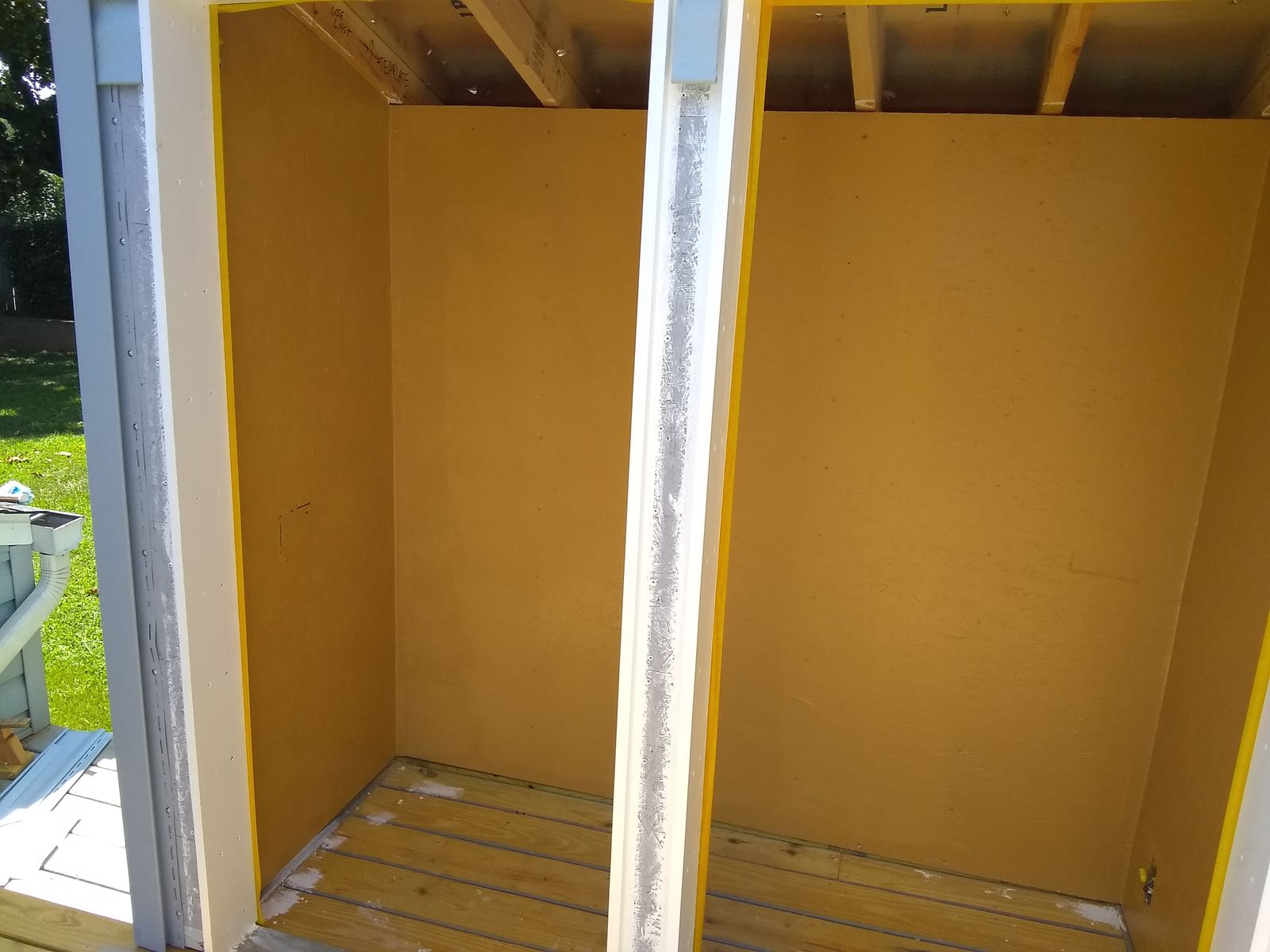

  • Busy couple of days. Managed to get the walls all painted, the floor painted, and finally got the only shelf framed out.  The top still needs more coats of paint this dry fit looked good this evening.

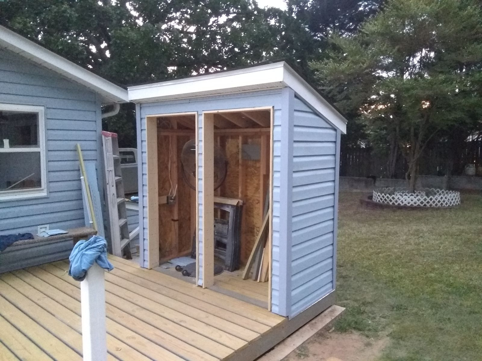

  • Finally finished before dark and can get some updates done.   Ran the power wire as I built the deck so power is already available and run from one side to the other.  At the moment I just n
Question: Are your posts in the ground on or on top of ? I can't tell for certain... I have plans to do a timber frame building sometime in next year or so,..that is one of my "not sures". After talking to a few guys at the moment I'm leaning toward on top of the concrete slab with a metal bracket of some kind to bolt in to.
For here locally they allow post for small buildings and decks that are below 24 inches to be buried posts.  For this project I used same method as before.  24-30 inches down, seal the post ends the day before and then fill hole with concrete.  The old ones were in good shape after 19 years but I cheated at the time and only went 12 inches.  Learned a few things about that since then and now minimum is always 24 inches.  After they had cured for a week I made a top cap that is 3 1/2 inches taller than the ground and 2 inches all around the posts.  Just one for effort to protect them.
I did look into the post brackets you are speaking about just didn't think it mattered for this small of a size deck.  Kept the budget low on this project.  All the 4x4's were given to me by a friend I helped out with his deck.  The concrete came from another buddy that bought 24 bags too many for a project.
Anything above 24 inches cannot have ground contact, and anything attached to the main dwelling cannot have ground contact.  How well they enforce that is anyone's guess.  Been here 26 years, a lot of decks and 12x24 buildings have been built using post in the ground.

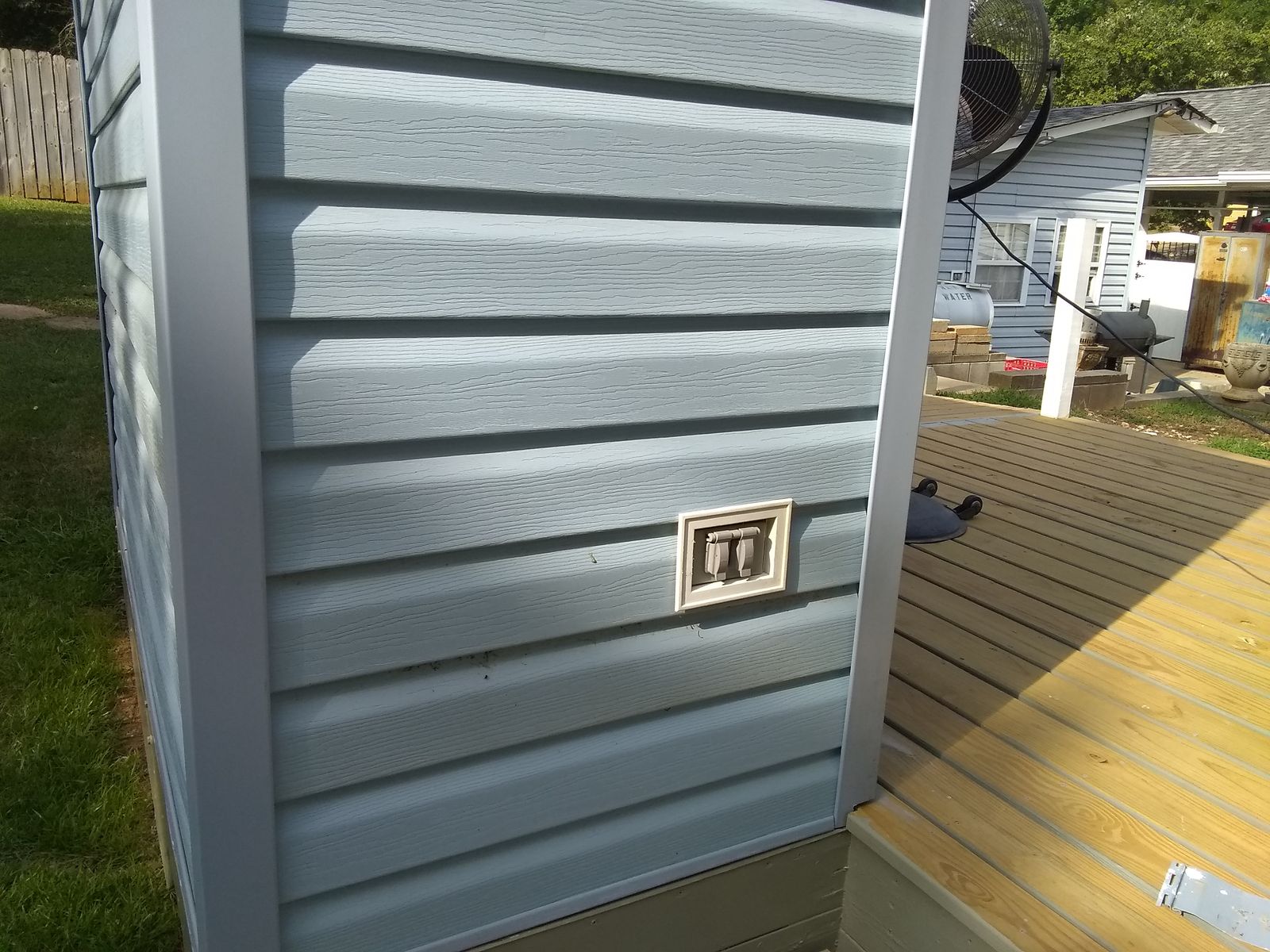

Had small progress all week.  Took two evenings to get some outlets run, then switches and finally tuck it away all nice and neat.  Having seen a lot of decks I noticed that it is rare they have more than a single outlet.  You think hey 2 outlets is enough right until you want some lights, maybe a speaker for a party powered up, and then something else.  Two just doesn't get the job done.  So I put two outlets in the exterior walls which brings the total available on the deck to 3 outlets.  Maybe enough?  Who knows?

Forgot to post the pictures of the outlets.
1362222685_outlets(1).jpg.a676811d177141a78b1ccf23fe5f2067.jpg  1036517788_outlets(2).jpg.a76dee1d3c855908d24b14405d03b0d5.jpg
WHAT? No in use bubble cover? Wouldn’t fly here in the peoples republic of taxachusetts.
Artie, I have to agree.  Those outlets are not permitted here.  We have to have those doors or bubble doors.  I prefer what Gunny is using as you open only the one you are using.
Edited by FlGatorwood
Also gotta be GFI protected, which I suspect these are.
Well if I was selling the place and an inspector insisted they had to be covered before the sale then yeah you would be required to have nice expensive bubble covers. Bit of overkill when the code requires a GFI receptacle for every circuit.
Yes the circuit has one, just in case I decided to spray water right into the outlet.  One of those hold my beer moments??
Looking mighty nice there Gunny
Out here, on the edge of reality, those bubble covers, of which you speak, haven't made it into the code...yet. In fact, I've not heard of them. Got a picture or link?
They’re called “In use” covers, meaning that they are listed to be rainproof, even with a cord plugged into it, during a rain storm. So why are the covers that WBBN posted not legal during a rain storm if there are no cords plugged in? I can’t get an answer on this. It would seem that the cover he used should be perfectly fine as long as he doesn’t plug a cord in during a rain storm. Most of us do not use cords outside in a rain storm. They USED to be perfectly legal, I’ve installed plenty of them over the years, and the inspectors passed them. But no more.
Those bubble covers are also great wasp homes.  :(
Bet a pressure washer would get 'em out. :ph34r:
This works wonders.
https://www.lowes.com/pd/Spectracide-Wasp-and-Hornet-2-Count-2-Count-Insect-Killer/1000486507
I have used it under eaves, faucets and for the widows next door.  Of course, my mother's dad would pick them off one at a time and roll them between his fingers.  We used to go to an old country church whose windows were not all that tight. Every Sunday morning, folks would wait outside until he had killed all the wasps.  He would go from one window to the next, picking them off, rolling them between his thumb and forefinger.  Then he would drop them on the floor and step on them.  It was my joyous privilege to get the broom and dustpan to sweep them up.  After the clean up was done, folks would come in and take a seat.  I'll take my chances from 20 feet away.  ;)
Well I have been know to do some crazy stuff at times.:D
I would think with the GFI in the circuit it still doesn't pose an issue.  And a GFI is required, and I do use them except in the shop.
Believe it or not the older style covers work better if there is a rain storm.
I haven’t experienced that yet, but that might be the NE location.
