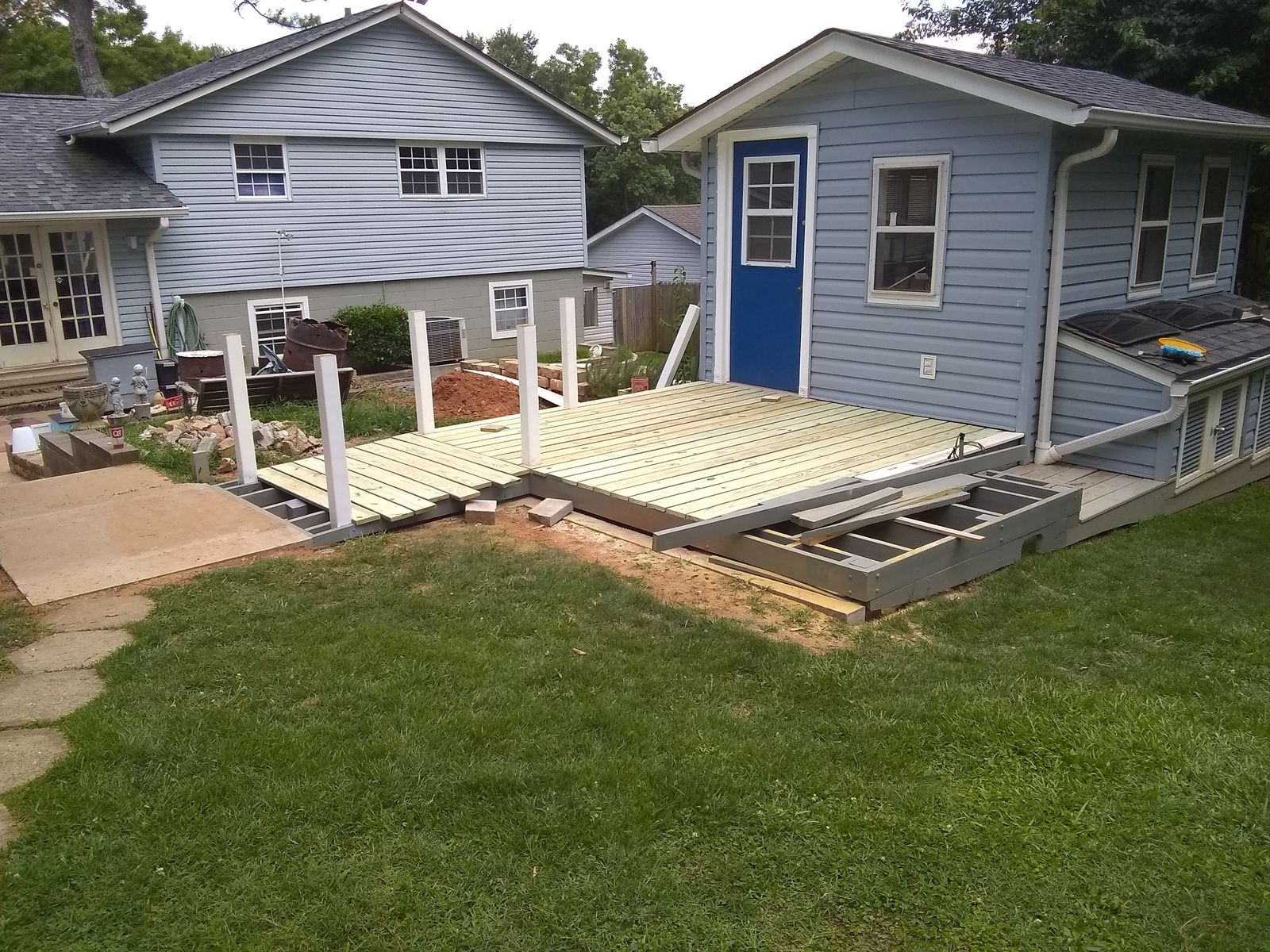

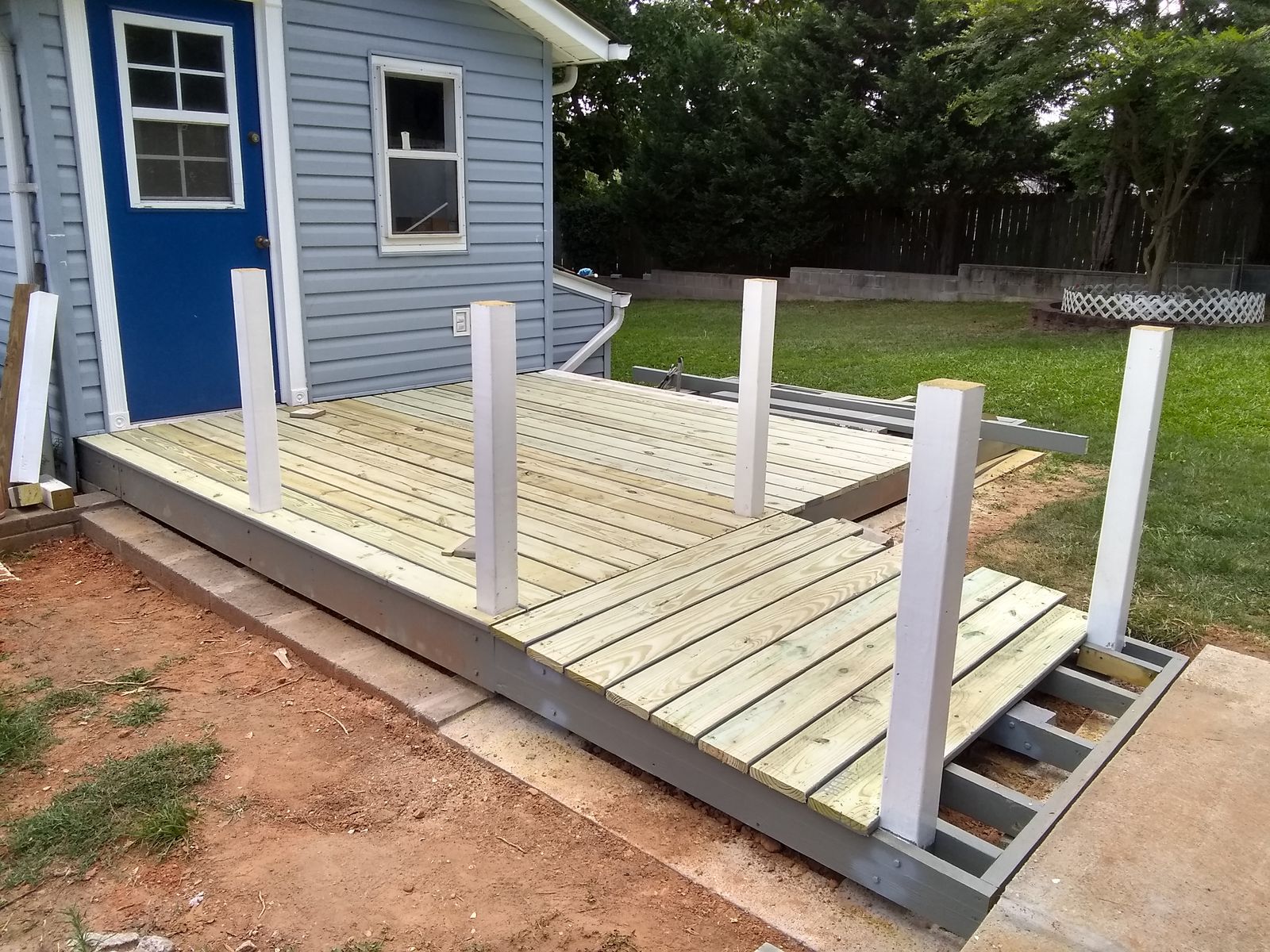

With that done I laid the post again.  This time I sunk them 2 feet down. Don't even want to talk about how deep they were previously.  To keep weeds out and make it easier to do the yard I laid a concrete foundation 1 inch under the deck level.  Trying to keep that pesky water issue at bay.
I saved a good portion of the previous deck boards so only a few new ones had to be bought.  Someone gave me 2 gallons of deck stain so I gave everything 2 coats before, and sometimes right after assembly.
Also added some more post to support the ramp to the deck.  Over 52 inches I had to come up about 3 inches up to meet level with deck.  Too small for a step, unless I wanted to kill myself so a ramp seemed better.

Really too bad about that tree.  That should have been wonderful shade.  And, now cut down, should be milled and sticked in that great shed.  It would make some really good lumber.  Coat the ends with Anchor Seal or multiple coats of latex paint.
Great job on the new deck.  That appears that it will be sturdy.
You'll also greatly appreciate that ramp as you age.  Just in the event you may need some help with mobility, that ramp will be the ticket.  Or, if you want to move heavy items in or out of your shop, that ramp will make a real difference.  As I have aged, I am adapting to making it easier for me.

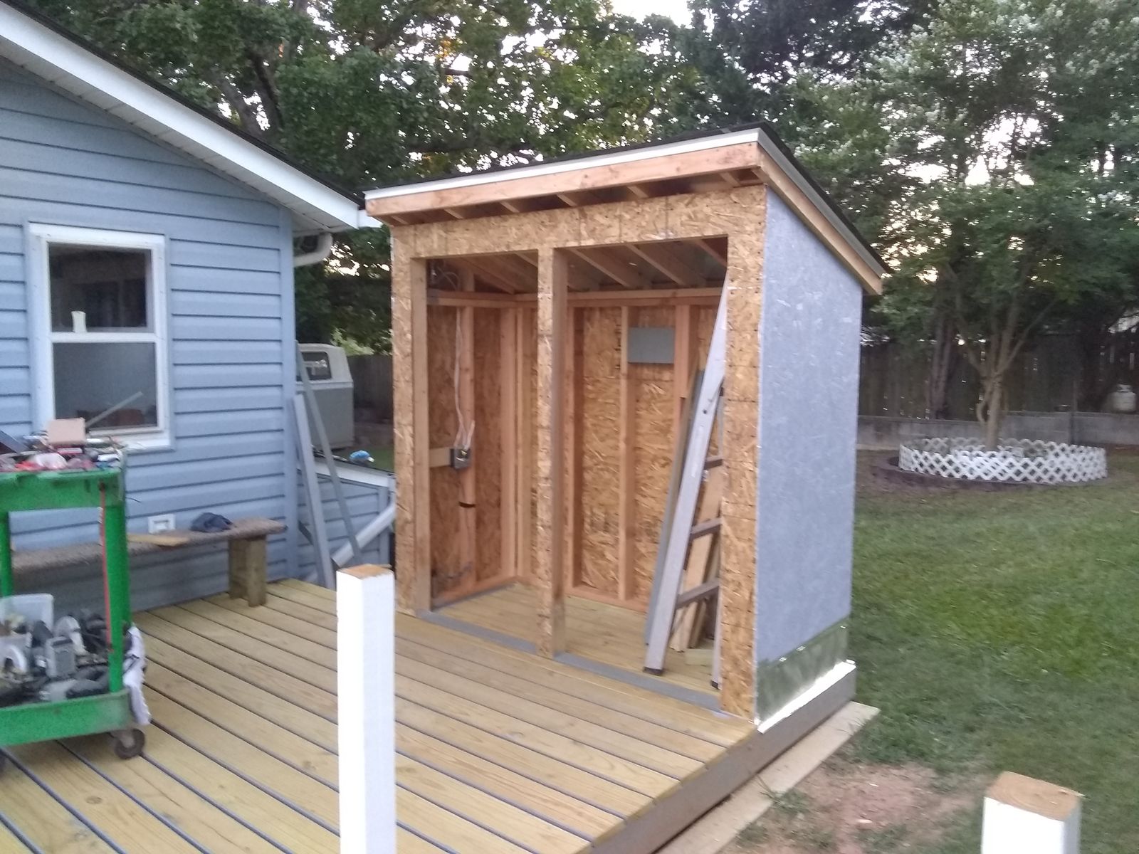

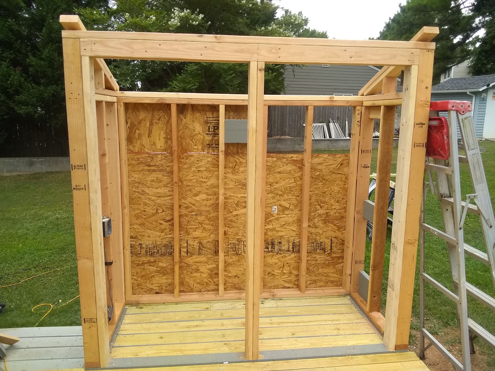

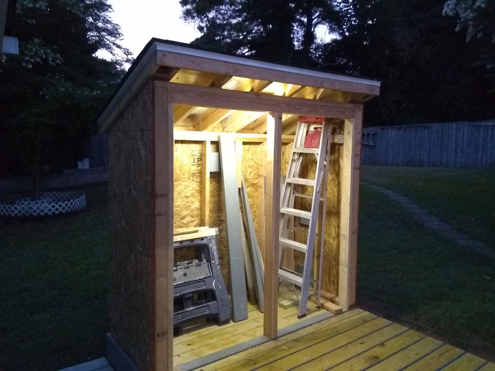

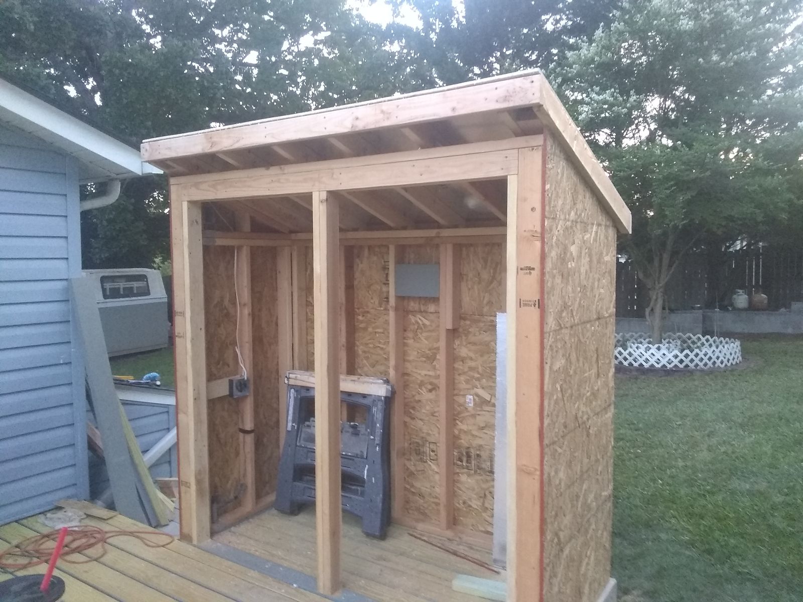

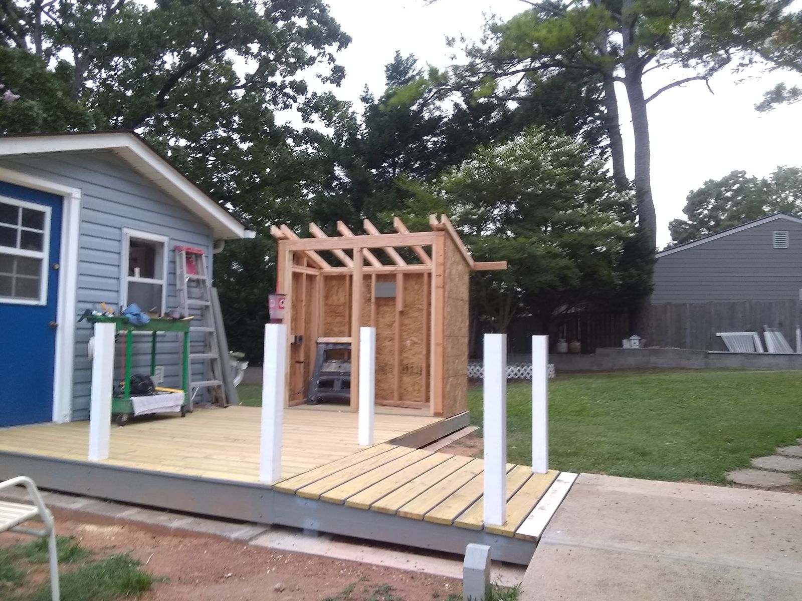

Further progress in this project.  Got the deck assembled.  Then began working on the 3ftx6ft storage closet.
1052428779_Deckrefurb(2).jpg.91140ca64e68ac64844e2b32a7441f54.jpg  591963080_Deckrefurb(3).jpg.f2e5a128256d209c2834da5fd41c2f13.jpg
 997184655_ClosetBuild(2).jpg.22cdcb74c523c9ab828f0b614a43b3d9.jpg  767831757_ClosetBuild(5).jpg.5e60ba8dfc1980b4c3498382d34fabd6.jpg
What is the small building going to be ? Out House?
Storage for deck chairs and a small folding table.
30 minutes ago, Gerald said:
Out House?
Now I had not thought of that but maybe half can redesigned to accommodate.:ChinScratch:

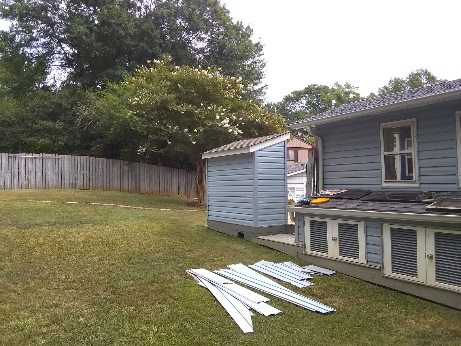

Roof installed, despite the rain.
I'm looking for something to protect that chip board.  All that I've ever had rotted in 10 years or less.  They roofed my garage with it because it was code to withstand 140 mph winds.  Before 10 years were up, I had rotten decking that could be easily seen from inside.  Called a roofer and had everything removed and decking is now 3/4" roofing decking plywood.  Inspector failed it, but it will be there when both of us are looking at the underside of the grass.
Are you going to install doors?  I like that you have some electricity to it and the one emergency rest room idea is great and convenient.
The building the deck is attached to is made of same stuff. Built in August 1999.  Here is what steps I took to keep that issue at bay.
Caulked every edge of OSB before installation, and let cure for 2 days.  Then caulked again when installing.  Painted all outside edges before install with oil based Kilz.  Then painted with latex 2 coats after install.  Used something like Tyvek on the corners and the windows.  Put 10" tin splash guard up at the bottom before installing Styrofoam for vinyl siding.
So far when inspected no rot issues except a trim board around door I seem to have forgotten to seal up at the bottom.  Minor issue, fixed on this refurb, correctly this time.
This closet gets same treatment.  I have the time and patience to do it now rather than burn more time later.

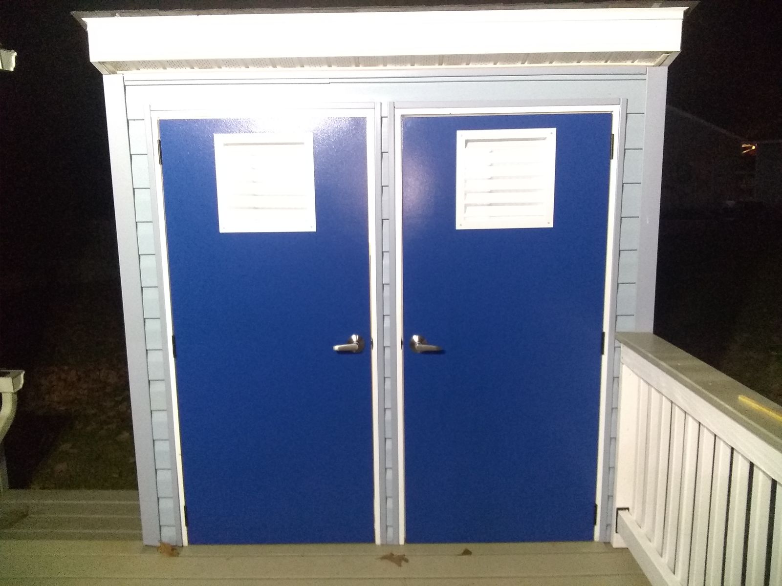

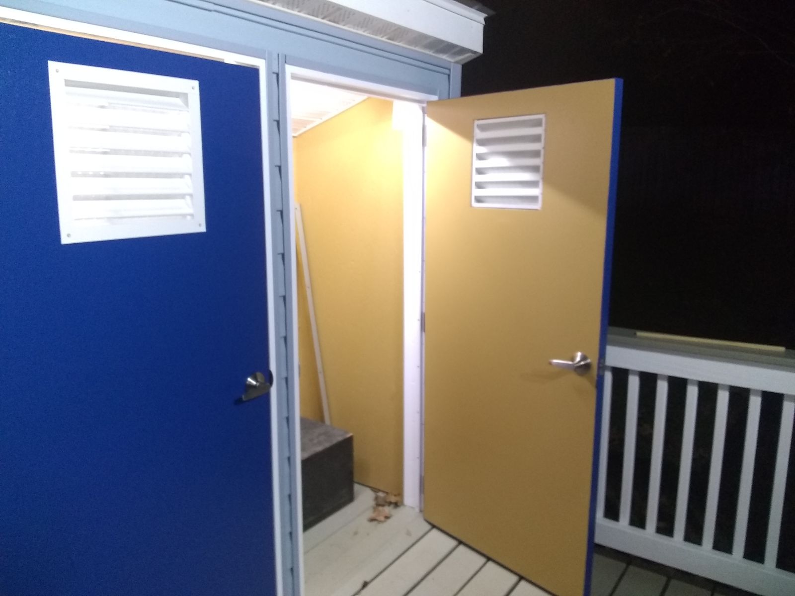

  Yes should be two 30 inch or little less doors.  They will be at 6 ft tall so custom doors are in order.

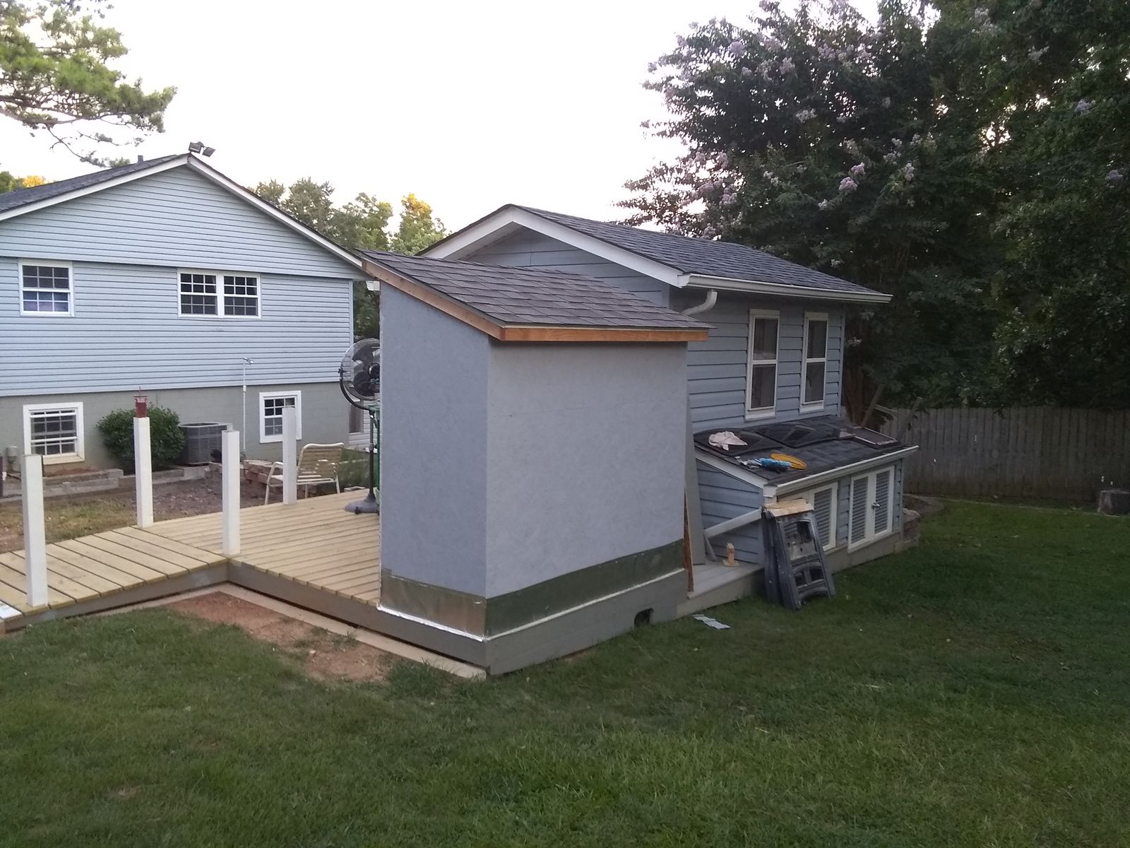

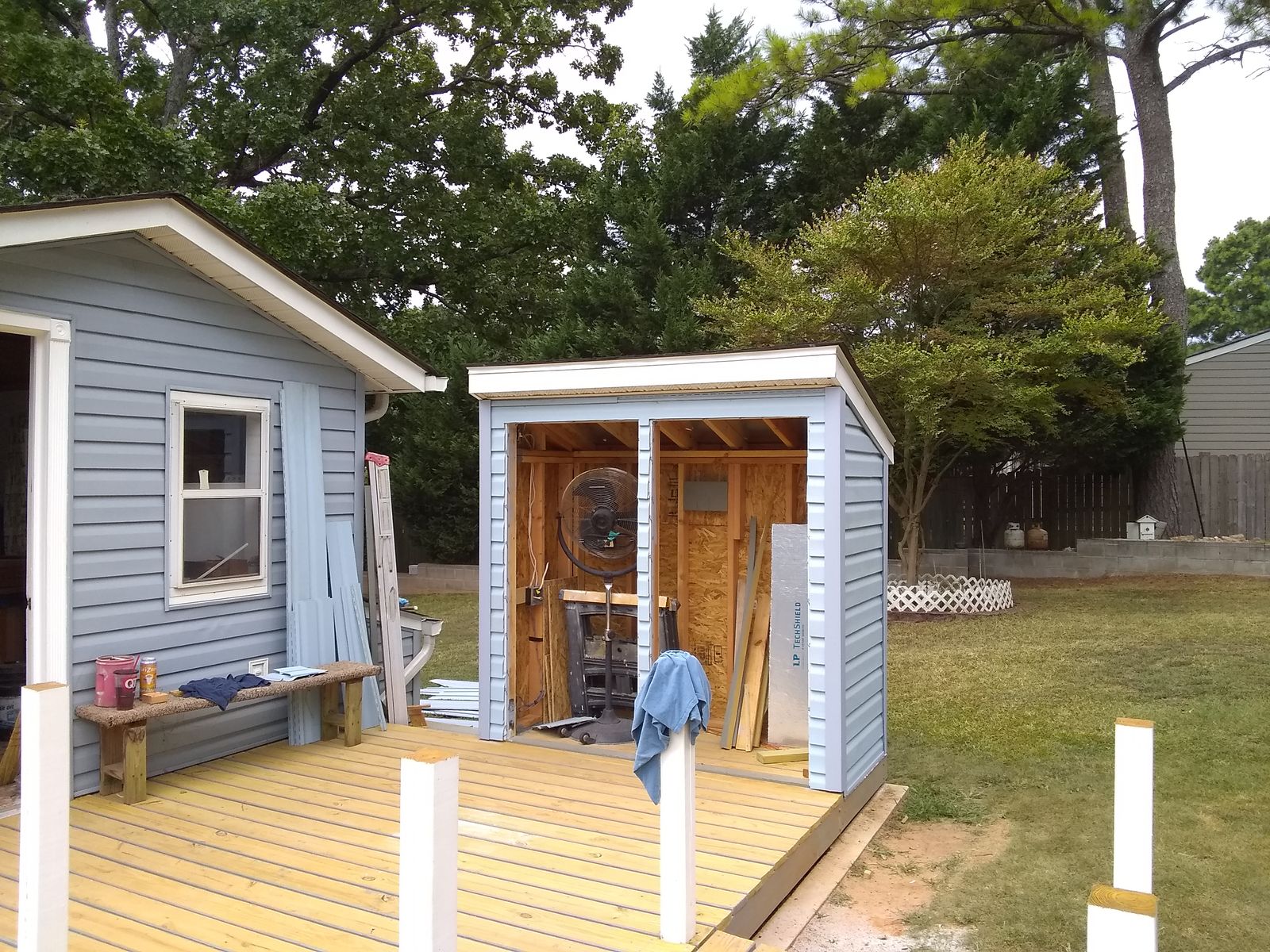

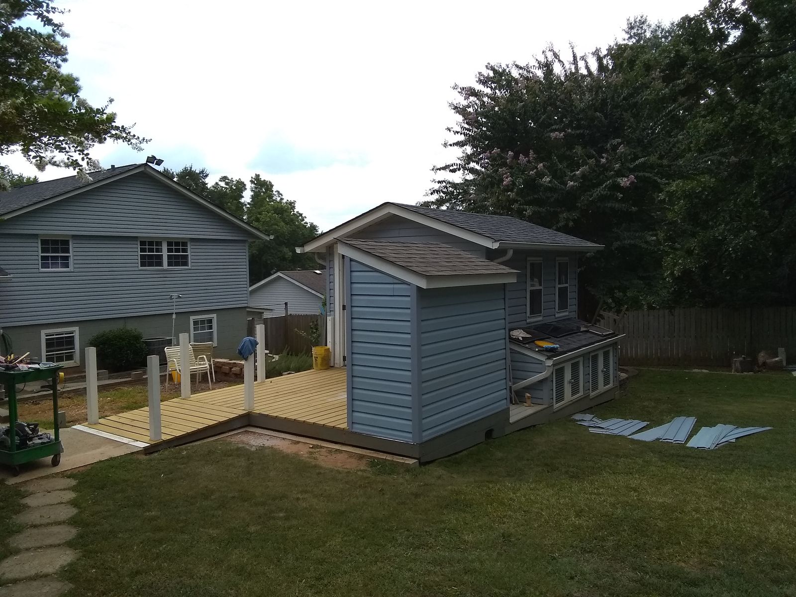

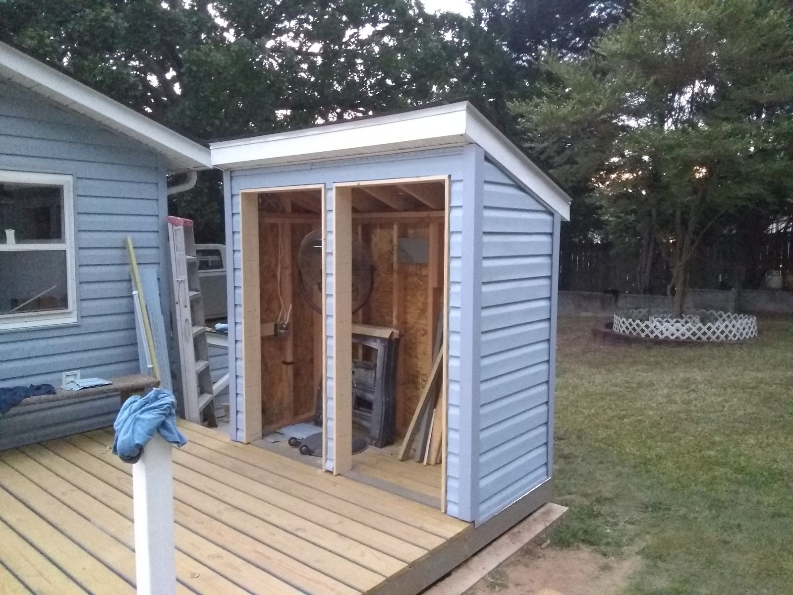

Finally finished before dark and can get some updates done.
Ran the power wire as I built the deck so power is already available and run from one side to the other.  At the moment I just needed a light so I ran an outlet in the ceiling which will stay.  It is switched, and will be like my shop lights. Install lights with a plug and you can fix or change anytime you want because no hard wiring, just an outlet. @Artie  I even used 12 gauge wire.:D  Still have outlets to run and a power wire to a light pole I will be adding once done with the doors.  I intend to light up the backyard with three  20watt LED floodlights mounted at the top of a 14 ft pole.  Haven't gotten around to welding up the 2 inch square pipe and brackets yet.  But I did put braces in the wall between the studs, used 2 x 6's that should hold.  :ChinScratch:
Next I sealed the OSB with paint I had extra, oddly it matched the siding color so a bonus not that it mattered.
Had to get a roll of trim coil, I needed 8 feet, had to buy the entire 50 ft roll.  Okay so now I have extra, a lot of it.  Borrowed a friends metal brake and made the pieces then installed.  The siding I got from a house that was condemned by the county.  Guy let me tear as much as I wanted off and it was light blue.  Certainly not an exact match but close enough for me.  Had to buy a couple of corner pieces and despite my best efforts I still have to get some "J" channel for around both doors.
So on now to the doorways.  Managed to get them installed and all sealed up but no paint.  Only so much time in a day.

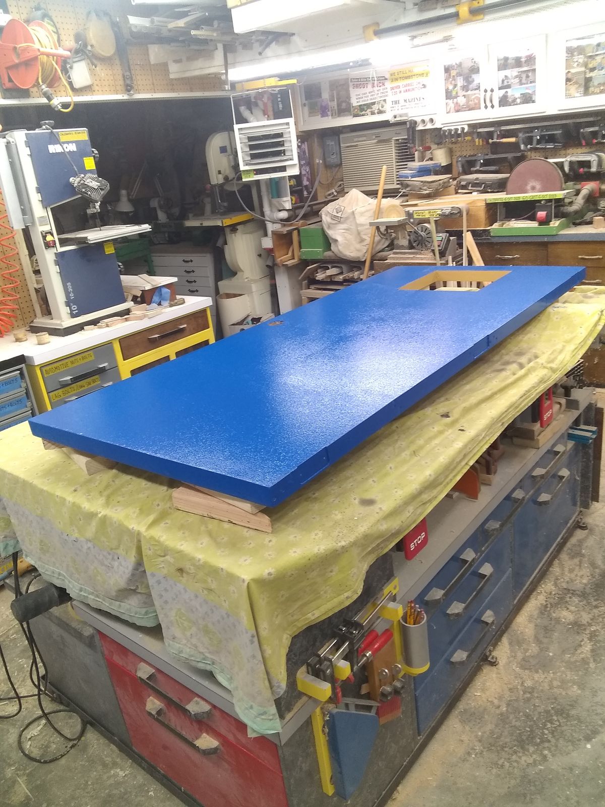

Me too, I am still considering a few options for method of build.  Typically for a shed I use 1 1/2" square stock and sheath it with 1/4 plywood on both sides.  But being that this is close to the nice door on the building I am thinking a bit more fancy.  Don't need windows but perhaps some faux windows?

Curiosity question--I see a hole under the shed in the support beam.  Or, is that an optical illusion?  It appears to be perfect for raccoons or opossums or some such creators.  I hope that I am not seeing correctly.  I do need to have my vision checked.  It's been a couple of years and I can tell I need some correction.  Anyway, back to the thread, no judgment intended, just trying to figure it out.
