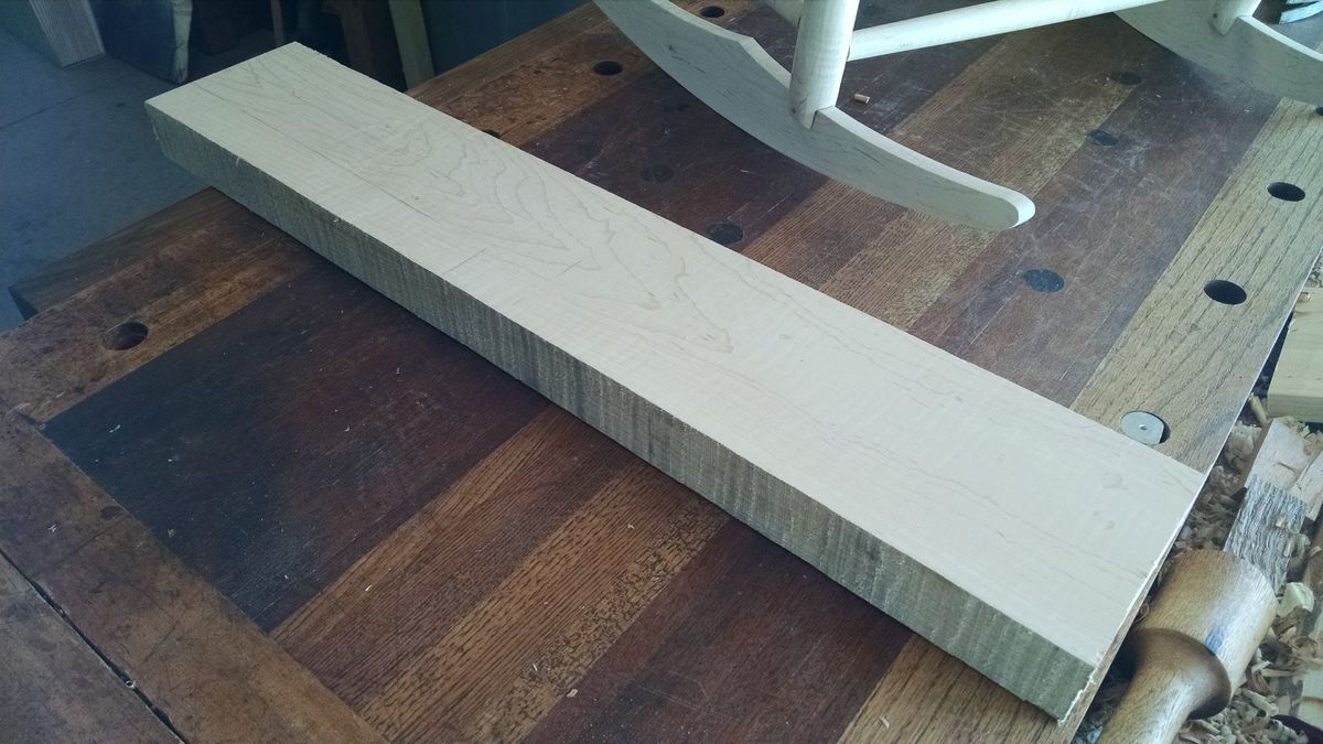

It's a miracle I still had a billet of curly maple sitting in my small lumber box for this project, I figured after two years I would have used it for something else, not remembering the original intent for the remaining billet of the original cut outs for this rocker. But I found it!
I purchased this lumber at Curlymaple.com where the gent who owns this small mom and pop mill sells much more than just curly maple, don't let the name fool you, they have some beautiful lumber of varying species. We have a great hardwood retailer here in my area, but really, the three main species, Cherry, Walnut, and Maple, it seems the best lumber with the prettiest figure and grain comes directly from east of the Rockies. The cost difference is dismissable, especially if you plan on selling your work, you can build in the cost to the price of the work, and it truly is negligible.
There is another dealer of lumber that I have purchased from as well, his curly maple was outstanding, he is Bob Kloes Lumber and he is a wonderful craftsman as well.

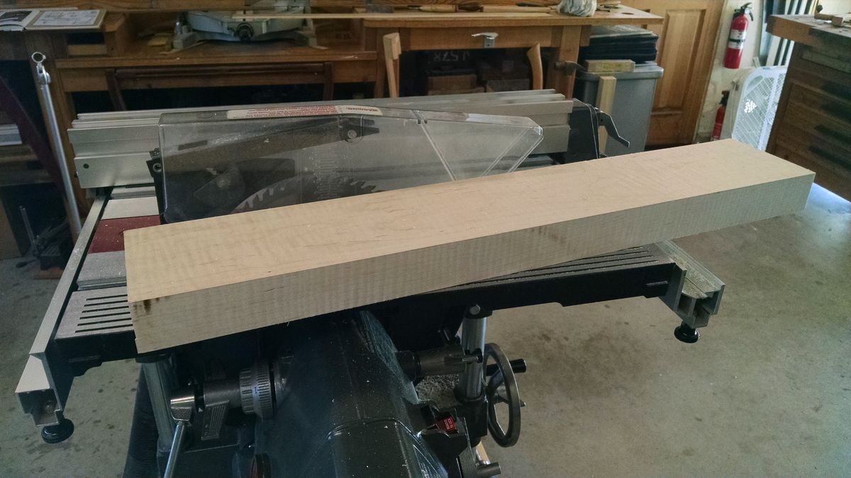

So, I just wanted to show you all that I put a billet of 8/4 maple through my Shopsmith, and I am so tickled that my Smith is cutting so well. For awhile there it was not cutting well, I could not have pushed this billet through the table saw of my SS before an electrical repair was made, and now it's like I have a new Shopsmith, the edge facing you in the image below was just cut, I cut out a 3/4" strip to use for my shawl rail, and as you can see there is only a couple dark marks, my fault, the first mark I fed it in angled, and the middle slight burn is when I paused briefly.
If you have not already seen my electrical saga you can see it at Shopsmith Has New Power.

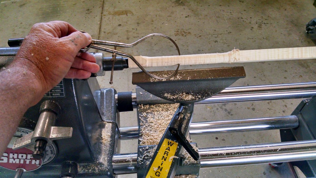

Jumping to the actual turning of my shawl rail piece, I set my calipers at 11/16" and I roughed it in with my Easy Wood Rougher to about a 1/16" heavy, so I could come back with my Easy Wood Finisher and bring it close to final dimension, and of course with the sanding the very near final dimension is achieved.

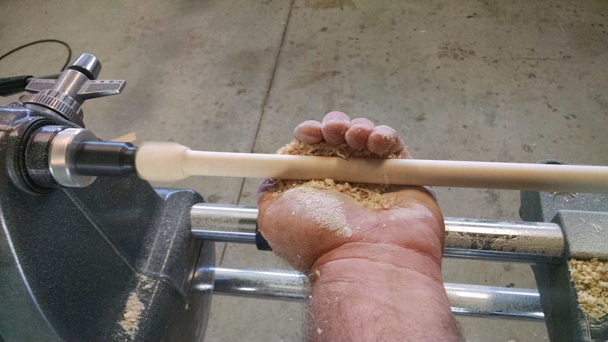

After I turned down the spindle and sanded, I burnished the spindle with a handful of shavings, this is a really neat way to bring out the glow of the wood and figure, but the reality is for this process, it's useless, only because I need to insert this spindle into a 200 degree steam box that raises the grain considerably and all that burnishing work is eliminated during the steaming. But hey, it's good practice! Really I could sand to 220 on the lathe and leave it at that, until it comes out of the bending form for final sanding or scraping then finishing.

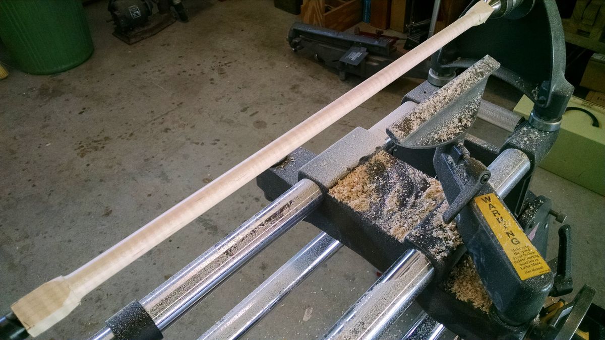

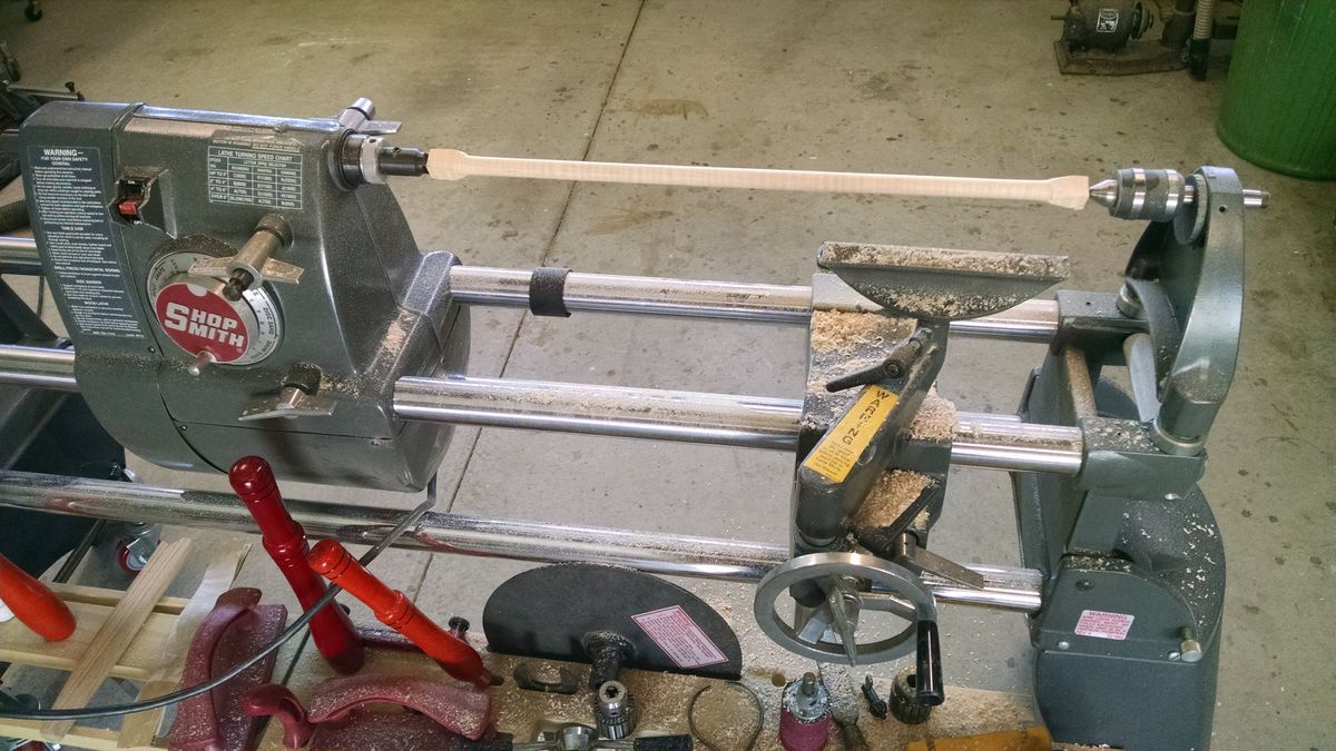

For the diameter of this spindle, it's long, about 22" long, so I had to support the spindle while I was turning it with my left hand wrapped over the spindle with my fingers hanging down and my right hand holding the chisel right at the same location being supported by my left hand, and my left hand thumb is applying pressure on the top of the turning tool tip and acting as a guide as well. It's hard to explain. But I adapted this method by reading the Kerry Pierce book on shaker furniture and how to build. I saw him using this method and I adapted it as well and have turned dozens of thin spindles using his method and I am very comfortable with it.
The tool rest is set back for sanding.

Just another shot of my Smith in lathe mode. You may notice I have a live center at the tail stock, it's one I had laying around for other purposes, I need to purchase a regular live center for future turning if I am going to use the Shopsmith, which I will. My Laguna lathe live center would not fit the Shopsmith, I tried, it's a different taper.
I installed the Shopsmith dead center on the lathe first to give it a whirl, so I could at least say I did for review purposes, within minutes it started whistling, and it was annoying, so I switched it out.

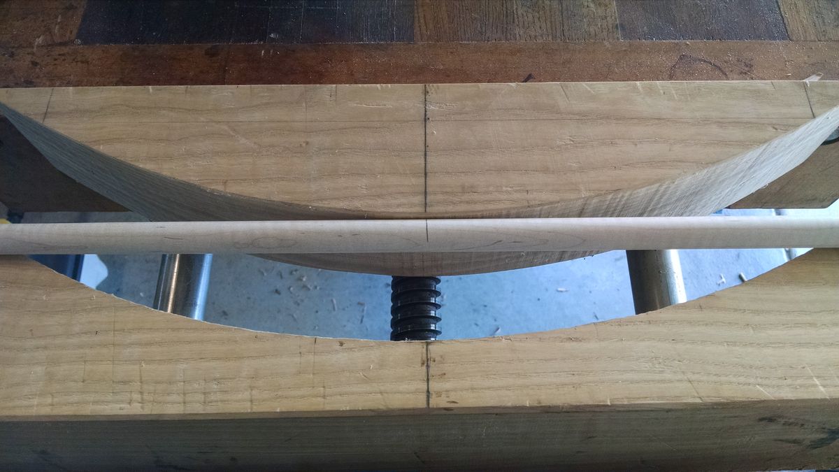

Our shawl rail is turned and ready to bend.

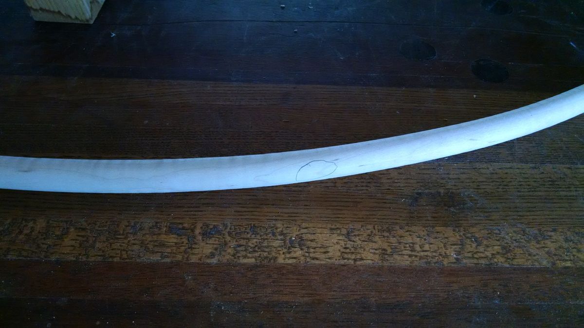

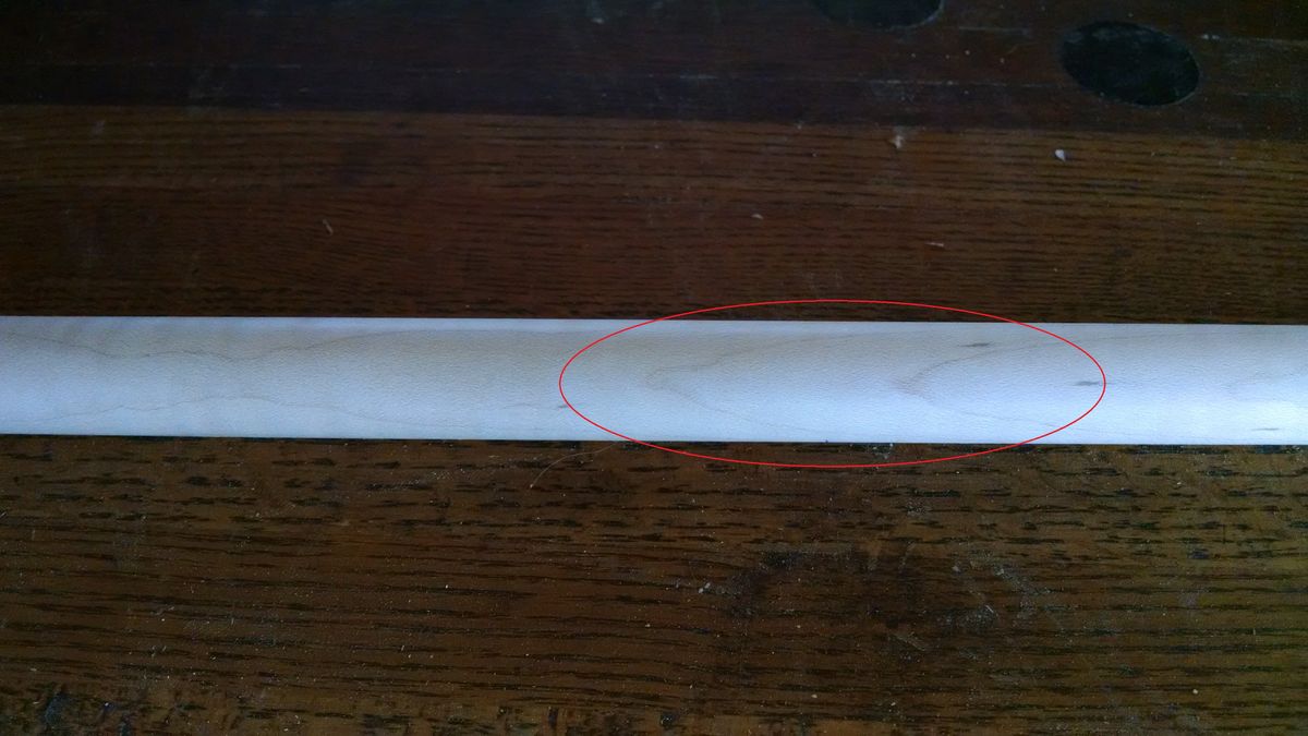

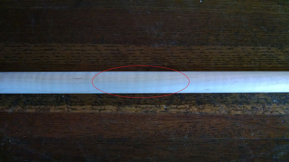

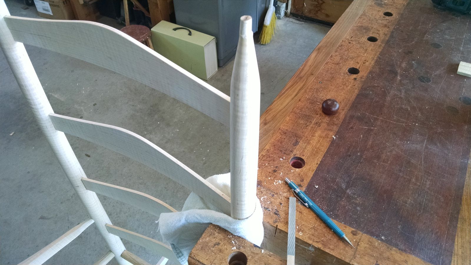

But first I had to orient the spindle correctly before bending. When bending you want to avoid grain run-out at the outside of the bend as much as possible. That is why for bending you want to try to choose consistent and straight grained lumber if possible, sometimes appearance and design don't allow this luxury, but if possible you want to consider using very straight grained lumber for bending. That being said, curly maple is anything but straight grained, and this section of my billet had some pretty good cathedraling of the grain, and that is the worse to have for steam bending but there is a way out of this predicament.
If you see the first image below I have circled in red, the area of the spindle that has the small cathedral grain. We don't want that grain to be on the outside of the bend, this will cause grain run-out. I experienced this on my first rocker shawl rail as an inexperienced shaker rocker builder, and it has become unsightly over time, and it even has the possibility of the grain flaking out and away over time from the outward stress of the bend. It's not so unsightly that anyone will notice it, but I notice it, the lines of the grain in that area are darkened, almost like the cathedral developed a dark outline of itself.
So to alleviate grain run-out in a bent piece, simply install the piece in the bending form with the cathedraling facing up and down, and the straight grain portion of the piece should be on the outside of the bend.
The area circled in red within image below is the straight grained portion of this spindle that I want to have on the outside of the bend, this will avoid grain run-out. The cathedraling is facing up and down in this image, out of view.

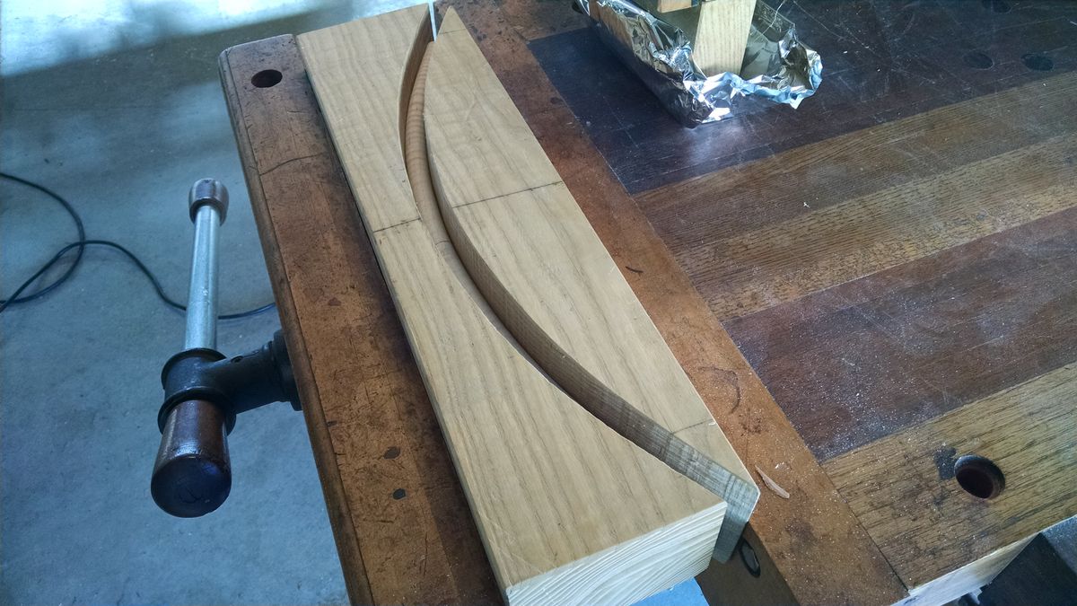

Before I put the spindle in the steamer I set a center mark on the spindle so I could line it up with the center of my form, to ensure the radius of the bend is centered. So, I am going to set the reader up for something that I did completely wrong, even after my long winded explanation of grain run-out. Perhaps you can see where I am going wrong already in my mind, planing this simple bend. Just look at the image below, by the end of this post you'll know already where I am going with this. The line I marked is not only the center of the bend, but an indicator to remind me which side of the spindle should be facing up to avoid the cathedral grain on the outside bend.

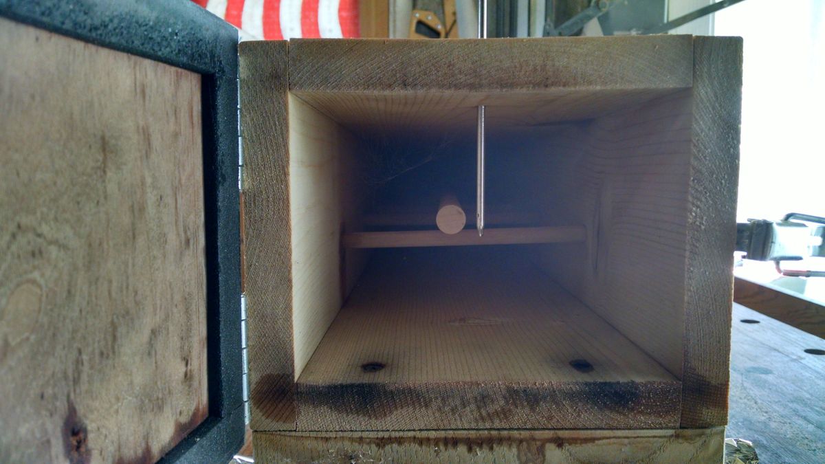

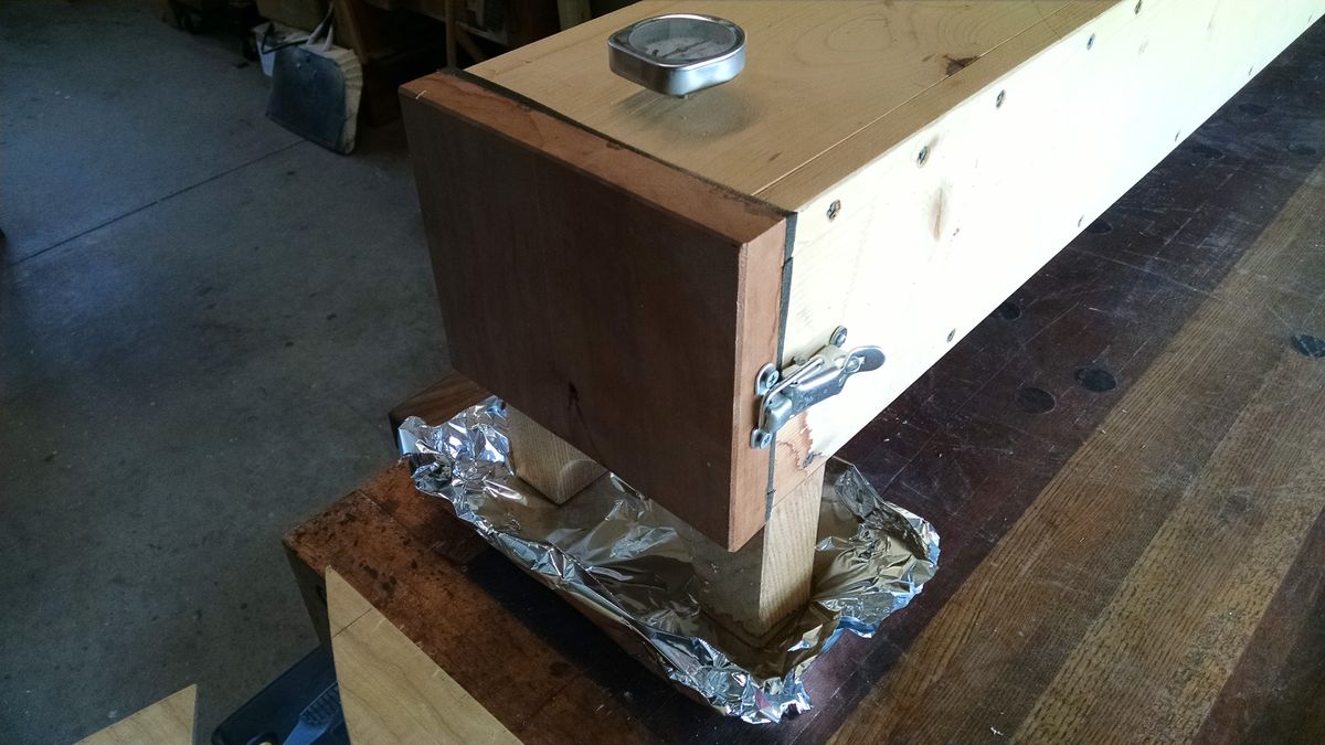

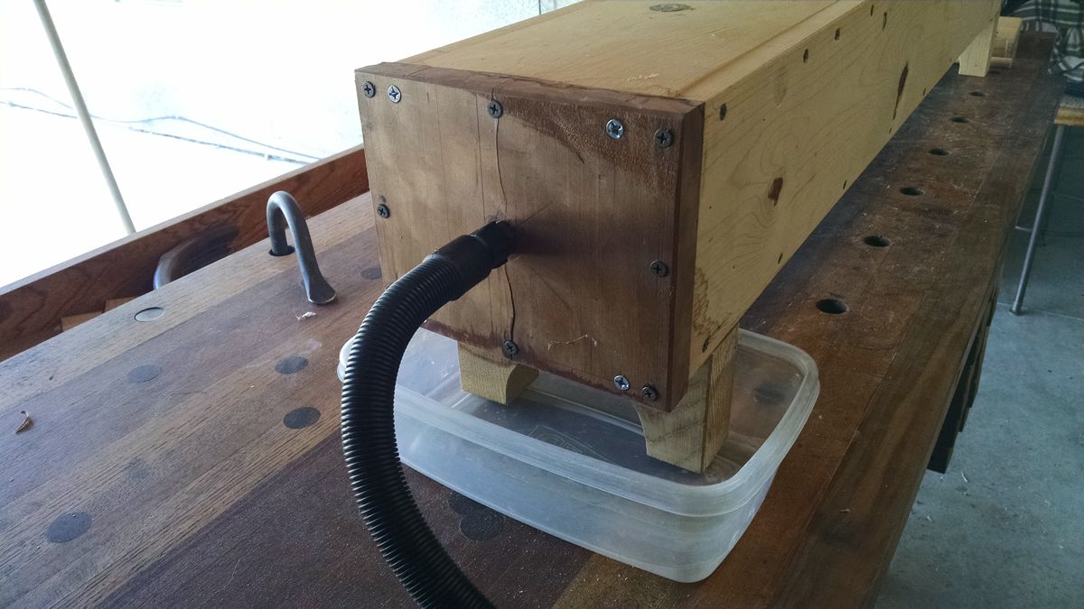

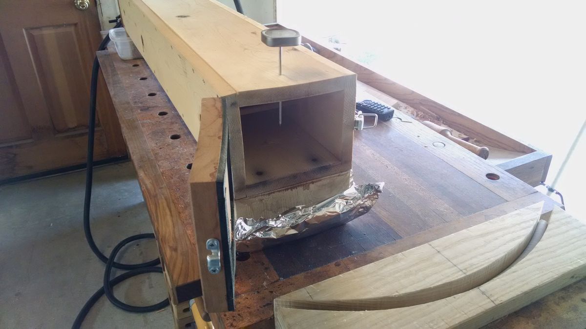

The following images are just fun shots of my steam box I made. If you want to see how I made this box you can see my gallery at:
The foil at the front catches a little condensation that ends up dripping out, but the majority of the condensation runs to the back of the box, the box is slanted back for this purpose.
A plastic container to catch the main runoff of condensation

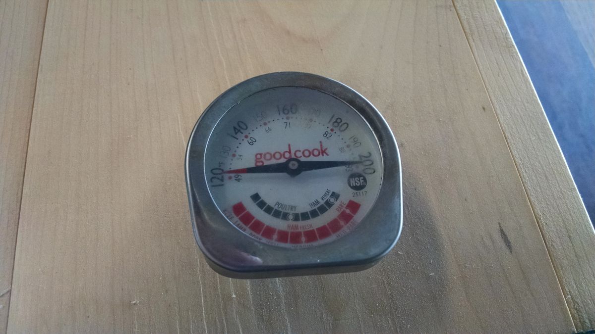

The recommended temperature for steaming is 210 degrees or there abouts. We are almost there.
I set the spindle in the box, dang, I forgot how hot it gets in there, even with the door open, I steamed the skin off a couple of my knuckles. :mellow: So I grabbed a pair of tongs from the kitchen to be ready to take it back out.

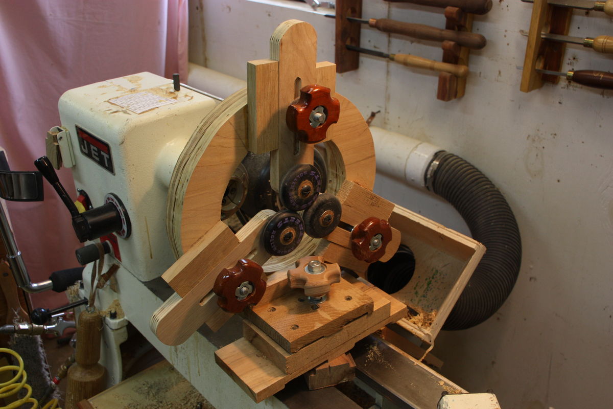

Nice post John. I thought you said you was not good on lathe. That is a good job for not having a steady rest. You can build your own for the next project and it makes it much easier to stabilize the blank.
Thanks so much Gerald! And thanks for the steady rest idea, I love it!

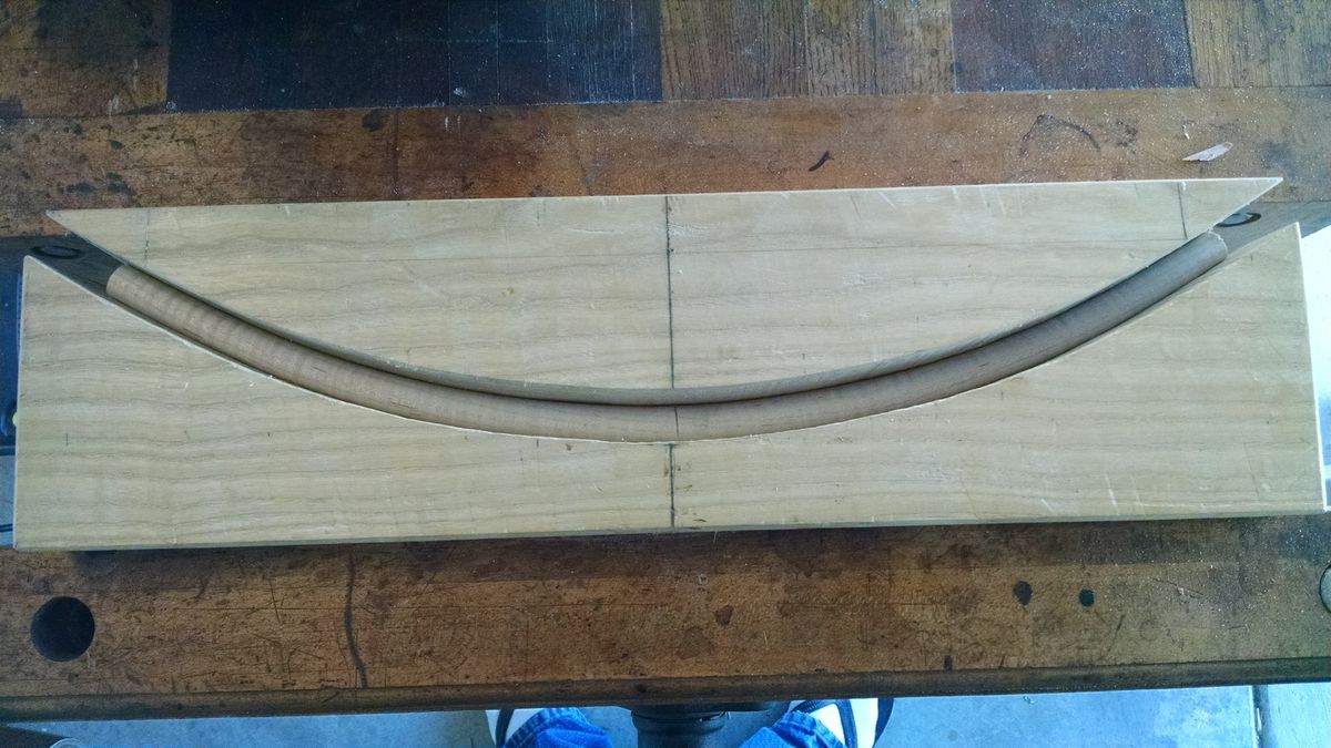

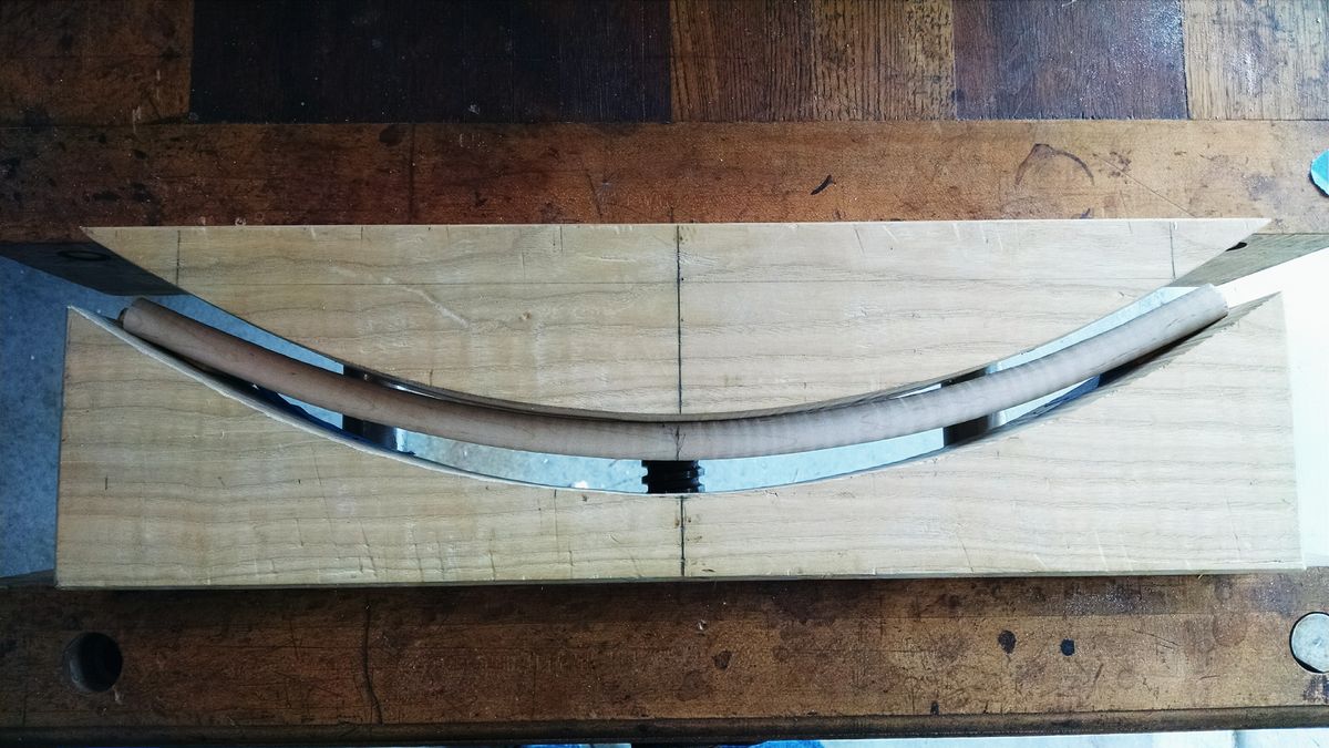

This morning, after I submitted the last entry here, I walked into the garage and looked to see how my shawl rail is doing.
I decided to loosen up the form a bit so the radius of the rail will more closely match the existing radius of the back slats.
Since the back slats set for two years, some of the bend came out of the slats. I should have resteamed the slats and bent them back. But it won't make that much of a difference really, as long as they all match.
I'll let the rail sit in the form in this relaxed stage till Friday. Then I'll fit it to the top of the backrest with wedged tenons.
Oh, one last thing, you can now see I got the grain oriented correctly this time. Note the cathedral grain facing up, out of the bend.

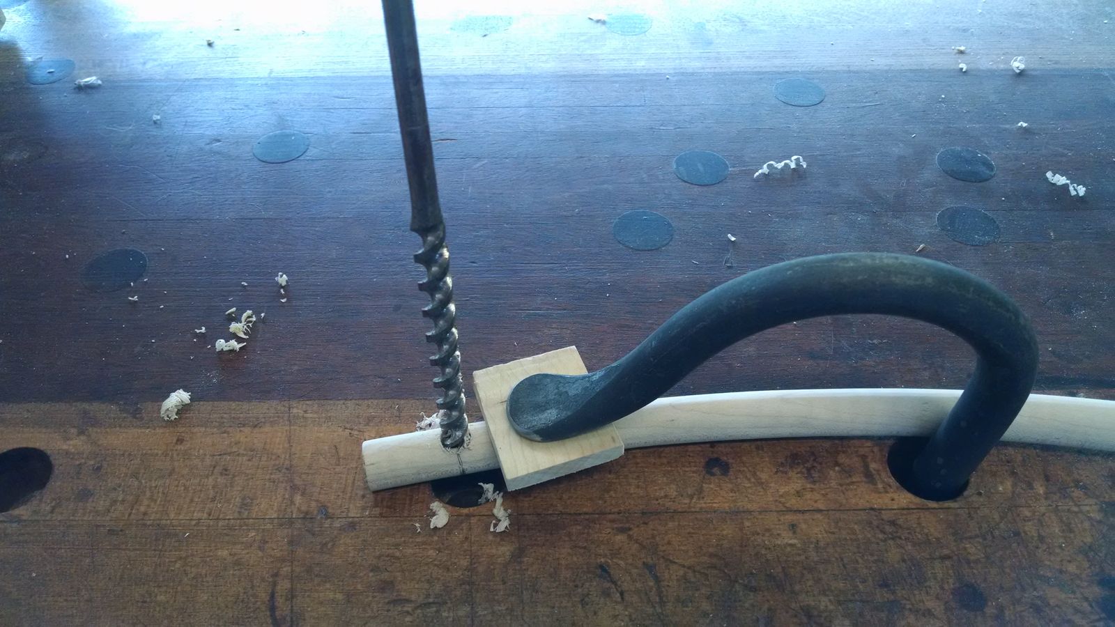

After the tenon was refined to a point, I bored out the 1/2" hole in the pillow rail itself. I am using my Fay and Spoffard brace and a Jennings bit, a great combination for boring.

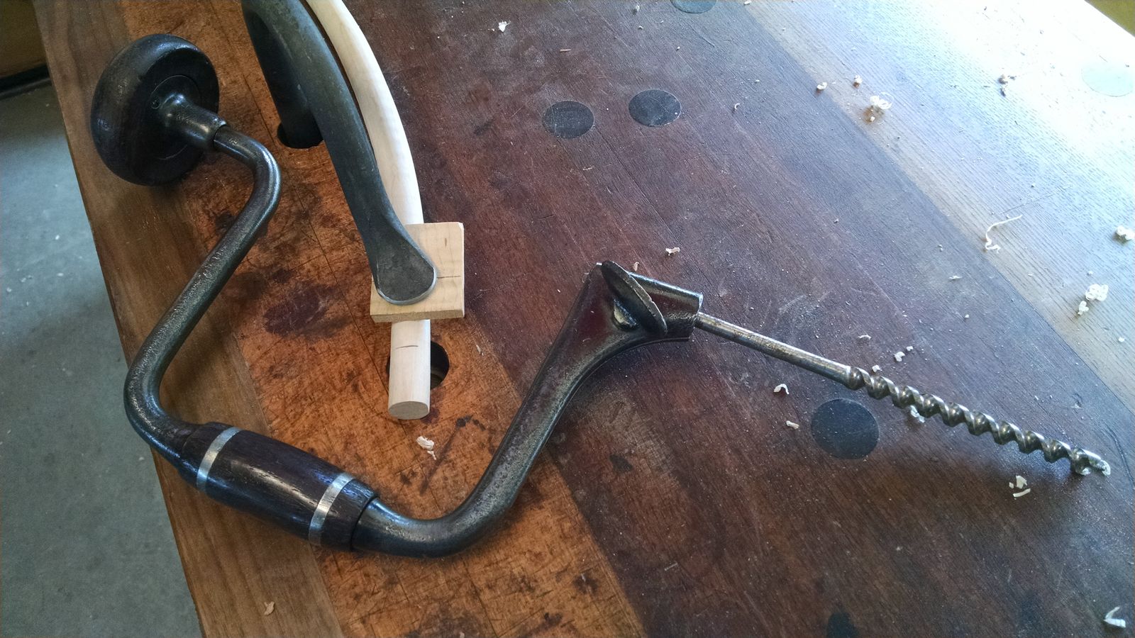

Getting ready to bore the other end of the rail. I wanted to show you my Fay and Spoffard brace, these are wonderful tools, highly sought after by chair makers, especially Windsor makers. And I know why, the level of accuracy and the feel of these braces is incredible. Since there aren't any other mechanics between the human body and the bit, besides the brace itself, you have a direct feel to the wood, you can literally feel when the bit is getting close to the other side, you can even hear the wood starting to shallow out, and you can hold this brace at angles and maintain that angle easily because you don't have the other mechanics in the way as other braces do, such as a ratcheting system, a bulky chuck, switches for reverse and forward etc etc. There is a direct translation of your energy, to the wood being bored, this is completely difficult for me to explain but all I can say, if you are wanting to bore holes with bit and brace, you owe it to yourself to find a Fay and Spoffard (or Spoffard) and try it for yourself, you'll be amazed.
Note the "quick release chuck", just a winged knob, a slight turn and that bit slides right out, and in with another, I can change a bit faster than with a portable drill quick release, and faster than a ratcheting chuck on other braces, not that speed is anything that matters in this brace, but it's just fun to talk about. :)

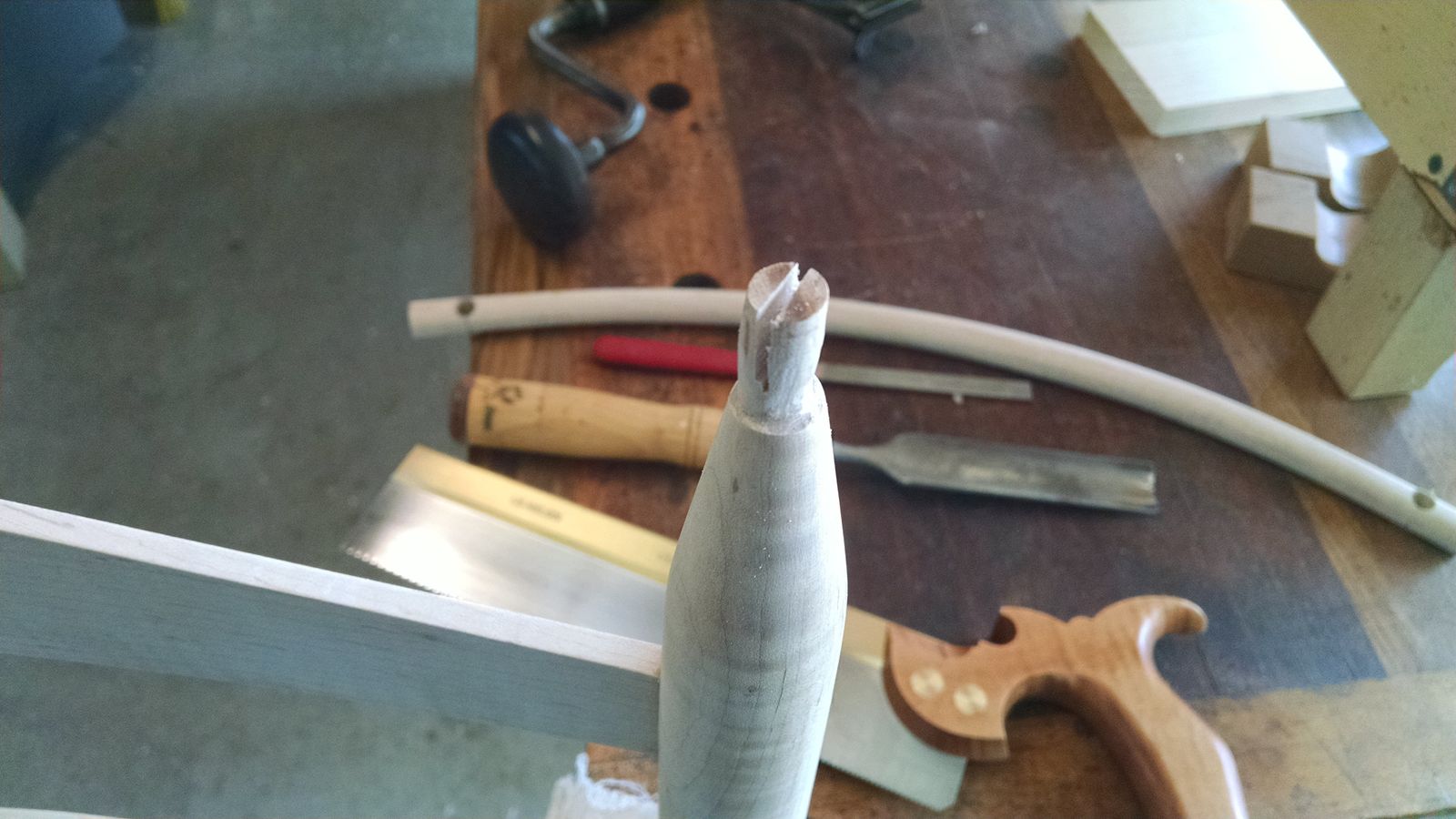

So the tenon holes are bored in the pillow rail, and it's time for final fitting, sometimes the rail does not seat properly, and some fine tuning is in order, as was the case here. I know, it looks rough right? Believe me, once the final fit is done, and the slot is cut, and the wedge in place, it cleans up nicely.
The wedge slot is cut.

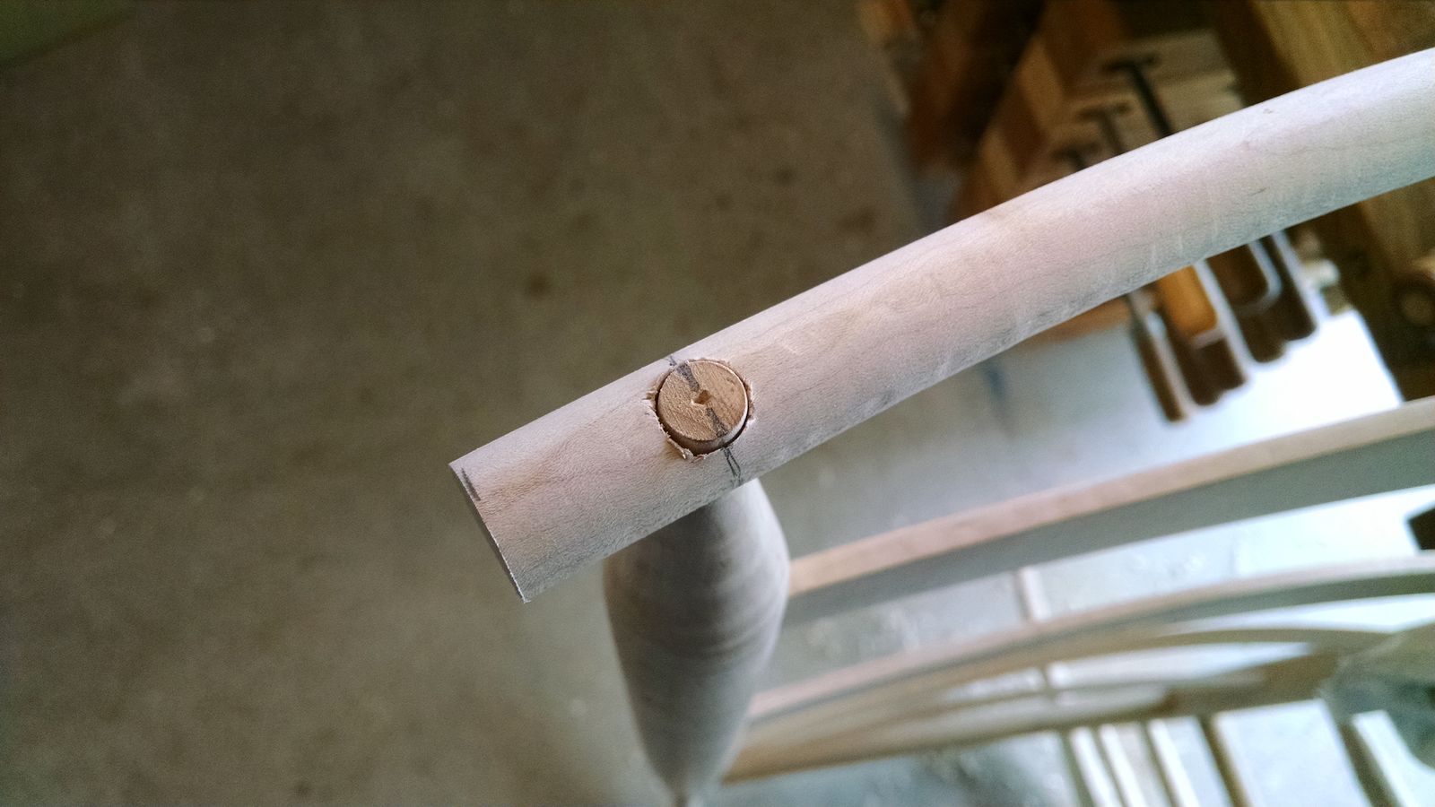

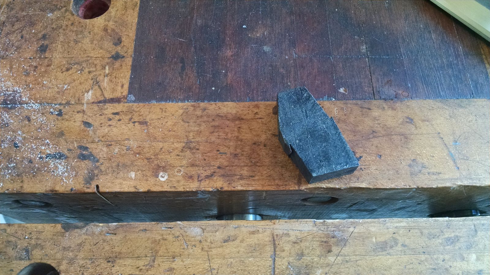

I took a piece of my Macassar Ebony and chipped some wedges out of it. The holes you see were plugs for one of my sculpted rockers (Link Here) that I built in the past. This is a left over chunk of Ebony that I am using for the wedges.
I cut out a few of these wedges from the Ebony, and shaped them to fit into the slotted tenon. This one is before final shaping, I took a chisel and shaped it into a wedge (not shown).
I wish I could have gotten images of the glue up process, but I did not. It's nothing special, you simply flood the tenon with glue, insert the pillow rail, then flood the slot with glue, and hammer the wedge home. The image below is the wedged tenon after I flush cut the wedge down, and filed the tenon and wedge flush to the rail.
Note the orientation of the wedges, they are perpendicular to the pillow rail grain, if the slots in the tenons were cut parallel with the pillow rail grain, the wedges would have split that rail as they are rammed home.
They still look a little rough, but they will clean up nicely with a couple passes by the scraper, the burrs will disappear, and the glue line around the tenon will be whittled down to nothing, exposing a fine joint.
