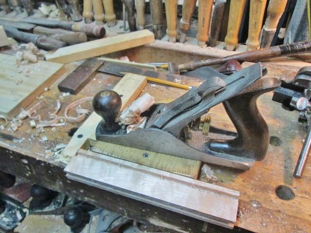

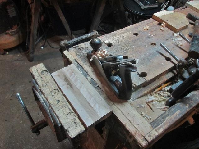

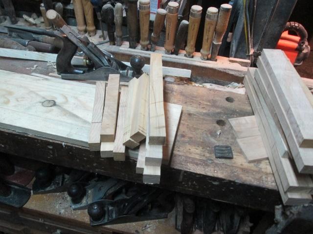

Thought I could just jack plane these smooth....plane was a bit too big, for this job...
The Stanley No. 3c that I had just rehabbed, happened to be sitting out, where I could grab it...seemed to do a decent enough job..:rolleyes:
I even used it to joint a few edges...
Got one looking decent enough as for width...needed trimmed on the ends for square, though..

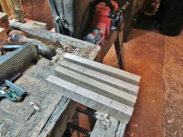

Works for me.    Got a few all the same width, mainly by bandsawing to width.  was able to gang a bunch up..
Used the #3c again. to make them all the same width.   Had two pieces, came from the same board..

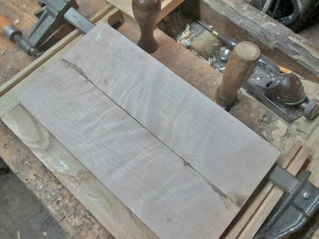

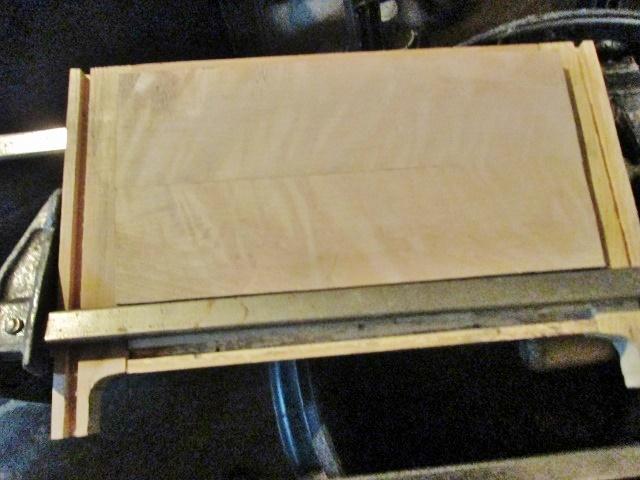

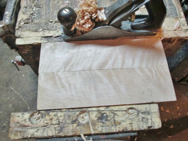

Figured I could book-match these two into a panel for a lid....they needed a bit of work,  one end being wider than the other end...bandsaw to correct that, plane to do the edges straight...try to make the grain as close as i could..
May need to add a bit, to get to the width I need.  Set the thin stuff aside, for now..
These will be sawn down into 1" to1-1/2" wide strips....to make the frames to house those thin panels..had to set up a jig on the saw...
Set for 1" width, for now....may go with the 1-1/2" instead....more to work with.

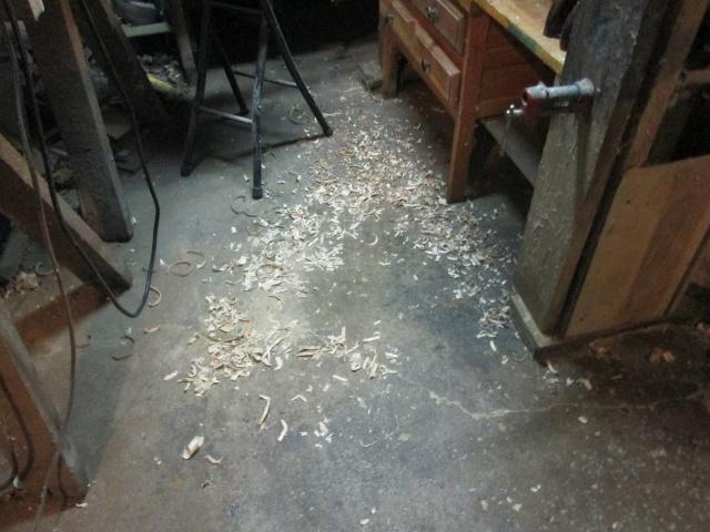

Made a big mess today...
May be about time to bring the trashcan back down to the shop?

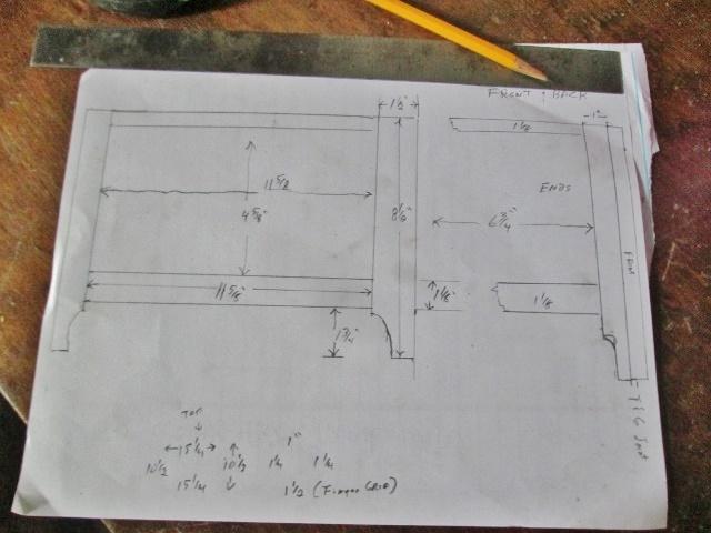

    Ok...took a bunch of measurements  today...and drew out a "Plan"   Not every day I resort to such things....I am trying to make a Maple version of this little box.. That was

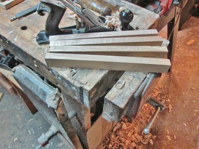

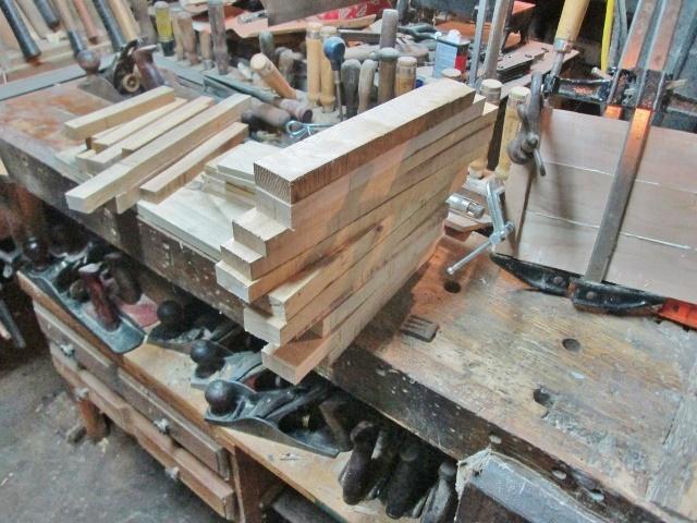

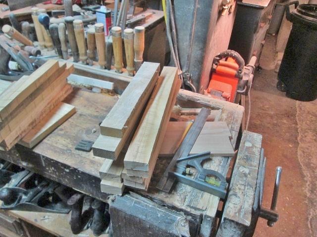

Got the 1-1/2" wide parts milled..
And..I hope enough of the 1" wide stuff, for the end frames..
The wide stuff also has to make a frame for the lid's panel to sit in...
Found a few extra pieces....some became frame parts..some will be panel parts..

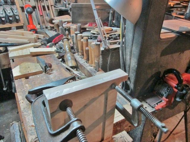

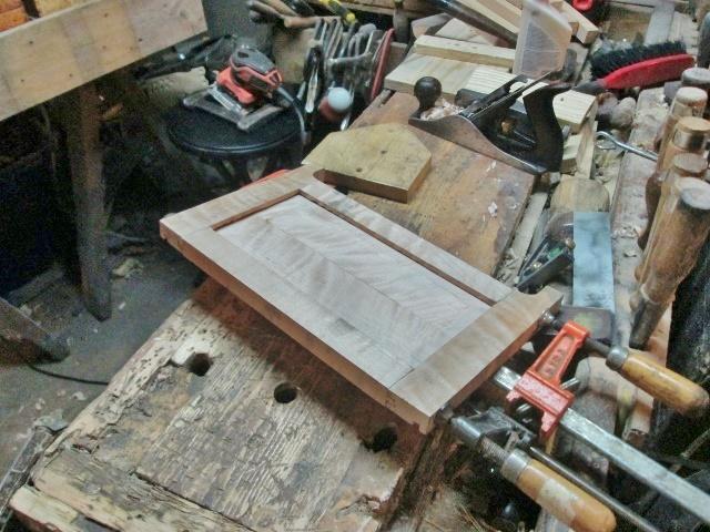

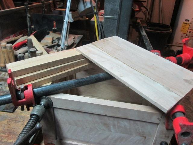

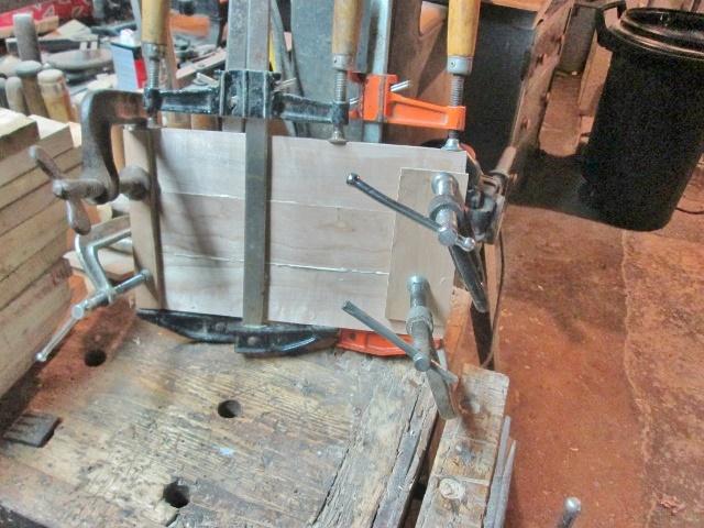

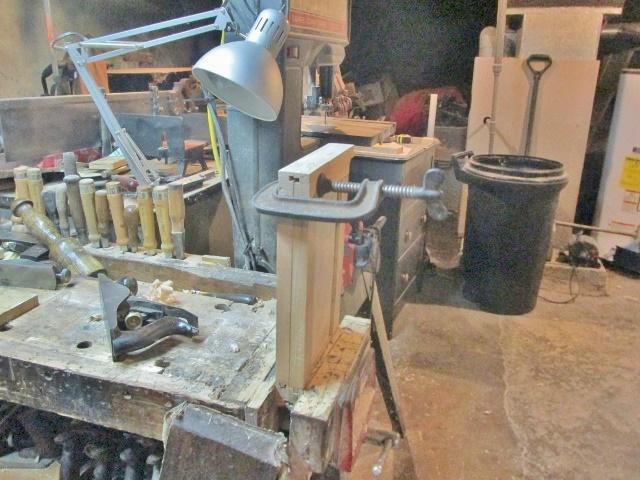

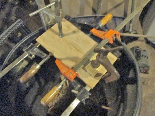

Panel for the lid is sitting in a forest of clamps..
Was a ROYAL PITA to glue and clamp up.    C clamps are holding a pair of cauls....one pair on each end.   Will let this set a day or so...

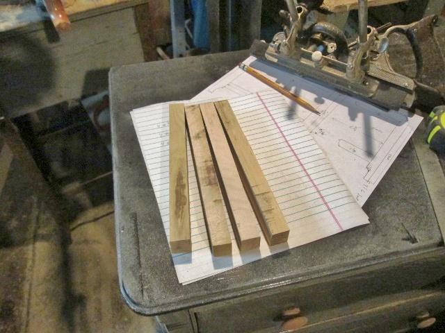

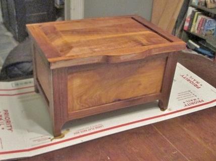

That was made with Walnut  and Cherry....

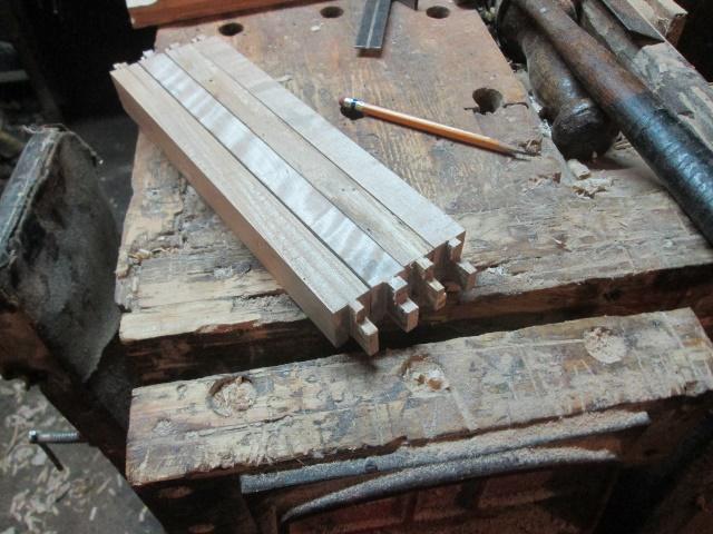

So...a cut list of sorts was made.   These are the corner posts for the front and back frames...had to cut a few down to size...needed to be 3/4" thick ( not 4/4) needed to be 1-1/2", and not wavy.   And needed to be 8-1/2" long.  Smaller mitre box for the lengths...bandsaw to rip for the rest.   Stanley No. 3c to smooth things out, and make them all match....same with the end's corner posts...needed 4 of those, but only 1" wide..
same routine again.   These will be the end corner posts.    They will also get a tongue milled along the edge where it meets the front posts, which will have a matching groove.   Set these aside...things changed a bit, for the next item on the list.    The four rails for the front and back frames...Supposed to be 12-5/8" long...mine only came to 11-3/4"?    Design change!    Two were easy enough to mill....the other two need a lot more work..

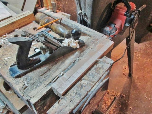

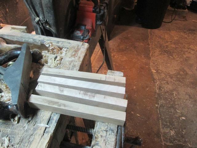

I could trim the first  two to length, and plane them to 1-1/8" wide...as they were 3/4" thick....the other two were too thick, too wide, too long...bandsaw to get rid of the excess...then the plane smoothed things out..
Not the easiest stuff to plane, either.  Millers Falls No. 11, Junior Jack.   Has no camber to it's iron.  Finally got all four of these parts done, to where they matched each other..

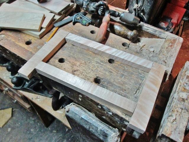

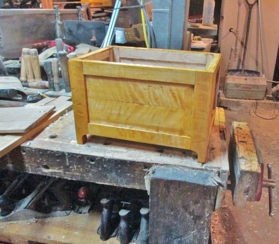

Decided to set the parts out to check how the layout came out..front frame?
fancy?   And the rear frame..
Not so fancy.   There was a problem, though...while I did have one panel that MIGHT fit..

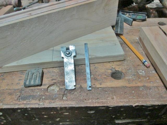

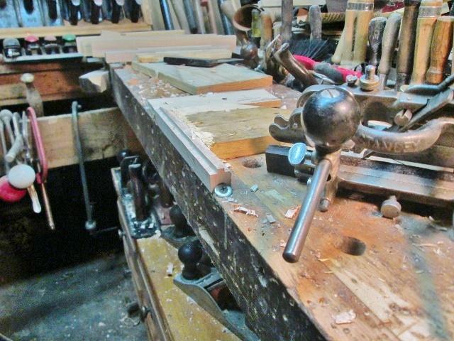

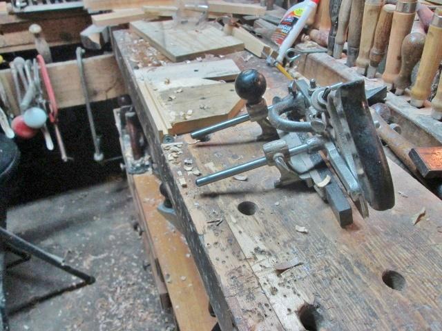

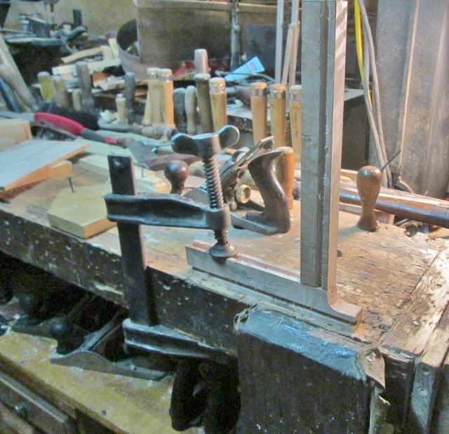

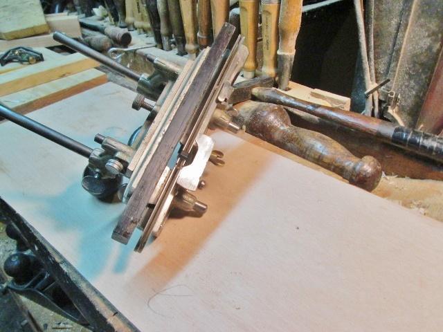

Changed the Stanley 45  from a dado plane back to a groove cutter....had to make sure the groove cutter (#12) matched a fancy  cutter
1/4" "Match" cutter...cuts a 1/4" tongue, to fit in the 1/4" groove the other cutter makes.....need the grooves cut, first....a LOT of them..
All set up.   Spurs have beenrotated back up, out of the way.   Set things up to plough a few grooves..
Two screw heads....didn't hold worth a.....added a pine backstop to replace the far end's screw

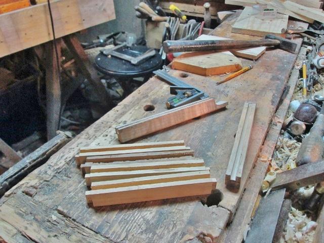

These four are the corner posts, for the front and back frames.   Length was a tad off...so, after the first set of grooves were milled

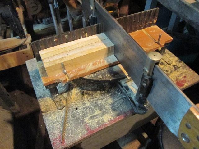

Ganged them up, one end all the same....saw cut the other ends square, and they all matched..

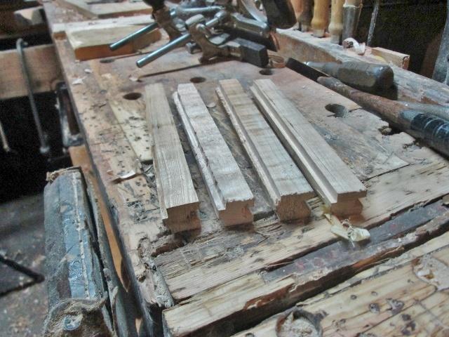

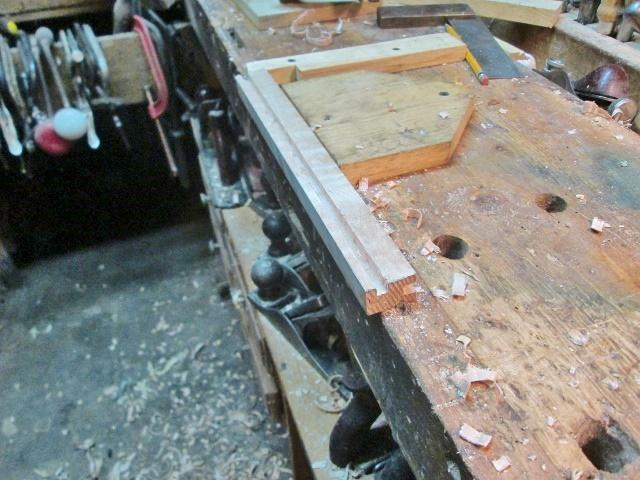

Works for me...There was a second groove to be milled on these corner posts.   This one was for the raised panel, the other was for the tongue to sit in..
And, as usual...one post was too thick....we have ways....got the four all grooved up..

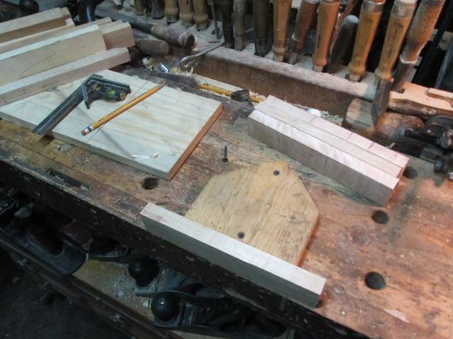

Then worked on the four rails....two get a single groove, as they are the top rails....raised panel groove only...the two rails fro the bottom, also needed a groove to house a panel for the bottom of the box..

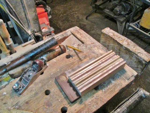

You can also see the entire jig I used...Trimmed the panels to length....and ganged them up in the vise..
And let Junior Jack joint them all the same width.   Set these aside for a bit, wanted the feet profiles done..

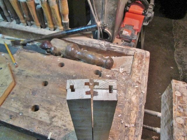

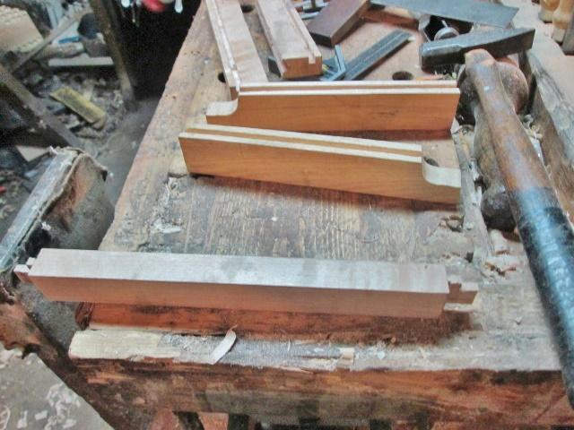

Then used one of the thin panels to layout the tenons on the rails...
Haunched tenons, at that, will fill the groove while the tenon goes on in.   Got all four rails done..

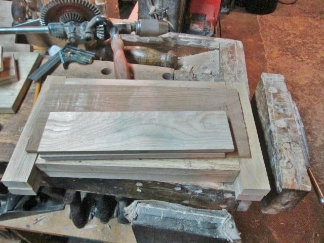

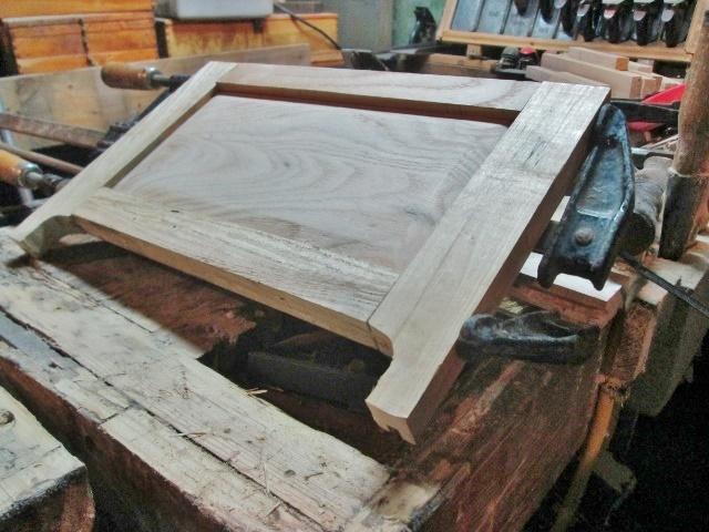

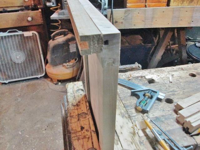

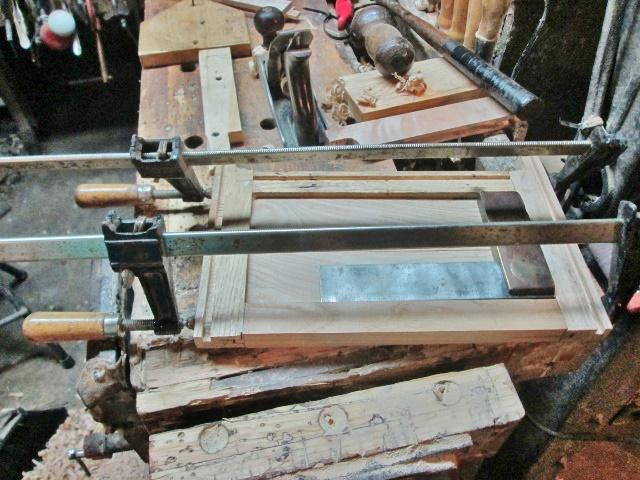

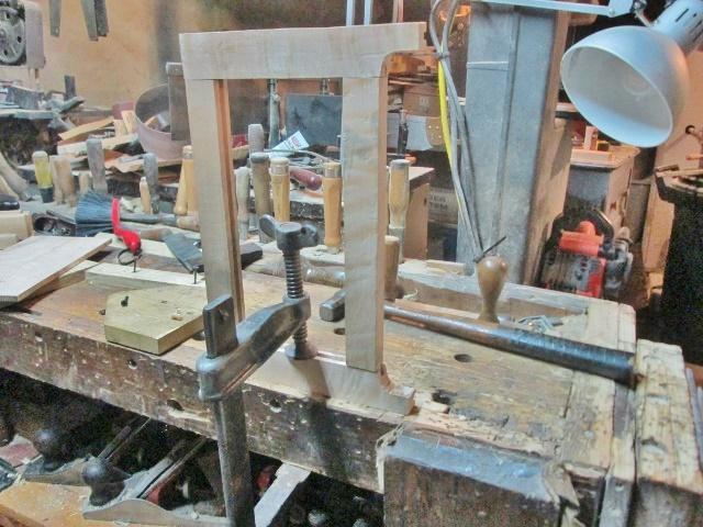

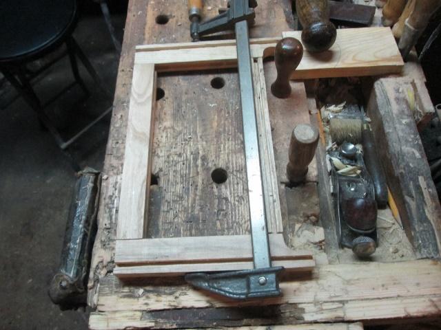

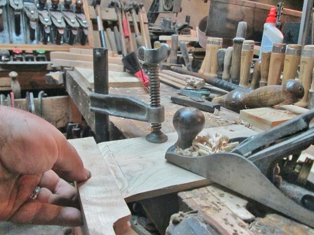

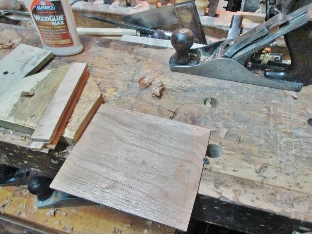

First panel out of the clamps...getting fitted for size....had a dry fit, as well
No glue, yet...used this to size the panels...BTW, mortises  are done on this frame..
Second panel is in the clamps..

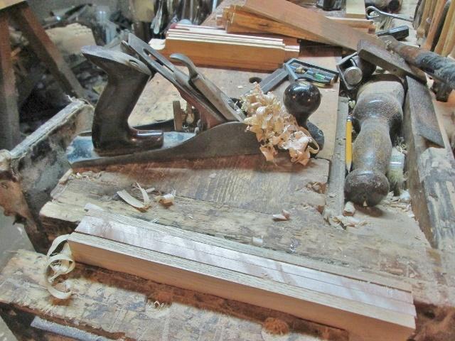

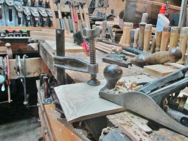

Let this set until morning....Planed the first panel flat...

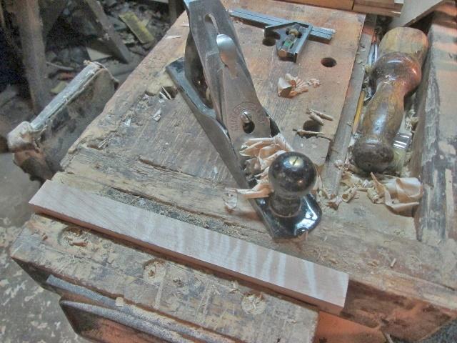

lew will like this one.   Got it sized for width, trimmed down, and jointed the edge...
Waiting on the front frame to get assembled...this will be it's panel.....
"Let the Midnight Special....shine it's light on me.."
Stay tuned...waiting on Wolfman Jack to show up....

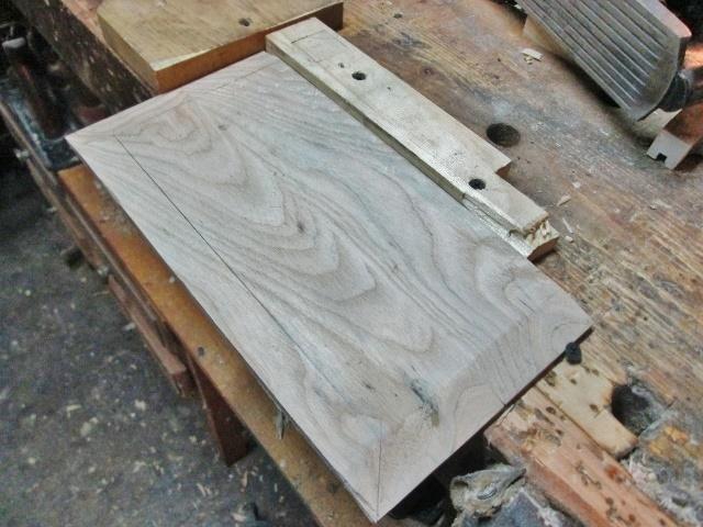

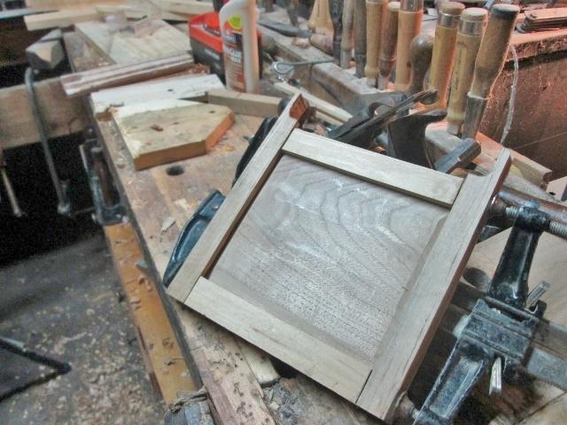

Got the second panel out of the clamps....decided to try to make it a raised panel
ala Paul Sellers.   End grain done first, and checked for fit..
Got both ends done...turned things a bit..
Layout line is 3/4" in from the edge.  Once all four edges are done..might as well glue and clamp the back frame together..
And set this aside until tomorrow...front panel also got "raised", and set aside...had four holes to chop..

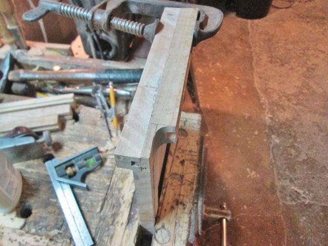

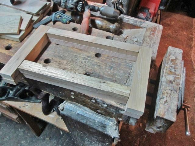

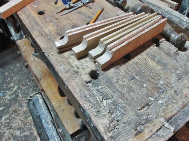

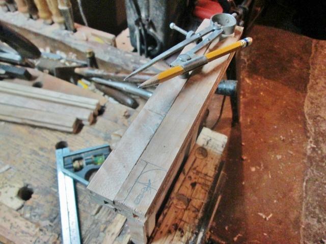

Had one more chore to do to these parts....I clamped one to the front frame..
Even used the compass to do a bit of drawing....then cut away the waste..
Then used this as a pattern to cut the other three....why the tongue?
So when I go to glue this mess up, this T & G joint will line things up.   Thenworked on a set of rails..

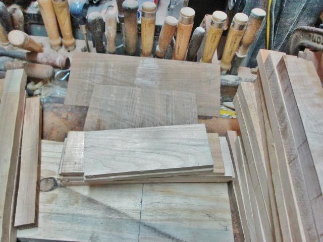

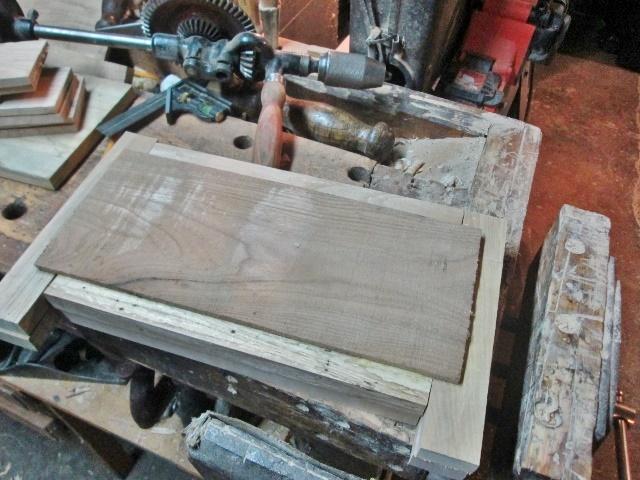

Which left panels to do.   Didn't have enough Maple panel stock...so I cut a couple from this stuff...
Had to flatten them, then do the raised panel thingy...( thinking this MIGHT be Cherry?)

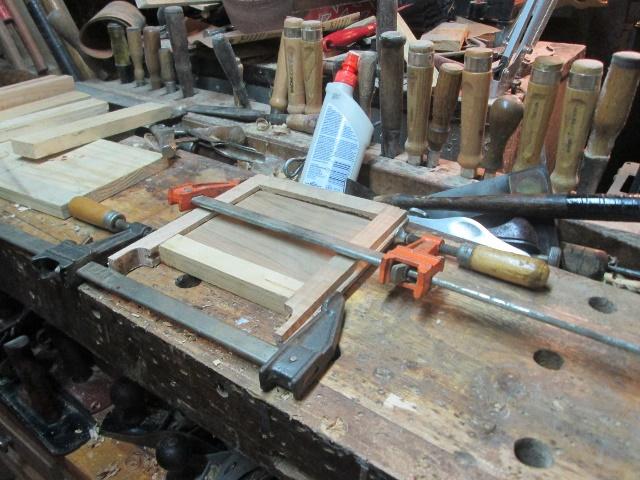

Then clamps and glue....
Trying to keep the clamp's pads ON the tongue, isn't the easiest to do....somehow managed to get both end frames into the clamps..
Let's just say...that hammer came in very handy....:angry::o:rolleyes:....just wasn't in the mood for having items back-talk me

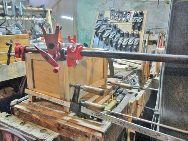

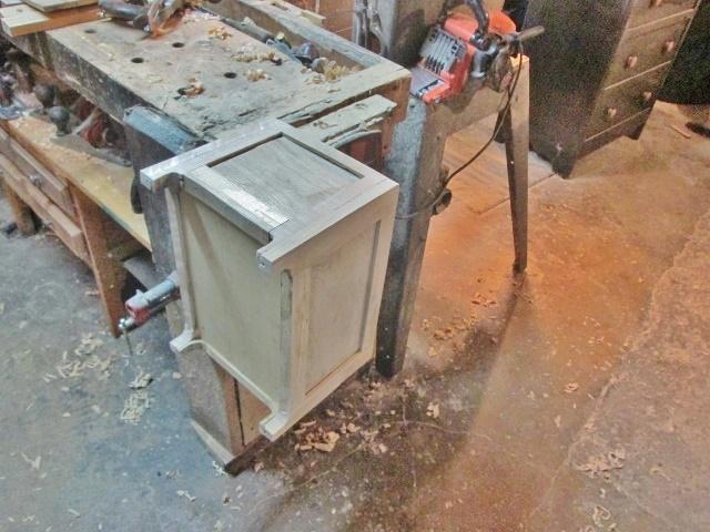

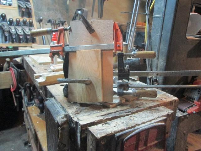

End frames came out of the clamps today....and one post popped right off..:angry:   More glue, and this time a few nails, to make sure it stays put.   Checked the location of where the bottom panel will hit the ends...wasn't enough room for a groove....so..
Panel was cut to size, and notched to fit,,,,with a little bit of room for the solid wood to expand....Yes, I glued this mess up, today..
One clamp to pull things square, as usual.   One other pipe clamp was needed, as the F style ones didn't have enough hp to close a gap....

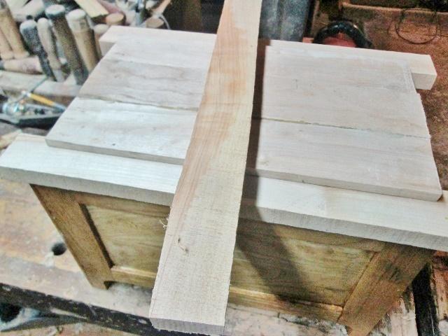

Laid out the parts for the lid, one of those long, skinny boards will get to make the two ends.   Whenever this thing gets off of my bench, that is...bandsaw was needed to cut a thin sliver of maple....
Either the tongue was off-center, or the groove was....too much to plane away....will glue the sliver  to match the gap, then plane it smooth along with the rest of the corners.

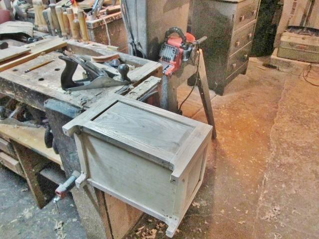

Ok..yes it is a Monday...trying to get a project done while I can.....

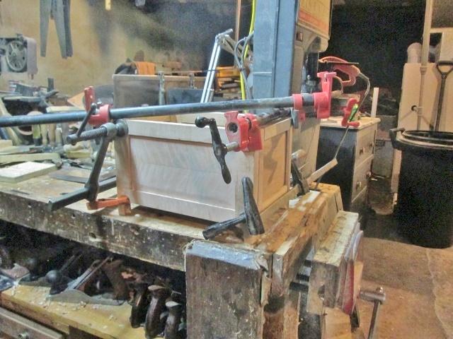

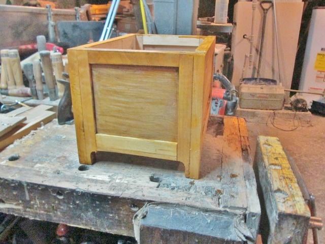

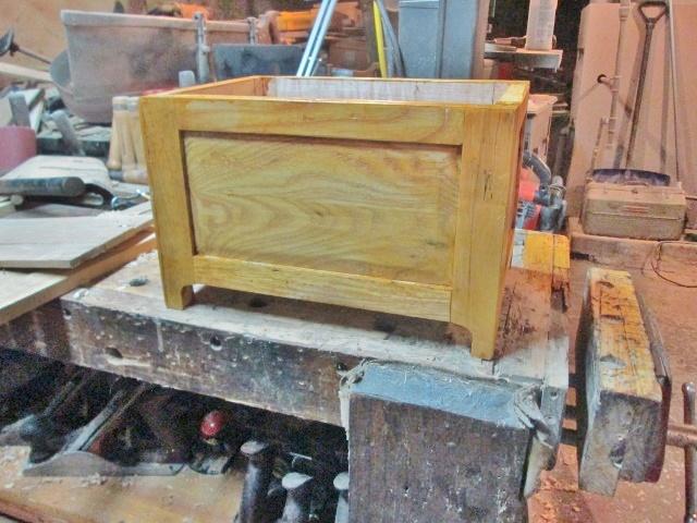

Took the box out of the clamps today....and it didn't  fly apart :o
Couple places needed filled, others needed planed and sanded, stuck the box into the vise...1376958698_endcleanedup.jpg.3a459f1fc0e1765212a17d483759cbed.jpg

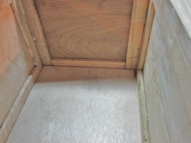

Need a filler strip along the bottom here...planed and sanded to match the rest..
Couple high spots needed work....dusted this thing off, got out the almost empty can of Amber Shellac..
One coat, to seal this up...may need another coat?
Back didn't look too bad.....

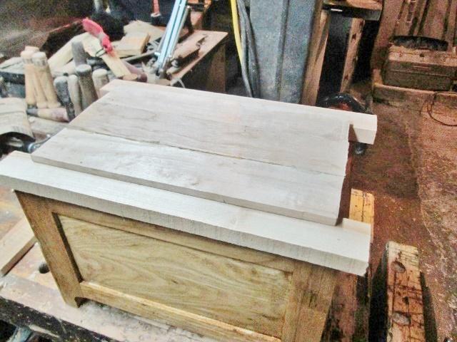

Front looks..ok.....laid out the main parts for a lid...
Need to plane the panel flat, then turn it into a raised panel.....need to cut another part exactly in half...
As this will be the two ends of the lid.    Need to joint the edges , before the Stanley 45 can plough a few grooves.
May try later this evening, IF the shop cools down a bit....."Start Time" in the morning?  be ON the road by 0500....:o:blink:
