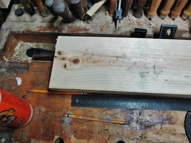

steven newman Posted February 21, 2018 Author Report Posted February 21, 2018 File has been started at VA....more stuff to fill out, now.... Took a few 1 x 6 planks to the shop.. Not the easiest thing to do...getting a 8' long board down there. Managed to haul one at a time. mark each for a couple crosscuts.. Just a few basic tools...length was 40". Used a couple bench dogs to keep the plank from moving around too much... One to push against.. The other was to keep the board from rotating around Got the first two planks done....there was an "issue" though... 40" hit right about here....hmmm....since I cut a profile to shape the "feet" of the case...guess where this knot will be.. That board is now the center of the 3 board glue up... Need to mill a rebate along the back edges of the panels....should be able to rebate right over this ...thing. Managed to get #3 plank to the shop, cut to sizes needed. Then I stacked all 6 parts up on the bench, and clamped them down until they were flat.. Will let the stack sit overnight...maybe tomorrow, I can joint a few edges, and spread a wee bit of glue....stay tuned. Al B, p_toad, Grandpadave52 and 1 other 4 Quote

Popular Post steven newman Posted February 24, 2018 Author Popular Post Report Posted February 24, 2018 Grrrrr everytime I think I could sneak off to the shop...The Boss needed to run errands. Wasted MOST of the day sitting in the van, while she was in the stores....throw in a round-trip to Huber Heights.....left me maybe an hour to do...something Second panel is out of the clamps...and a clean up started... Worked a bit on some high spots.. Then brought panel #1 over and placed it on #2...just to see how well they matched up.....meh....ran the square a bit.. I think a plane could "shoot" this edge. Panel was a hair wider,, About ~ 1/8" or so....will clamp the two panels together, then run the #8 along until they DO match....One end will take MORE than a shooting plane.. Sooo, while these two are clamped together, I can run a saw across both..THEN maybe they will match. If and when they do..I can cut a foot profile out. Then the real fun ( and cussing) can begin... Stay tuned p_toad, Cal, Harry Brink and 2 others 4 1 Quote
steven newman Posted February 25, 2018 Author Report Posted February 25, 2018 Back started to stiffen up, today...worked in the shop until 1700 hrs....then closed up shop...might have got a wee bit done, though.. Ganged the two panels up, to figure which was inside or outside faces. Clamped them together, and set up a fence jig...needed to square the ends This is the jig I post on WOOD Forums long ago, as a fence for a jobsite saw. Been in use ever since. Set the distance between the saw blade and the edge of the shoe. Check for square, and make the cut....the circular saw IS a Vintage one, BTW. Got both ends squared up...which left the edges in need of a little work...since the panels were already clamped together... There was a couple spots, where this huge plane wouldn't cut...we have ways.. Jack took care of those trouble spots the long plane was skipping over. Hmmm, as long as these two are still clamped together.. I could get a few toys out, layout the pattern for the bottom of the case...and saw that out... If they are to match each other..might as well do both at the same time. Finally marked out for inside and the back of each panel.. Then got out the reason my left thumb is sore, as well.. As I needed to mill that rebate. The case's back panel will get glued and screwed here. Had a scrap of the plywood, to make sure I was deep enough.. Got things laid out and set up, to make use of this little gadget...I also cut one 1x2 x8. One was a stile for the face frame, two were for the web-frames, and a small leftover scrap. Used the framing square to layout a few lines.. Needed a space for corner blocks to attach a top, then two lines for the webframe. the a space for the kicker, and a drawer side, to layout for the "runners" the drawer will slide on. Then marked out for the bottom and middle shelves. Dovetail bit to mark a center line.. The CL is where I pull from. Once I know how far in from the edge of the router's base's edge to the center of the collet, then I can mark where the fence will be set up. Mark a line for the fence to be set to..and away we go.. Close enough. Made all four slots on one panel..used the layout lines to layout the second panel.. I use those little tick marks and the framing square to mark lines to set the fence to..and an arrow telling me which side of the line gets the slot..set up and make four more cuts.. Had to use a "Climb Cut" to avoid blowing this spot out.. Came in from the edge into the knotty with the bit spinning the "wrong" way. Tight hold on both handles, and press against the fence...the a clean-up cut coming back the other way.... That will do for the panels, for now...need to start cutting parts for the webframes....set up a small mitresaw for that..AFTER I cleaned the shop up.. I can save the large one for tenon work. Back was hurting, time to stop....maybe tomorrow, I can start cutting parts? Stay tuned p_toad, Cal, HARO50 and 1 other 4 Quote
