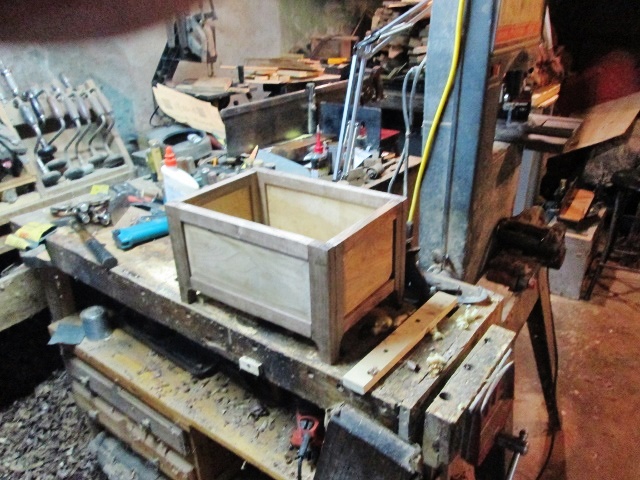

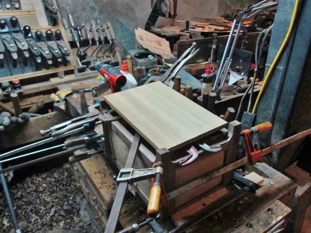

This was the scene this morning..

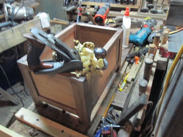

C clamps and visegrip finger clamps to glue in cleats.    Panel will become the bottom of the box....
After all them clamps were taken off.   Panel was a tad too wide, and had a wavy end..

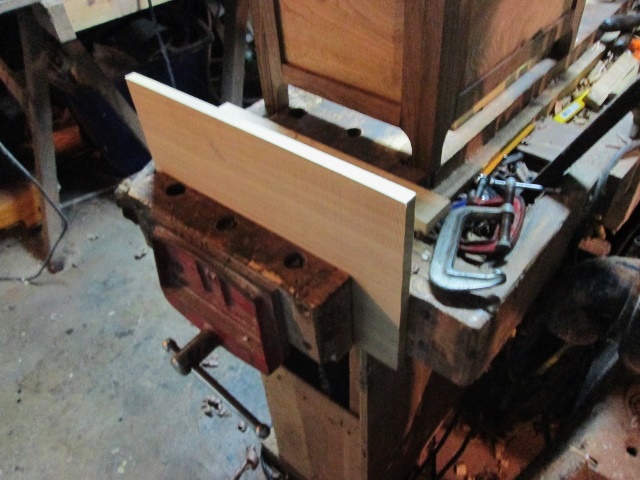

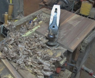

Clamped it up in the vise.   Used the "new" Stanley No. 4 to adjust the sizes..
Shavings were a tad too thin...took a while.    Test fits..
Just a hair of a gap.   Should be about the right fit.   May add a small "dot" of glue under it, right at the center of the panel...no nails, or screws needed.

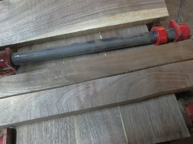

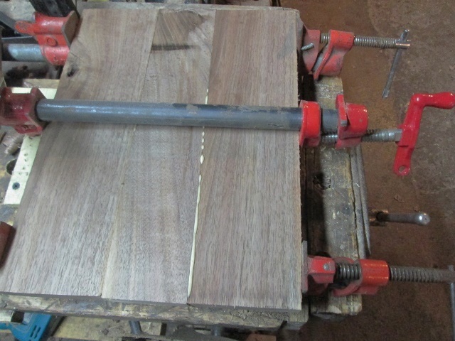

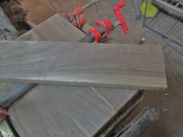

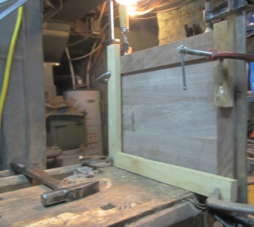

Three board glue up....will be a raised panel tomorrow..I hope..

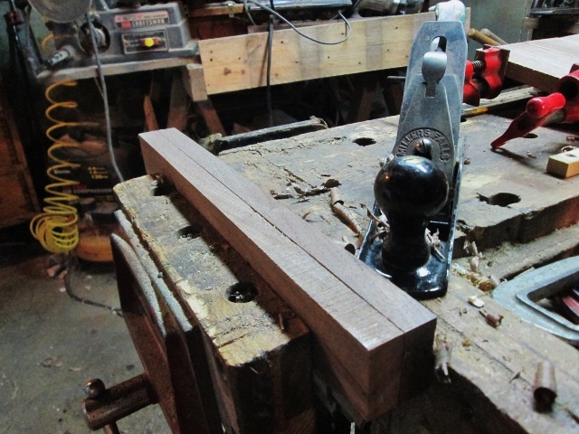

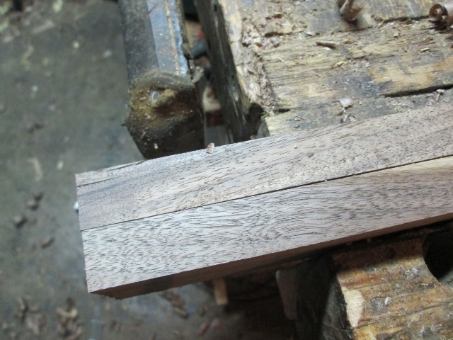

Needed to split this right down the middle.....long rails for the frame...
Two blanks for the "short" rails....I clamped the two long rails back to back and clamped them into the vise...

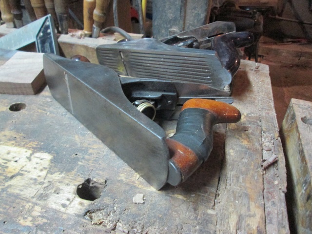

A bit rough around the edges?   We have ways...
Junior Jack plane, seemed to do a decent enough job...
Short rails needed to match each other, as well.   One needed to be sent over to the bandsaw..was wee bit too much to plane off.   All these  pieces were cut to rough length with the Langdon mitre box.

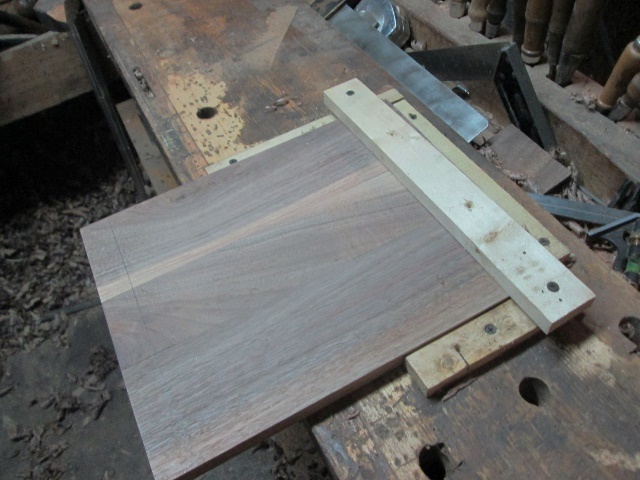

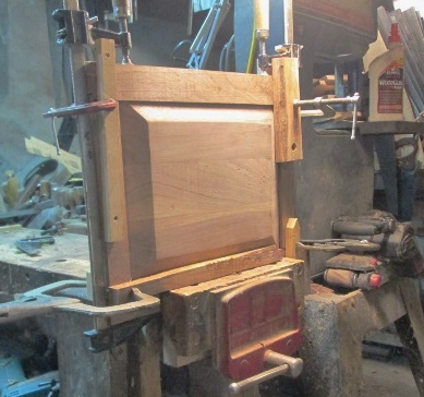

No longer "captive"   and has been "leveled"

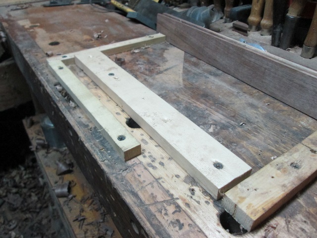

Then a jig was built..

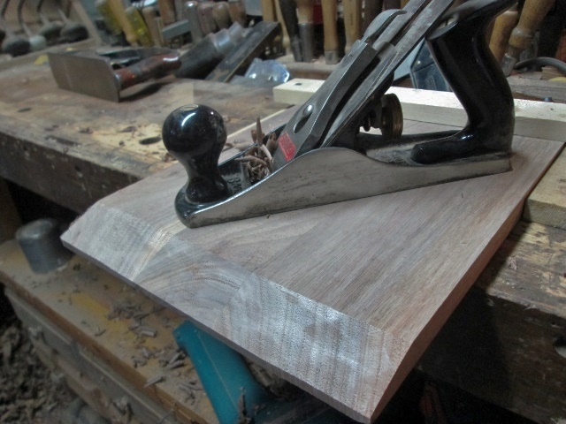

Marked a stop line, and used a couple planes...

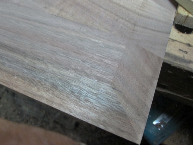

Beveled the end grain first.    Then re-adjusted the jig to do the long grain edges.   Was looking for a nice sharp cornercorner.jpg.3842f4c2ee9483876037955e273fcaff.jpg
Not too bad?  i used two Stanley #4 planes...
The #4c was set to "hog off" most of the waste, the regular #4 was set for a finer cut, to finish the cuts,

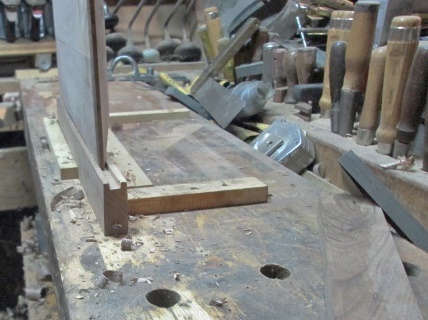

Re-made the jig.   Needed to run the Stanley 45 around.   rails needed a groove milled, to house the raised panel..
Will just have to do...decided to try to glue this mess up...

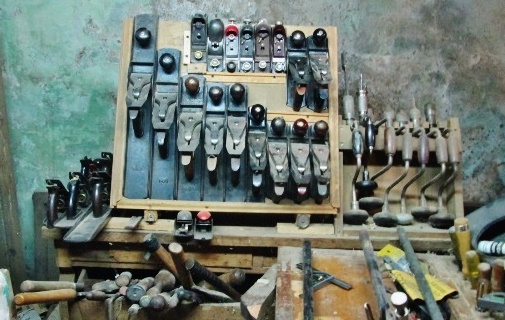

Spent a little time this morning. The Plane til needed things moved around a bit.   Jumbo Jack , and Junior Jack planes needed a bit more room.  Cut and fitted the holders a bit..
The "extras" to the left?   I might have to build an "add-on" for them.   The Stanley #8 isn't even in the picture!   Don't have any more room to the right..
getting a bit crowded...again...
The  family just keeps growing!!

Quite a collection  stash of cordless tools you've got going there:P

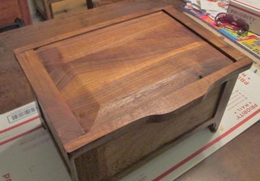

One coat of Amber shellac....just to seal things..
Mainly to see where it needs a bit of work at..
No hardware has been installed, yet
Missed a few spots on the edge of the lid....get those next coat.
Take a close look at them feet....see anything special?
Maybe tomorrow, I can sand this back a bit, and add the hinges?

Don't tell me YOU used a powered router with a cove bit?1?1?:rolleyes:
All I can say is that walnut about popped out of Ohio with the amber shellac...and that's only one coat. WOW!!
Love the handle detail too...did you rout a finger groove in the bottom? Just curious.;)
Haven't made a finger groove...yet.....we'll see...
yes, I do use a router when I don't have a plane that can make a certain profile....

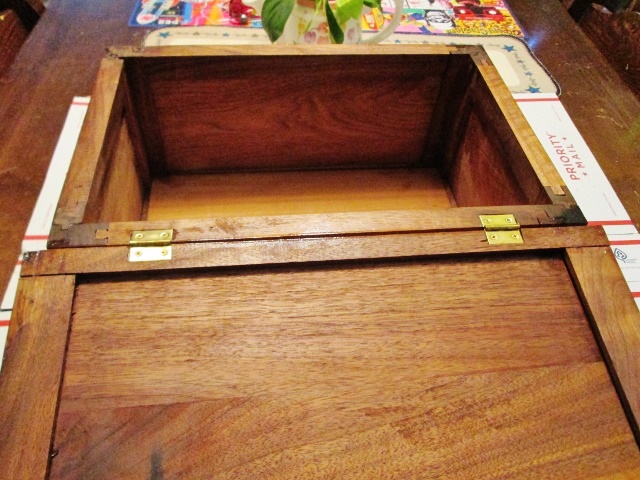

Finger groove has been made..using a gouge.....hinges have been installed.....Trays?   Cancelled.   Wasn't looking right,  wasn't the right sizes of parts....maybe next time, I'll try to make a few....

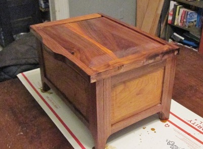

Roh-kay, here we go....finish is done....among over things...

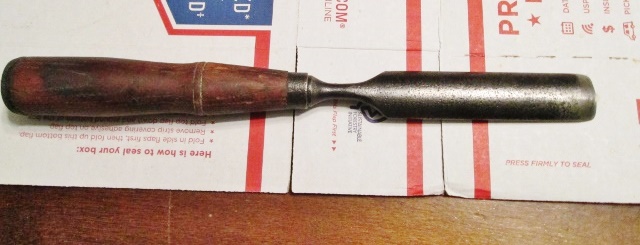

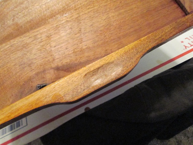

Used this little (1" wide!)  gouge to make a finger rest under the lip of the lid..
Hey, I never said I knew HOW to  carve.....I also got the hinges installed...
And...on the first try, no less!    Ok, close the lid, before something flies in there..

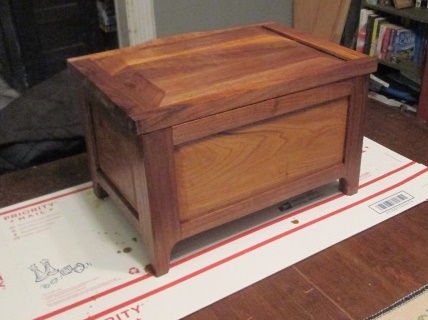

Then a look at the front..
Cherry is showing up a bit yellow...I'll let this sit in a window, and then see how it looks...
One of the ends.   A little bit of showy grain?   Black streak on the edge of the lid?    That be a big,old knot.
Then one of the hinge side..
May have to get the measurements later.....About 15" or so  wide.
Great idea & touch to the lid...glad ya' thought of it.;) Now you can justify why you bought the gouge.:P
