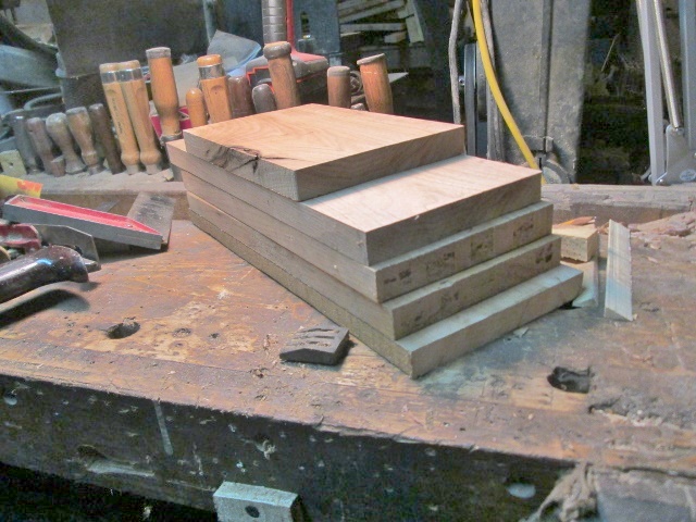

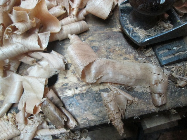

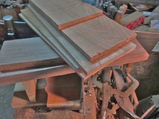

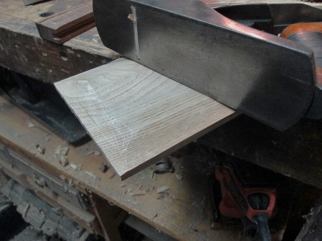

"Scrap Stack"   of Cherry.   Not much to look at?   Decided to plane a few faces, to see what I have..

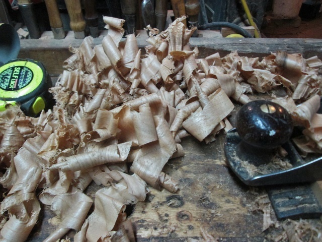

Made a mess on the bench (again..) but this time it is with that Stanley No. 4 I had just rehabbed.....was making some see-through shavings, too..
Yes, that $8 plane made that.   Some of the faces looked very good..

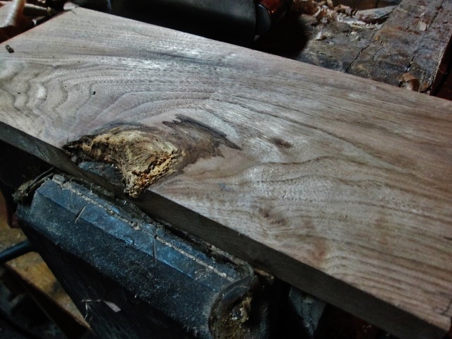

Nice grain?    One board may cause a bit of trouble..
Ya think?    Plan right now, is to re-saw the best sides off at around 1/2" to 3/8" thick.     Then see about building a fancy-schmanzy box?

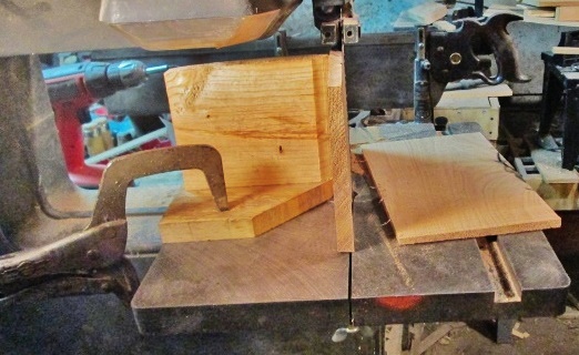

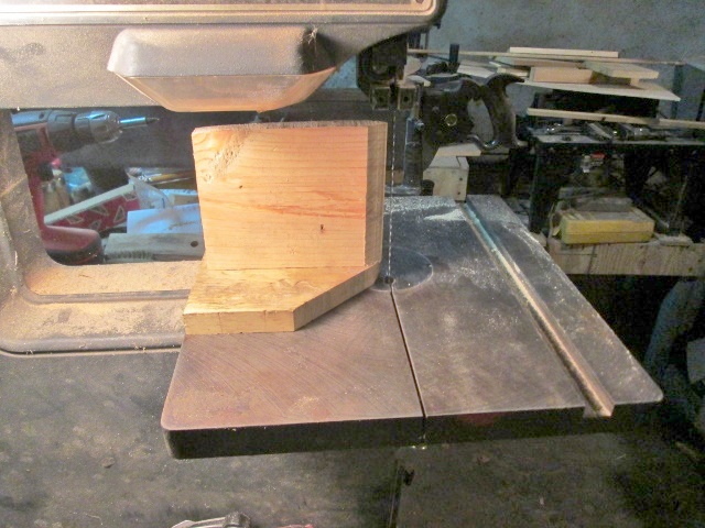

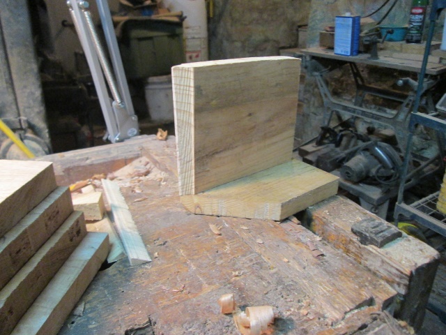

Somehow managed to get these all the same width, and at least one good edge jointed....made a little jig..
I cut a point on the end of one board, and attached to the resaw jig with a couple screws.
Took a couple tries, to get it to fit in here....kept the second cut-off.....needed it later...Things were going downhill already

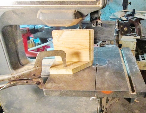

Couldn't find my "normal" clamp..this one likes to move a bit..grrr.  cranked it down.   Set it up to about 1/2" away from the blade.  double checked the table, to make sure it is 90 degrees to the blade...on the third try, it was.   I also tried to set the point ahead of the saw's points..
Will just have to do....starting making a few cuts..
Couple weren't too bad.....another two were cupped.....didn't go too well.   got the stack all resawn down....decided to try a plane to flatten the high spots down..

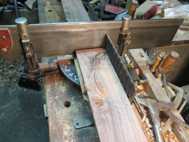

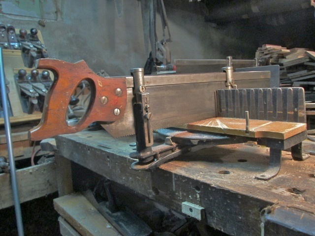

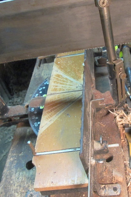

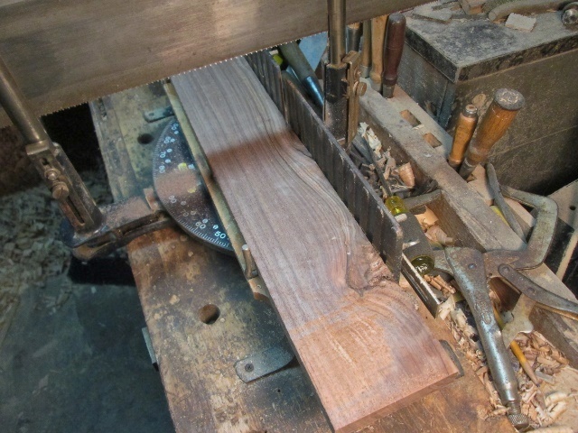

Mitre Box was still on the bench, got out the "old" saw..
As I had a bit of work for it to do..

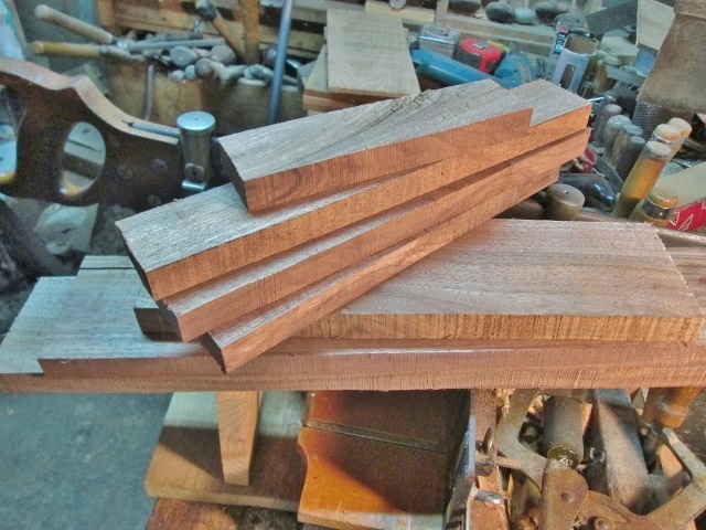

Beyond the saw, there is a decently straight section.  there WAS another beyond  this  nasty section
Task was to remove this bad area.    Once I got that done, I could then straight-line a few edges, as nothing was straight.   Tried to find my metal straightedge...normal luck,  found a straight piece of pine, and marked a few lines.   I also marked around the worst areas, to get a few good parts.   Then I cleared the bandsaw and tried a cut

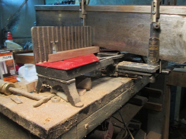

Hmmm, motor runs,  belt runs, both pulleys turn,,...but the drive wheel doesn't budge?    Got to checking,,,,a set screws was loose..VERY loose.  Found the allen wrench set, even found the right one!:huh::rolleyes: Cranked that thing down as TIGHT as I could....stepped back, crossed my fingers, and flipped the switch:ph34r:
It ran like new!  I soon had all the walnut parts trimmed up...
Will need the edges jointed,and then a few gooves milled.    Might use a Tongue & Groove joint to make the corner joints...

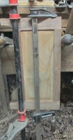

Long side assembly is now in the clamps.....#2 needs a few tenons made, and then it can be glued up....

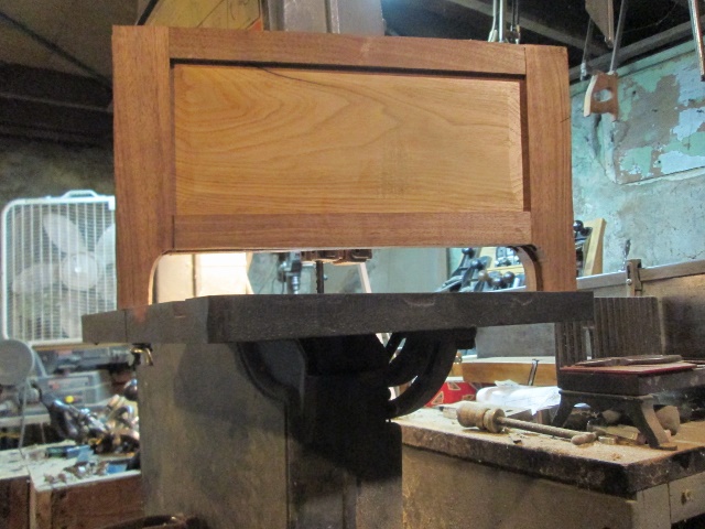

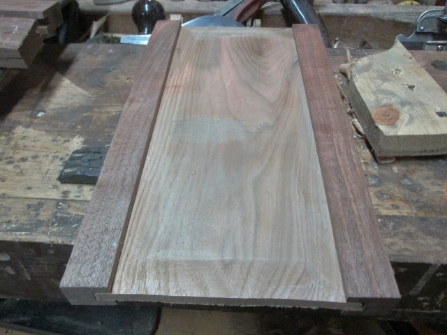

Maple panels have a raised panel look to them....may keep the raised part to the inside of the box?

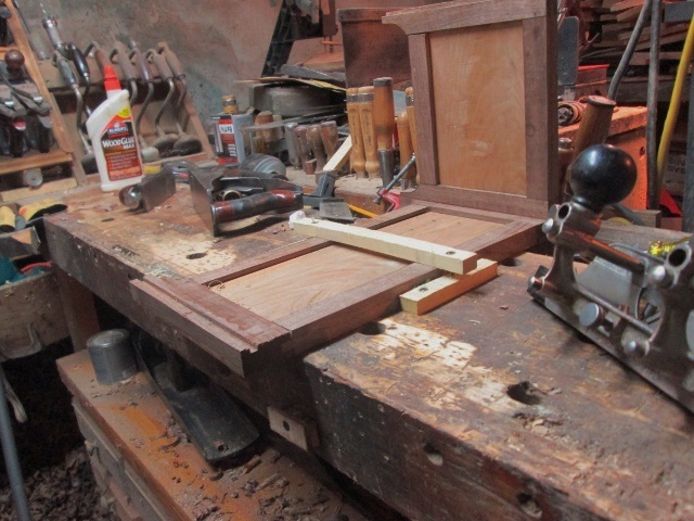

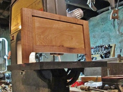

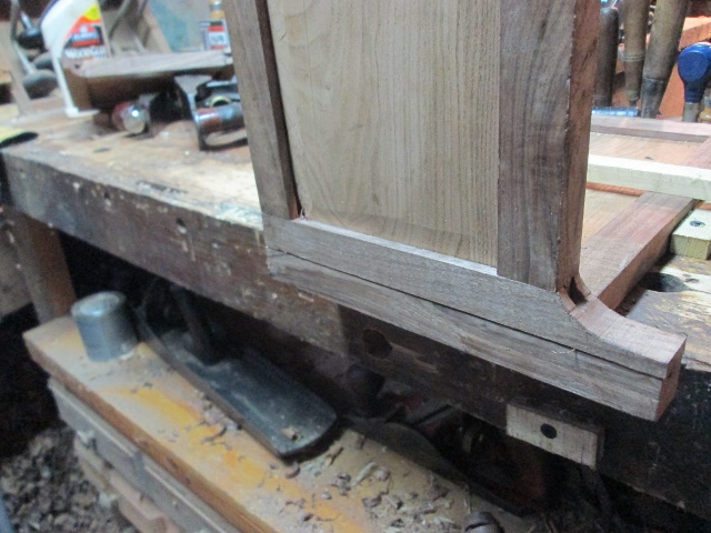

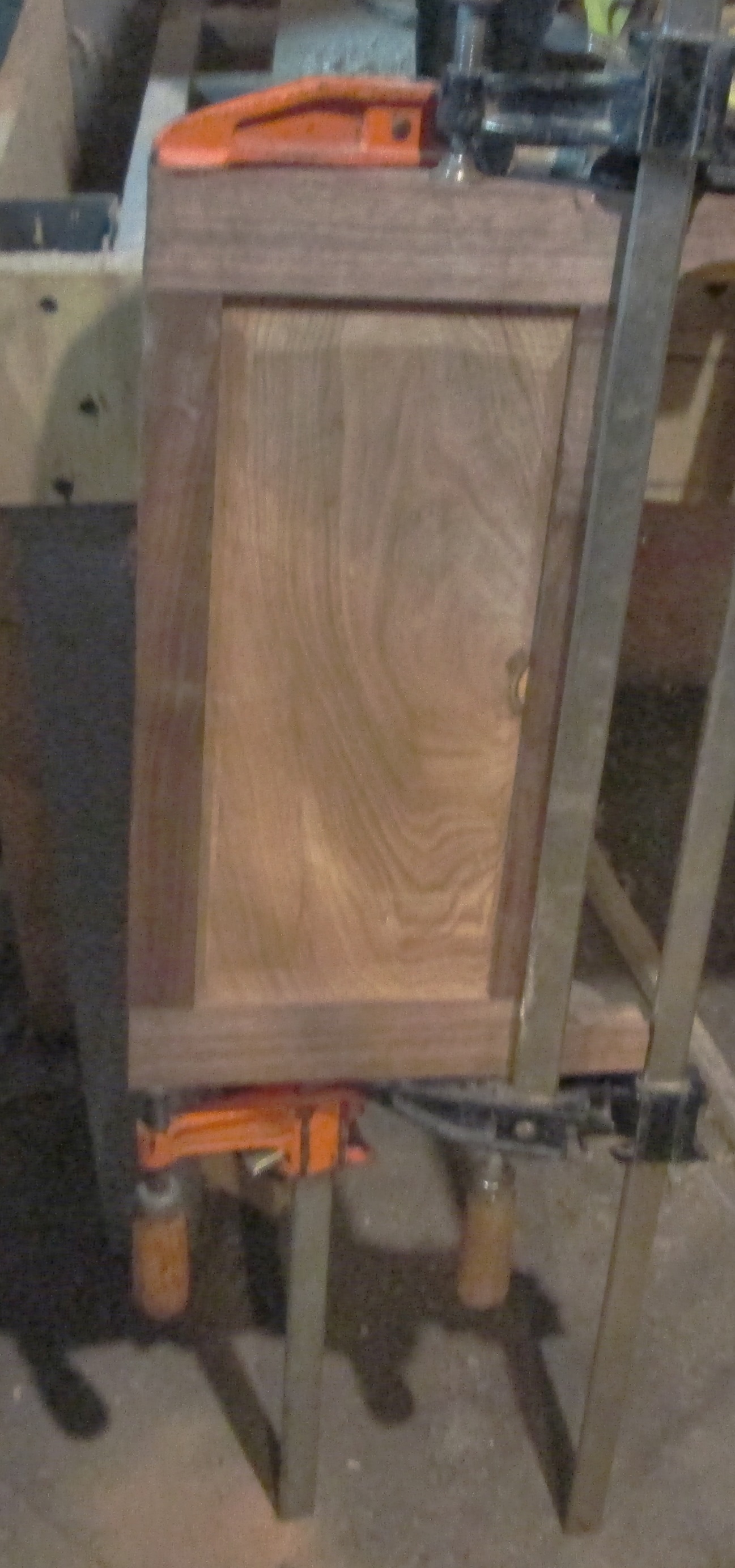

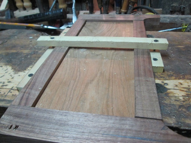

Ok, this is side 1, all glued up.
Beveled the Maple panel for side 2, and then a test fit..

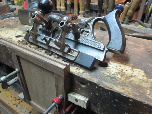

Grooves were made with the Stanley 45....needed to make a couple end pieces..
Box needed feet to sit on...

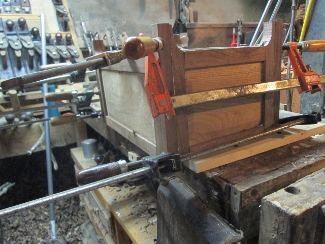

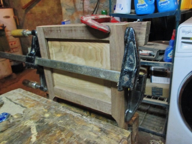

More grooves.   Made tenons on the ends of the long rails, spread more glue around, fought with a clamp or two..
Gave up on the one "F" style clamp, and used a pipe clamp instead.    Swivel pad would not still in place...about went in the trash.

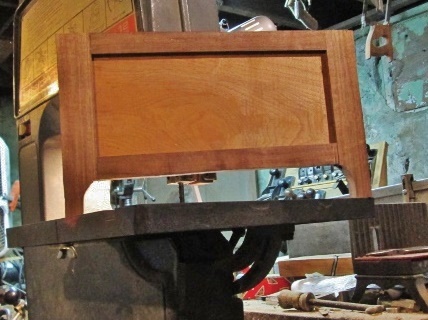

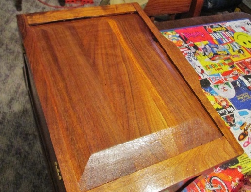

Side #1 is out of the clamps...
Raised panel view....or..
Flat?    Might go with the raised panel look....as for #2?
This is the raised panel view, too.   Might keep it this way.

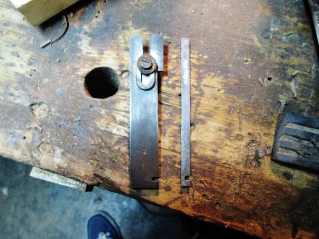

Once I get the ends done and into the clamps, I need the change cutters...
3/16" Tongue & Groove cutters.  #6 & #11.   Corner joint work.

I prefer the raised panel side out look personally. Those pieces are going to "pop" with the orange shellac applied.

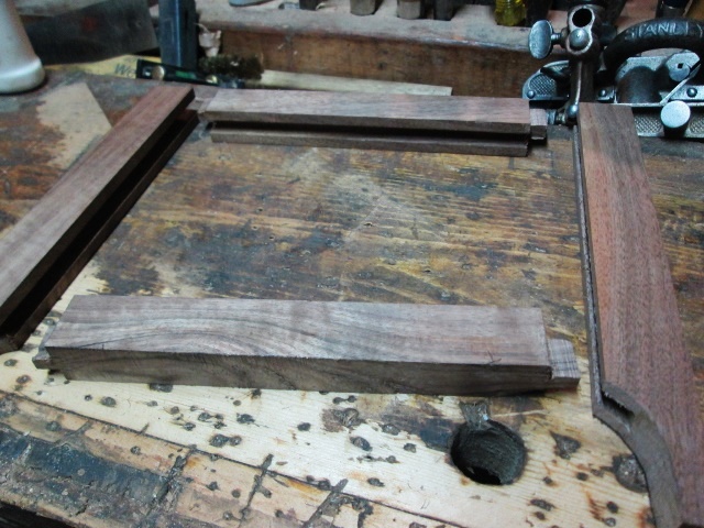

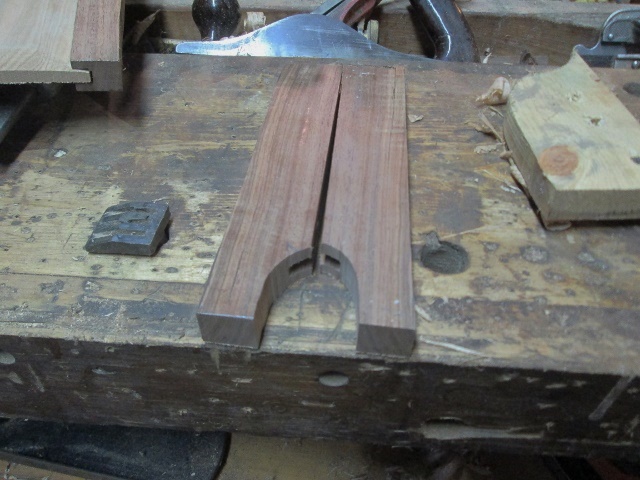

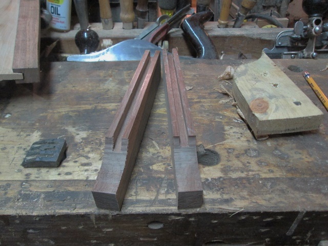

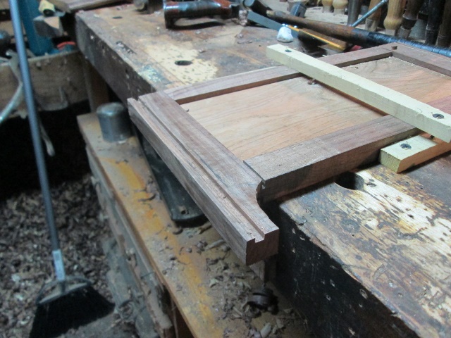

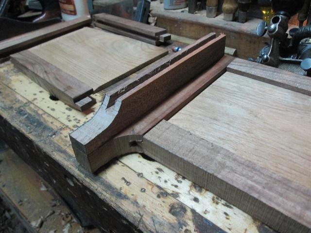

Needed 4 of these "stiles"  made up.    Had a wider plank of walnut, milled the grooves,  cut a strip off the plank, and make another one.....Had enough to make these four parts, and...
Three out of four rails....I had a longer plank, but it was too narrow.   At least to fit in the vise, and have room for the Stanley45 to run along.    I notched the ends of the 2" wide plank, and used those to screw the plank to the bench.   Had a "good edge" standing up, ran the #4 plane along to get a nice flat edge.   Then ploughed the groove.
When done, I could cut away the waste.   I used the bandsaw to cut the profiles for the feet.   I used the mitre saw to trim a few parts
I also marked out for the tenons, and use this to make the shoulder cuts....bandsaw did the cheek cuts...

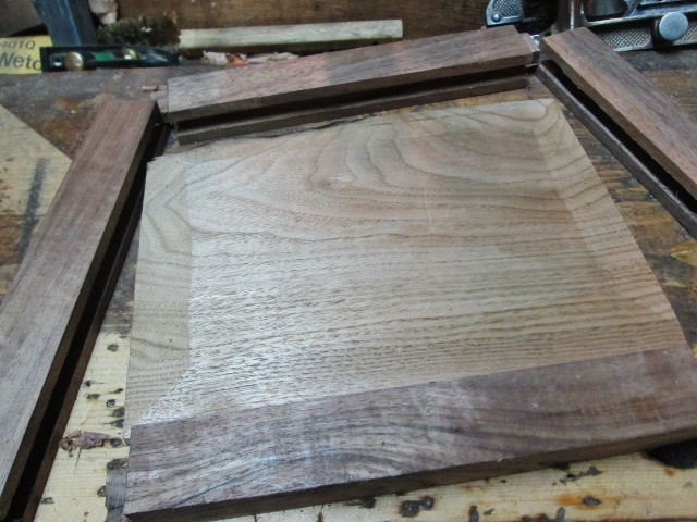

Had to cut two panels to length.   Planed the edges to make them match each other.   Both needed flattened a bit, with a plane.    I marked a "stop line" 20mm in from the edge.   Hand planes to cut a bevel.  Test fit.
Did this to make sure it match the existing stiles.   Had one a hair too long.  Mitre saw to trim.   I also checked a cutter..
Mainly that depth stop.   Don't need a LONG tongue, just  enough to hold the glue.  Will cut a 3/16" wide tongue, so I needed to hone the #11 cutter.   It is a 3/16" wide plough cutter, that "matches" the tongue's size.  ( yes, that IS a gap I have to fill...later.  Ledge and bottom will cover most of it)....Another test fit..

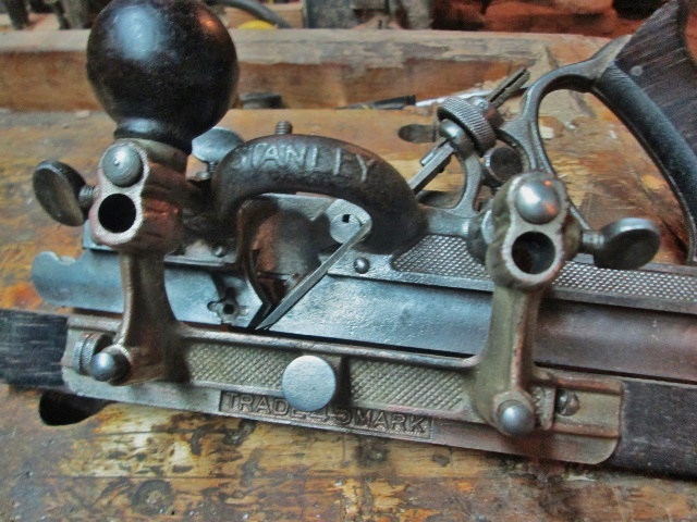

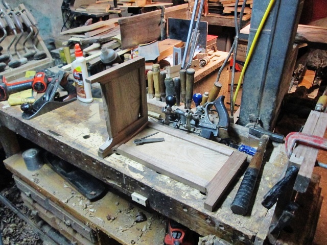

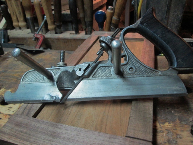

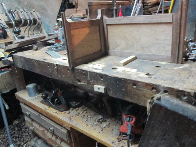

Well, thought I'd sneak back to the shop....and just switch off the assemblies....one out of the clamps, and one into the clamps...got that done
Got to thinking ( uh0oh..:rolleyes:) since the grooves were all finished, for now...maybe I could switch out a cutter?

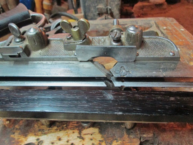

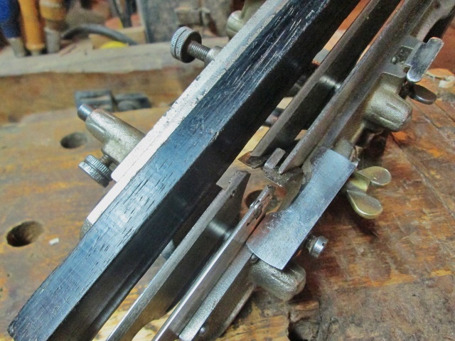

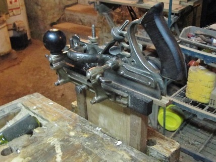

Took awhile.....had to even reset the depth stop on the cutter.   Raised the plane's stops up, and out of the way.   Set the fence to go under the cutter
Which is why these have two places for the rods to go.  I used a scrap of 3/4" thick Pine to set it for center.   This cutter will overhang a bit off the sides.  Biggest thing is the skates need to support the cutter, and clear that depth stop..
On this side, you can see where the cutter overhangs.  These can work even on 4/4 stock, so they are made wide for that reason.
Once the plane is set up, I start at the far end, and work my way back from there.
Sitting in a vise for this shot, only.    I used two C clamps to hold the assembly to the side of the bench, that way, I am pushing in-line with the bench, and not across it.

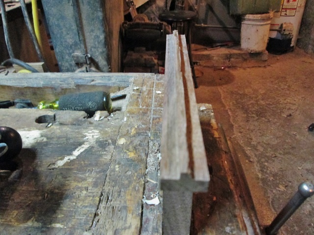

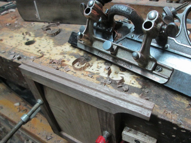

So, how did it turn out?
It is not all that tall, but it only need to "key" into a matching groove to complete a glue joint.   And to think, I was going agaonst the grain to mill this one...
Good thing I had sharpened the cutters up, earlier...
Maybe tomorrow, I can get the other end milled, and then reset the Stanley 45 again.   Stay tuned...

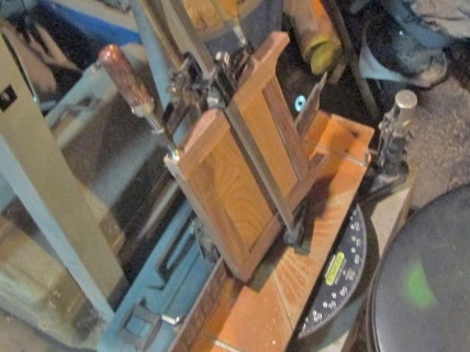

End panel #2..
Showing how it was clamped to the bench, so I could finish the milling..
Pretty, isn't it?   Then flip it around..

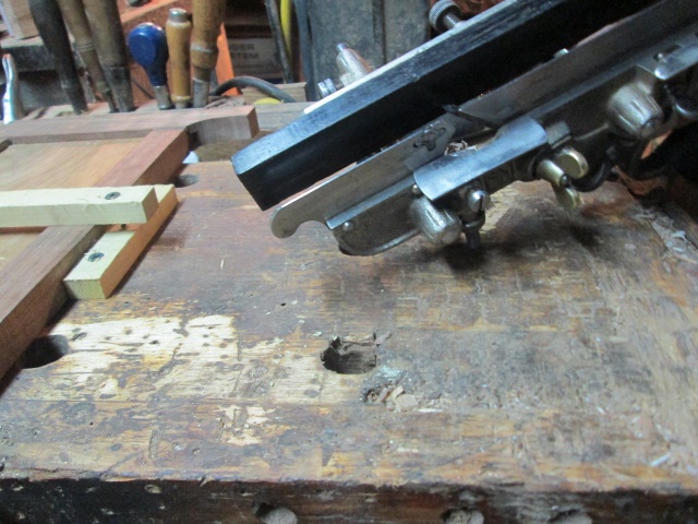

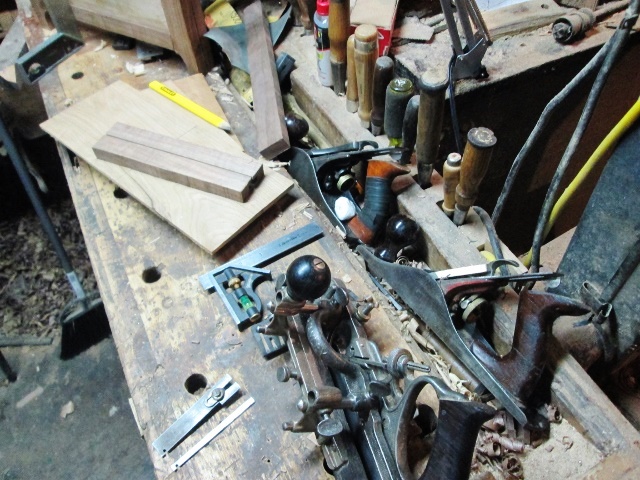

Ok, these are done...time to "tear down" the plane....
Replace the match cutter with this skinny groove cutter.   I only need the main skate.   And the fence..

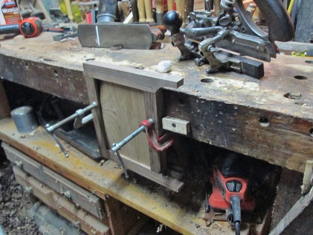

Had to "nibble" on the area where the grooves will go..
AFTER I built a jig to hold things still.   Set the depth stop..
This one was needed,  had to "lower" it quite a bit.   Would rather it be too shallow, than too deep....59b30601a11c7_firstgroove.jpg.5f52a824568faf67a65f694dfbe22e4b.jpg
First try,,,was a hair shallow, and a hair too close to the edge..test fit?
A little gappy on the end....reset the depth a bit.  and the fence....once this one was looking good, I could start on the rest..
No, I did not mill the groove with that end piece sitting there.  Made yet another jig....
Reused a couple pieces...more of a third hand..

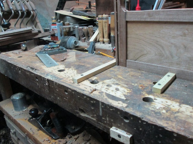

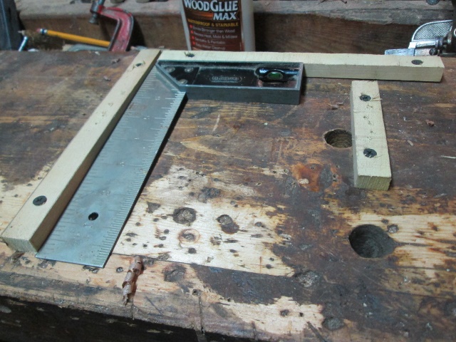

I wanted a square corner jig, to help with the next step...
This way,  I can spread a bot of glue, slide each piece into place, and have them roughly square and waiting on clamps..
I added a pine "keeper" here on the end.   Checked things with a square, and added a diagonal clamp to pull things into square.    6 clamps in use, I can't even work at the bench, right now.

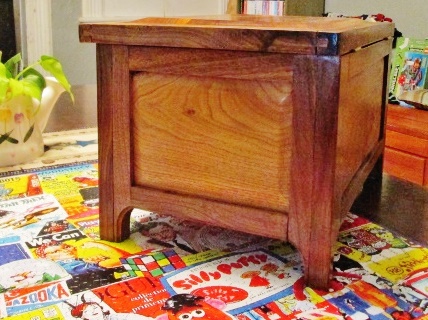

Letting this sit awhile...need the figure out a lid/top for it.
Stay tuned....:rolleyes:
1 hour ago, lew said:
Can't wait to see how the grain is gonna POP when the finish hits this one!!!

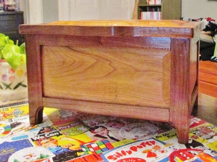

Me either...going to be one pretty "little" box
