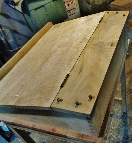

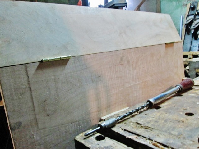

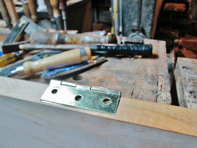

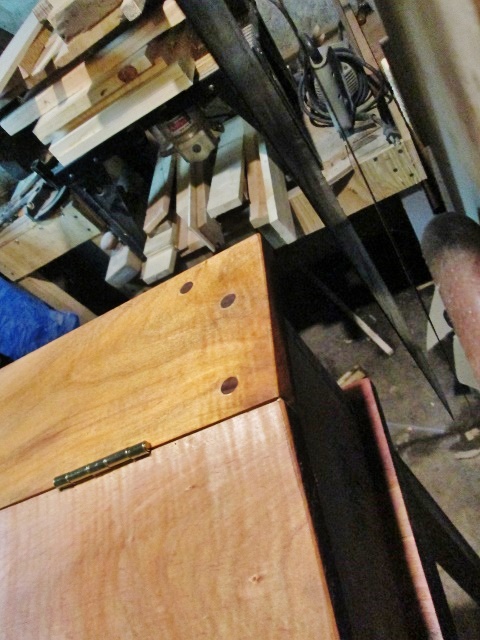

Did I ever say how much I HATE to install hinges?
And to do them on a bevel, to boot?   Toys laid out, Chisel was hit 3 times at each mark...depth control...
I used a small phillips screwdriver to mark where to drill the pilot holes at..
Then check the fit....was going to use the cordless drill....but , found a better way to drive the screws..
Seemed to work just fine....
I did use the electric drill, to drill a few holes..
3/8" Forstner bit.   Pilot holes by the Yankee drill.   The cordless driver has a clutch on it,  so I don't snap screw heads off.
Need to make some Walnut plugs to cover the screw holes..
The cutter I have in the drill press makes tapered plug.   I then use a screwdriver to "pop" a plug out, add a spot of glue..then hammer in place
Then wait until the glue is dry, and then a chisel and a block plane to flush them down level.  I also watched how the grain was running on the plugs, to match the Top's grain.
Took a bit, to get the lid to balance long enough for a picture....Then I leaned  it on over..
I hate hinges...
Closed the lid..
To check the "gap"..
Not too hateful?   ( I still hate hinges..)

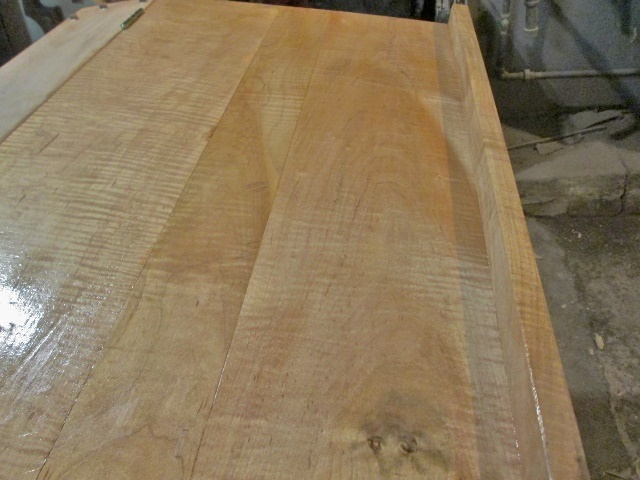

Front view, will I get out the brush and BLO?
Did a test run of one coat on the lid..
I kind of like this grain.....has enough colours that it doesn't look like a plastic slab...

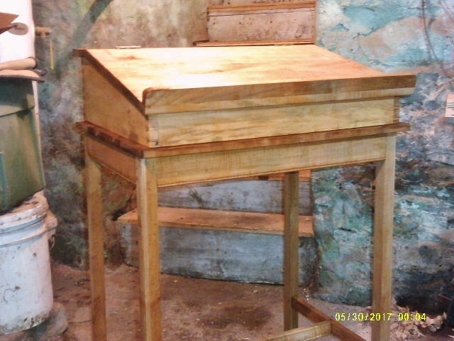

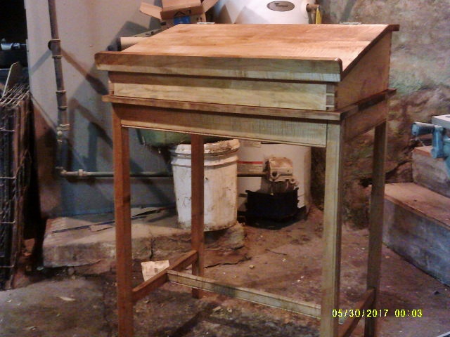

How about a PIP?

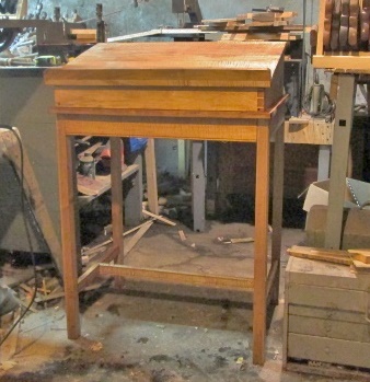

Details....foot rest, and the front of the desk' stand

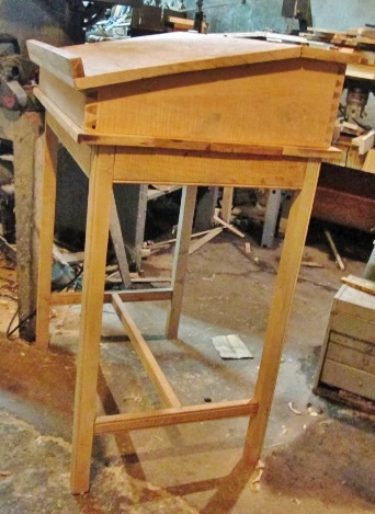

Back corner..tried to line up the grain...
Opened the lid to air it out a bit.....BLO stinks.
Front view

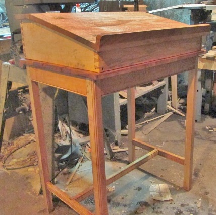

And the full frontal view.    As for those Walnut plugs..
I think it will do, for now.    Waiting on this smelly stuff to cure/dry and stop stinking, then a coat or two of Gloss Varnish.
Need to start cutting finger/box joints, next Project....thanks for looking in!

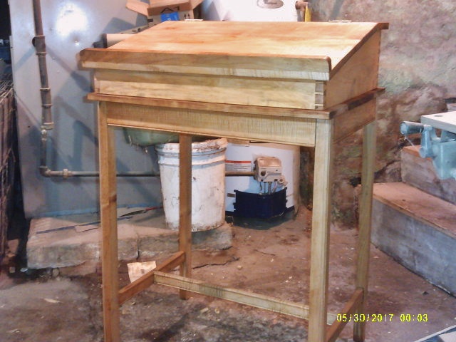

Tried an older camera.....lights were bothering the usual one..
Hmmm, maybe IF I turn the flash on?
Ah, that's more like it!   Looks like what I see.....Other camera like the florescents better than the LED/ Incandescent bulbs...one more?5967a7e7ac5fc_flash2.JPG.5bec230375d71cfe099628fb0efc4763.JPG
The older camera doesn't do fine details as well, like showing the grain

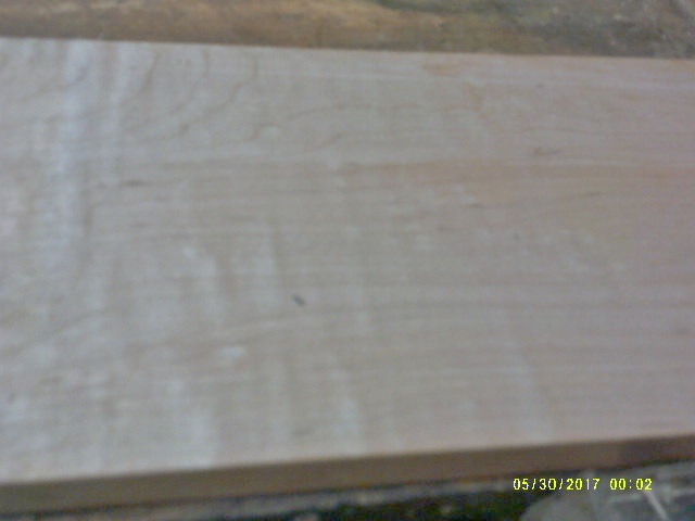

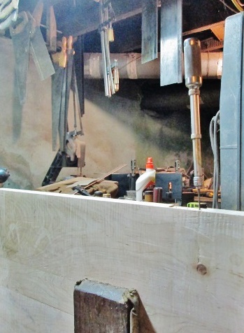

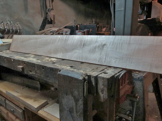

This is a board to be cut up next...
Glass smooth board, mind you.   Will become a Candy Box for a friend of the Pastor.   We'll see how this turns out...
